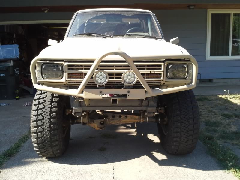

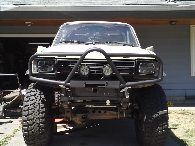

I have tried a couple of different LED light bars but never found one that had the light output I wanted and would work with my bumper (didn't want to mount it on top)
Picked up some round ones off ebay:
bumper needed some touch up paint, went ahead and painted it and the grill desert tan.
Not so sure I like it or not

Nice work, Rob....Gotta adapt and improvise at times! Lol.....
Looks pretty bright....
Originally Posted by Lons81
Those LEDs look great in that spot in the bumper. I gonna have to find some for mine, when the time comes

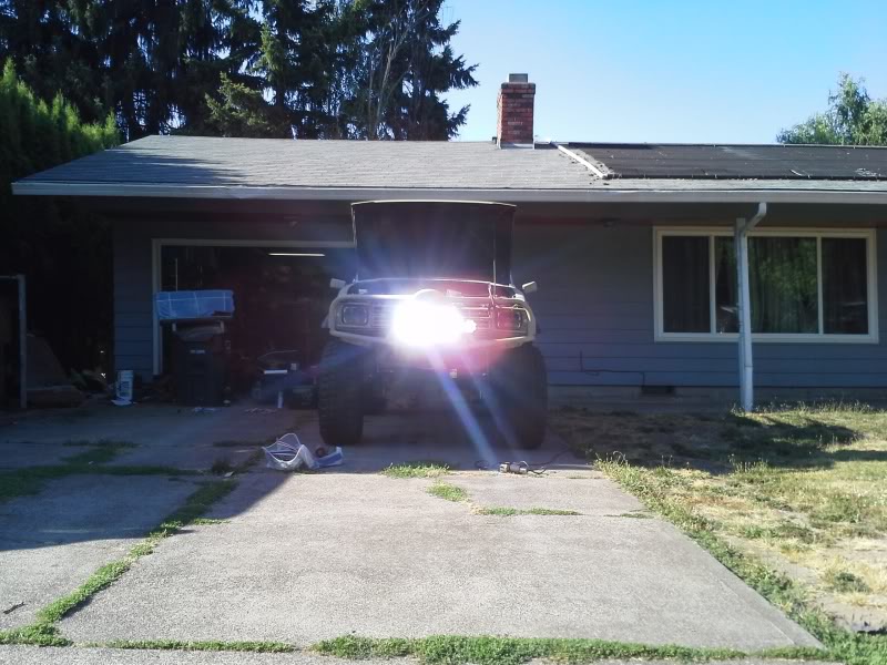

they are pretty bright. I was trying get them aimed last night but my neighbor at the end of the street didn't seem to appreciate them coming them coming through his windown
decided the tan bumper/grill combo was a bad idea:

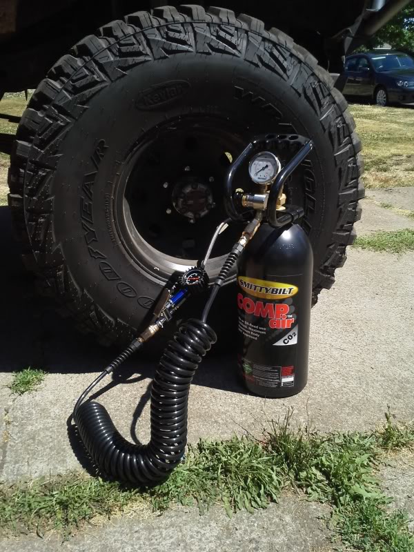

filling up tires should be a little faster now:

Went cO2 eh?

Thanks! If you search on ebay for 45w LED spot you will see a few come up. I got lucky and found a guy priced a little lower than most
He had them shipped to me in less than a week from hong kong. There is a guy on pirate selling the same lights but his shipped price to me was more than what I paid.
http://www.pirate4x4.com/forum/light...es-lights.html
He has some good pics showing the output. I tried to get night ˟shots but I pissed off my neighbors
You might look at the 60w LED spot lights. They have a bit better output, I would have gone that route my I have limited space where I wanted to mount my lights

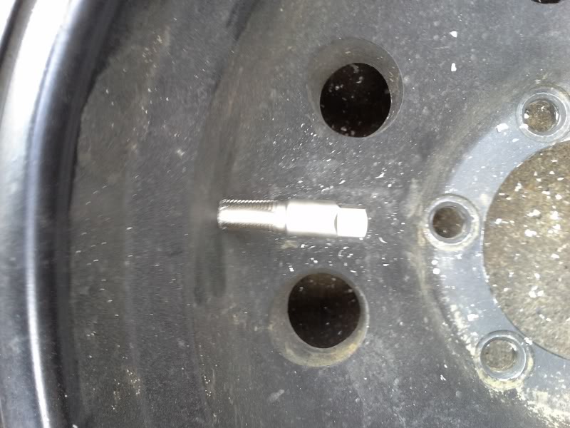

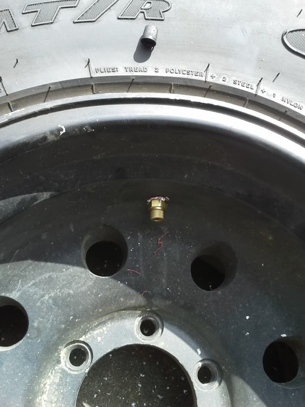

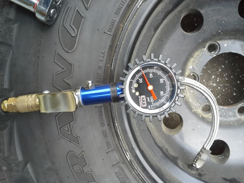

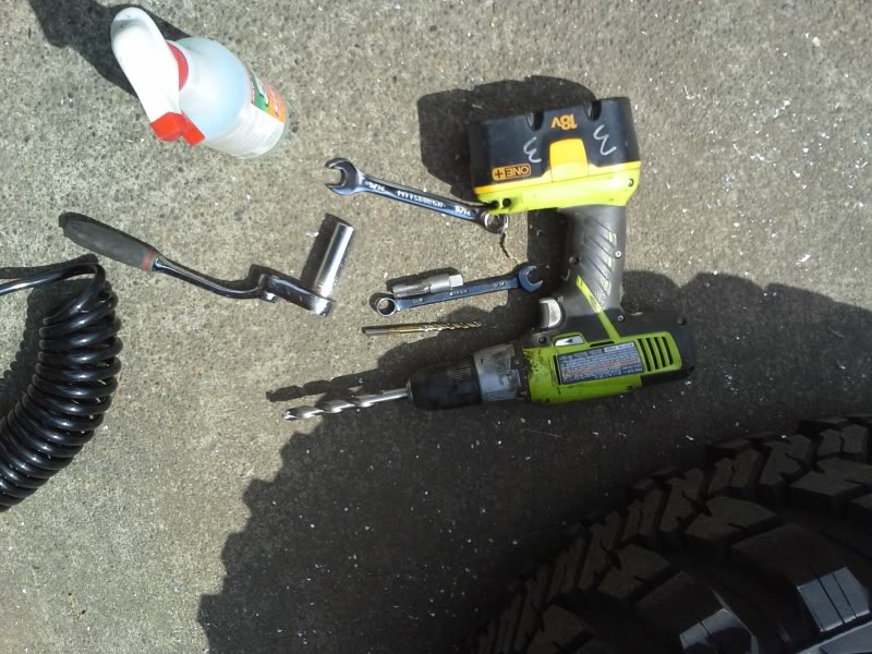

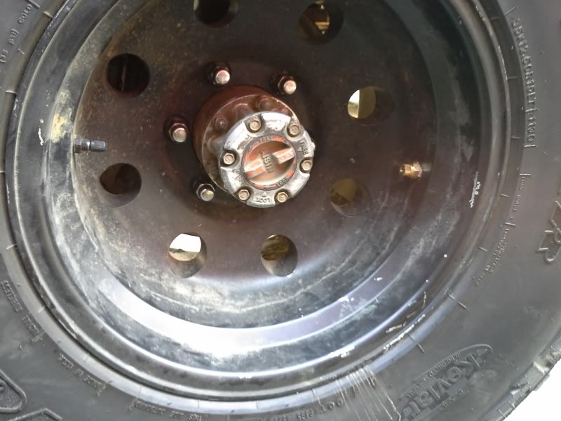

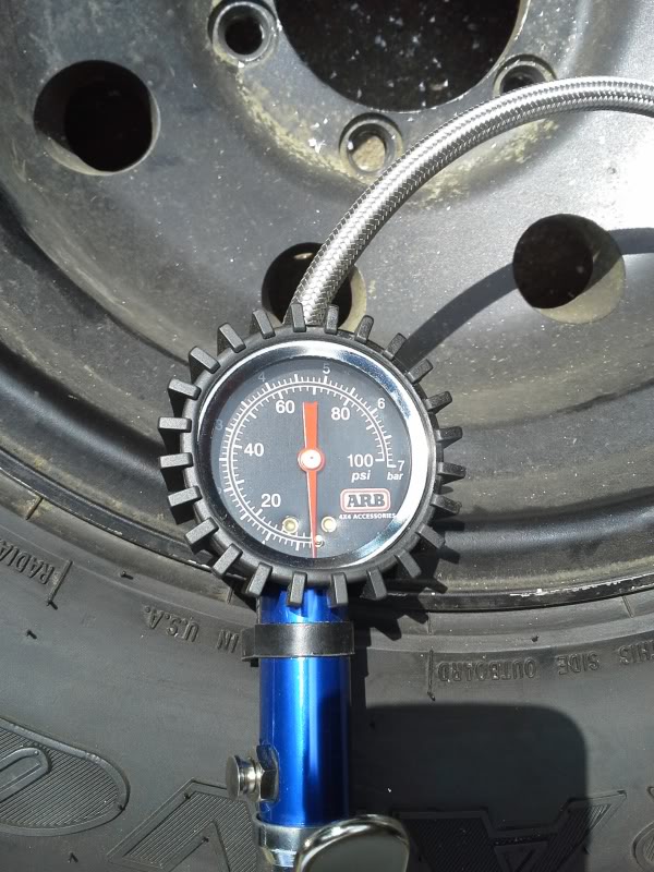

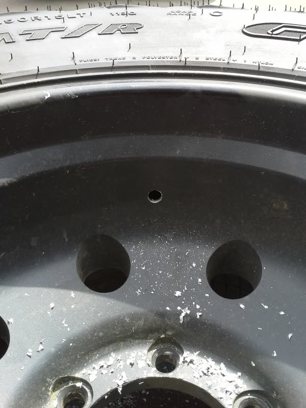

I wish I had done this before I headed to the dunes last week.
I installed my power tank mini monster tire deflators today
http://www.powertank.com/products/sf.../productID/445
Total install for four wheels was a little over an hour.
I was nervous drilling into the wheel
Found the correct 7/16" 1/4" -18npt tap on eBay
Installed
Mounted them opposite of the valve
Went from 30 to 0 psi in about 30

I was very Leary about the first one. I still have my other steel wheels in the shed in case this didn't work out.
Nice thing with the 7/16" hole in the rim it will be easy to dump in a few ounces of air soft beads. I thought I had a small scale to use to weigh them but it has disappeared. Will have to pick one up at harbor freight or somewhere.
