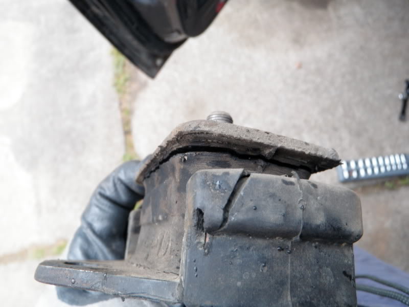

I was gonna pull my cases today and thought while I was under there I would replace my motor mounts...didn't get to the cases not enough time. I had never done motor mounts before so learned a few things which is a good thing but killed too much time>plus the rain and hail made it fun
Good thing too, stock mount looked like it was about to break, it was split about 3/4 of the way thru:

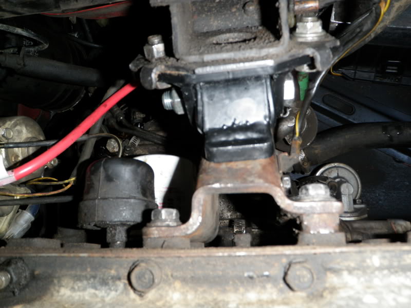

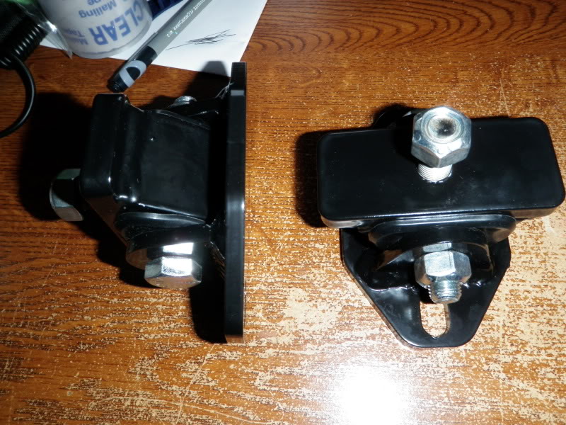

replaced them with something a bit stouter Trail Gear mounts :
wivey got these for me for my b-day. she is awesome
I like these better than alternative of welding some chain on the stock mount

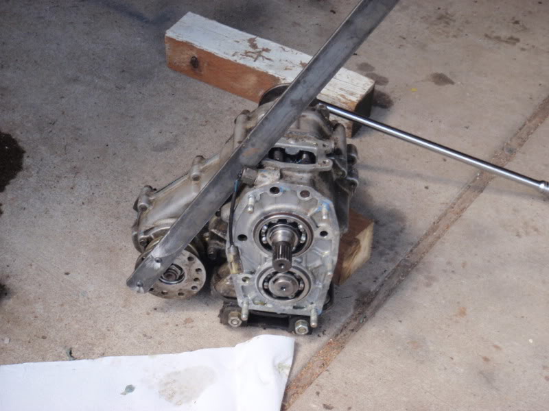

I messed around with the transfer cases yesterday, I didn't really find any smoking gun.
My home made SST to get an output flange off, 30MM sockets are too expensive to buy 2:

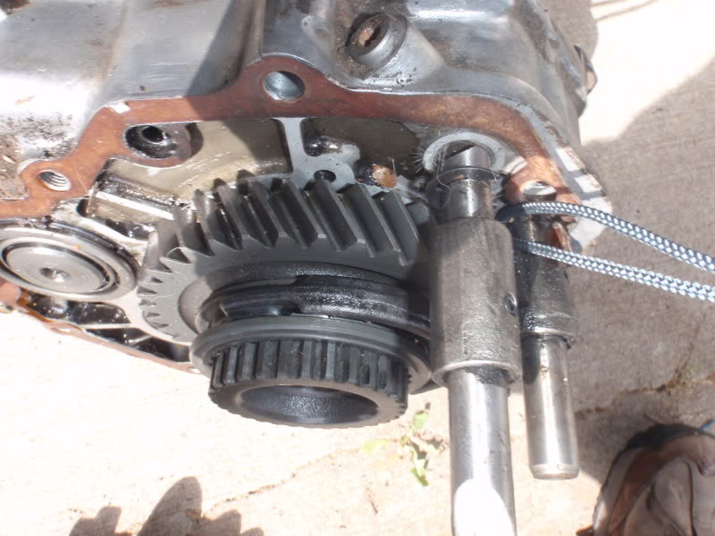

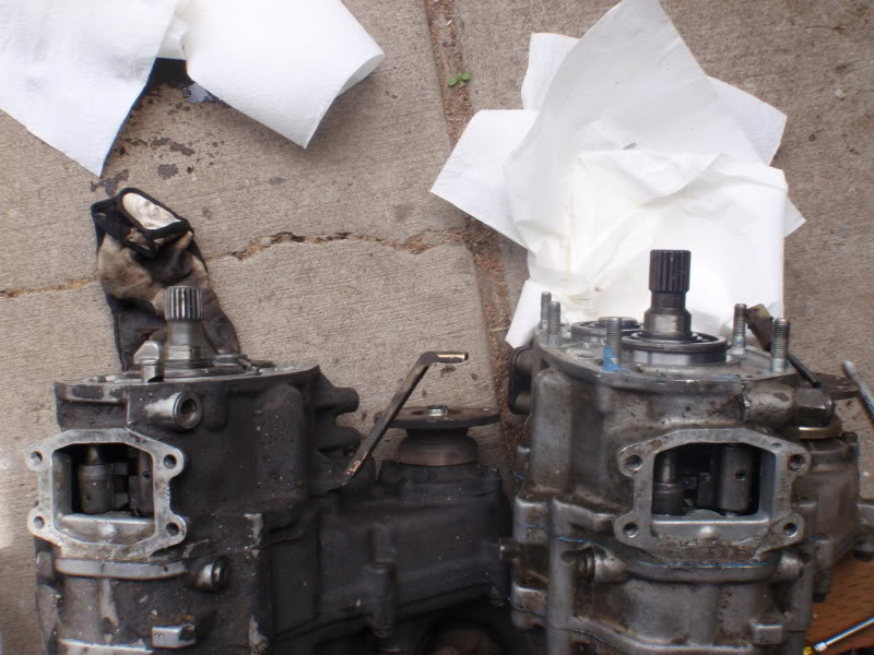

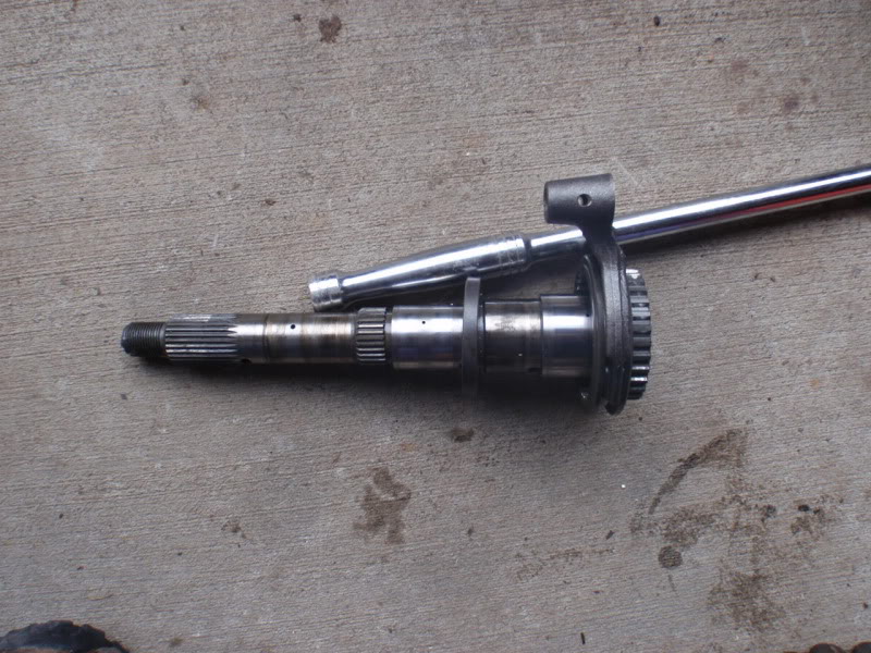

Here is what I found opinions and advice appreciated:
my 4.7 cases is on the right, the input bearing when shifted in to low range sure seems to move out a long ways compare to the stock 2.28 case on the left, the dual case adapter sure seems to allow for it due to the depth of the recess.
There seems to more play on the low range shift fork (dunno correct nomenclature:dunno) on my 4.7 case:
this pic is from a parts case I have:
How much play should there be in the hi/low range slider gear?

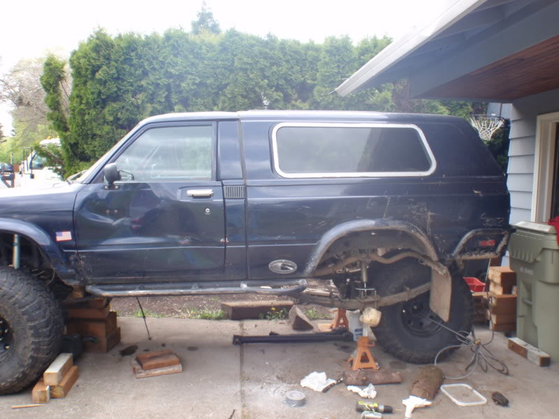

flush mounted boat lights
So with my hand semi screwed up I decided to try a light duty mod:
10 minutes or so with my Ryobi rotozip clone I went ahead and decided to mount the flush mounted boat docking lights.
Had to deal with a rusted out body strengthening panel that Winnebago installed, no much left holding this thing in:
it is supposed to be glued to the fiberglass,...not anymore
I mounted it at a slight downward angle just in front of the rear wheel well. I think that I may pull the lense out and tint the majority of the clear portion.
not very noticeable from distance:
i think with the majority of the lense frame tinted it will blend in better...
