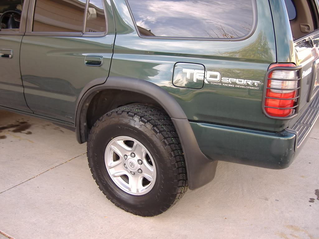

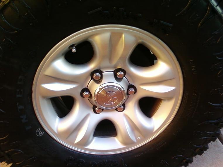

hello i have a 2002 4runner limited 2x4 with a 3inch spacer lift kit front and back, i would like to put 33x12.50x16 (on my stock rims) however all the places i have searched on the internet (for hours!!) haven't helped much so i hope you guys can give me a little info thanks it is a 16x7 alloy wheel i have up loaded a pic before the lift thx. i have put 33x11.50x16 on they fit height wise i just don't know if the 33x12.50x16 will fit with wise, to clear the upper A arm or if they will rub the A arm

I know that 285/75/16 Cooper Discoverer STT's with a 3" OME lift will rub the upper control arm. I now need to pick some new rims with 3.5" - 4" backspacing.
I would think the 12.50's will be a little close. You may have to trim the Upper As or use some spacers.

so they fit 33x12.50x16 on stock rims if any one needs the info, looks sweet

here are the pics
33x12.50x16 on stock rims with a 3 inch spacer lift! no rub cut 1cm off front fender in wheel well.

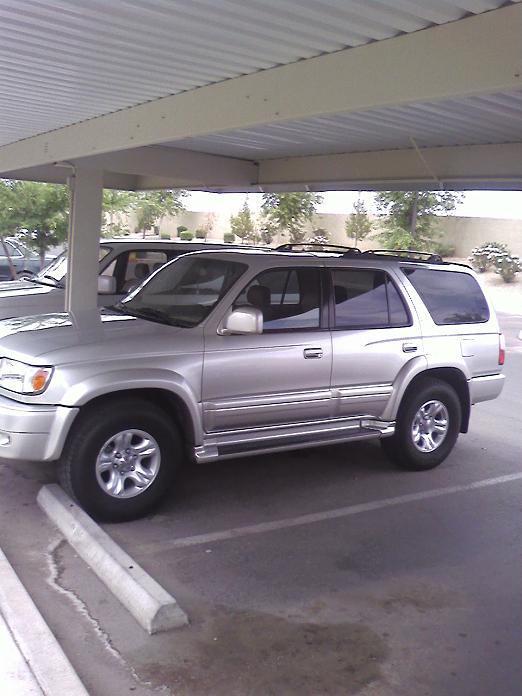

Hey guys Im new to yotatech and im sure this is out there somewhere. I just bought a 98 runner sr5 this weekend and want to put some bigger tires on it cuz i hate stock tires. Its all stock. Ive read i can put up to 265/75r15 or 31/10.5/15 on it. Just wanted to see what everyone thought and maybe if you had pics of what that looks like on a stock runner.
I was thinking of getting these.
http://www.tirepackage.com/Tires/BFG...&t_pn=BFG87961
heres what i got

uh oh.. this question again. well, we usually yell at new people who ask this, (since it comes up 3 times a day if not more) but in your case, since you have a nice rig, ill let it slide. 33x1050 is about the biggest you can go without a lift of some kind... some pounding to the inner fender welds and stuff will allow you to stuff em.

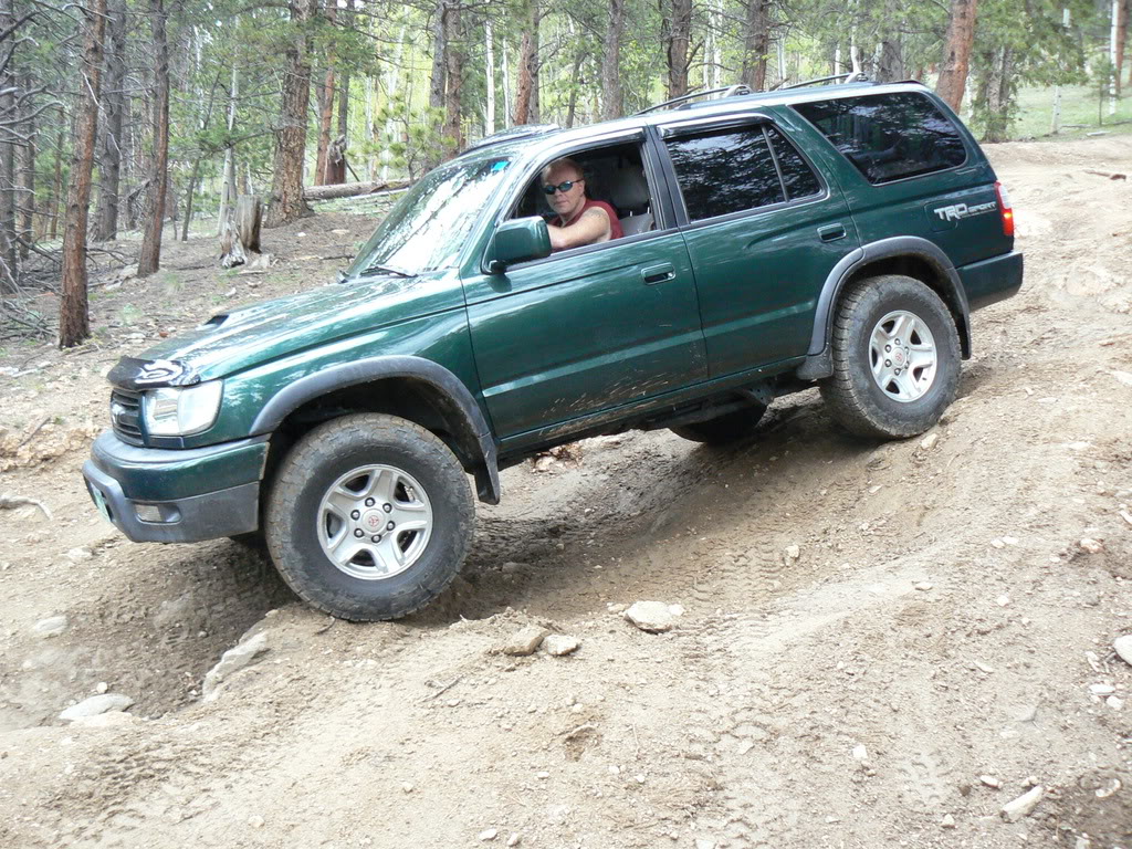

The metric size will be 265/75 on the 16" rim which is about a 32" tire.
I'll be going with my 2nd set of Nittos by summer.
