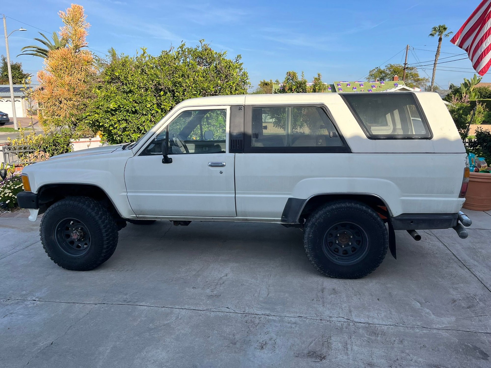

Chopped it.
Chopped it.
Old Jun 3, 2026 | 07:06 AM
wallytoo's Avatar
Joined: May 2013
Posts: 1,942
Likes: 847
From: nh
decent enough, especially if it runs and passed smog. the a-pillars look good; no rust through evident. that's a good thing. rust on the a-pillars is usually caused by failing seam-sealer in the roof gutter that runs along the top of the door opening and down the outside of the a-pillar. i have 2 1st gens on the road that i daily drive. one for winter, one for summer. both are my preferred vehicle for any distance travel; i drive each one at least once per year on a 1,600- mile round trip to the midwest. we do each way in one day, so 800 miles per day. and in truth, i almost always do an added trip from the destination in the midwest to a camp owned by family that adds another 350 miles to the total miles driven. we do this trip 3 times per year, minimum. with the front sport seats, it is a comfortable drive to make. i made the trip once in my '88 volvo 240 sedan (sold), and it was the worst road trip i've ever made. completely messed up my back, the seats are so poorly designed. sold the car a few weeks after i got home from that trip.
