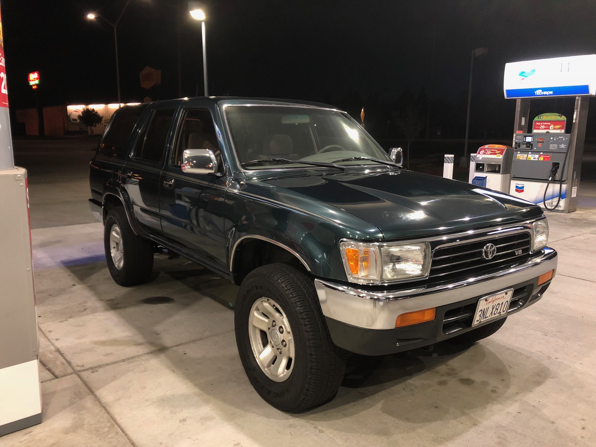

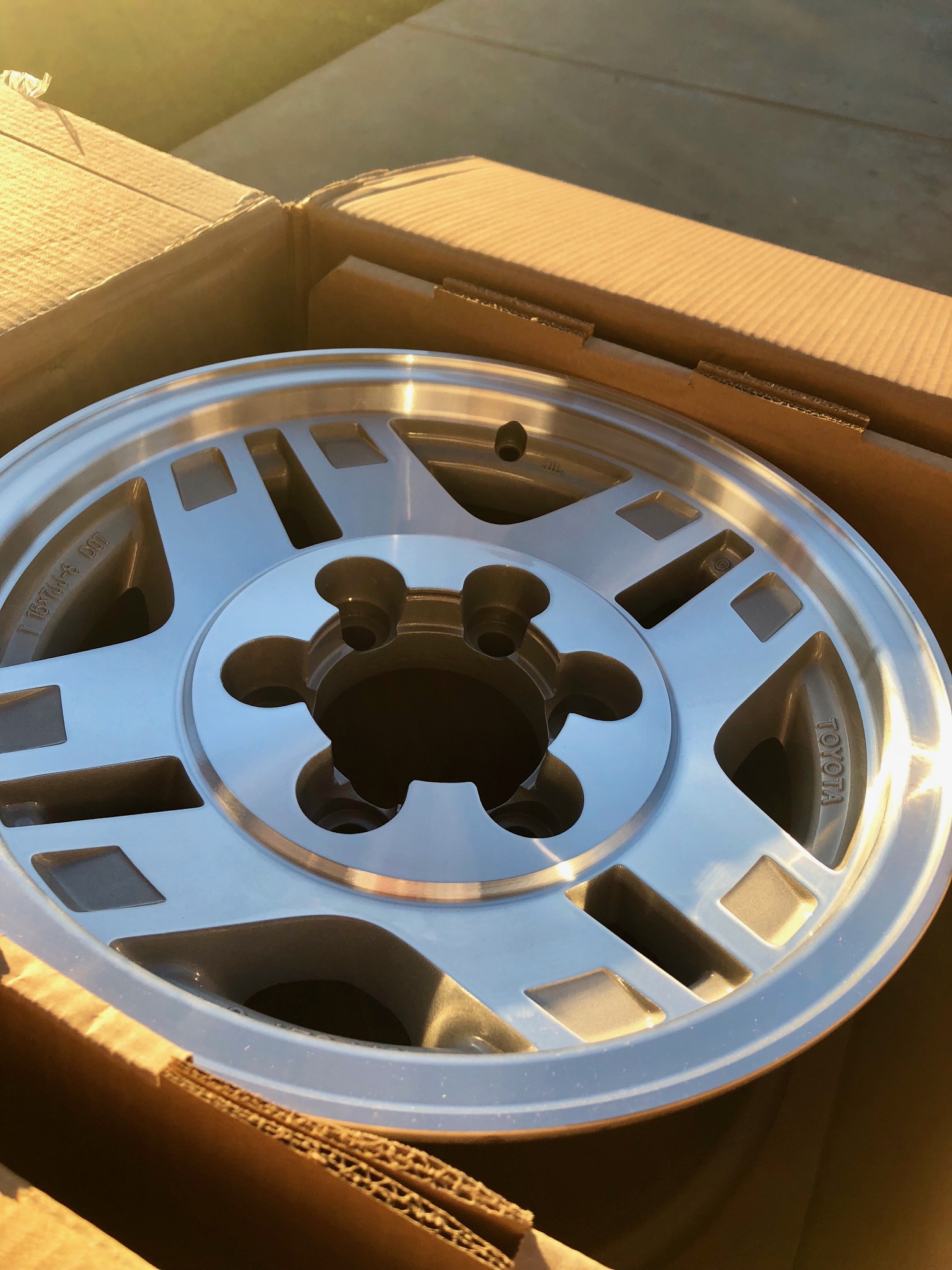

I've been reading that a lot of guys here fit 32x11.5's on their 2nd gen Runners without any rubbing issues. BUT, I went to a local tire shop and took took some measurements with one of the techs working there and he was saying that it looked like 32's would probably rub without a lift. Can anyone give me any advise on this? Because I was under the impression that 32's on OEM offset 8 wheels would fit no problemo.
My ride is a 95 rwd with Rancho 9000's and cranked torsion bars. Any help on this is appreciated because I want to buy tires in the next couple days. Here's my Runner and the wheels I'm putting on soon. If you can't tell from the pic, there's no sag in the rear. Edit: I'm riding on 265/70 16's right now
