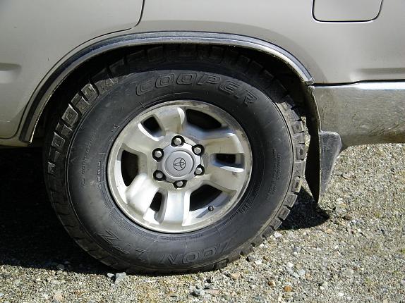

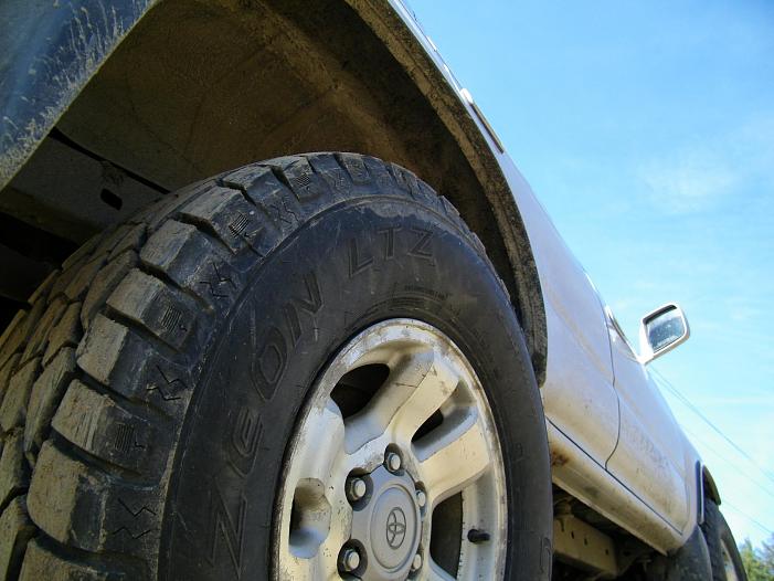

265 75 r 16 e-load cooper ltz
I have been riding these tires on my 3rd gen for over 6 month and love em, sort of a hybrid all terrain and mud/snow tire. I have had my stock suspension completly flexed with no rubbing what so ever.. hope these pics help.
