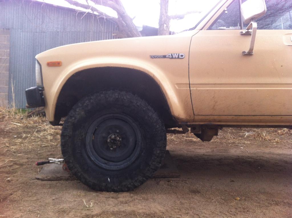

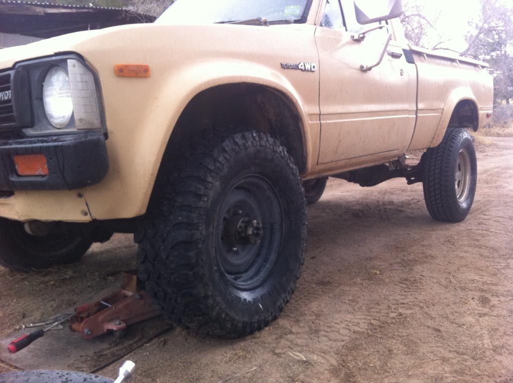

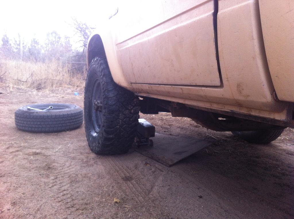

1980 short bed 4x4. Stock suspension, stock steel 6" wide wheels. BFG 32x11.5 mud terrains. Sitting still everything clears lock to lock. I'll prob have to clearance the pinch weld but will do that after i figure out exactly where.
Headed back to get the other 3 mounted today.

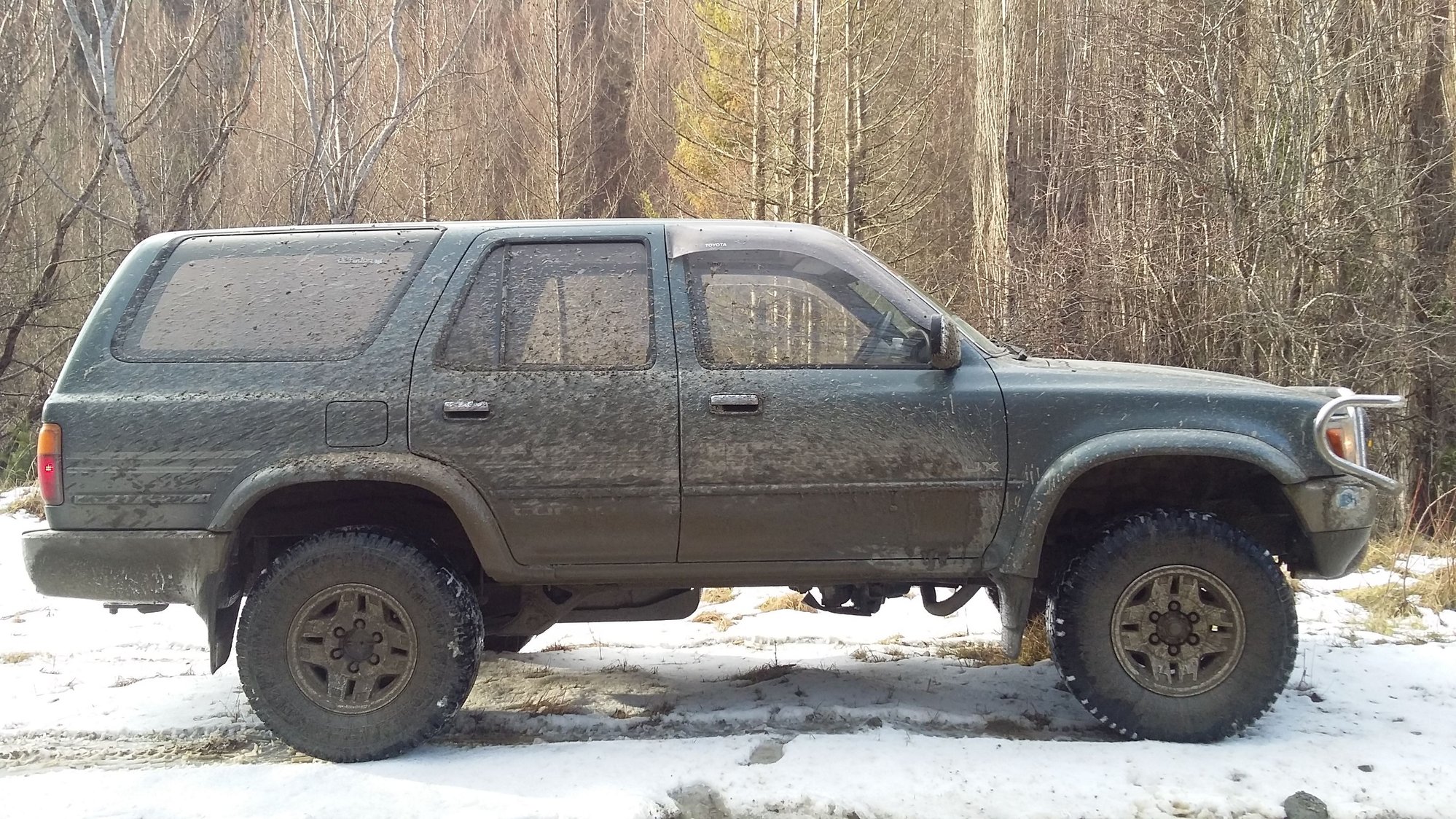

hey guys hope this hasn't been beat to death but I cant seem to find the answer, my 98 Tacoma has a 3" bilstien lift from toytec , i'm currently running 31x10.50x15 on stock rims no problem, I don't think I have room for 33x12.50 and 33x10.50's are like hens teeth, I bought a set of factory 17 " wheels from a newer Tacoma and was wondering if 285/70/17's would be rubbing the upper control arm, if I would need spacers, or if I should just go with 32/11.50x 15's and sell the 17's, thanks mick

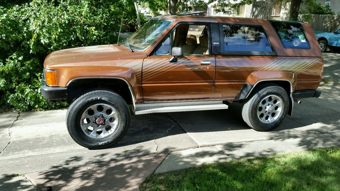

1987 SR5, 22re. Newer FJ Cruiser wheels, P265/70/r17's
Stock FJ wheels, P265/70/R17 tires. Slight rub on the running boards at full lock. Going to remove them soon!
87 SR5 running stock FJ Cruiser wheels and P265/70/R17 tires
