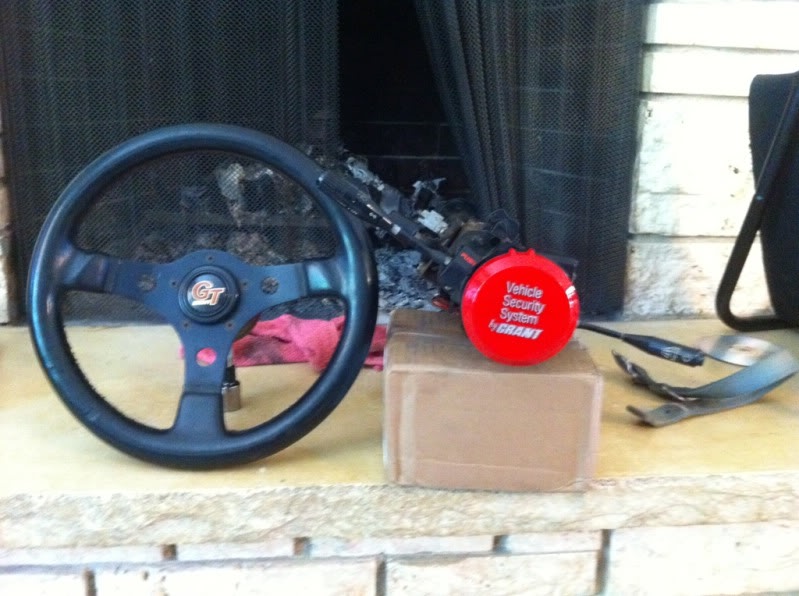

Grant Removeable Steering wheel
Originally Posted by irab88
ooh... thems look comfy! are they bolt-in, or how much would you have to fab?
They are comfy they will take a little bit of fab work, not much. The out side bracket will need to be tweaked up to horizontal. The other 3 mounts are horizontal. it will be pretty straight forward.
Trucks seem to disappear on a semi regular basis around Portland..local member gary_the_4runner was lucky enough to get his 4Runner back a few weeks ago.

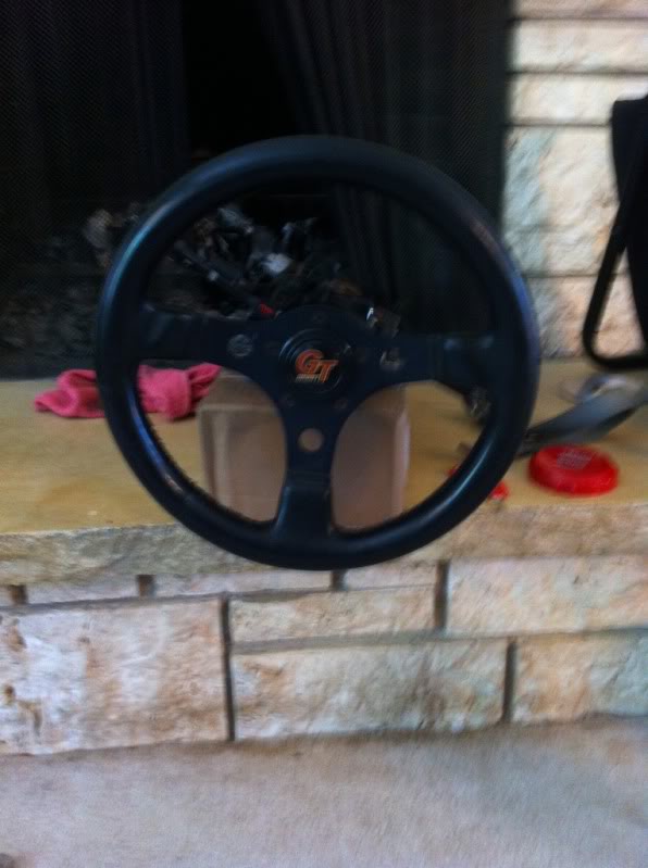

I have a couple of other methods to slow down/deter Oxygen Thieves but thought since TrekkerPaul gave me a Grant Steering wheel out of a truck he was parting out (BTW Thanks)
I would pick up a Grant Removal Mount. Cheapest place I found was from Jegs. Ordered on Friday, got here today(tuesday) awesome service IMO. About $50 lower than Auto Zone and $90 cheaper than Grant's List price of $215
I had an extra steering column that dunno why I tried it there first...anyway, install is easy..take about 10 minutes. Only thing is the horn wiring is kind of funky...I will probably do a floor mounted Dimmer switch as the horn switch because mine only worked intermittently anyway..
remove the stock wheel.
put the vehicle specific adapter on
put the locking adapter
put the wheel on the steering wheel interlock with the wheel..

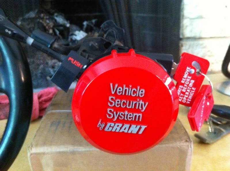

put the key into the unlock position, push down turn wheel slightly to the left and it is off:
put the big bright red thing on to make it obvious to Joe Tweeker that he isn't just gonna hop in and drive your Junk away:

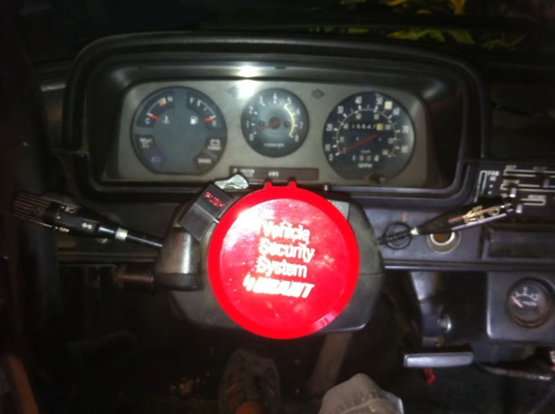

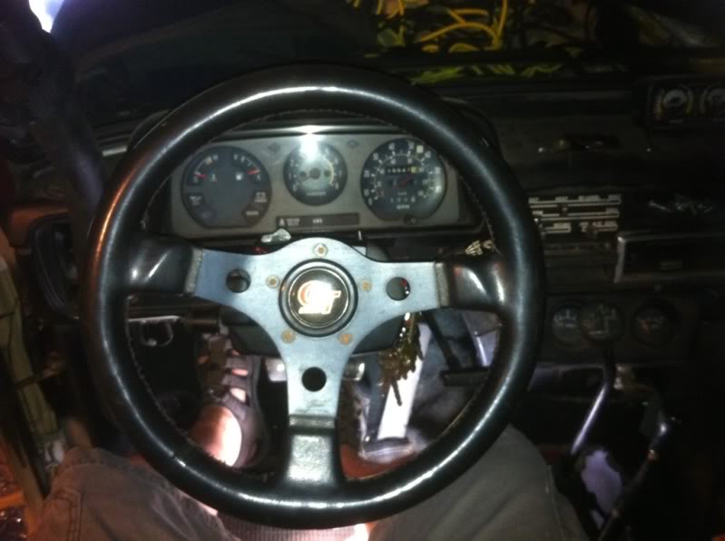

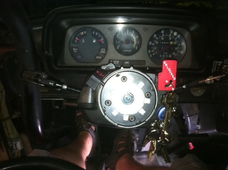

Put the Grant Removeable steering wheel security thing in today:
Put the key in, a slight turn to the left and pop off the steering wheel:
Put the Red 'can't drive this one' warning in:
I think this will be a great way to help me keep my truck around...

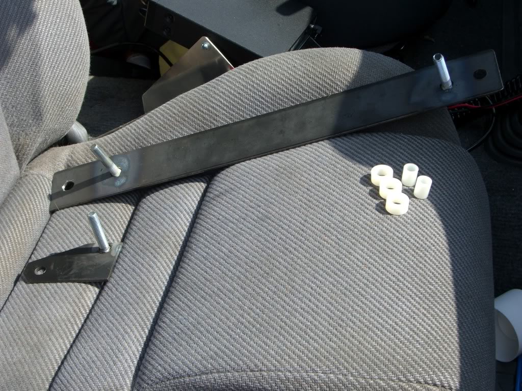

found an idea for mounting my prelude seats used by SCToy:
Originally Posted by SCToy
I opted not to drill holes in my floor, so I used the original mounting holes and put some new studs that stick up out of the floor using this stock steel.
will use something like that..

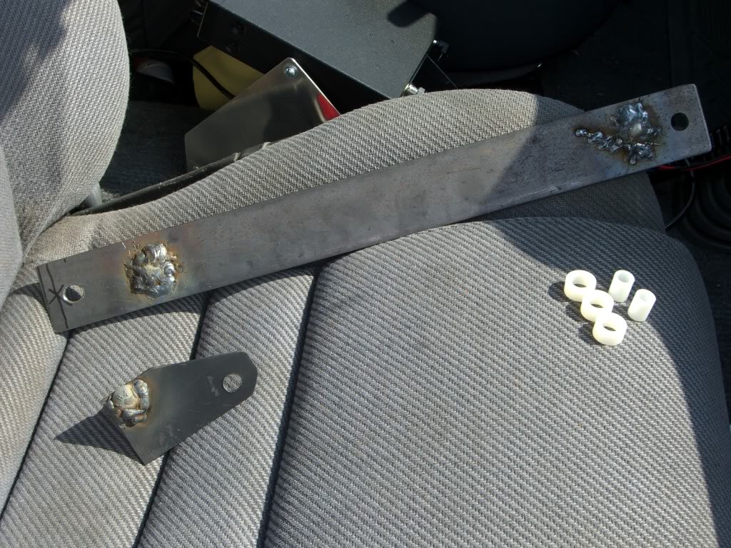

i welded carriage bolts sticking up, as to minimize how much the bolts or studs stuck up in the back

thanks Ian-that is another idea. are those hardened at all? I kind of like using grade 8.
Old Aug 31, 2011 | 06:33 PM
  #696
irab88's Avatar
iTrader: (4)
Joined: Jul 2010
Posts: 6,499
Likes: 37
not hardened at all. just grade 5. you can use grade 8, but i've never ever had any issues with grade 5. (that's after a fender-bender, a day of off-roading, and a couple thousand miles. oh, and all weights of people)... grade 8 would be nice, but you'll be hard-pressed to find grade 8 carriage bolts. i found them in either packs of 500 for $300+ or non-existant. that's the main reason for not using grade 8.

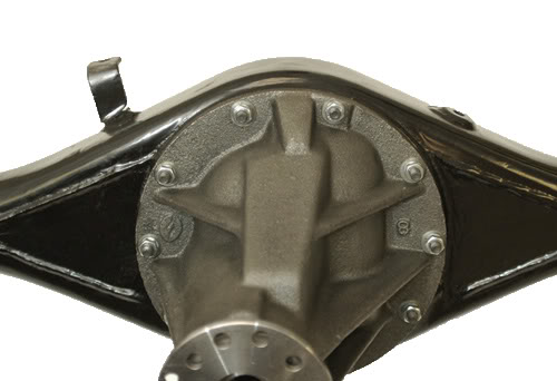

IFS Rear end Prep
picked up an IFS rear end from TrekkerPaul and did the tear down this afternoon.
I had heard of the studs for the third member unscrewing before but never had it happen to me before:
i will either order one of these diff stud eliminator kits from T-G
but the local Ace Hardware has an awesome metric selection so I will probably be able to do my own for about $10-12
pulled the axles and at first thought frigging great, bearings are crap:
turned out to be some very fresh grease used when the bearings had been replaced recently...cleaned it up and they are in awesome shape
the e-brake pivot moves very freely. I am half way tempted to check the conditions of the brakes and maybe just run the IFS axle as is (with my 5.29 third of course) the 86-95 rear drums are massive compared to the stock 1st gen drums:
yes, somebody pried on the backing plates, but it appears to be a BFH'able repair..
I need to get off my butt and get the rear disks mounted sometime though...
