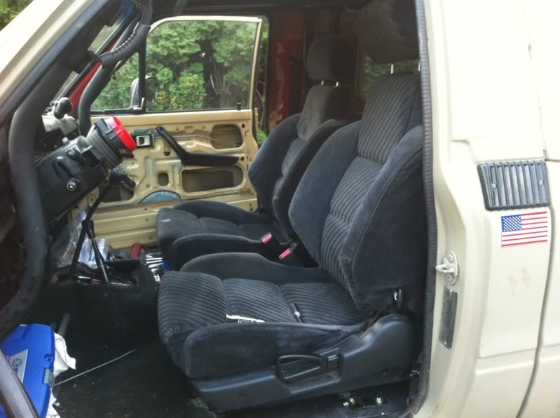

Talking Prelude Seat Install
Got some time to finish up my seat install. These things are very comfortable.

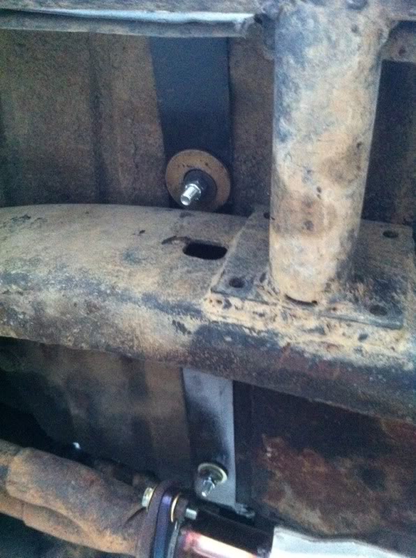

I used 3/8" 1.25x1.25" angle and just bent the front mounts to a 90* and was able to use existing holes:
Full plate across the bottom:

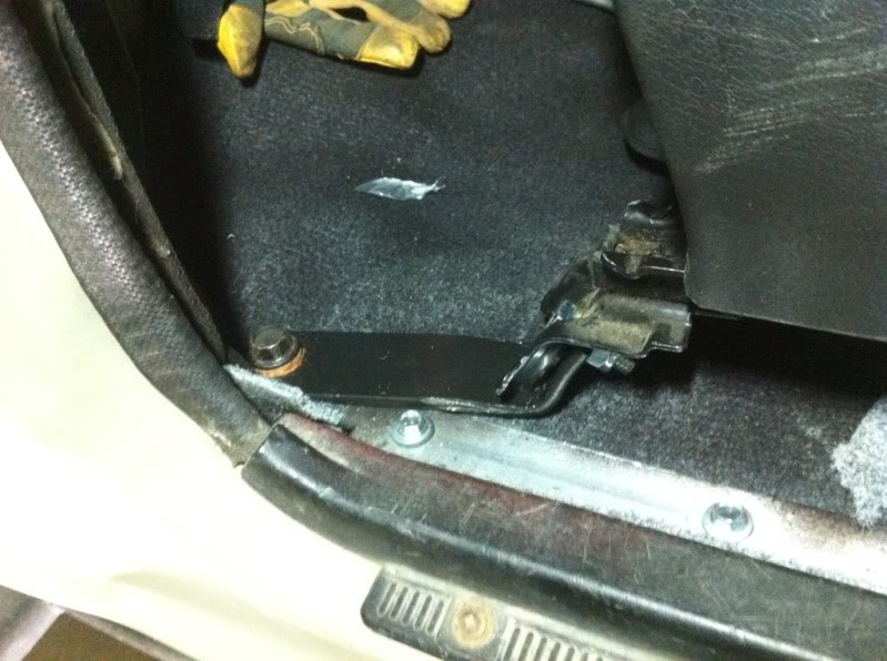

For the outside corner I tied it into the seat belt lower mount:

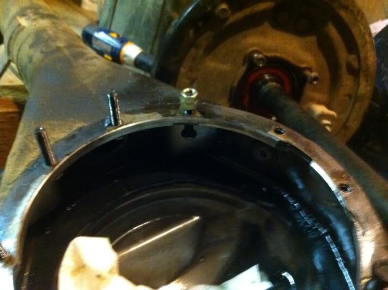

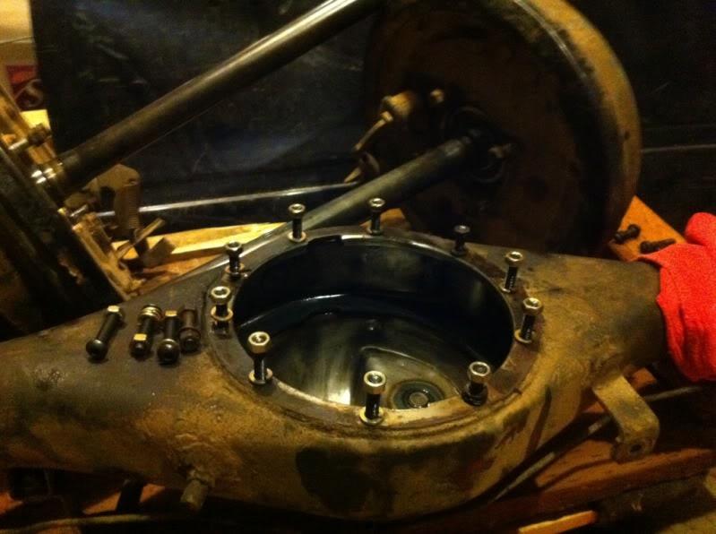

Instead of ordering the diff stud kit from T-G I was able to get the stuff at Ace Hardware for $8.70.. Took about 20 minutes to install.
Double nutting it proved to be the easiest/fastest way:

Originally Posted by 1986yota4x4
seriously? damn, got any pics?
Don't have any pics. TrekkerPaul has met him before if it is the same one I am thinking of.

Those seats look sweet! I like to aggressive bolstering. If I had to fault my Accord seats for anything it's the lack of bolstering. But then again the Accord isn't a "performance" car so I can't complain. They are comfy however and I LOVE my armrest.
Nice job scoring the hardware at ACE!
How's the eye?

eye is still a little sore. The patch was a 24 hour deal, now it is just ointment for the next few days.
The bolsters are what I really like about these seats. My old Montero seats had an armrest but it kept nailing my side out wheeling.

stud kit: 8 out of 10 studs pulled out when I pulled the third from my IFS housing. instead of trying to lock tite it and have the possibility of them coming loose down the road I went this route..I have heard that with time they can work loose and end up leaking..

how does the diff stud eliminator kit work? seems liek it would be harder to remove the nuts if its just a bolt there
you put them in from inside the housing..just replaces the stud...

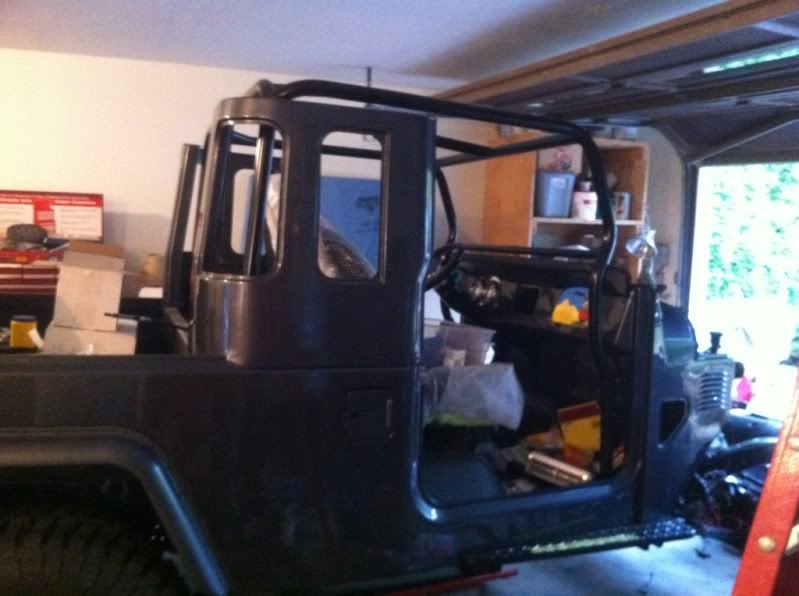

My next door neighbor looked at them, he thought they would be ok, just have the one bearing pressed down.. Dunno
Here is the truck he is working on-FJ40 stretch 20" with an LS1:
He s
