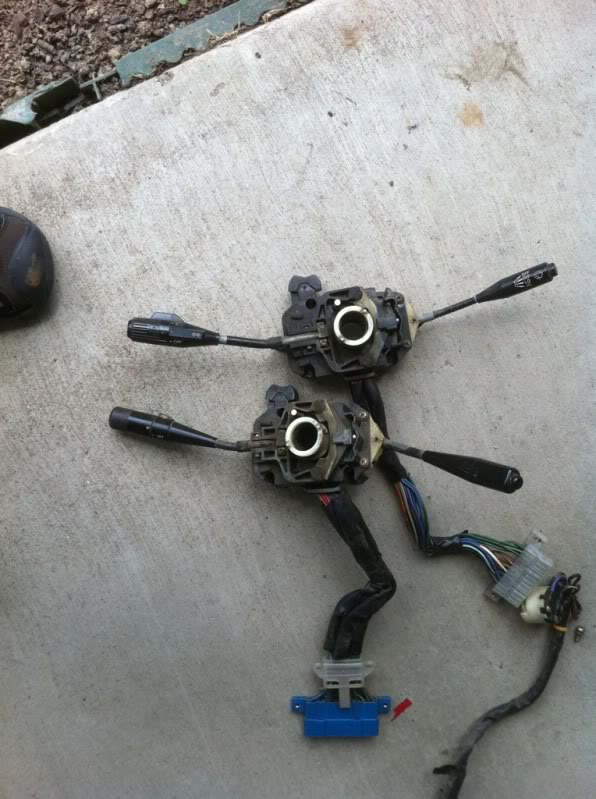

with a few local members having their trucks riped off by some honesty challenged individuals I decided to try a more extreme method of theft prevention:
though they might look the same, not all 1st Gen wiper/light switches are created equal

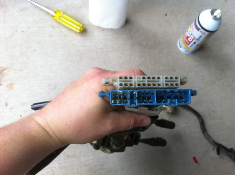

81 plug in is on the top, 82-83 is one the bottom...

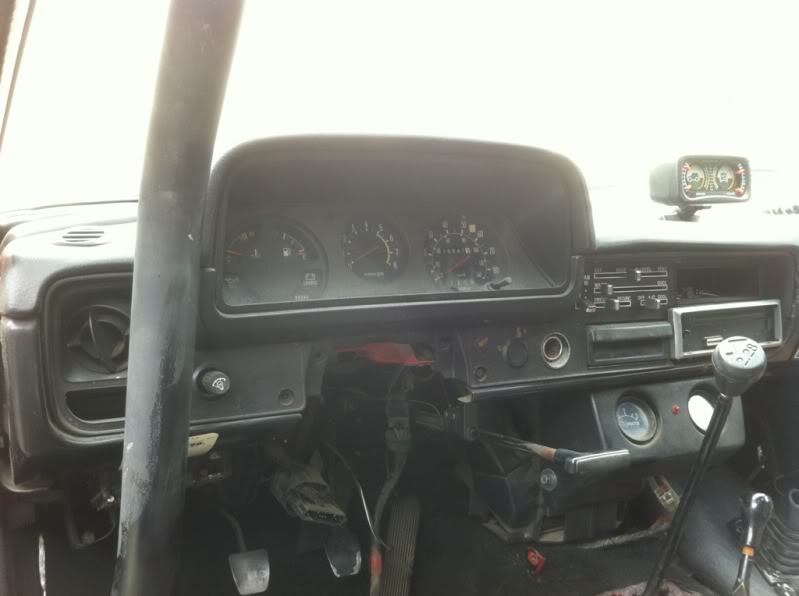

Finished swapping out my steering column and added the early Supra steering wheel.
My old columns tilt mechanism got stripped out wheeling a while ago. It is nice being adjustable again
Not sure if I like it or not. I need to touch up the emblem a little.
It is in much better shape than my old one.

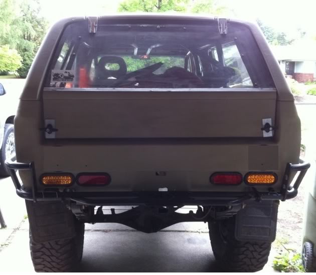

put the rear bumper back on finally--chopped the mount for the swing out and left the latch mount on the left so I could either use it for a flag(dune running) or a CB antenna mount. Neither one would block the left turn signal much
with the bumper back on it doesn't look quite as funky as it did before....still not sure if I like the 4" back up lights or not. it would be easy to fill in the hole again...
**Open to opinions, I know someone mentioned it looked like a truck in district 9
either way I need to either get on IFS rear end or throw some wheel spacers on the back...too narrow in the back

honestly, in my opinion, it looks great either way. i like the rear end as a whole. keeping the lights in would not hinder the appearance, nor would removing them. however, if you removed them, wouldn't you still have to put some on somewhere?

Ian: they have kind of grown on me...without the rear bumper mounted it looked wierd to me. I just need to wire a relay inline with the lights, these things are at 35w or so, they would burn up the stock circuit.

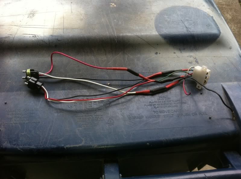

had a little time and was able to get the rear lights wired up.
sacrificed a couple of cracked housings to get the connectors:
the loose wires are for the back up light, I need to use that wire to power a relay.

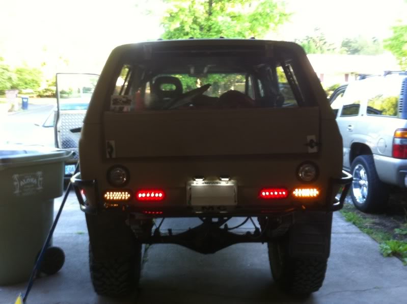

Brake Lights:
license plate mounted with some LED's from superbriteleds.com
I am debating about getting a set of 24 LED brake lights to match the turn signals..

what do you mean by "a set of 24 LED brake lights to match the turn signals"?
on the flasher: good choice
and those amber lights look a little dim to me (maybe it's just the lighting?)
Old Jul 18, 2011 | 08:41 PM
  #676
dropzone's Avatar
Fossilized
iTrader: (6)
Joined: Oct 2005
Posts: 19,771
Likes: 456
From: PNW
was just thinking i would match up the red and amber lights..brakes have 6, t/s have 24
the amber ones are set up as a tail light and turn signal, they are much brighter when they flash.
