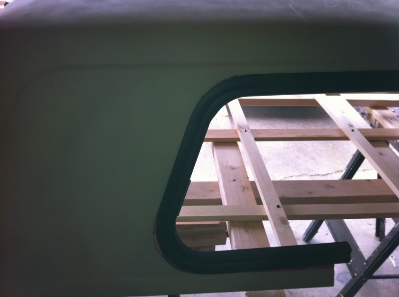

Cut down the window frame. Happy that the frame fits the existing curve:

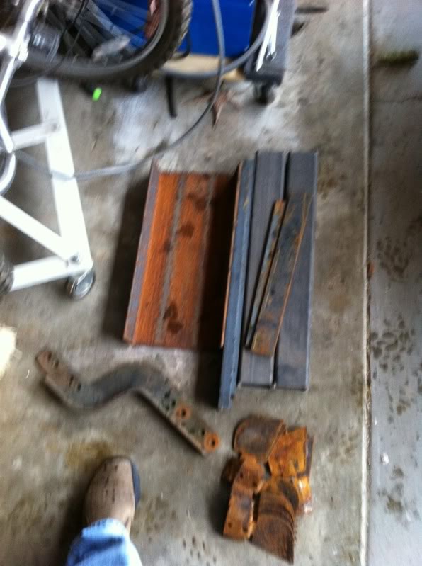

Borrowed some stock bumper mounts from TrekkerPaul to get an idea for the curve for my new mounts. I am thinking about using the big channel.. Should be able to get both mounts out of it.. Misc stuff to use for bracing:

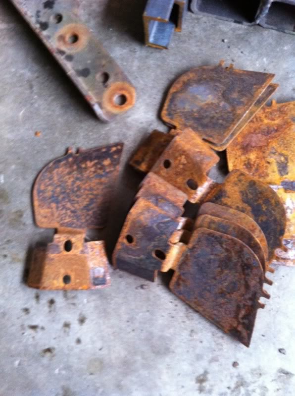

Also scored 10 things I can cut down for misc light mounts:
$14 for scrap.. Price went up a little but it should clean up nicely

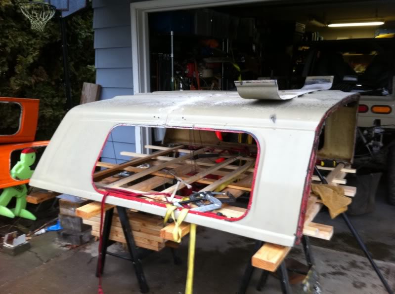

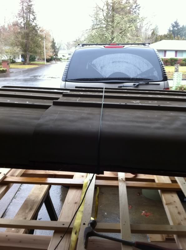

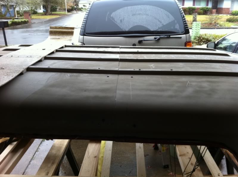

Finally got off my fat butt and finished cutting the top. A little to wet and chilly to start the fiberglass
Used 550 cord for a straight edge
Cut came out Good, the overlap method worked like a charm
Added some Bracing underneath, will Glass the top first
Window opening will end up around 36"

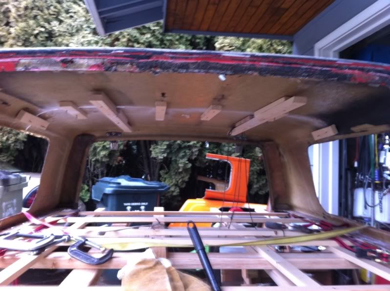

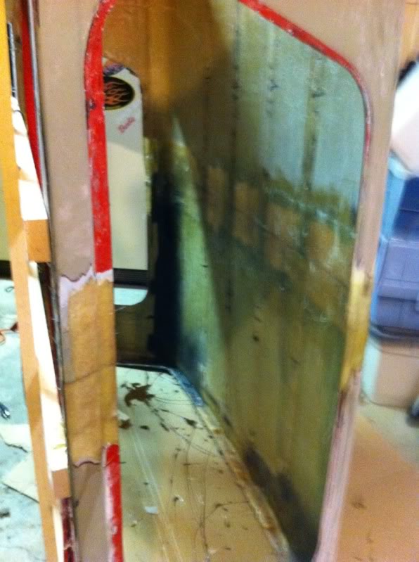

Moved the top in to the garage and put a couple of layers of fiberglass on the outside and inside:

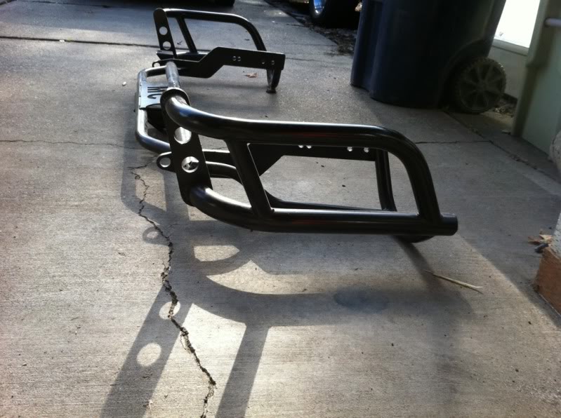

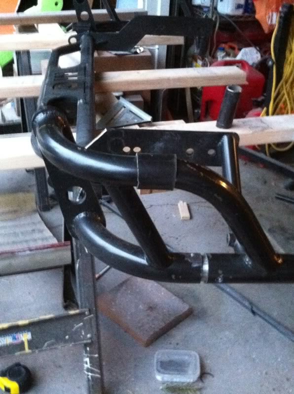

The cold is making the cure time take forever.. With the fumes filling up the garage and not having any luck selling my Marlin bumper decided it was a good time tO play outside:
Some how 7" showed up missing:
Need to trim the mounting bracket a little more and find some 1.25" tubing to do an inner sleeve for the upper tube..

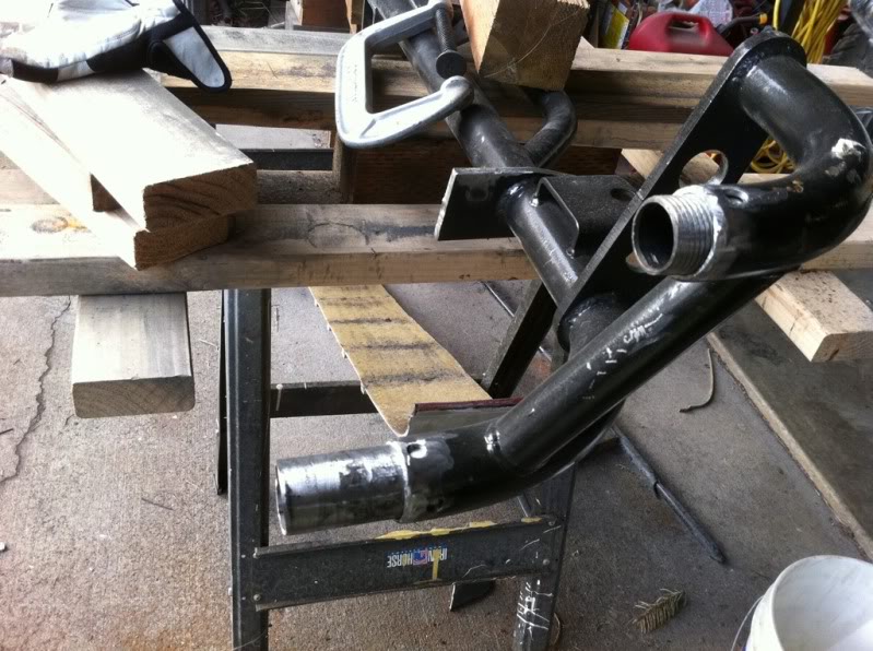

Got one side done.
My welding skills are far from perfect but am happy with my 1st time welding tube.
I did an internal sleeve with rosette welds on both upper and lower tubes.
Going to have someone with a real welder to help me with the brackets.

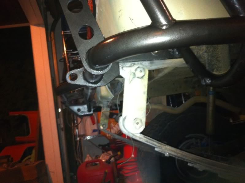

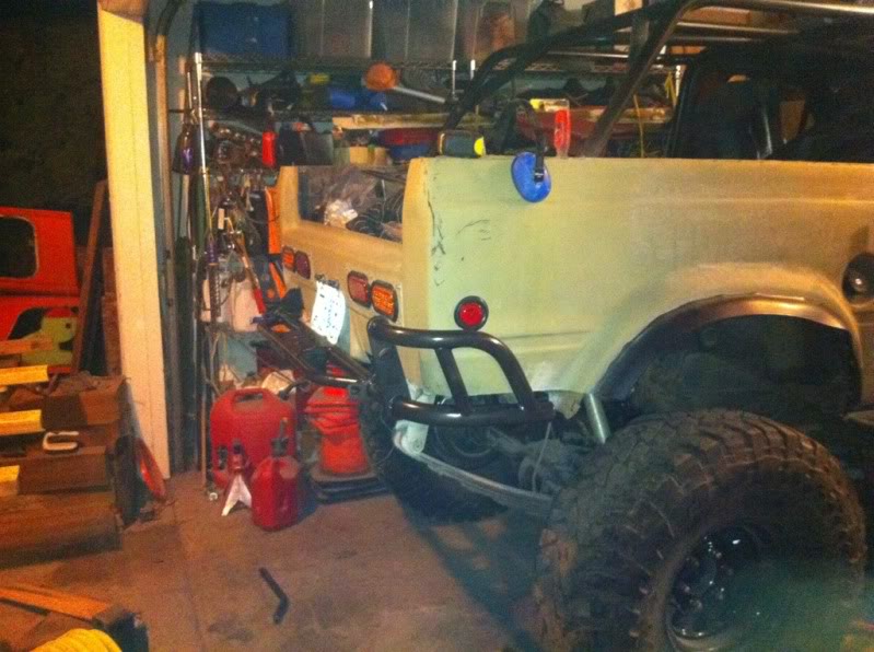

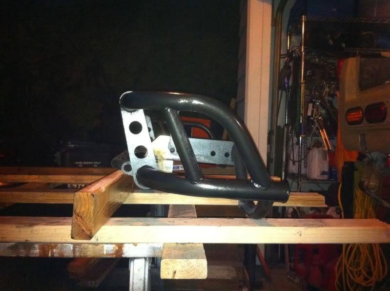

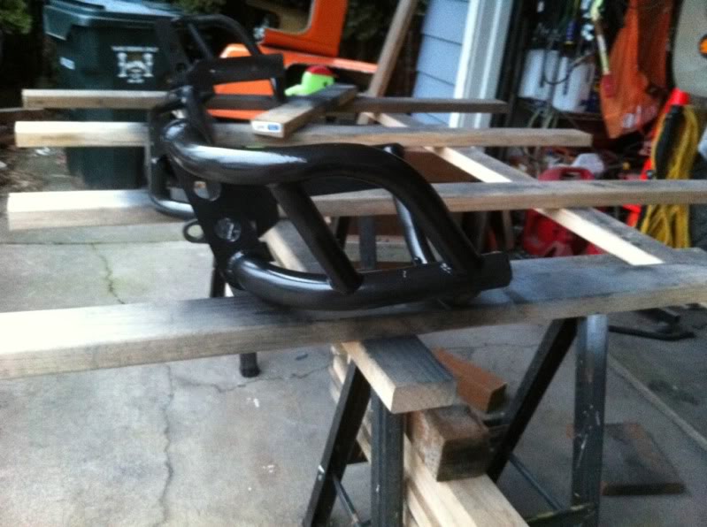

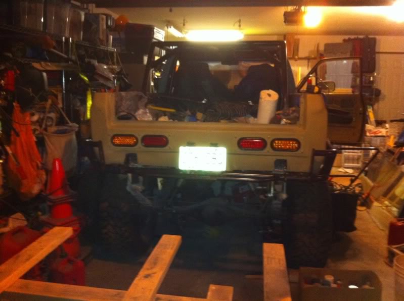

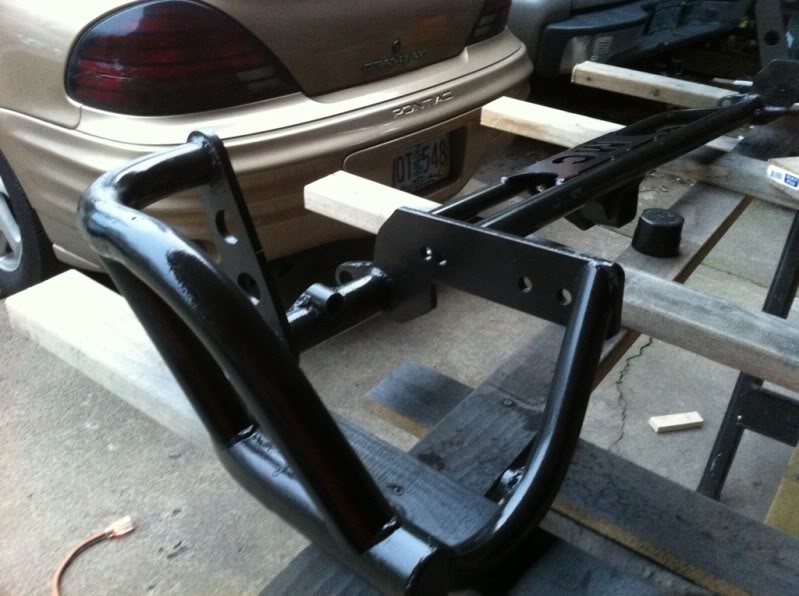

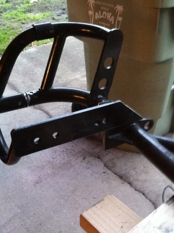

Wrapped up converting my Marlin Crawler bumper into the short bus edition.
TrekkerPaul fired up his 220 welder to do the bumper mounts, thanks Paul:Bigok:
Should have enough clearance for the rear shackles:
