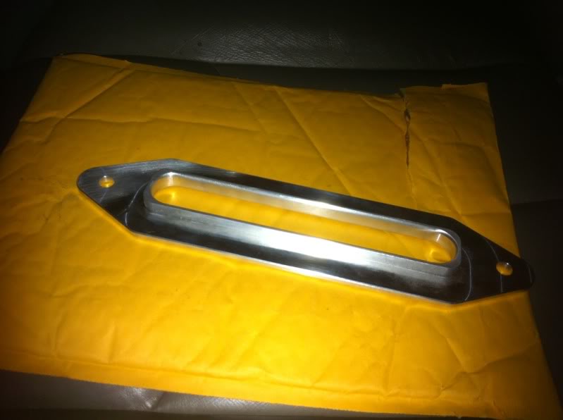

Synthetic Rope Fairlead liner
I don't even have my winch yet but when I saw Rory's thread for a liner to protect synthetic winch cable I thought it was an awesome idea..$26 shipped to the door..awesome

now I just hope Santa brings a winch to go along with it.
Thanks for the quick shipping Rory

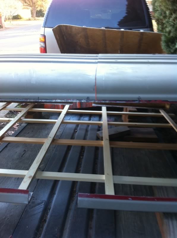

I picked up a bunch of 1x2 today to build a subframe to hold this thing together for the cut..should be able to pop the windows and start on the subframe tomorrow afternoon..might start the cut friday.

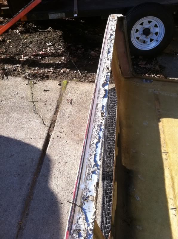

The bottom of the top had a crap load of butyl tape/adhesive still:

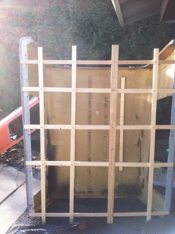

Built a frame out of 1x2 strips to help steady the top and keep it the right width:
Started the cuts:
The framework seems to be doing it's job.
I can flip it over now, not at flimsy as it would be with out it.
Just have to undo a few screws and can slide it forward...
Hopefully be able to make the real cut tomorrow and maybe start layer of glass but with Christmas this weekend have a lot of misc BS to take care of..

Robb, lacquer thinner does a great job at removing the butyl tape. I learned that redoing my camper. Looks good.

TinMan-thanks, will give the thinner a shot. Got most of it off with a heat gun and putty knife. The thinner will probably do the trick for the residual stuff..

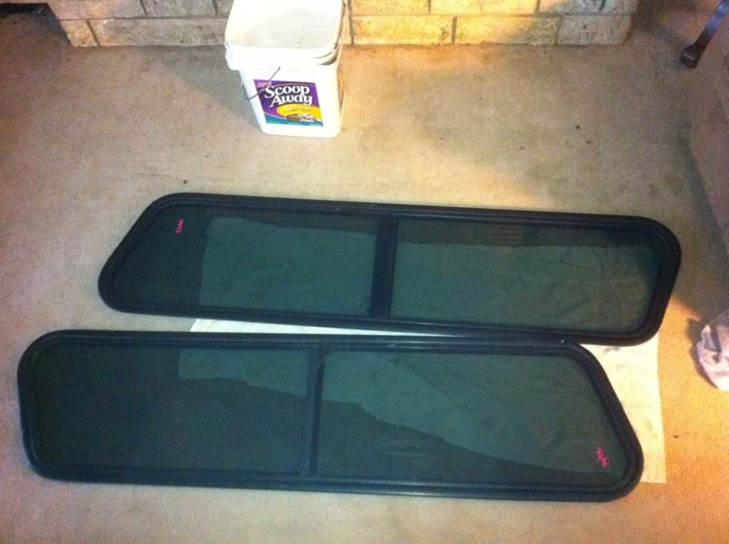

Not much of an update but picked up a set of sliding windows at pick n pull today. Too long but I will cut the frames down to about 38" or so.

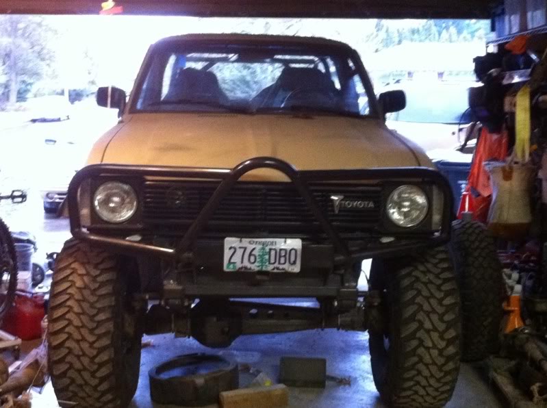

Hit TrekkerPaul's used parts emporium for a 2WD grill. Mine was toast and saw a truck on pirate with one and thought why not:
Before:
