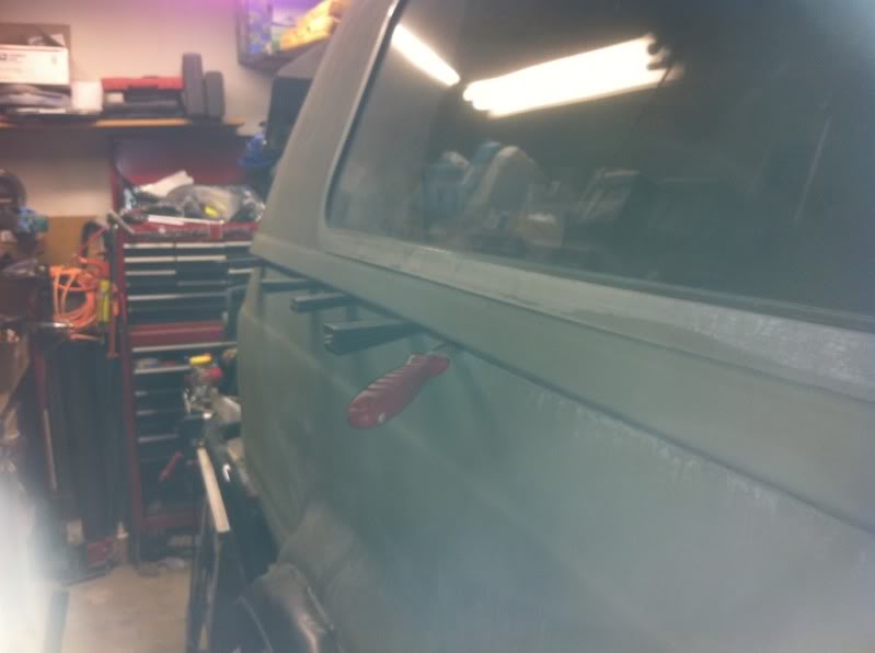

Winnebago used bolts, screws, rivets and some insanely sticky butyl tape..
Using a combination of putty knives, utility blades, pry bars, grinder and door shims got the POS off:

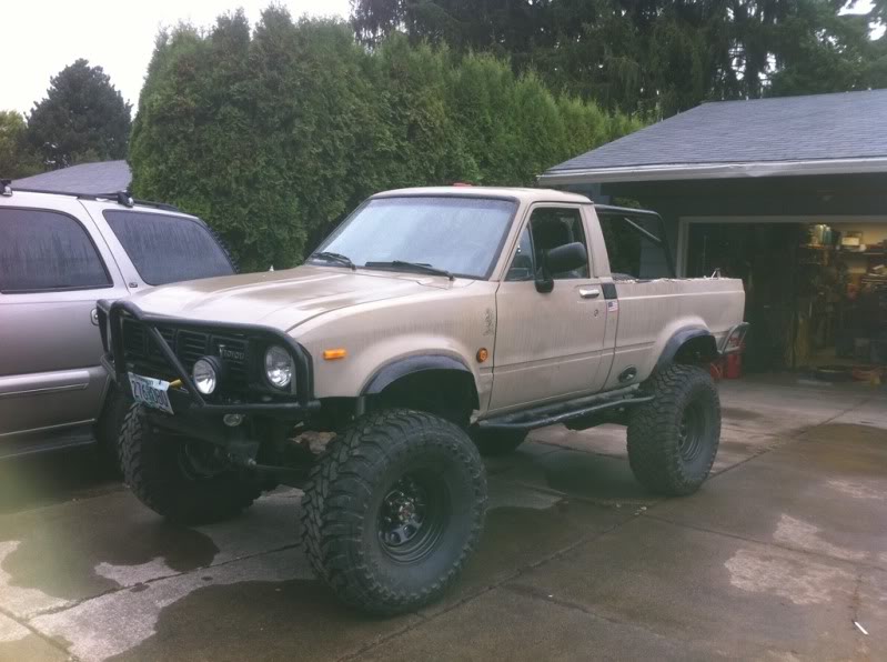

I was happy to find minimal rust around the cab:

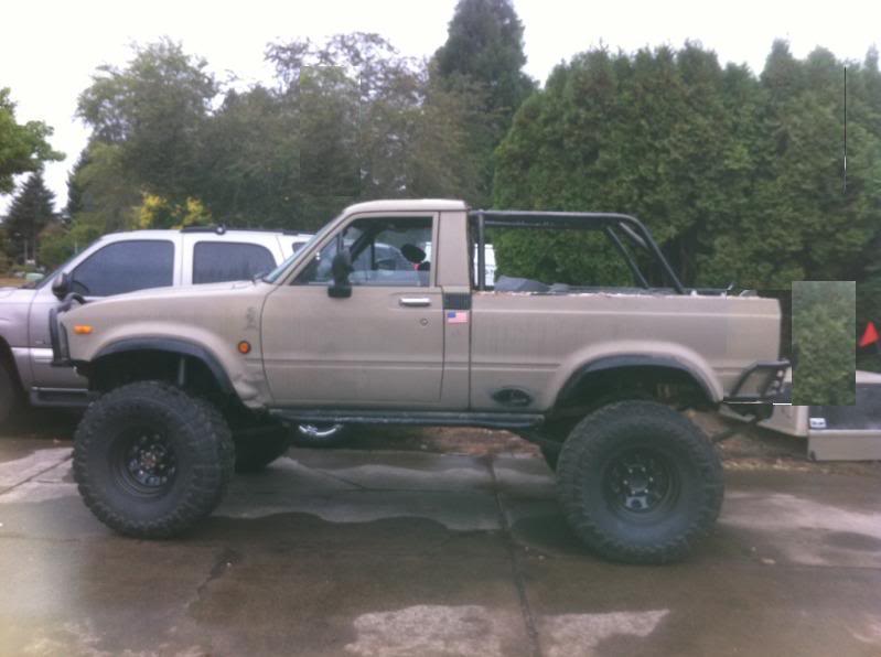

I think it looks pretty cOol with out the top. My plan is to add some nutserts or similar attachments so I can take the top off on a regular basis like a 1st Gen 4runner:
Having the top off will allow me to get 360* welds on the cage and to get paint on all of the cage.

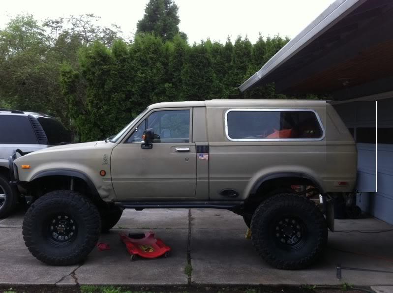

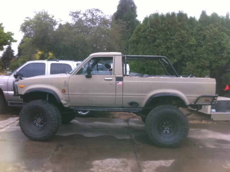

kind of playing around with the idea of bobbing the trekker:
need to take some measurements but I think I can get 9" out from behind the rear wheel..
