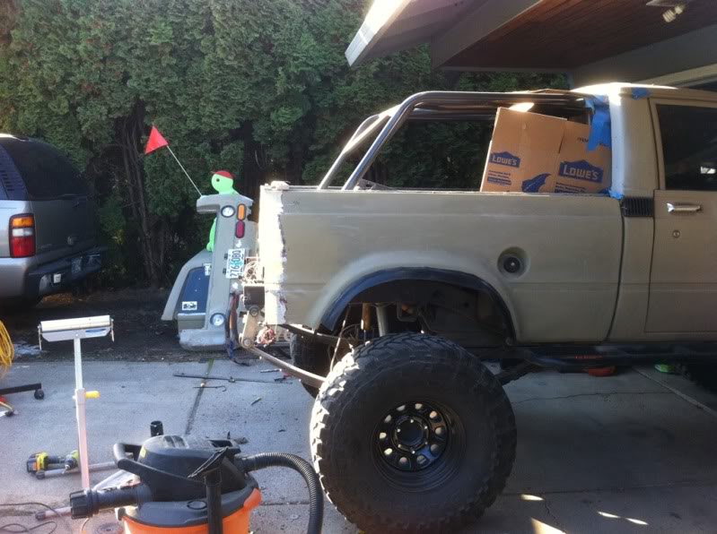

Ok on to todays progress:
Got a late start but measuring a few times, forgetting about a body mount and having to rethink the cut ended up better in the long run.
Still got 8" out of the bed and about 2-2.25" out of the frame. Not as much as a lot of guys get out of their bob.. My spirings are 9" longer than stock.

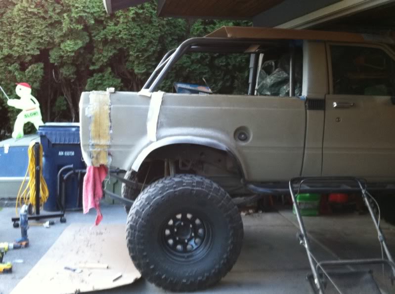

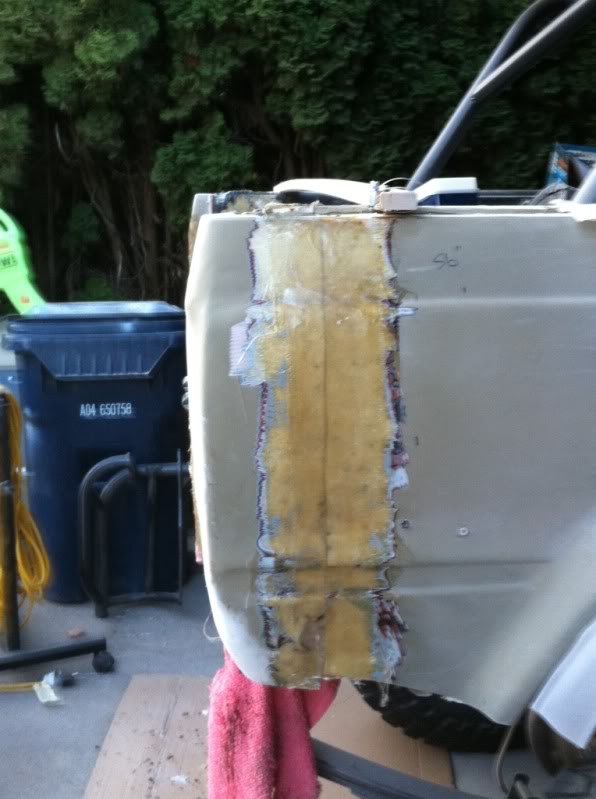

Sanded down about 3"+ on both the inside and outside of the bed where the tail end section will be put back on

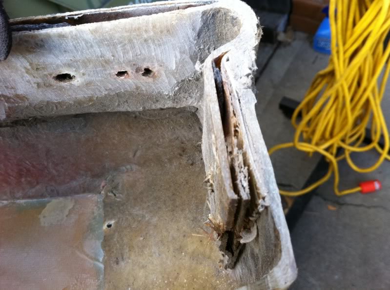

A little Winnebago trekker trivia is that they sandwiched a Metal plate in both side of the bed. Even though they appear to have been enclosed by fiberglass, the metal was just chunks of rust when I cut through:
Weird though that the floor of the bed has expanded metal in it but it is not rusted

You wasted no time! Interesting on the metal incased in the fiberglass. I can only conclude that it must not have been air/water tight at some point allowing moisture to build up.. Thats my guess anyhow.

I agree on the rust issue. It will be Monday before I can touch this thing again...I work a wierd schedule

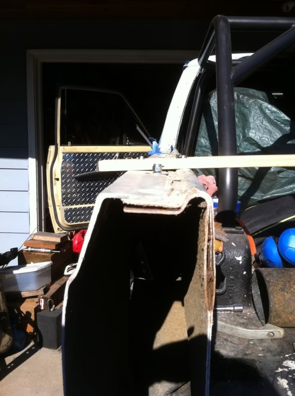

Next step is to use some short strips of 1x2" to help position the top so I can get the glass going again similar to what Luke of Frontier 4x4 did here:

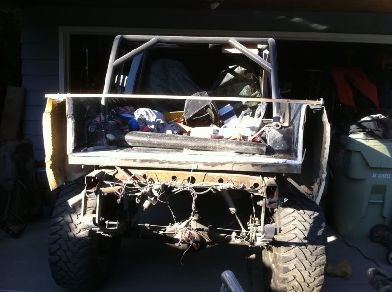

Had a little time today to play...

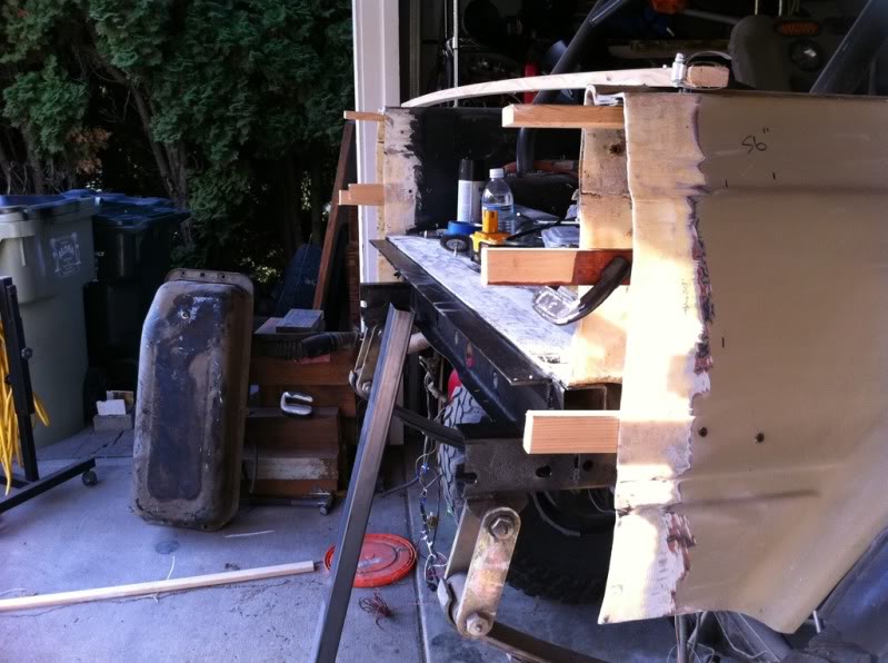

1x2 strips to help hold pieces in place prior to glass:
Since I won't be able to glass the bottom of the bed I welded a piece of 1.25 angle to help support the end of the bed:

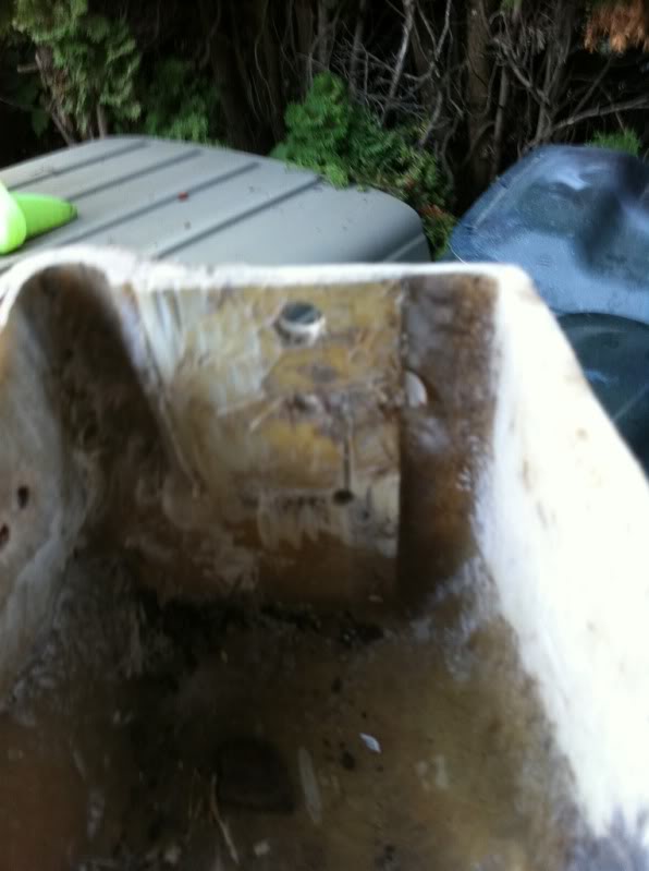

Trial fit of the end of the bed found something off:

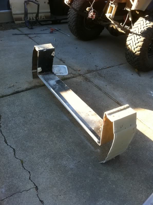

Winnebago had out a metal brace in the corner of bed, again rusted out and forces pieces of the fiberglass to separate:
Cleaned it up with a cut off wheel:

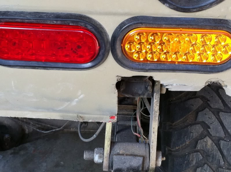

Due to the location of the shackles I will end up moving the tail lights up and relocating the back up lights:

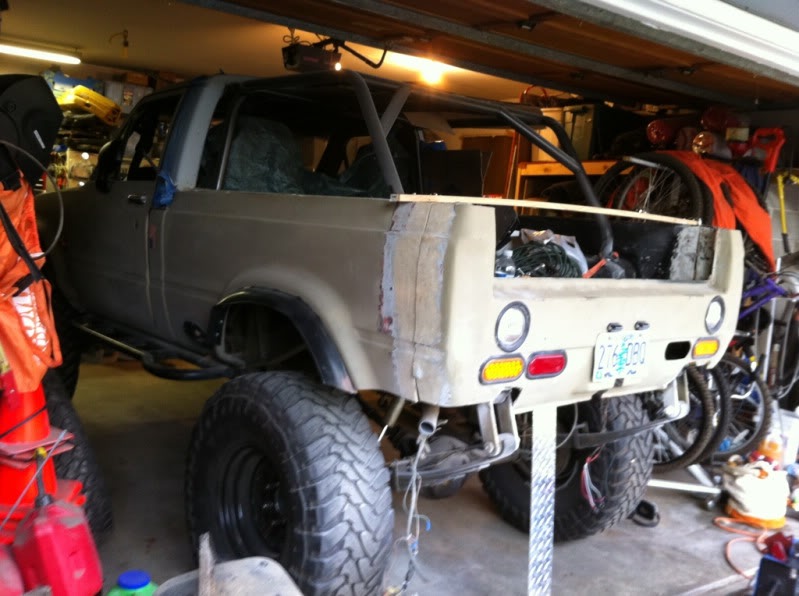

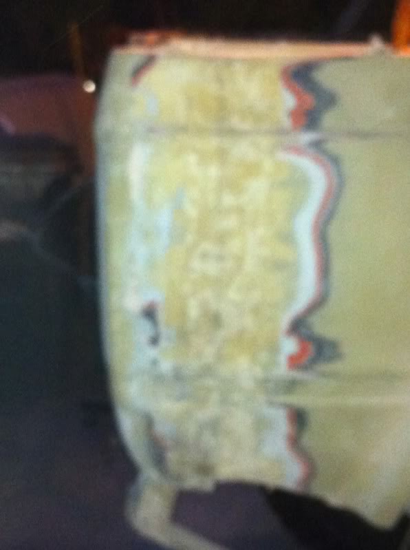

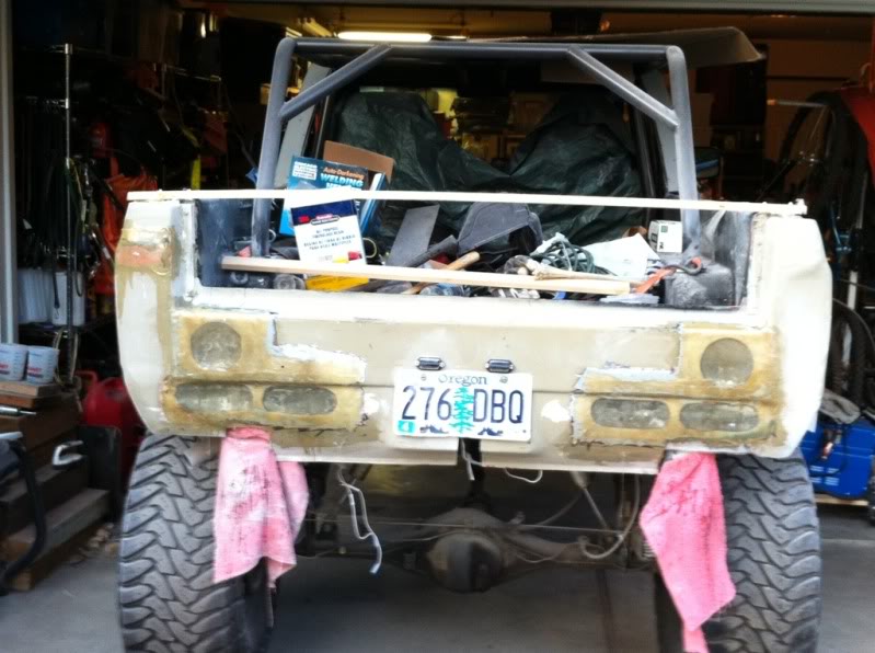

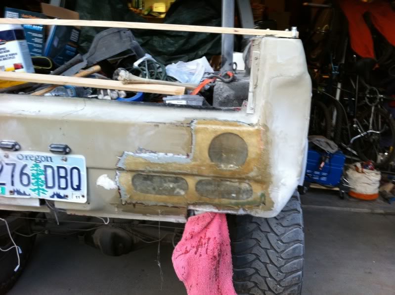

It was a little chillier today than I was expecting so the fiberglass was taking forever to cure..hopefully it holds up.
I got the inside of the bed done and the outer wall of the bed. Gonna let it sit for a few days to allow it to cure.
Need to do some trimming, will take care of that when I start sanding.
Filled in the back up light hole in preparation of moving the tail lights up:
Need to glass the inside of the outer bed side if that makes since and all fiberglass the inside where the light holes were filled in.
Gonna take a bit of sanding and some touchup work to get it looking good.
Looking at the rear of thing it is definitely higher than I want so I think I am gonna drill my shackles up about two inches or so to drop the POS down a little...

Played with some 100 grit today, still a lot of sanding to go and my phon camera is going downhill fast but you get the picture:
