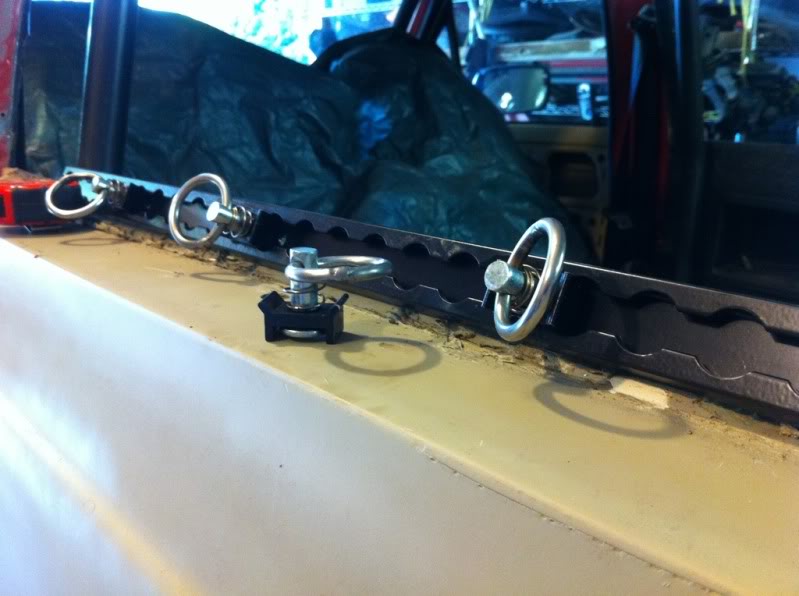

Also found some cargo rail tie downs I bought a long time ago, mounted to the fiberglass with a backing plate should be good for a cargo net:
Got them from: discount ramps

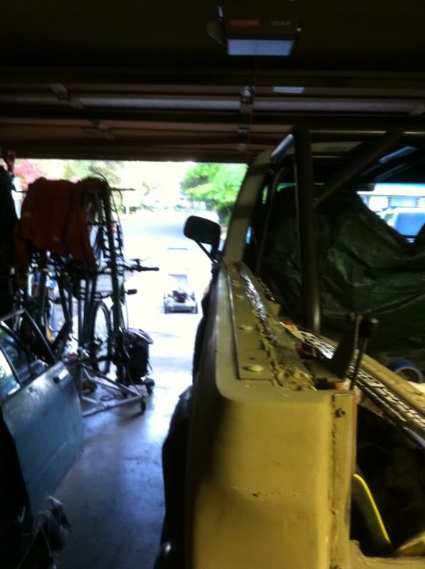

got one of the bed rail adapters done to make the top removeable:
there are five nuts welded to the back side of the strip..
need to convert the carraige bolts to garage door bolts (flatter head) and add 2-3 more of them..
i wanted to try to clean up the butyl tape winnebago used to attach the tub and bed sides but it wasn't worth it...plus it is pretty much what holds the bed sides on...
