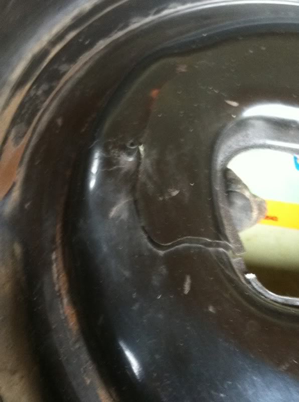

Still plugging away at tieing up loose ends, hopefully taking it through DEQ (Oregon e
Emissions) tomorrow.
Found one root cause for my carb being gunked up all the time:
Stress cracks on the bottom of the air cleaner
Oh well, my buddy Paul came through again! He had a few good ones to choose from

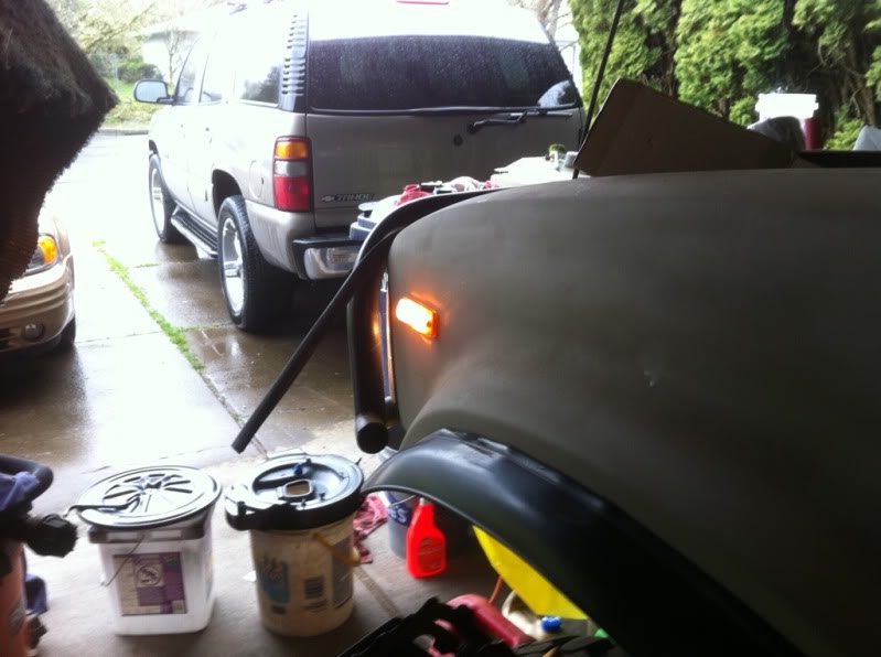

Spent a lot of the day chasing down some wiring gremlins. The truck turns over etc, just going to change out the thermostat before I fire it up.
Figured since I was doing wiring I would finish hooking up the LED side markers. For about a $25-30 conversion I feel it is well worth it for the amount of light output:
Looking forward to converting the taillights.

What's the deal with those LED markers. Yours look great, but I can't get mine to work. I've got power to my two wires. 1 wire off the LED marker, I'm lost. Did you do anything special to get yours to work?
Old Apr 9, 2011 | 03:11 AM
  #571
dropzone's Avatar
Fossilized
iTrader: (6)
Joined: Oct 2005
Posts: 19,771
Likes: 456
From: PNW
are you just using yours as the sidemarker like I did?
got these lights at NAPA, they have 4 LED's in each lite. You should only have power to one of the wires, the other will be your ground.
Make sure your grounds are good.
Old Apr 9, 2011 | 07:47 AM

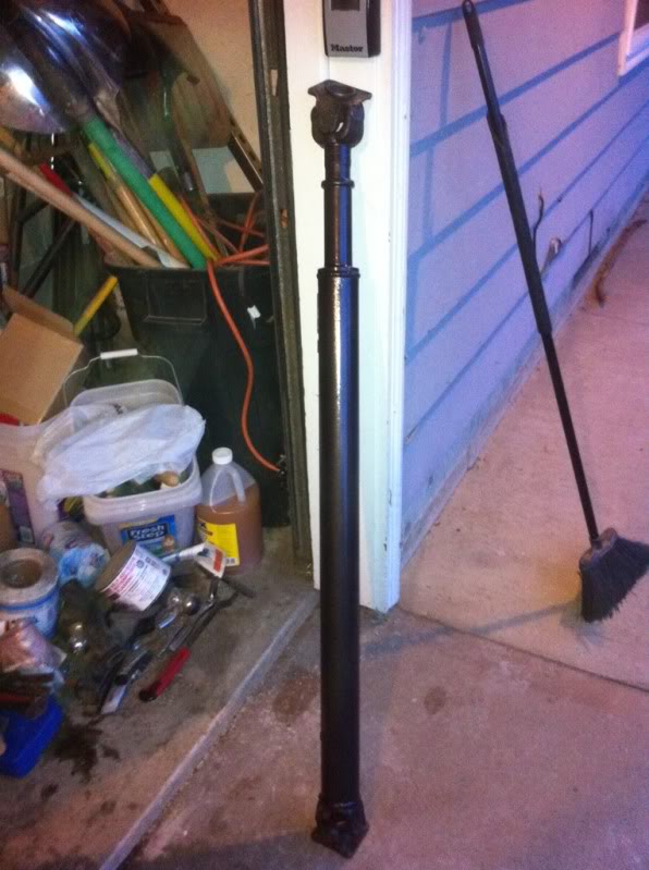

Both axles will be getting new bearings and seals. Just felt like cutting steel today
New u joints and cleaned up the rear driveshaft:

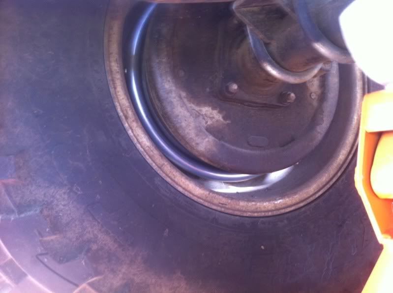

Ran into a snag upfront
they won't clear the bigger V-6 Calipers/vented rotors...gonna need a set of wheel spacers..I had some, dug for them but guess I traded them for something thinking I would not need them...idiot me
will order some soon..anxious to see how they work upfront..

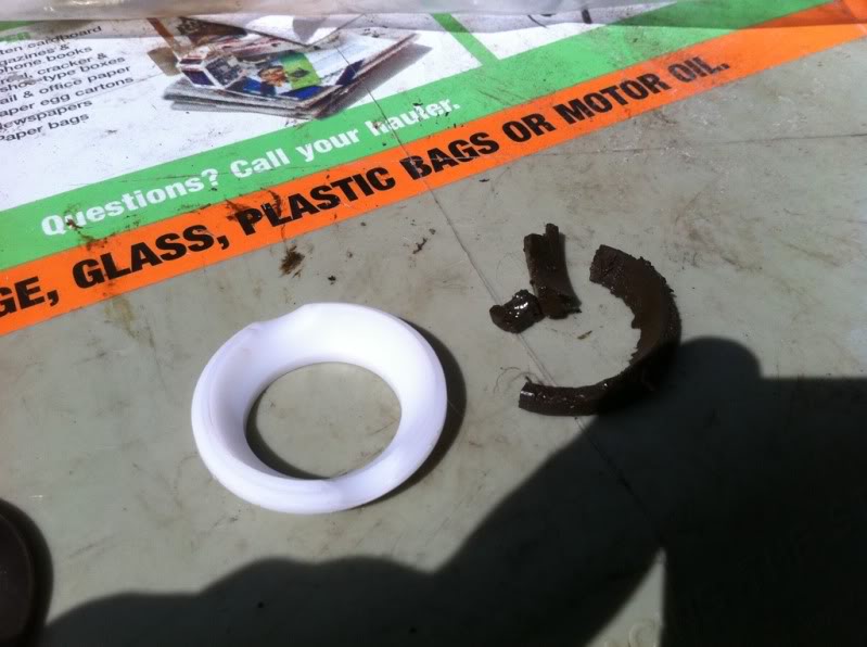

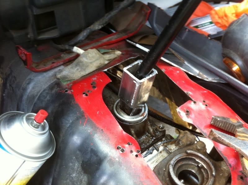

cleaned out the shifter hole, wasn't a whole lot left of the original shifter seat:
the Marlin seat dropped in just like the video:
greased up the shifter and dropped it in with my homemade shifter retainer SST:

I switched back to 15x8's because I didn't want my wheels sticking out past the fender flares and centramatics were able to balance even going against this much weight(balanced at Schwab and tire has a ton of rock rash):
with out the balancers I would have a ton of Death wobble...not with these things
