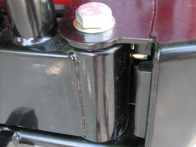

They look to be round head bolts so you can't unbolt from the outside.

I used flat head garage door bolts, nothing for anyone to get a grip on.
Went thAt route so I could cut the head to fit around the latching area.

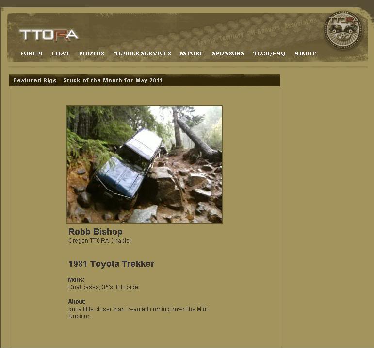

haven't been on TTORA for awhile and don't remember when I submitted this pic but it was kind of cool to be the May 'stuck of the month'

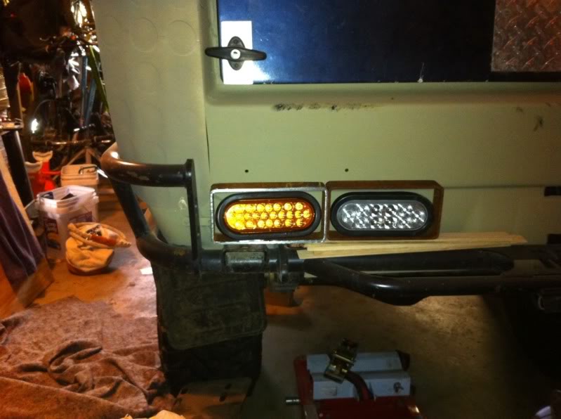

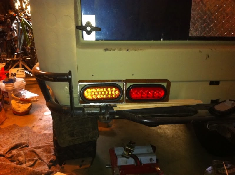

so not much of an update...no cash to buy a weber carb...been busy getting the house ready for a graduation part for my oldest...if you have kids...they grow up WAY too fast...spend quality time with them while you can
anyway got a great deal on some amber LED turn signals so that will help solve my dilemma of whether or not to try to use a trailer converter to convert a single light to be both the brake/turn/ tail light. They put out a ton of light:
Tentative idea is to fill in stock upright tail light position (just used a piece of card board to block the existing tail light) and move them down just above the bumper.
for something like this:
flush mount
FLush mount with each light having a 4x8 box tubing guard:
not sure if I am gonna use the clear stop/tail light lense with the amber or go with the red tail/stop and amber turn
they are both the same size so I could swap them out. I am debating about moving one of the clear lenses up top to use as a third brake light.
I would have loved to have gone with a set of clear amber turn signals, but the amber lense LED's were free, hence the great deal...
the rear swing out tire is going away...a friend of mine did have an idea to mount the lights under the bumper and bend another piece of tube to act as a mounting surface/guard..not sure if I like that or not, but it would allow me to keep the swing out as an option

Is the clear lense even legal to drive? What about 2 red and one amber like original and then no converter for the blinker. I like the placement. Weld those pieces together witha backing plate, build a mount to attach to the rear bumper and you will be in like Flynn.

Hey Paul: I will just use one red one for tail & Brake light and the amber for turn signals...will find another use for the clear lenses. Maybe a third light at the top of the canopy and use the other one if I build that sleeper style cap out of that extra top.
will flip a coin to see if I flush mount them into the fiberglass(kind of what I am leaning to) or pick up some flange light mounts and weld them to the rectangular tubing and that to the bumper.
nothing happening anytime soon...Oldest is graduating Saturday and have a ton of family coming in this weekend....

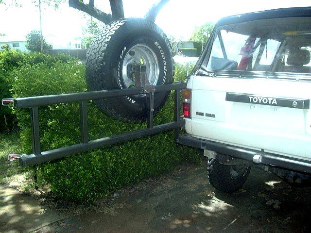

I thought about using them on the tire swing out but I have pretty much decided to eliminate the rear swing out for now for a couple of reasons
1-visibility with a 35" spare sucks..tried a reverse camera and still never trusted it, been driving too long and still look backwards etc..
2- the hinge kit I used is a trailer axle style forget where i got it but there have been multiple reports of this style hinge failing...I don't want that liability. I even went so far as adding a 3/8" piece of cable as some extra piece of mind should it fail.
what I want to do is like 4Crawlers design, only round tubing. With two hinge points and two locking latches it would be very secure...this is a down the road plan, kind of like my 37's or 39's and 2.7 Taco engine
