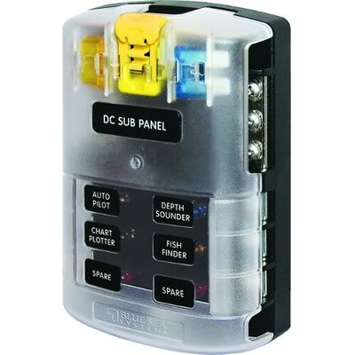

so been trying to figure out my switches for my dash (have an idea to redo the stereo and dash plate) and saw these guys on facebook:

all of this junk will be wired inconjunction with this thing:
this will help get rid of my rock light wires I left hanging down from my sliders since I wasn't sure how I was gonna route them.

How much is that fuse panel thing and were do u get it at?
search for "blue sea systems fuse box"

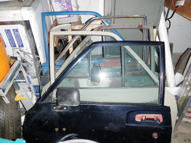

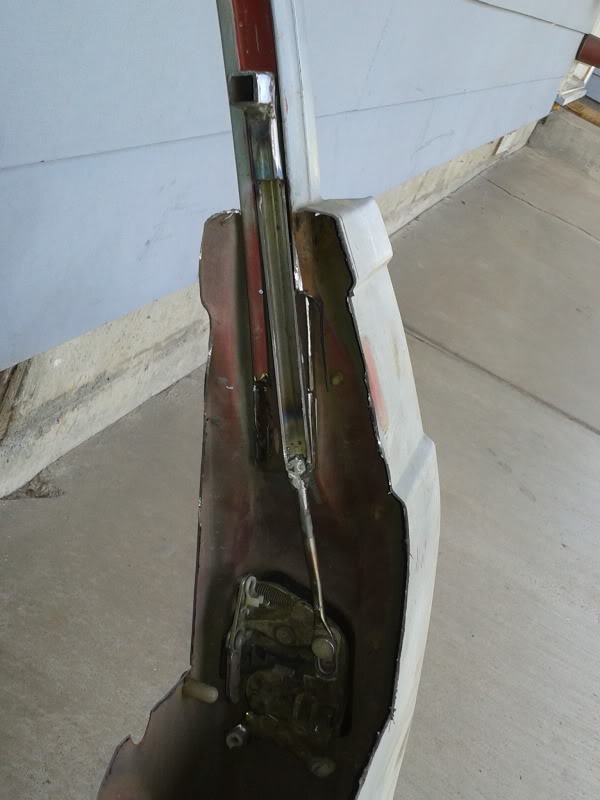

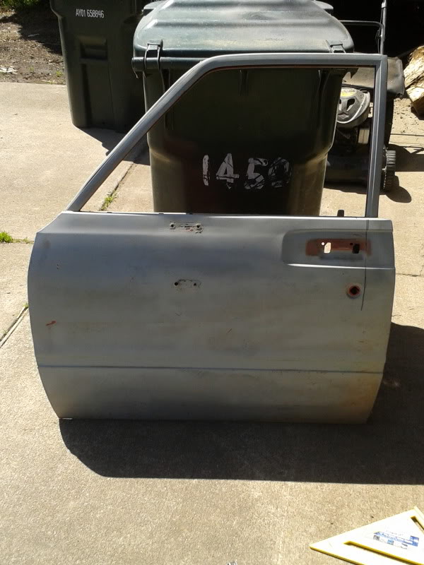

The weather was awesome today so I broke out a set of doors out of my collection

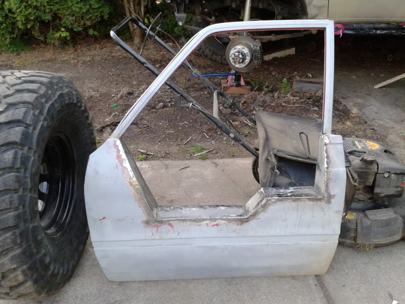

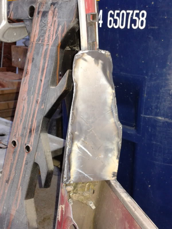

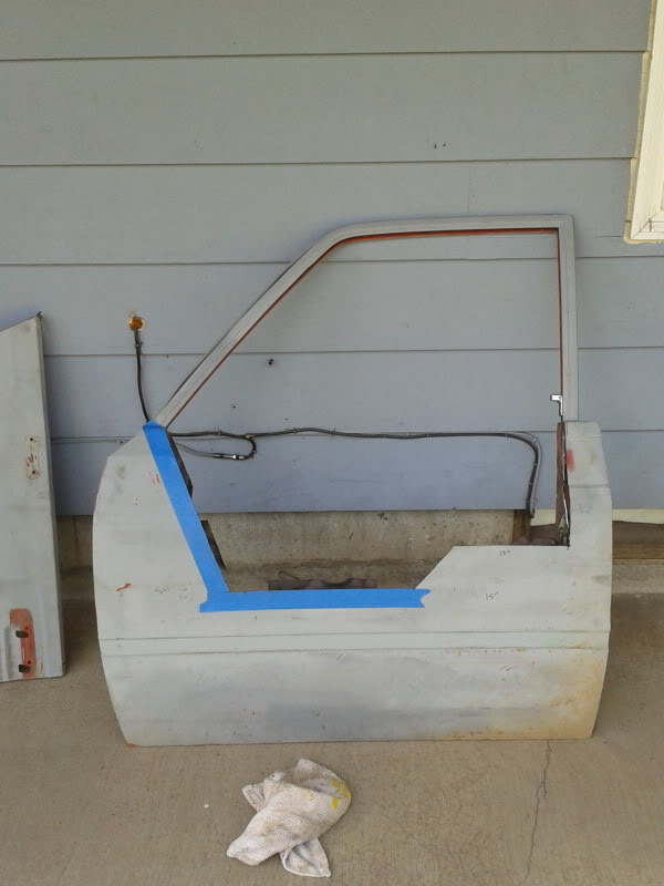

Made the cut:

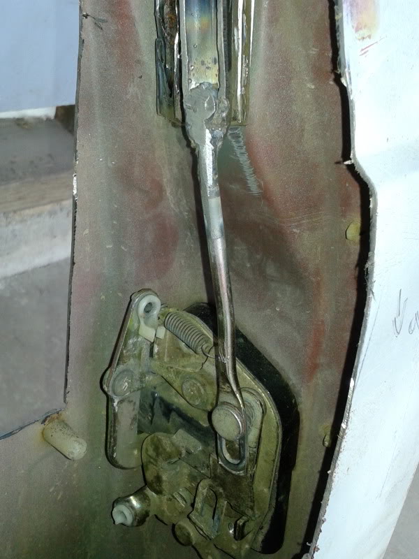

Went a little different route than the norm and ran the latch up the window channel like a few guys used on pirate

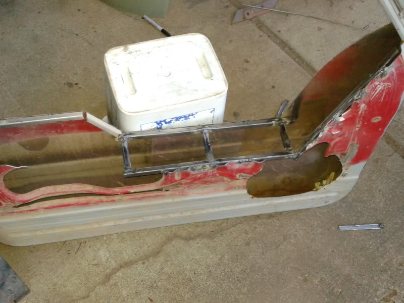

Built a small subframe out of 1/2" square tubing to give it a little strength
First time welding sheet metal
Hopefully get it done tomorrow

Nice collection of doors! The half door looks good. That's a smart latch design

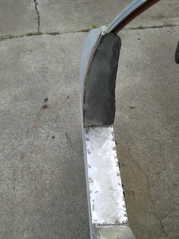

Got the majority of the driver side door done. I am note sure which I hate more fiberglass or sheet metal. I have a new found respect for body guys.
Need some more flappers wheels and some bondo.

Fuse Box
Have you installed this yet? You using it as a aux fuse box? Been looking for something that I could use for wiring all my lights and accesories too.
