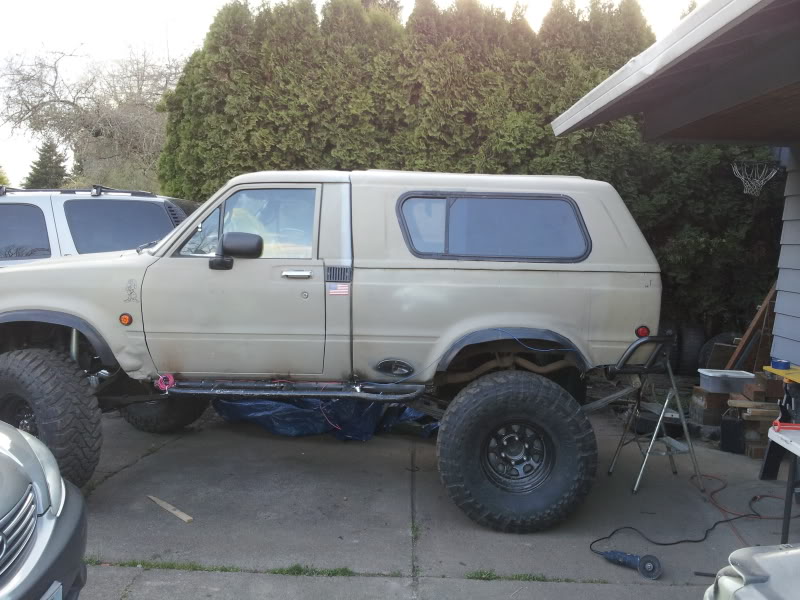

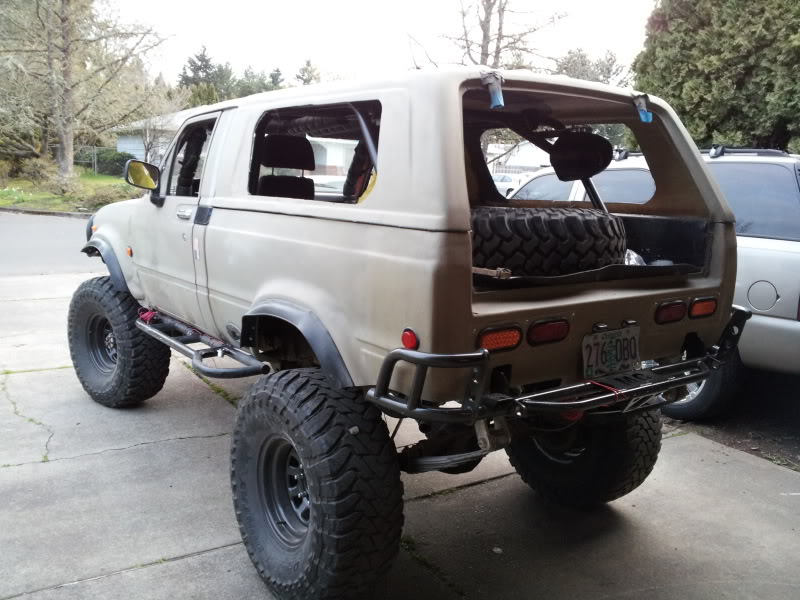

Progress pics, top test fit;
Fiberglass isn't perfect but it'll work.

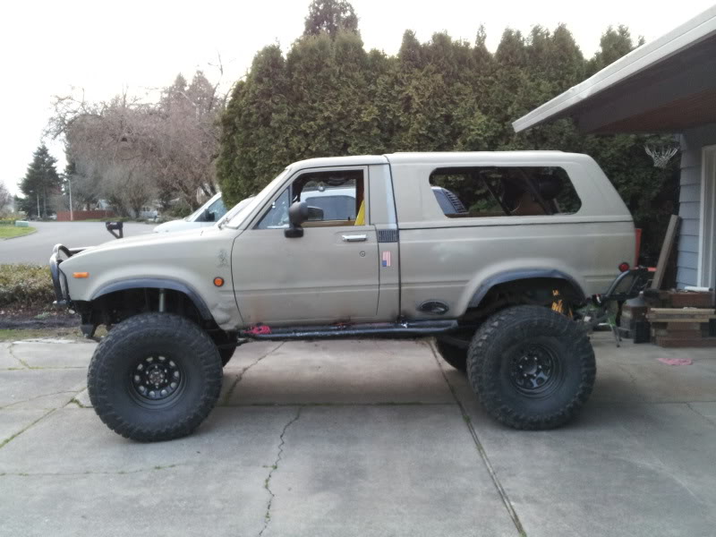

Originally Posted by ToyoTech559
looks awesome. glad you got it done!!
thanks, still not done though, test fit..

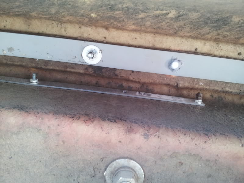

A little more progress -
Got the bed rail mounts done with nuts welded on the backside to allow the top mounts:

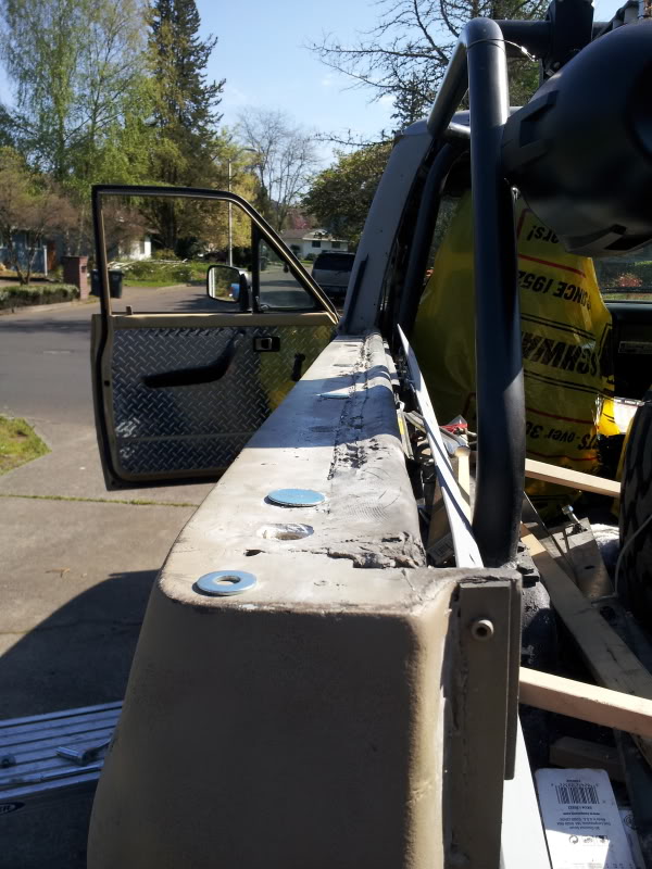

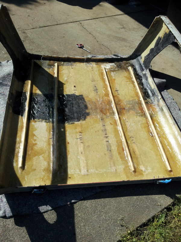

Was staring at what I did last week and it looked like the top might end up too high so remounted the bed rail mounts underneath
Should make for a cleaner install.
Added some dowells for some reinforcement in the top

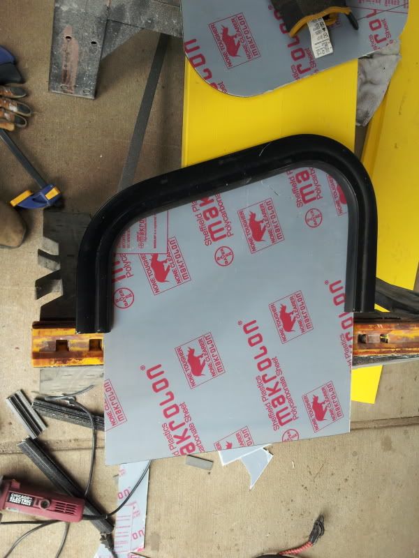

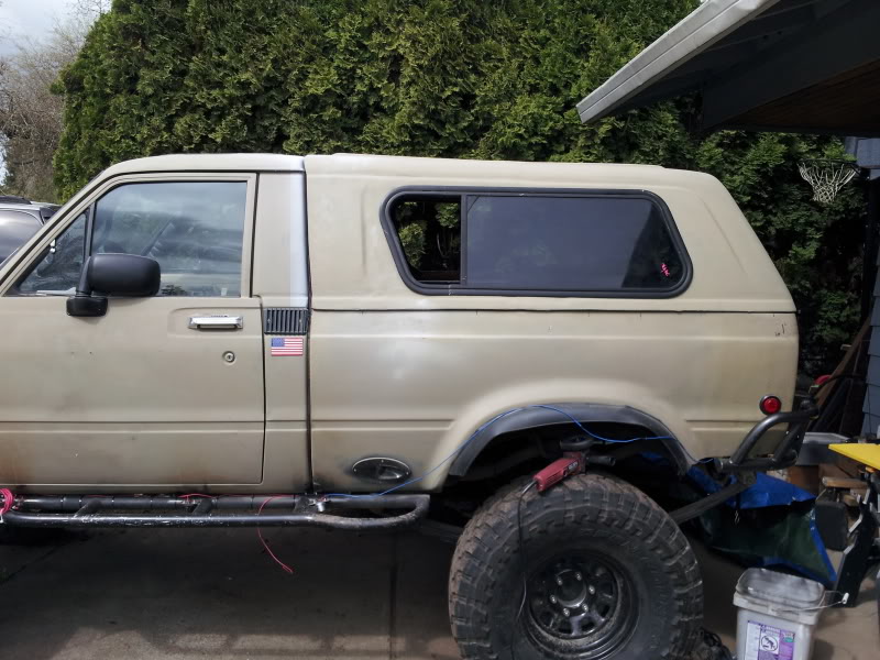

Cut the window frames to fit:
Test fit the frame
Epoxy the frames together, sealed and screwed down tight:
