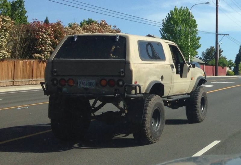

So because the weather forecast says this for a few days I threw the half doors on:
Than a buddy of mine found someone had posted my truck on a FB Toyota page driving down the roadName:  IMG_3140_zpslbmpnfgp.jpg

Awesome! Wish I had picks of my truck from other people...always the case when you are behind the wheel.

Looks goooooood!!!!!

Yep I thought it was kind of cool too. trail shots would have been better though
what tripped me out a couple of years ago was seeing my truck on TV when I dropped my ballot off at the country sheriff's

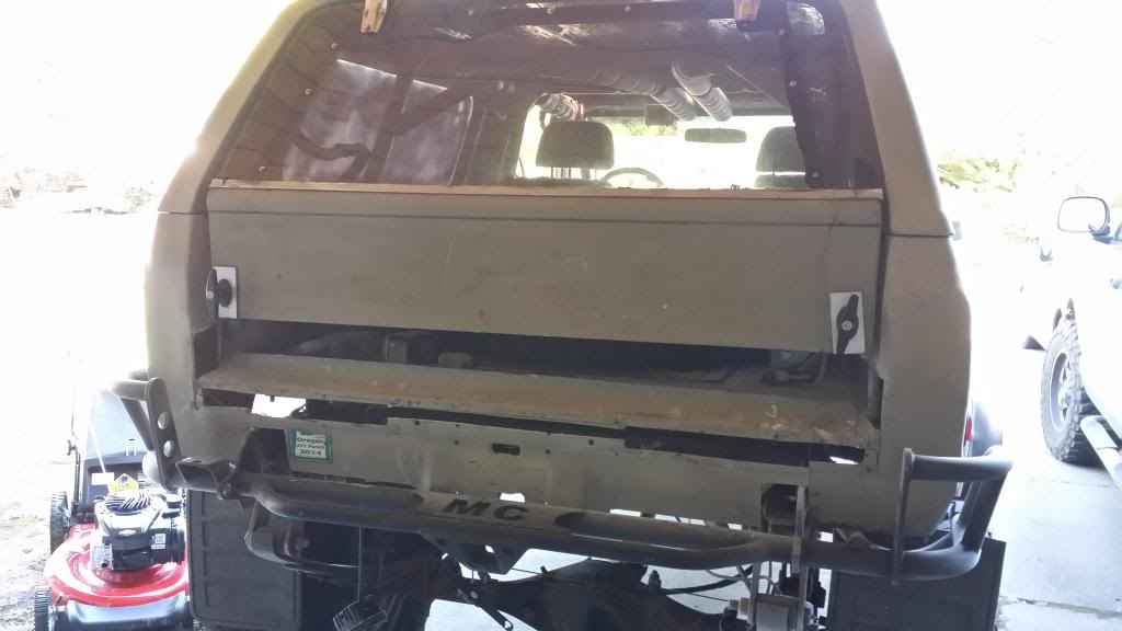

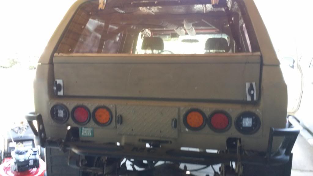

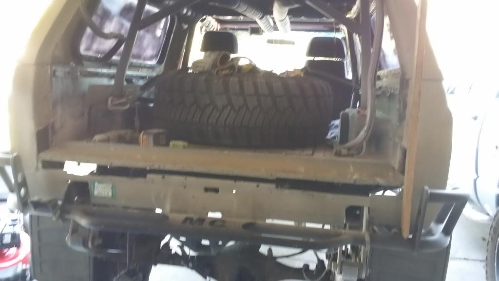

Operation: Can of Worms 2
So I started a project today to fix something I think Winnebago screwed up when they designed the trekker bad. They made the tail gate area 5" higher than the floor of bed. Making it a PITA to get stuff in and out of the bed. This project would not be possible if I hadn't scored the rear hatch off the trekker I used the top off of for mock up when I bobbed my bed and canopy. Thanks Paul.
Anyway my plan is to lower the tail gate opening 4" and extend the hatch 4"
Weather and scheduling depend I plan to have this done in 3 weeks.. (fingers crossed)

Rob is at it again! You sir, have the biggest set of cojones on here when it comes to your "hey, I don't like that so let me cut it out and fix it the way it should be" ideas! But I agree, the tail gate on the Trekkers were designed stupidly high. I'm interested to see how this works out for you.
ditto, on the edge of my seat!

Thanks. I think it will be a good change
Me too..hoping it comes out fine
