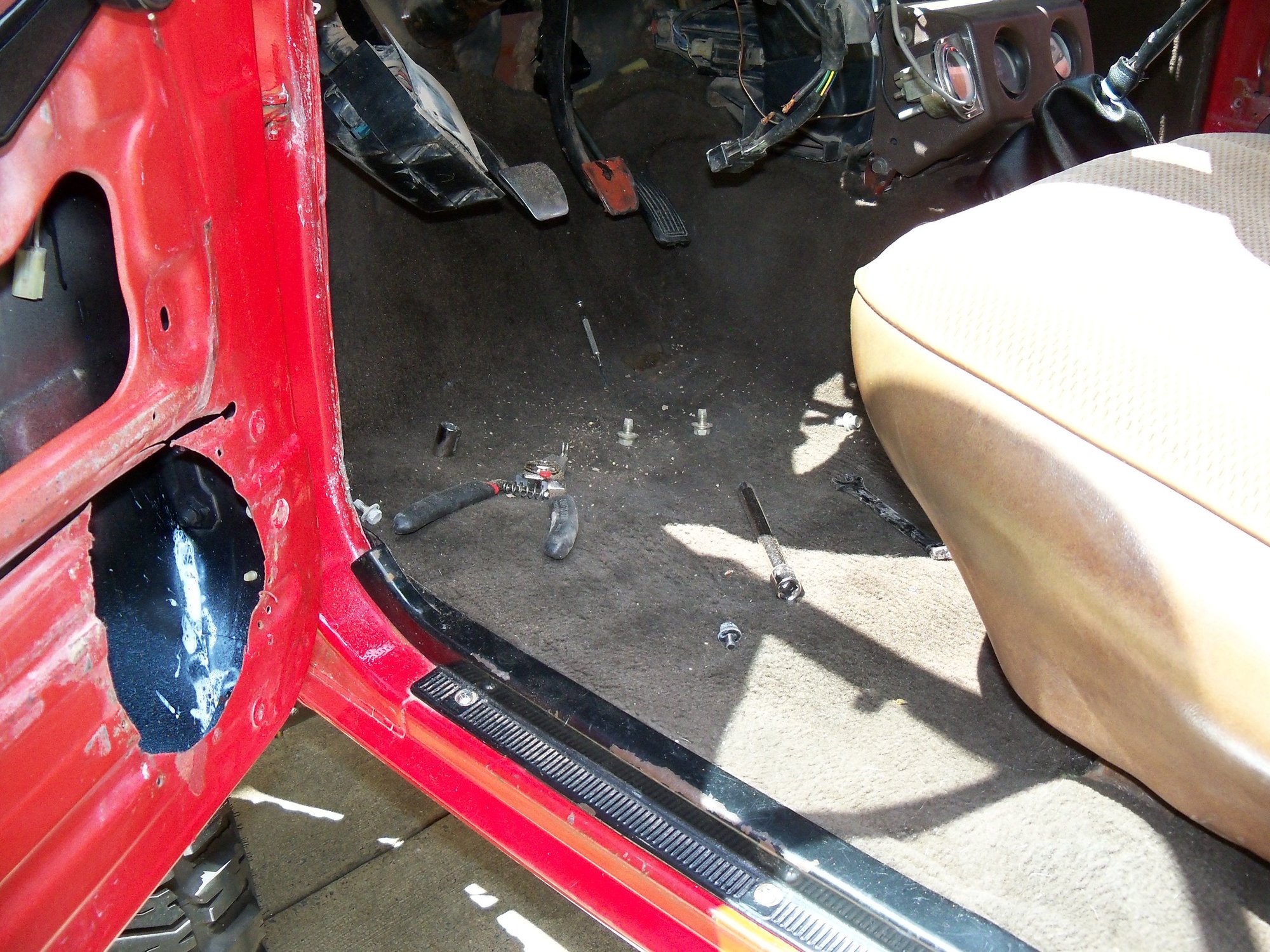

That carpet looks terrible and I wonder what is hiding for me underneath... Oh and I never liked that gas pedal attached to the floor.
Oh look more work of course..... someone decided to use contact cement and spray adhesive with some sort of generic foam. What fun for me.

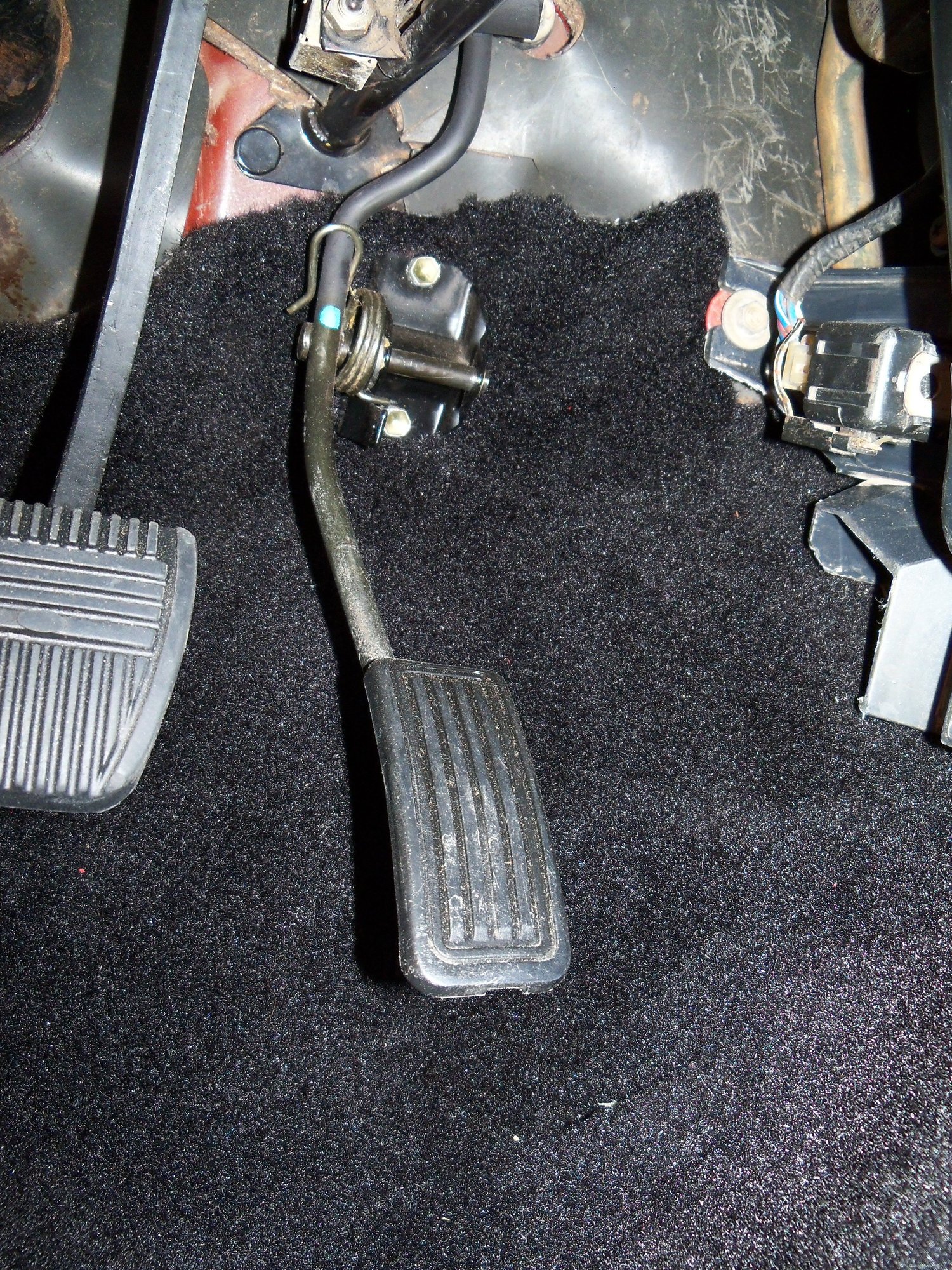

Ok , I know that gas pedal was spotted earlier hanging as the carpet was coming out. I may have got a little out of order. Anyway What I did to get this newer style pedal in, was to cut the weight near the throttle cable end for clearance issues and rebend the pedal rod in a vice with a BFH to give me the correct angle down and match the other pedals. This allowed me to keep the existing pivot stem point rather than cut and reweld it to the opposite side.
Original 1983 gas pedal bracket that hangs off the firewall will need to be reshaped to accommodate the newer style pedal.
Old 83 bracket now reshaped in a vice and BFH so new pedal pivot stem can work in this bracket.

Oh and look new carpet with that pedal.... Some aspects of this resto I decided to move forward with knowing I will be going back to repair things underneath or behind things. Like the Floor boards. For me it made sense to prioritize wrapping up a resto task depending on if I needed to move or use the truck.
