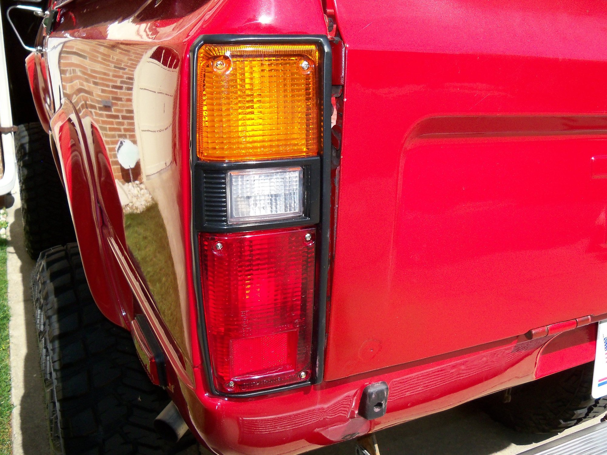

I replaced ALL Lights and Lenses all the way around. Most are factory Toyota some are T.O. parts.

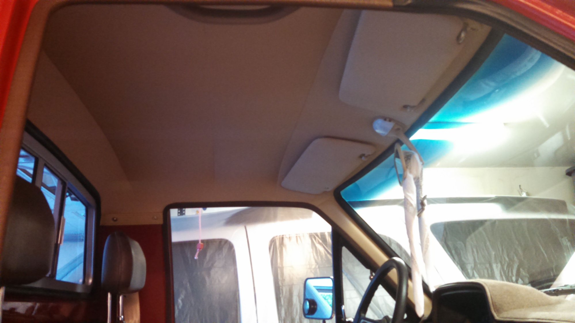

Some more of that stuff I got at Lowes for Sound proofing and I think has an R rating of 3...Not much but hey. I also didn't want to pay what they wanted for carpet pad so I went with a Plush memory foam Bath mat with Rubber backing for 16 bucks to go between the Headliner and this sound proofing material. It was a perfect fit.
Ahhhhhhh..... What a difference!! Headliner, Visors, Mirror, Trim, And Grab Handle all Factory Toyota New. For headliner install just follow the FSM and check out some Youtube vids .

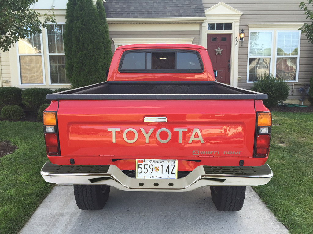

Hey Dave, I'm Dan...Yep I'm still in MD. I actually just got back from AZ seeing my Daughter. I should be here a While. As for the CAR SHOW I'd like to come but I don't know if I can get out of some prior obligations. I took some Pics of my bumper now that we have some sunshine after all that rain. So here they are and I'll ask the wife about this weekend.
Thanks for the pictures. I was initially thinking about doing a stainless or chrome bar bumper like that, but I think I'm going to go with a 89-95 bumper. I photoshopped one onto my truck to get a better idea of how it would look (picture below). I really like it and it looks stock. The rear bumper is pretty much the only thing that I really need to do to have my truck look "complete."
Definitely let me know if you can make it down to the beach this weekend. My wife also has family in Rockville right off of Wooten Pkwy so next time I head up that way I'll let you know and I'll see if she'll let me take my truck - it's not exactly a family vehicle so it may take some effort to convince her to take separate vehicles... Nice score on the headliner - from Griffith Motors on eBay? I used Raptor Liner throughout my interior so I don't "need" a headliner, but I may eventually do it.

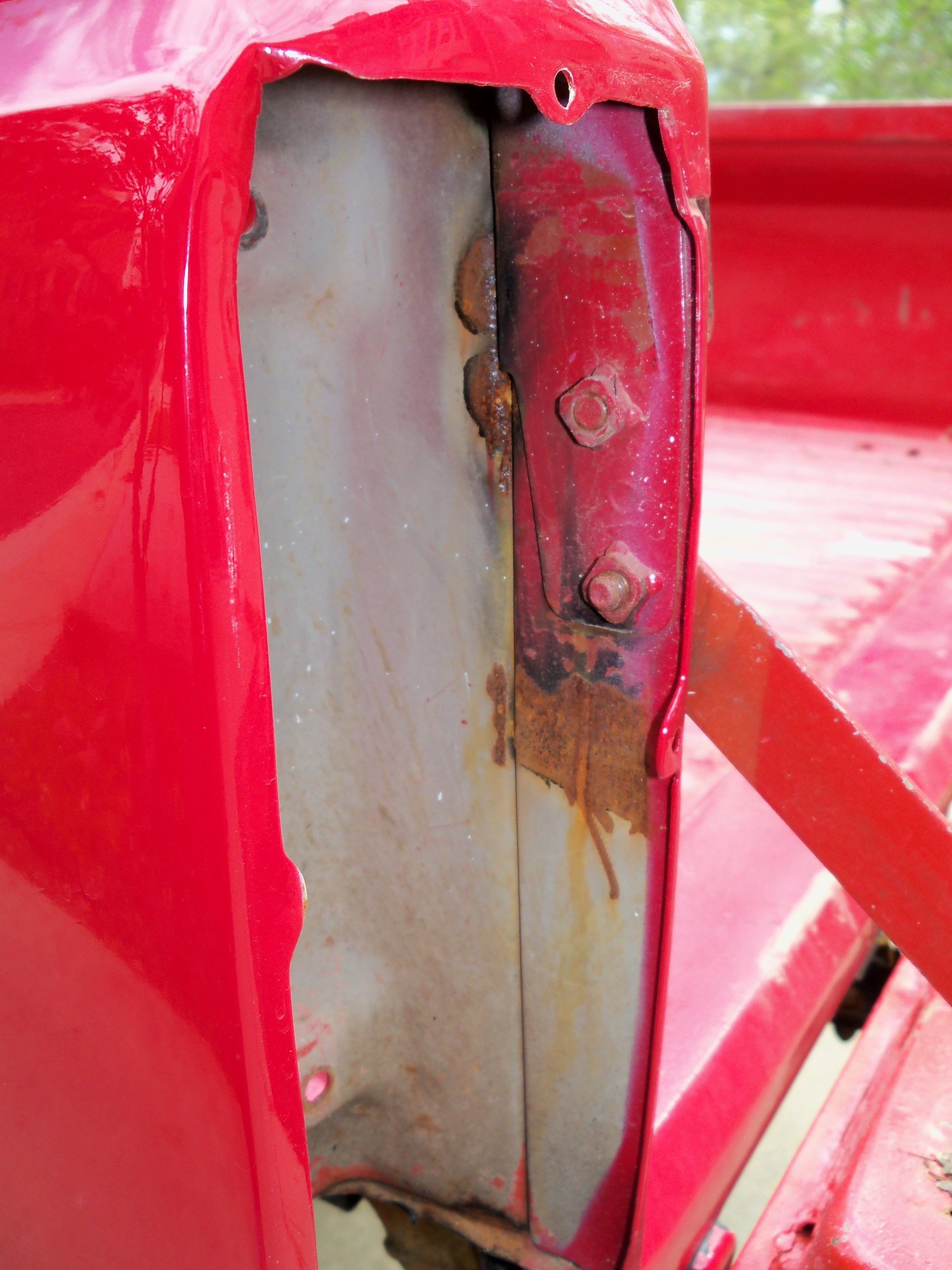

Unchartered territory
Soooo.... not the greatest pic. But These lower skirts on the bed are a problem spot on all of these Trucks at some point... My question to all that have encountered and tackled this problem is.....It appears that on the backside of this seam is a pinchweld. Has anyone drilled out the pich welds or cut through this seam to separate the two panels to initiate repairs??

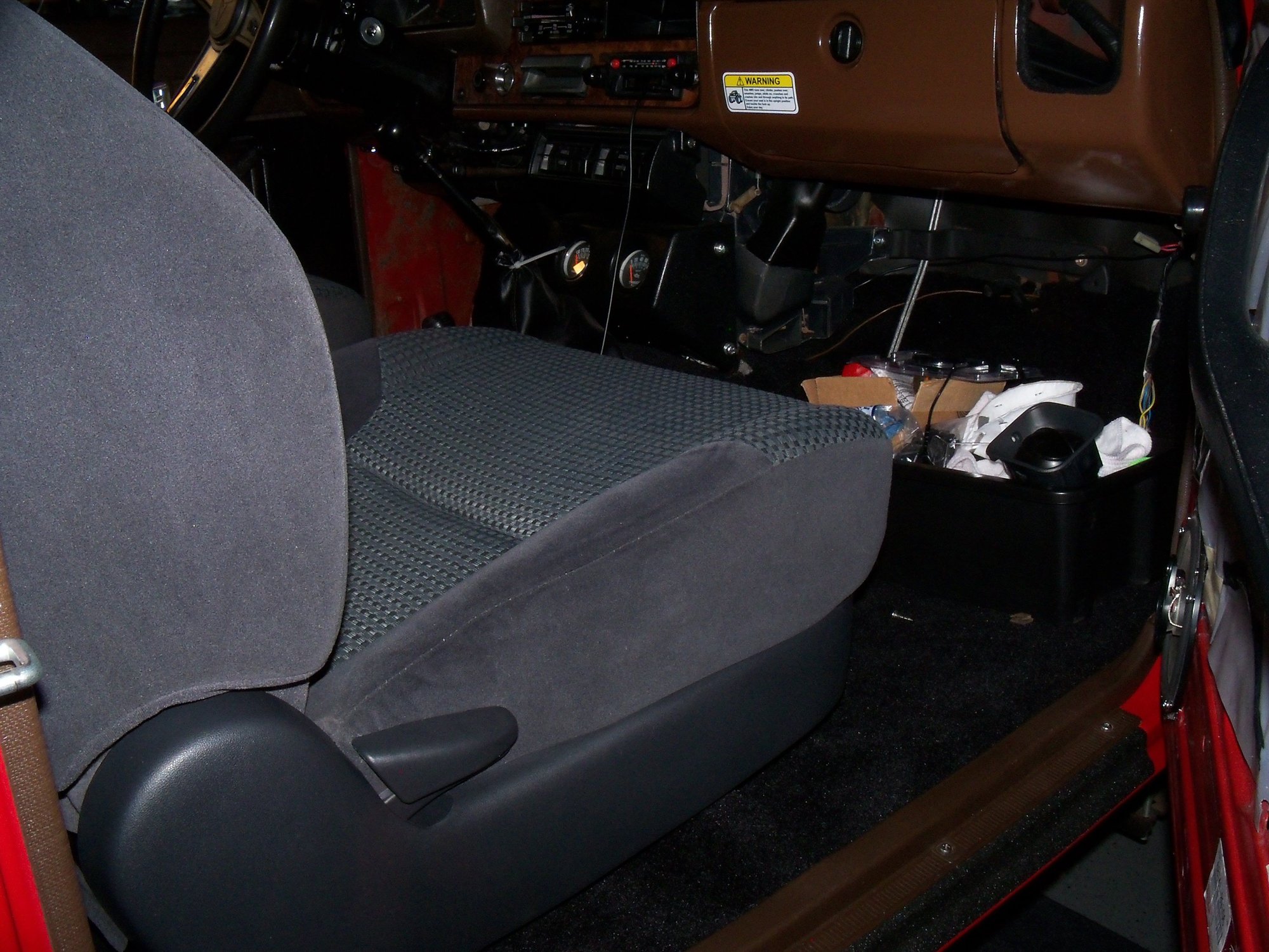

These came out of a low mileage 2005 4Runner and after cutting off the seat brackets and re-positioning them, I will be able to bolt them to the existing Bolt Holes on the truck. I cleaned them up with a Bissel wet pet vac and they came out looking almost new. I can't believe they're ten years old.

Good lookin' slider! Just a FYI, that bed rust was painted over - no telling what else they painted over as well. Unfortunately, it is likely a lot worse than you think it is. The problem with those bed skirts is that the way Toyota design that particular section, there is 3 layers of steel right there that collect water. Chances are good that the rust is a lot deeper than you think.
