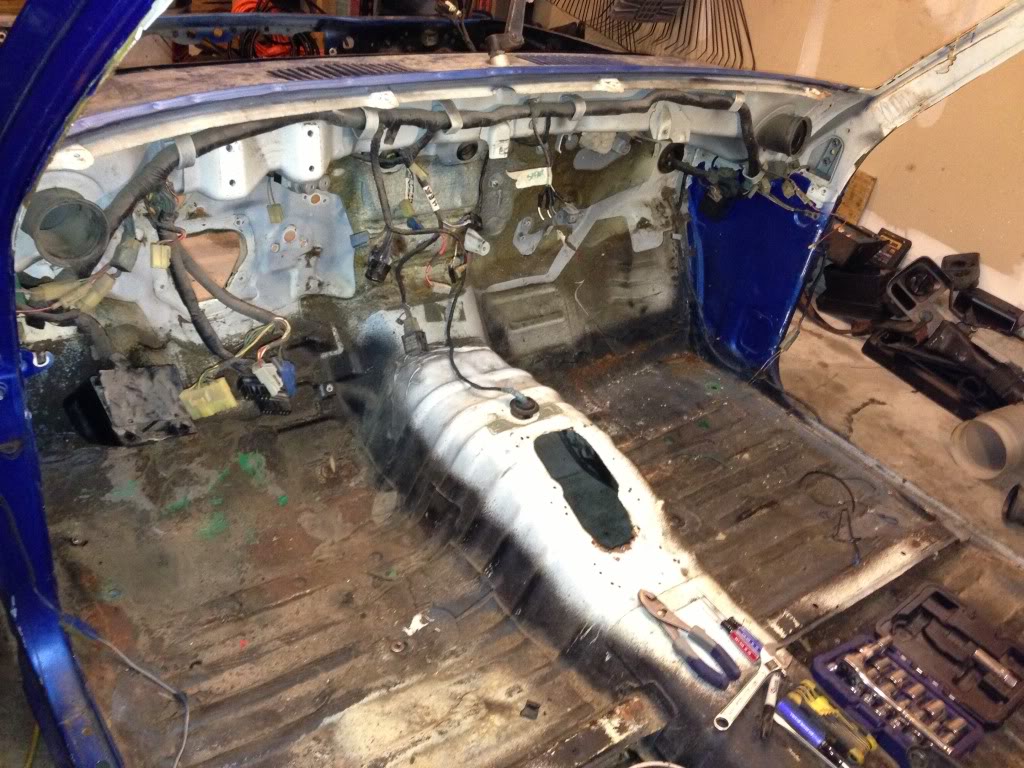

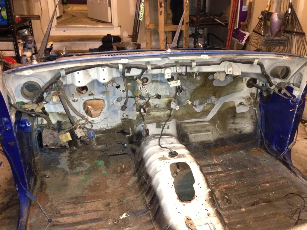

Managed to steal away some time between my in-laws visiting, working on my brother's apartment building and life simply happening to work on my cab. I pretty much got everything removed from the cab except for the wiring harness.
I was able to get a better assessment of the floor boards with everything out. It looks like I'll be better off replacing the entire floor and tunnel. Honestly, I could get away without doing them, but I'd eventually regret it. Plus I plan on using bedliner on the interior floors and it would look best over some smooth sheet steel without beads like you see in Scouts and old Broncos. I'll 16ga steel for the floors and some 1.5" square stock to replace the seat mount which will double as structural support so I don't have to roll beads.
One of these night I plan on tackling that wiring harness. Hopefully I can keep it installed like it is, cut off the sheathing and slice/pull out everything I don't need anymore (ie: Emissions crap). That way I can "tack" tape it back together while it is in the cab so that I can keep its geometry before I remove it. I'm pretty sure that I can just trace and remove everything that comes out of the Emission Control box which will remove damn near every wire, switch and plug on the passenger side fender wall! Waaaahoo!

With what you are doing already, I'll give you one killer piece of advice: remove the harness intact, replace it with a painless 18 circuit offroad waterproof kit. You will not spend a better 500$.
With age, even jacketed copper gets surface oxidation. Due to the physics of how electricity is carried over a conductor (look up "skin effect" for more info) the surface is the most important current carrying area in a cable. Ergo, old wire doesn't work as well. Also, every connector in your harness is badly oxidized as well.
A new harness will make everything work better. It will start easier, run better, and your lights will be brighter. This is the single best upgrade I have ever made to mine.
I have done the whole conversion, and still have my notes. I haven't taken the time to fully diagram it, but I can put that together if it helps you. Maybe between us we could get another thread rolling

Thanks for the input Pumpkin. I have considered the idea of doing the painless harness; however, electric and wiring is my one area of weakness. Since my harness is in really good shape, I'm just going to strip out everything that I don't need and reuse it. Once I have it back together and running right, I may go back and redo the wiring with a painless harness. My fear with rewiring it at this point would be troubleshooting once everything is complete. I'm really good with mechanical trouble shooting, but awful with electrical troubleshooting so if I can eliminate that variable I should be better off.

Wellllll.... I pretty much have all the worthless wiring and emissions wiring stripped from the wiring harness. I basically removed the emissions control unit and traced all the wires back to their dead end origins where they used to connect to smog equipment. I got everything wrapped back up after about 5 rolls of electrical tape. Everything seemed to go pretty well except for the starter relay. If anybody has had experience with the wiring of the starter relay, please chime in here. Basically, what I BELIEVE the scenario to be is that there is that the fuel shut off solenoid ran through the starter relay. There are 4 wires going to the starter relay connected by 2 plugs (one is blue and one is black) but none of them seem to run to the starter from what I can discover (I still have some sorting out to do). There is a Black/White wire that runs to the starter (grouped in with the oil idiot light and temperature light) that I should be the start switch to the starter. I'm just not quite sure what to do here or if there are better alternatives to the factory relay set up - Electrical is pretty much my only weakness. Help or advice will be greatly appreciated.
I'm at work right now, but I can post pictures and more information later tonight.

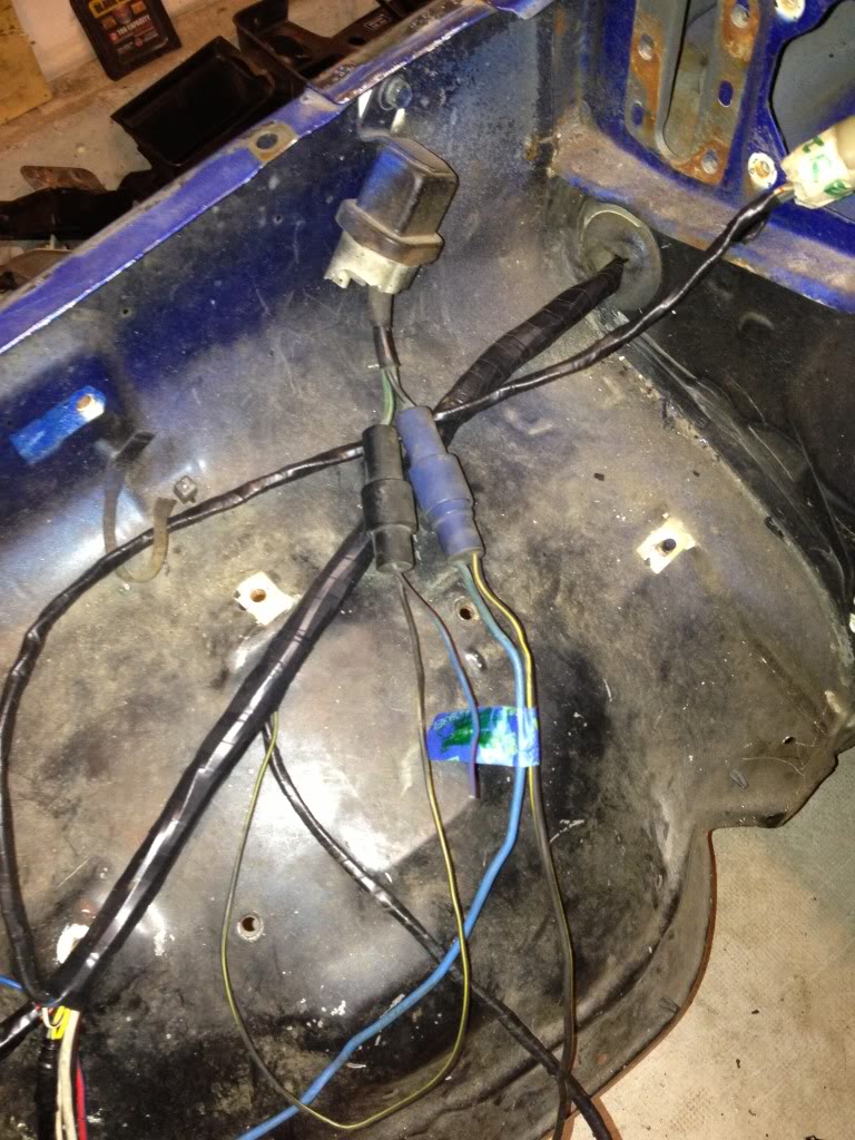

83Toyota88, I could be wrong about the fuel shut off solenoid - I'm at work so I'm just going off of memory.
Don, I certainly trust you as a reliable source when it comes to these things; however, there is definitely a relay mounted on the passenger side fender wall and judging by the way the wiring was wrapped and tied in, it certainly looked like it was factory, although the previous owner(s) definitely did some hack jobs on some of the wiring so I can't really be certain. So are you saying that you have single wire from the ignition switch to the starter? I can take and post some pictures tonight to give you a better picture of what I have going on.

The relay you are showing is originally the one for the CMH heater on the carb. Maybe someone changed it for use as a starter relay because it can take high Amps. Original Federal Specification wiring:
B/Y (Small) - Relay Coil - Engine Fuse
B/R - Relay Coil - Computer
Blue - Relay NO Contact - "E" Circuit Ignition Power
B/Y (Large) - Relay NO Contact - CMH Heater on Carb.
I have a B/W wire coming from my ignition switch to the starter Solenoid. The Wire is located in the engine wiring harness on the passenger side. The wire exits the harness near the battery and goes directly down to the starter solenoid.

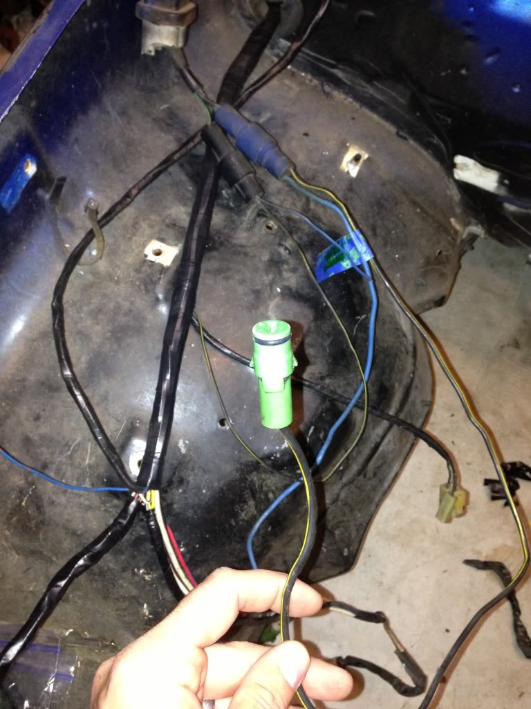

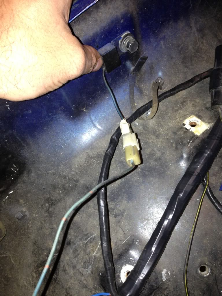

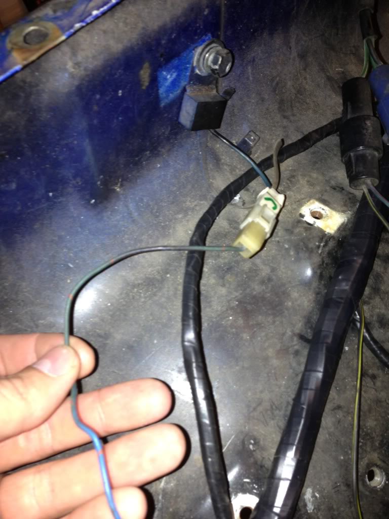

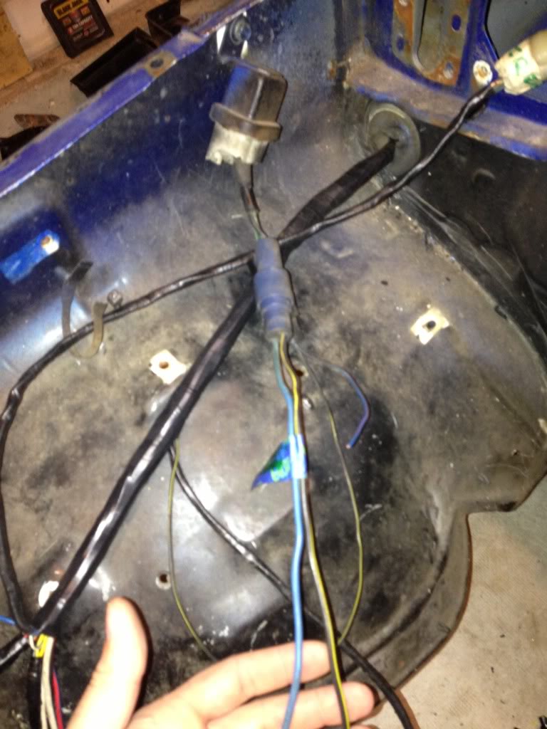

Thanks Don, that makes perfect sense. I went home during lunch to snap some pictures.
From the blue plug - The blue wire ties into the (+) on the battery. The black/yellow wire apparently went to the CMH (which I removed with the LCE intake plate):
CMH plug (heavy black/yellow wire) from the blue plug coming off of the relay:
From the black plug - the blue/red (Cut) went to the emissions computer. Does the small black/yellow go to the ignition switch?
My next question is what is this that my thumb is point to? It is a blue wire with a red dash. I'm assuming it is some sort of resistor
So I am assuming that I can remove the CMH relay and its wiring since I will no longer have a CMH? Also, I am assuming that the smaller black/yellow wire (going to the black plug in the pictures above) was the feed off of the ignition switch. If that is the case, I will need a feed off of the ignition switch for my additional gauges that I am installing, can I use that? Or is that not a constant feed when the ignition is on?

#272
I'll second Don on this one. You shouldn't need a starter relay either, the amount of amps that the solenoid pulls would be inconsequential. I could throw an amp clamp on mine to test if you like, but I'd venture a guess that it is less than an amp on these trucks. Just bypass that relay, rip it out, and wire it up direct. One more useless thing pulled from your truck!
#273
On the black, yellow wire, never assume with electrical. Do you have a voltmeter or test light? You will want to test and make sure that wire is doing exactly what you want it to first.
You probably have a more convenient ignition switched hot in the cab, as a result of removing the ECC anyhow.

I was mistaken in my recollections from last night (I've got spaghetti brains from all this wiring). I verified when I went home during lunch that the relay was indeed for the CMH and not connected to the starter. My primary concern now is can I use the black/yellow wire that went to the relay as an ignition "on" feed for my gauges? And what is that other resistor and wire in that last pic above?

The small B/Y wire originally went to the ENGINE fuse.
The thing you have your thumb on is a NOISE suppressor and there are several located throughout the engine compartment.
The Blue wire from the "E" circuit of Ignition Switch can be used for an Ignition power source.
The small B/Y from the ENGINE fuse should not be used as an ignition power source because it will not carry enough Amps for anything other then a relay coil +.

The small B/Y wire is only hot when the ignition is on.
The heavy blue wire originally came off the "E" circuit of the ignition switch. Your Blue wire was cut and installed on the battery. Look for the other end of the heavy blue wire under the dash (wire factory splices into the B/Y wire off the ignition switch) and see where it was cut. Install a plug-in type connector and then install additional wires for your gauges from the new connector.
