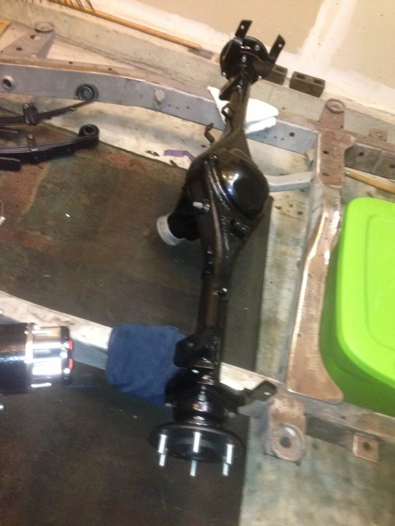

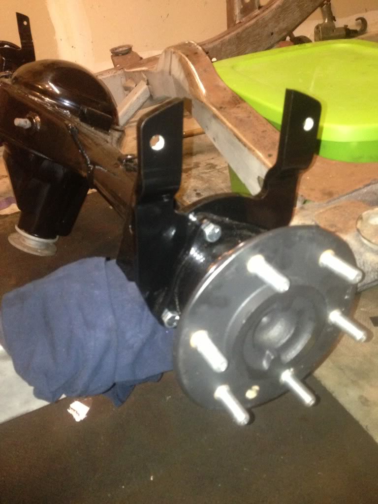

I got more work done tonight. Here's a shot of those rear axle shafts with the bearings and wheel studs pressed in.
And the axle shafts installed with the Sky Engineering rear disc brake conversion bracket:

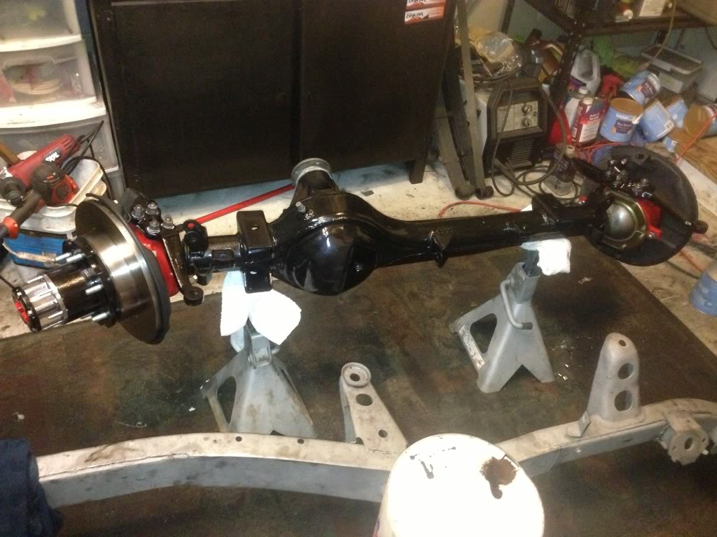

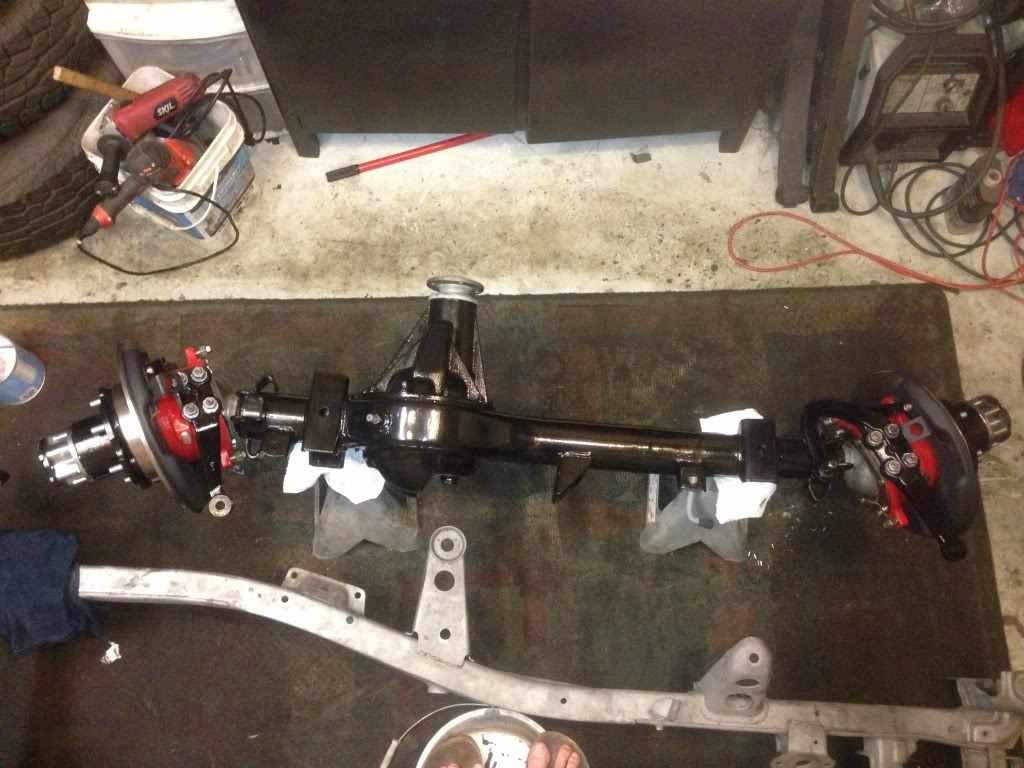

And alas... a completed front axle:

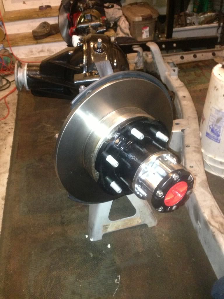

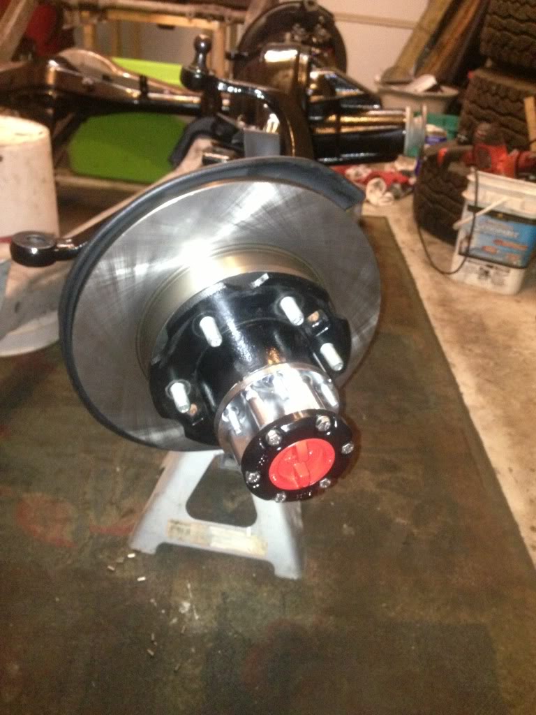

Well....kinda... I slid on the aisin hub locks for looks. I have to run out and find a 54mm socket to torque down the spindle nuts so I couldn't bolt the hub locks down just yet. Everything spins smooth and freely so I'm pretty stoked about that, but you never know if it is truly done right until it's rolling down the road with all 4 wheel still attached!

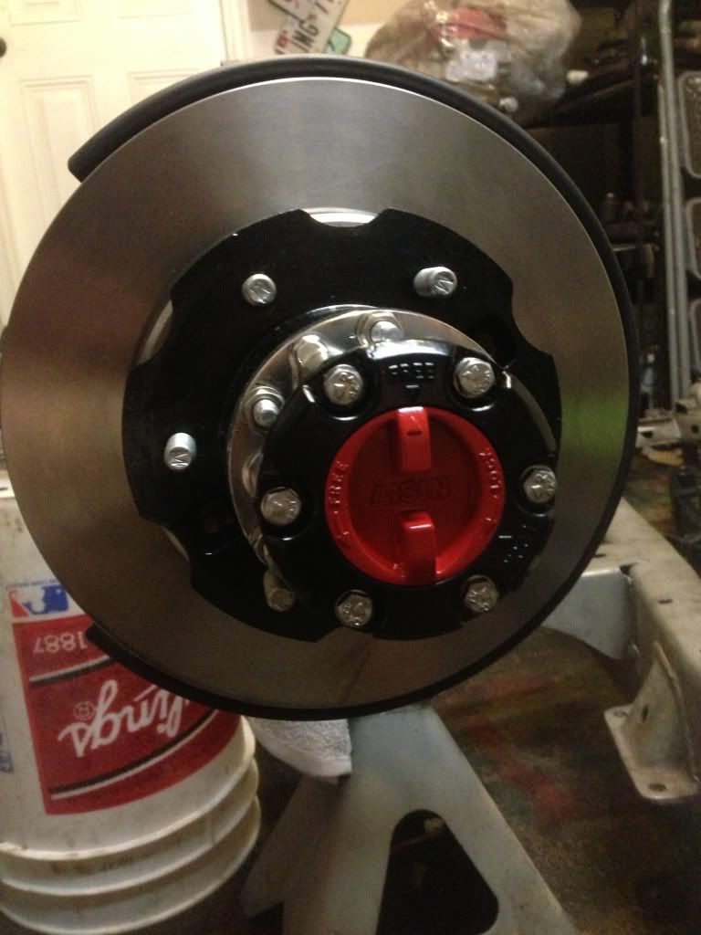

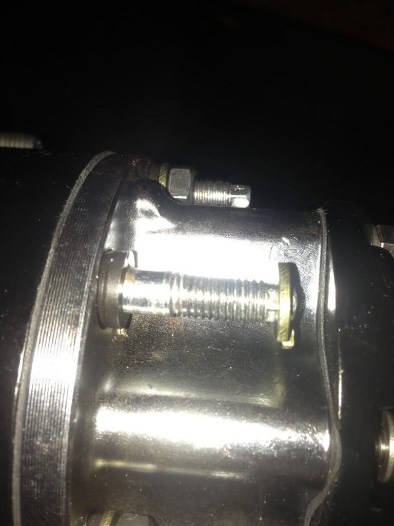

I got the Aisin Hubs finished up today, well kind of... I somehow managed to strip two of the hub studs on the driver side. I'm using Trail Gear Super Metal hubs stud and two of the nuts began to spin after about 10ft lbs of torque. It was pretty strange that all of the others torqued down to 23ft lbs with no problem but these two didn't even make it half way. Seems like those two studs may have been slightly faults so I emailed Trail Gear and hopefully they will shoot me out a couple replacements.
Here's the passenger side complete:
Here's a shot of one of the stripped studs. (I back the stud out and just left it in there finger tight so I wouldn't lose the cone washer):

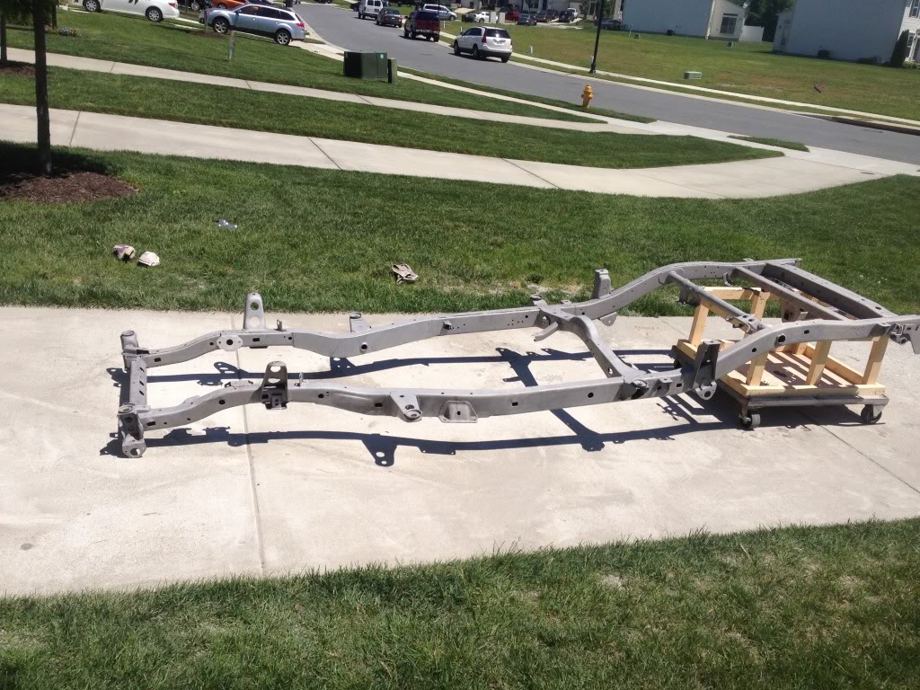

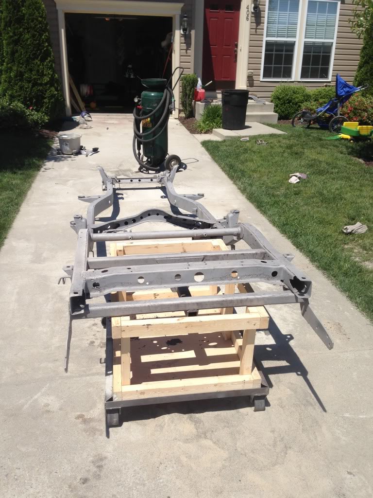

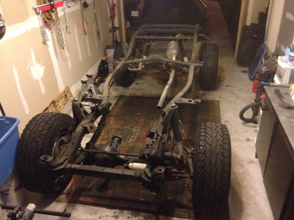

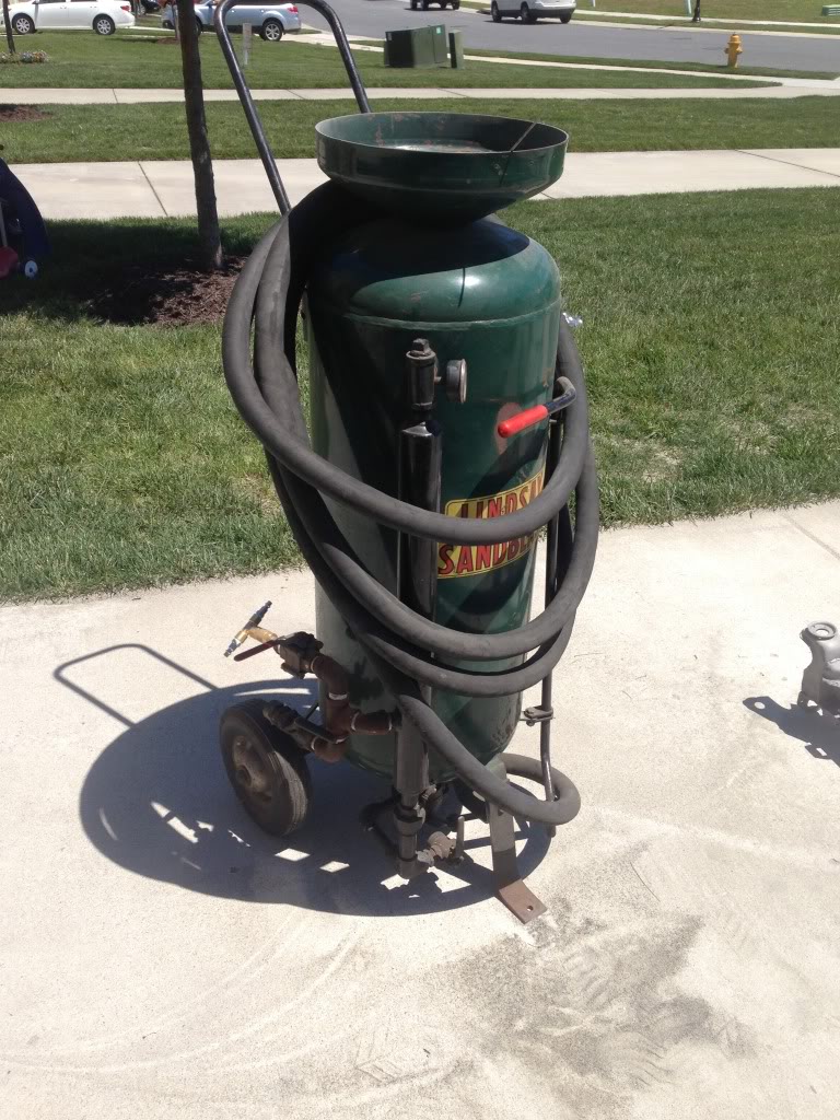

Ok, so I finally discovered that my sandblaster officially sucks!! I borrowed a sandblaster from my co-worker. He's doing a resto on an International Scout and said that his blaster was stripping everything off and doing the job really well for him... soooo here's the god send that he let me borrow:
Hooked it up to my gas powered compressor as well as my 80 gallon electric compressor so that I would have plenty of continuous air. I was running about 80-90 PSI through the blaster and never had to stop to let the compressors catch up. After about 6 hours of blasting I ended up with this:

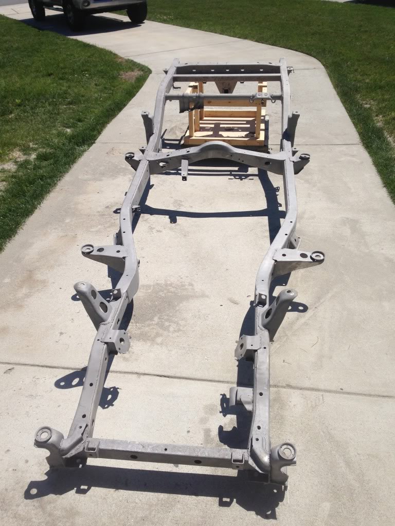

Keep in mind that I started with this:
I went back over the portions that I previously blasted since I managed to get it a little greasy when I was building my axles. I also shot my tranny cross member, bumpstops, tranny bell housing plate, shock/u-bolt brackets and some other odds and ins that I plan on powdercoating.
A little side note to those who may be painting their frame... DO NOT HALF ASS IT and use that cheap rubberized spray on coating! I was cussing the PO the whole time because he had that stuff caked on so thick that this beast of a blaster was having a hard time getting it off! So keep the guy you sell your truck to in mind when you make these kinds of decisions.
Soooo, this week I plan on slapping some POR-15 on the frame and powdercoating the rest of the miscellaneous parts that I have cleaned up. If my front OME springs ever come in then I should be getting a rolling chassis together soon! WOOT WOOT!

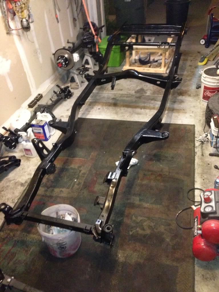

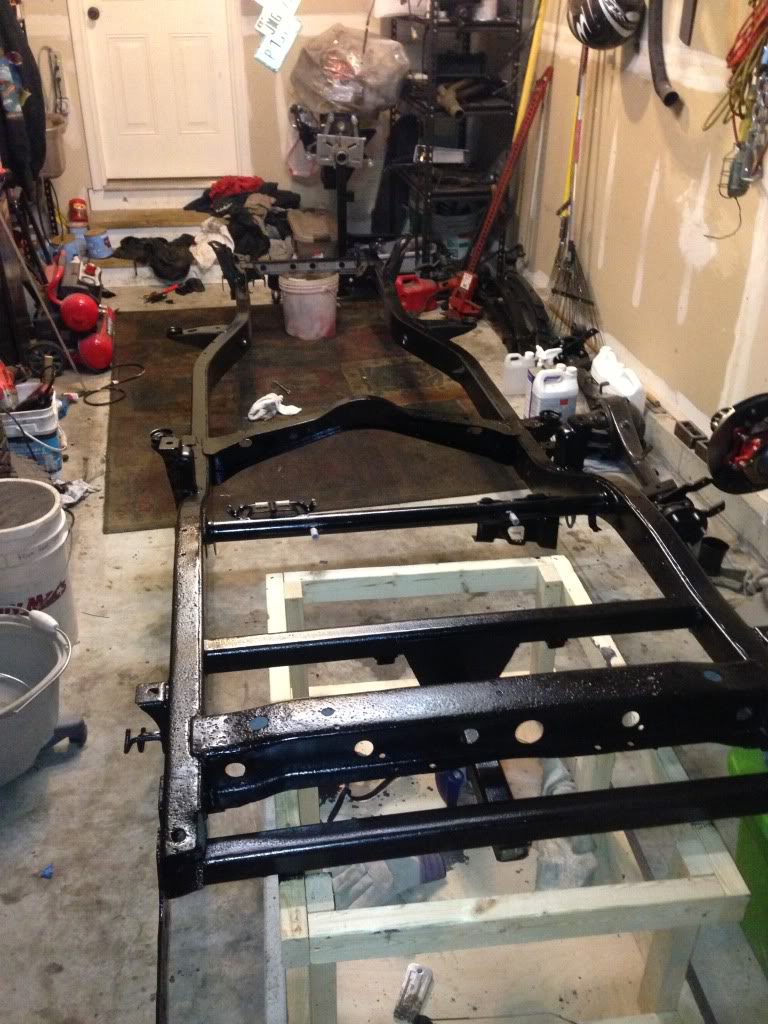

Applied the first coat of POR-15 tonight. I'm planning on doing 3 thin coats and then at least 2 coats for POR-15 semi-gloss ChassisCoat. For now, I'm brushing on the base coat and so far it's laying down rather flat. If it doesn't flatten out well after 3 coats then I'll knock down the ridges with some 320 sandpaper, spray a 4th base coat and then spray the ChassisCoat.
So far I only painted the top and sides of the frame. Tomorrow night, I'll flip it and lay down the first coat on the bottom, then flip it the next night to do the 2nd and 3rd coat on the top and side and flip it the following night to do the 2nd and 3rd coat on the bottom.
For those wondering how far this stuff goes, I'll give you an idea... So far I have applied 3 coats to both axle housings and one coat to at least 3/4 of the frame and I haven't even used a half quart yet. I imagine that I'll be able to get everything painted with less than 1.5 quarts. This stuff goes a long way.
Here are the results so far:
