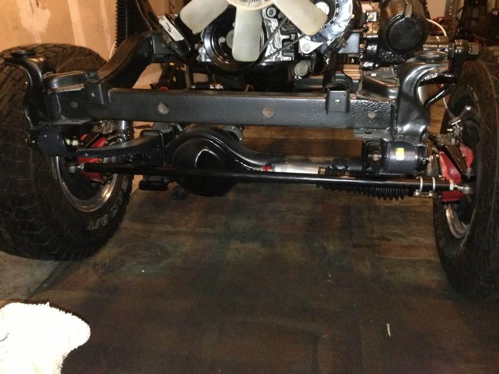

I adjusted my front end alignment tonight. I measured the caster angle using the bottom "ledge" of the bearing caps where it slightly hangs off of the top of the knuckle to take a more accurate measurement. My uncorrected caster angle was about 6* and I actually had 2.5* shims lying around so I was able to use them to get the correct caster angle. Everything said and done, it measured out to a perfect 3.5* of caster. I then adjusted the toe in - took the wheels off and used some steel flat bar to clamp the the rotors so I could take the measurements. I marked off 28.3" (that's what the factory tire is) and centered the flat bar from front to back level with the floor so that I could simulate the factory tires to make the correct adjustments. Technically with a larger tire, the toe "seems" larger but infact it is still the same angle. For instance the 28.3" tire has a 4mm toe in where a 33" tire might have somewhere around 5.5 or 6mm tow in but they would still be toed in at the same angle. I set my tow to 4mm per the FSM.

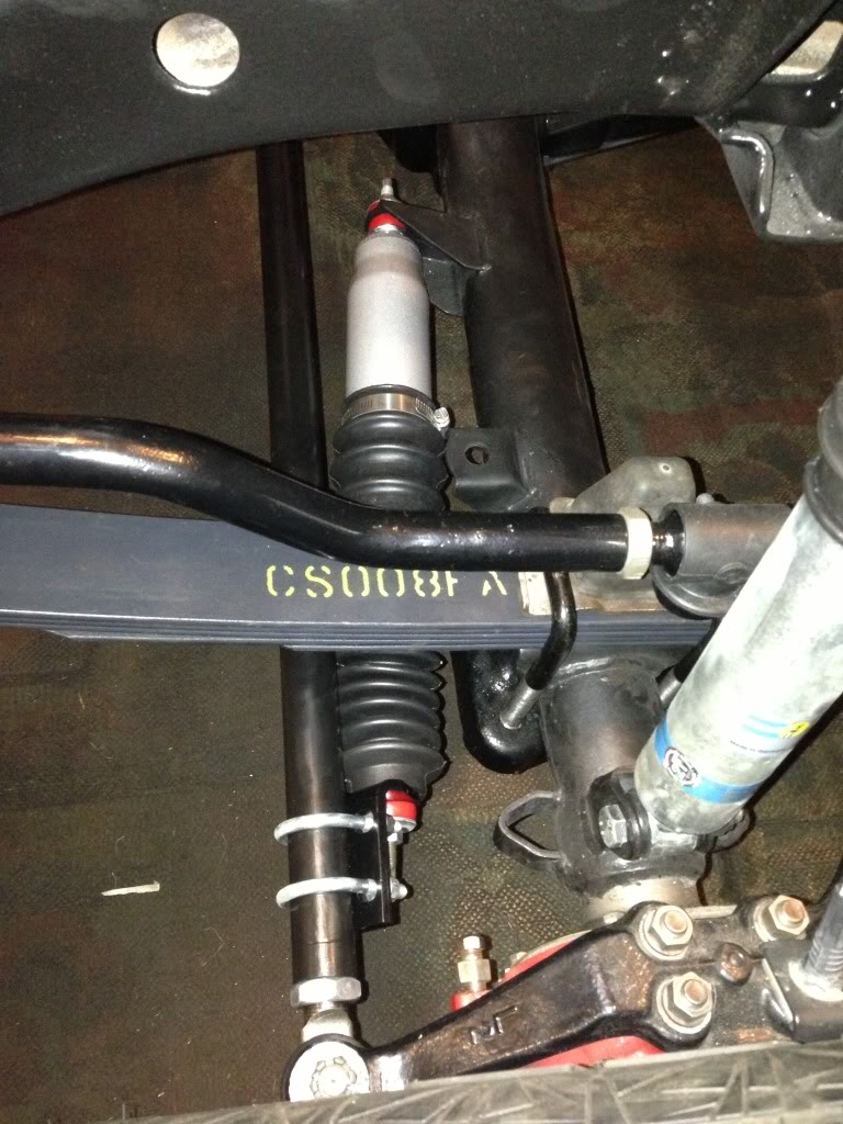

After I got my alignment handled, I mounted my Steering stabilizer. It's a silver skyjacker 9000 (I actually read that it performs well) mounted on the factory bracket on the axle housing and u-bolted to my Sky HD tie rod. The 8" travel is pretty adequate and smooth. My son was having a tough time sleeping so I called it quits for the night before I could snap some pictures. All I need to do is adjust my inner and outer steering limits and the front end should aligned pretty well.
As far as the front driveshaft situation, I'm going to order a 1.5" spacer from 4crawler in hopes that it will do the trick for the time being - I'm thinking it will. Besides, The springs still have some settling to do and I'll get some more compression once I get my cab on. I did hang the axle at full droop tonight while installing the shims and the driveshaft didn't slip apart so I'm thinking the 1.5" spacer should do the trick. If I were to hardcore wheel this thing (which I will not be doing!) then I would need to go another route. I'm only going to need 4wd when I'm in the snow, hunting or on the beach.

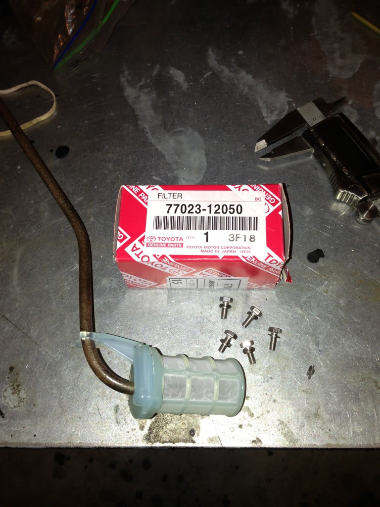

Went to the dealership today in hopes of snagging a new OEM in-tank fuel screen for my fuel pickup. I was surprised that they had it in stock! $21 is steep, but it certainly helps keep any future grime out of my fuel lines and prolongs the intervals between changing fuel filters. I also got some new stainless steel hardware for mounting the fuel pickup and sending unit to the tank. The factory hardware utilizes tiny phillips headed bolts which are a real pain in the ass to remove with the bed on so I went with hex heads - it's the little things that keep future headaches away. Just need to grab some stainless hose clamps and my fuel lines will be checked off.
Here's a couple shots of the steering stabilizer that I installed a couple nights ago:
I'm quickly running out of things to do on this chassis... not neccessarily a bad thing!

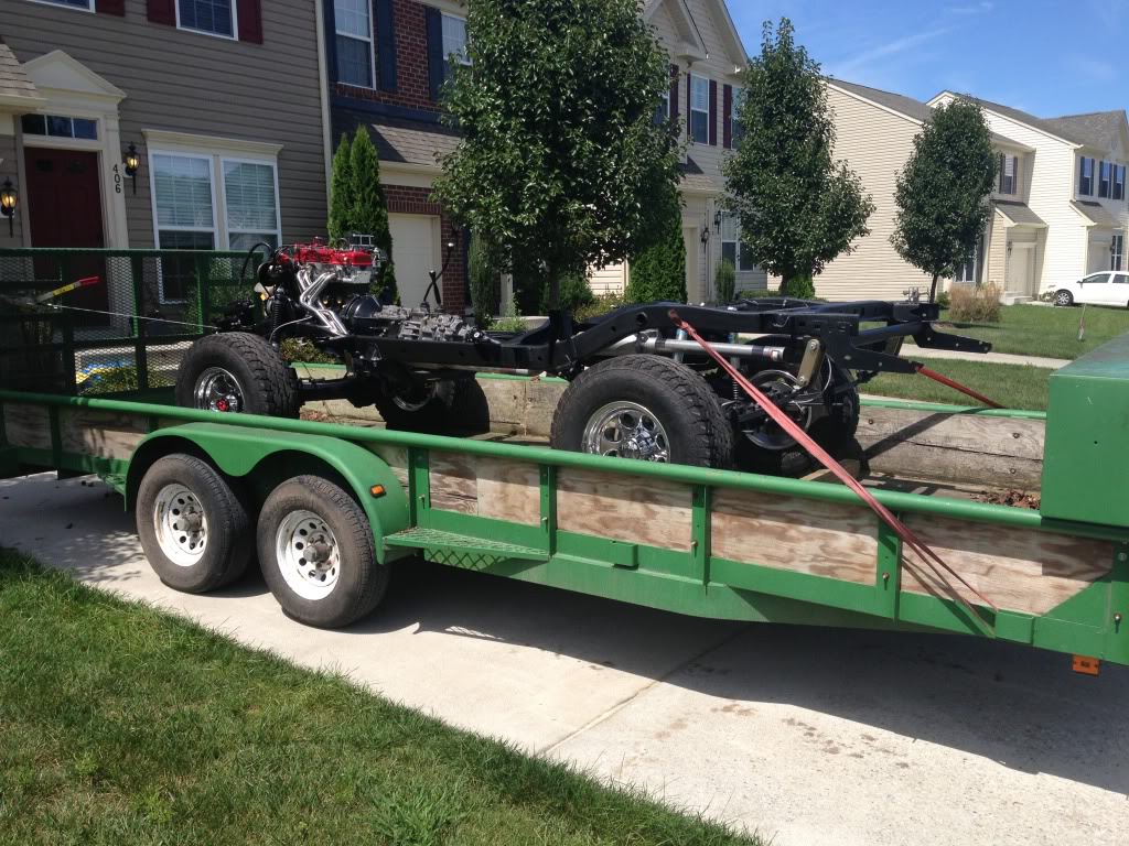

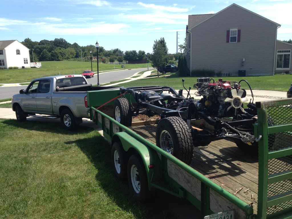

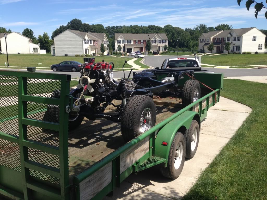

Yesterday was moving day! I hooked up the trailer to my Tundra and loaded up the chassis so that I could move it over to storage while I work on the body. No incidents occurred while hulling it across town, although I was quite paranoid considering the amount of time I have spent on this thing! My cousin moved to Hawaii about a year ago so it is now sitting in his garage so that I can do the body work in mine. Hopefully one night this week I'll be able to slide over to my friend's house to grab my trailer with the cab and other body parts on it.

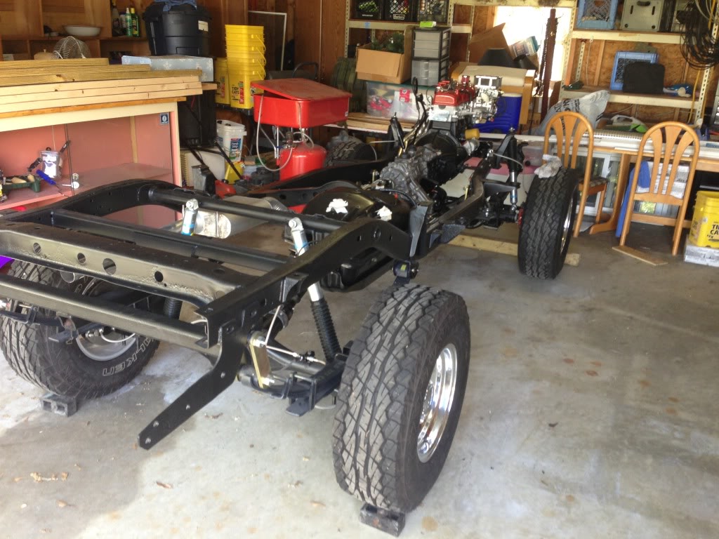

That tail pipe isn't welded on to the muffler yet - just a place holder for now. I'm not going to finish the tail pipe section until I get the bed installed so that I can weld up a down turn just under and even with the rear of the bed. I'm also not sure if I want the down turn to go towards the rear or tucked behind the rear tire like it is from the factory.

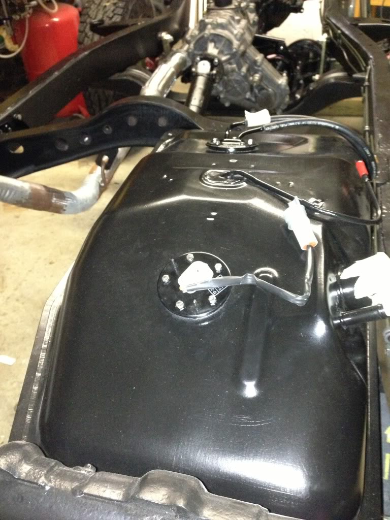

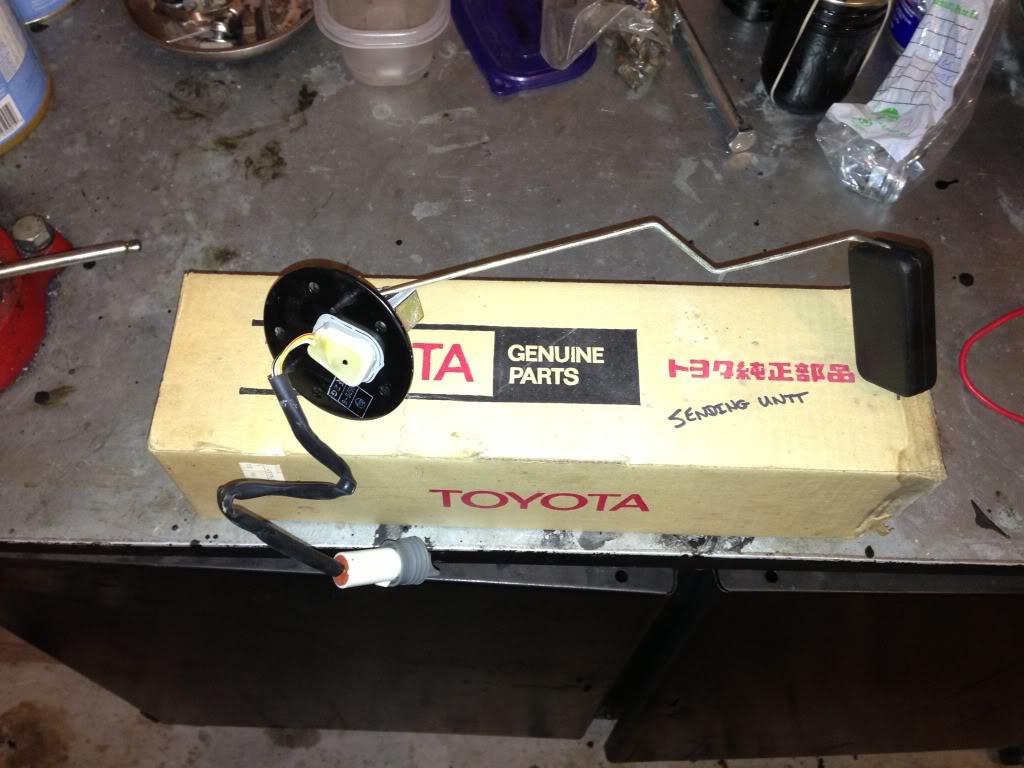

My latest score arrived today! Brand new old stock fuel sending unit:
This is one of those rare parts that I am completely stoked about finding. I'll have to run over to my cousins house tomorrow to install it really quick.

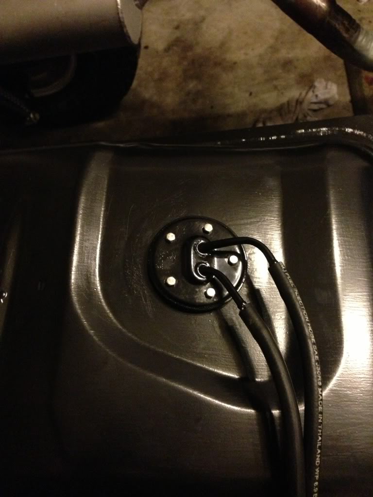

The lady that was cleaning my cousin's house prior to renting it out locked her keys in the house so I had to go let her in this morning. I killed two birds with one stone and installed my fuel sending unit with some shiny new stainless hardware while I was there.
I think that I have everything installed on the chassis that I can at this point and I can officially say that my chassis is complete... I think...
