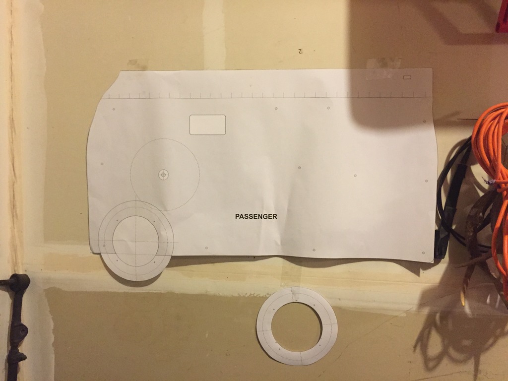

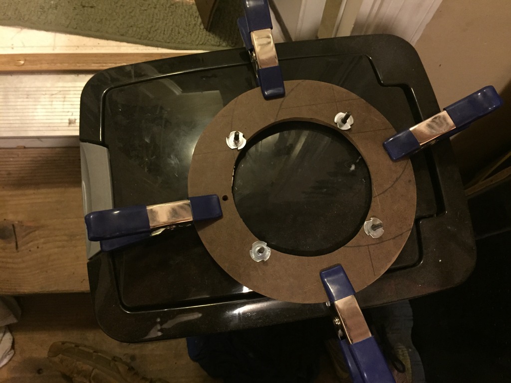

Started making my door panels tonight. As with most everything I do, I took a methodical approach and drew out a template in CAD based on some pretty damn good measurements. Printed it out 1:1 on the wide format plotter at work and voila! A template is created!
The template matches up perfectly with the factory holes so if anybody is interested in using it, I have a PDF file that I can send you.

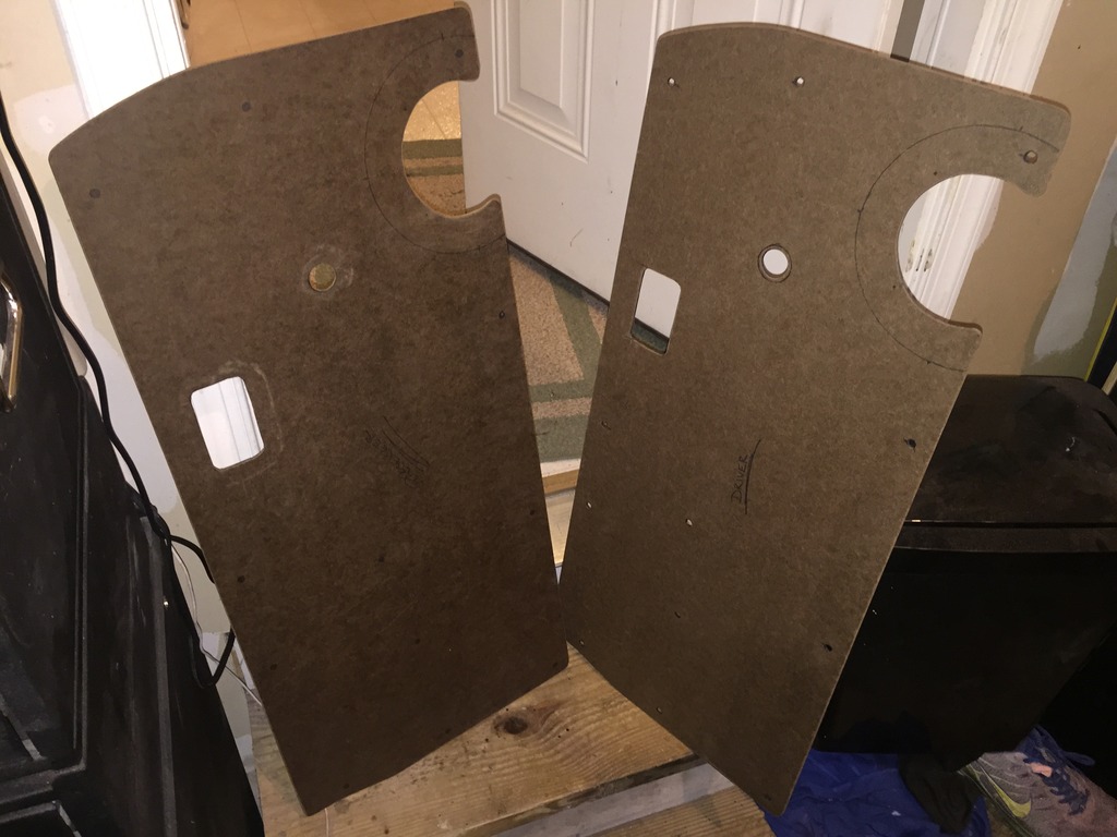

I took some 1/8" MDF with my templates drawn out on it to my table top scroll saw and cut out the main panels and speaker rings. The main panels are basically ready to wrap, just need to drill the holes on the passenger panel.

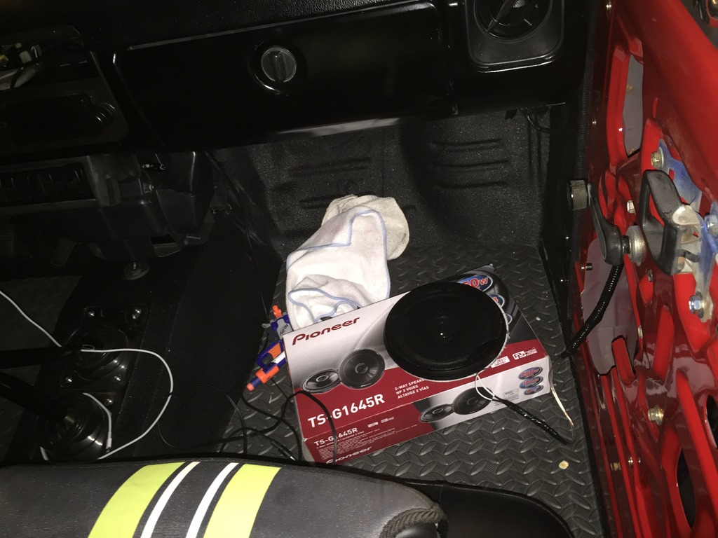

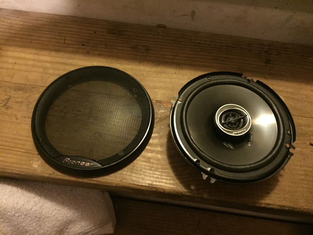

I'm going to be using some Pioneer 6.5" dual speakers that I had laying around for my audio pleasure. They were supposed to go in the cabin of the boat but I never got around to installing them.

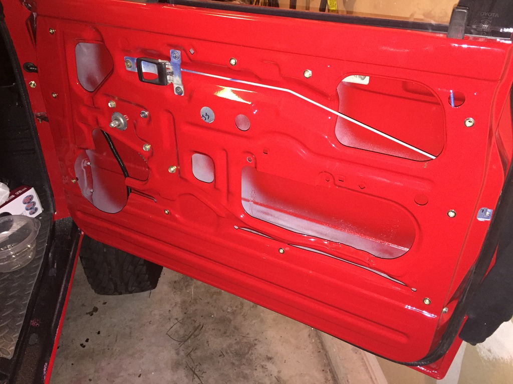

Since at some point the previous owner decided to hack the crap out of my door panels to install speakers (some people should be allowed to use any kind of saw at all!) I had to address that issue. Remember way back when I was prepping my doors for paint and I had to clean up my speaker holes in the doors? Well in doing such, I had to cut the hole just barely too big to properly mount 6.5" speakers. So now I have to make and use some speaker rings. The mounting of the speakers to the panels and the panels to the door is a little tricky, but I'll post on that later when I get to it (don't feel like explaining). I'm using T-nuts on the back of the rings to mount the speakers. Since I wanted the speakers to sit out a little more, I glued together two pieces of 1/8" MDF.

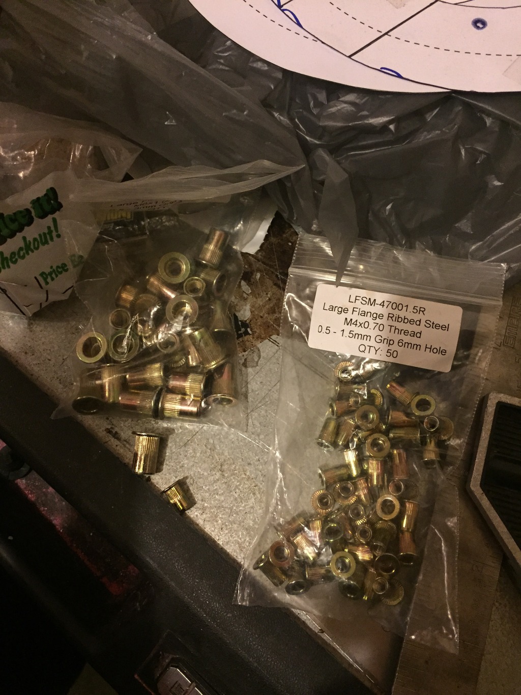

I am using rivnuts and stainless flat head allen bolts with finishing washers to mount the doors so I had to install some Rivnuts in the factory mounting holes. I love rivnuts!!
Once everything is cut out and ready I'll cover it with black vinyl
Between MDF, Vinyl, hardware and rivnuts, I only have roughly $30 into my door panels. These panels aren't intended to be the permanent panels, but I need something to essentially hold me speakers in place until I have the time and spare cash to make something better - I'm thinking fiberglass eventually. My Pops also had some left over DynaMat from when we did the floor and doors of his Camaro so I'll use that on the back side of the door skins kill some sound.

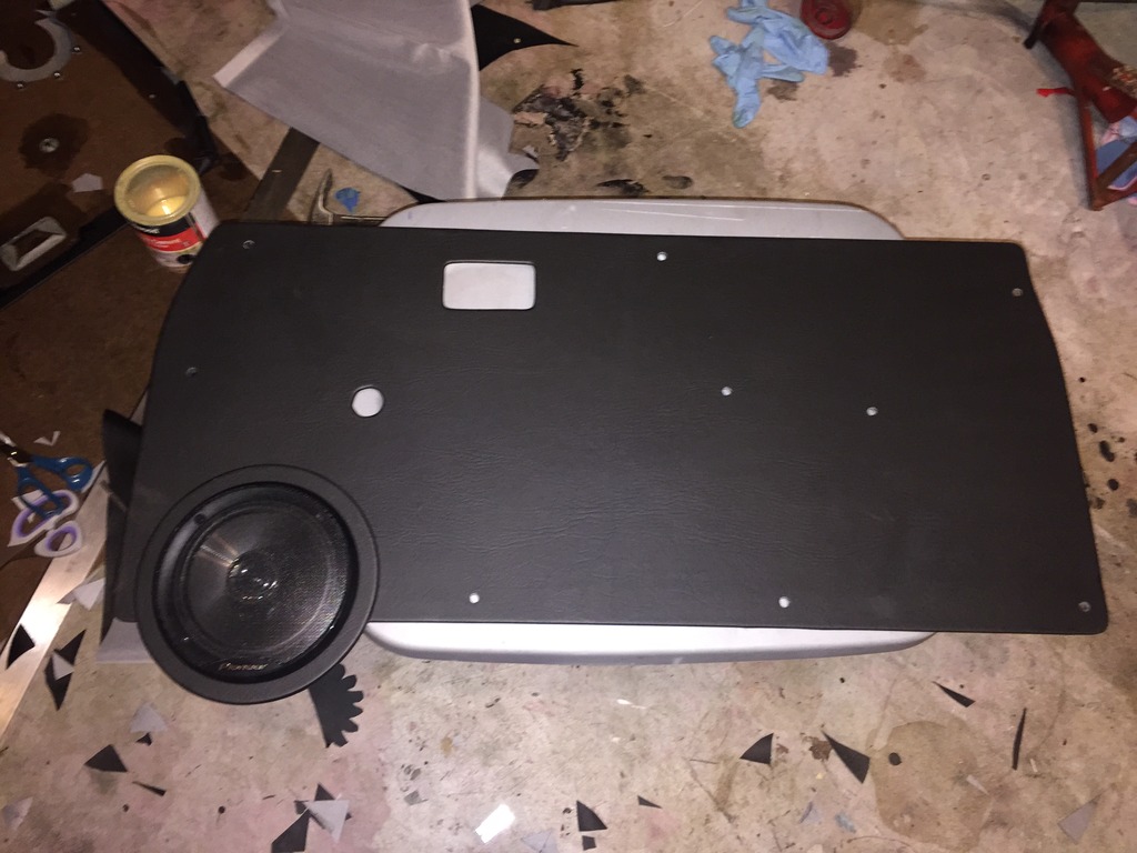

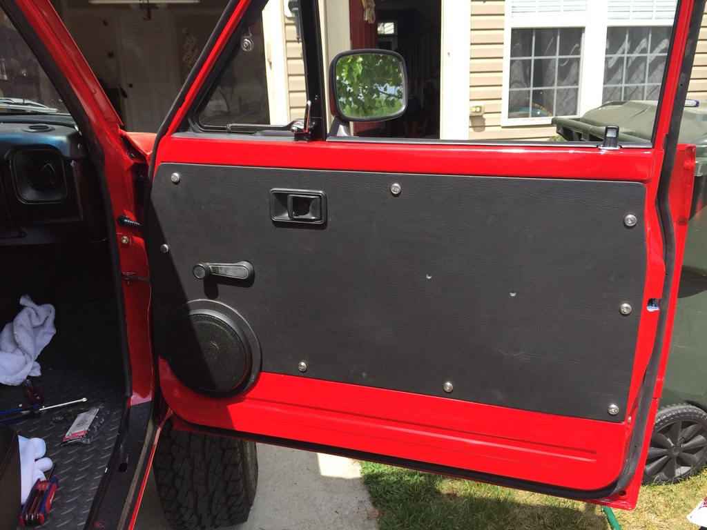

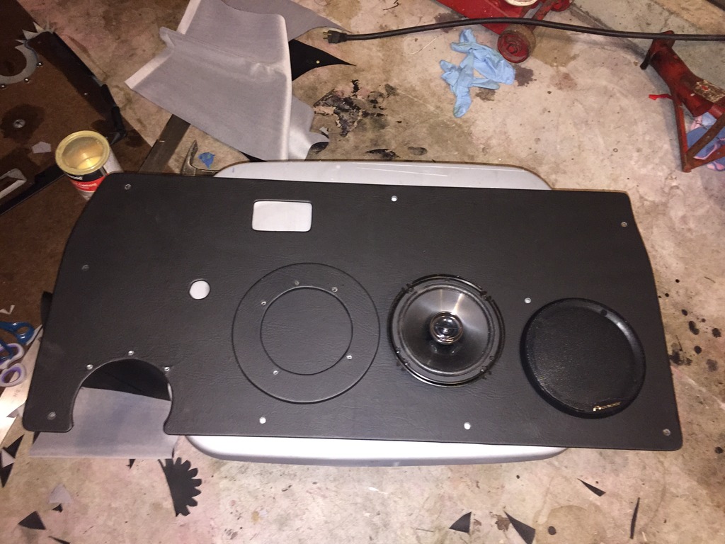

Got the door panels done tonight. I think they turned out pretty good! Given the amount of contact cement that I used, the vinyl will have to got throught a nuclear holocaust before it delaminates.
Here are the pieces that I had to make from where the PO FUBAR'ed the speaker hole:
And the parts put together for the passenger panel:
And the final product for both sides:
It was getting later tonight (3am) so I'm going to mount them to the door panels tomorrow morning before heading to the beach. Should be a 10-15 minute task.
All I have left to do is wrap factory the door handles in vinyl. Not sure how I'm going to do it, but I may recruit the assistance of my Ma to stitch them up for me.. She's the sewing whiz (she's even teaching my wife to sew) so she can likely work it up for me.
