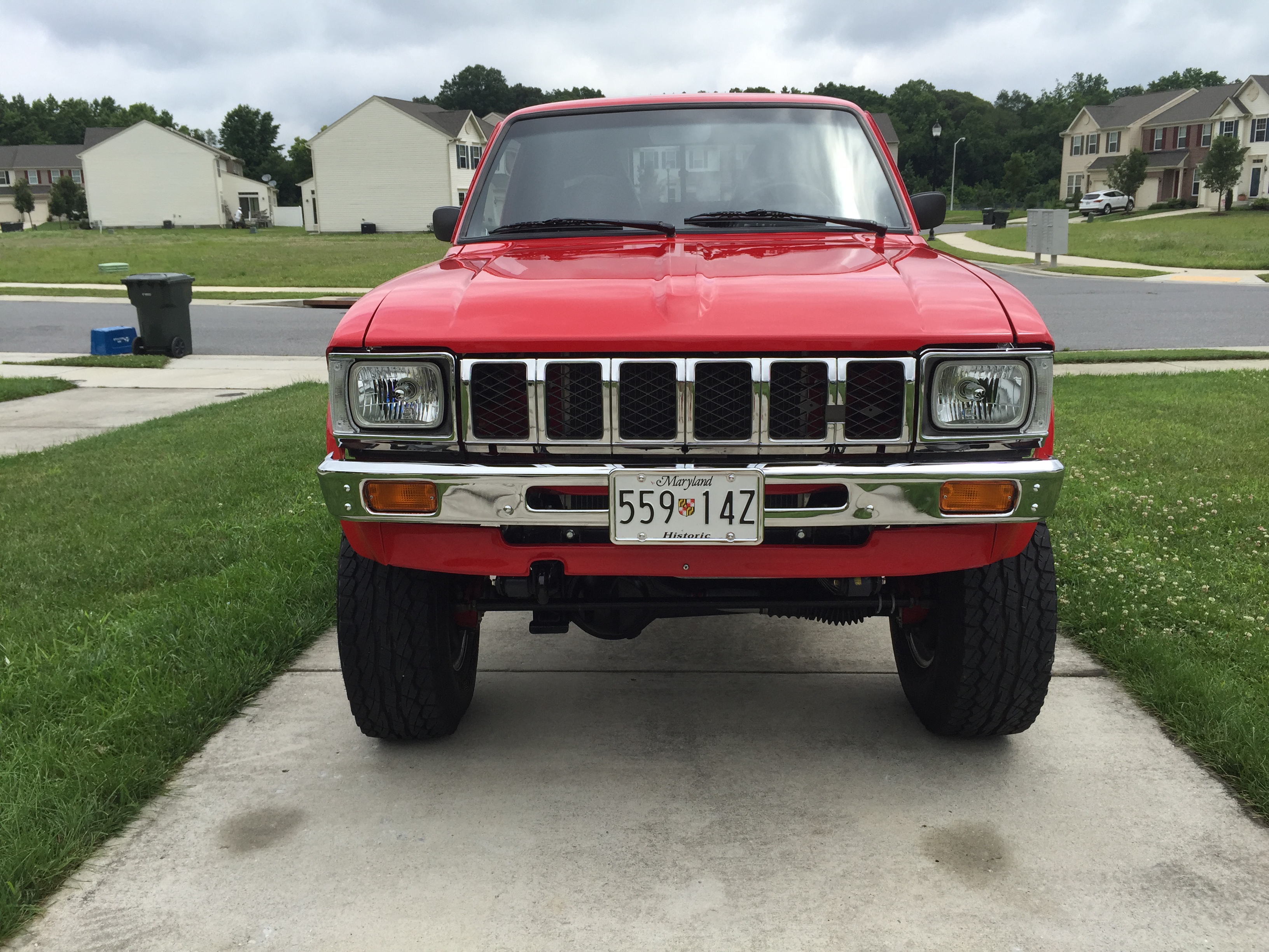

All the same on the truck front. I finally got to drive it this past Sunday when the rain finally let up. The t-case brake was a little tight on the rotor so I had to pull the caliper back off and add a washer to space the caliper back off of the rotor a hair. After that, all was well! Holds the truck still on fairly considerable inclines and resists movement pretty well when I try to release the clutch with the brake engaged. It by no means will stop you on a dime when driving, but it is certainly doing the job that I need it to do which is a parking brake! I'm pretty satisfied so far.
We have a pretty big car show about a hour up the road in Harrington, DE on the last weekend in June. I plan on taking my truck up there, but right now I am working on getting my Pop's truck ready for the show. He has a 1955 Chevy Pickup that has a custom fabricated extended cab. I've showed you guys before, but here it is again:

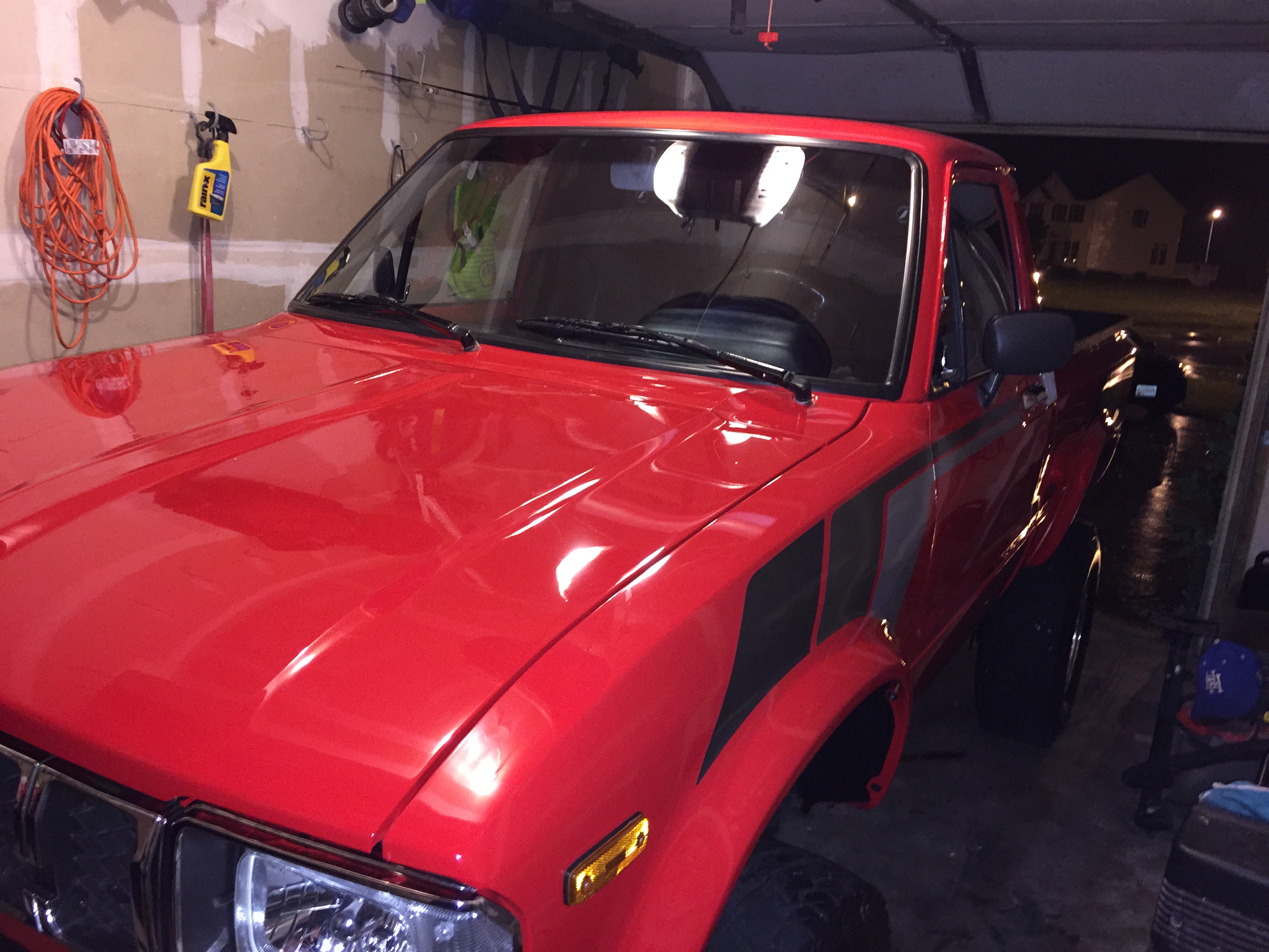

All I have left to do is so dress up. No "after" pics yet, but I'm working on making this look pretty:
Lots of chrome and aluminum to polish and since my Pops is lazy and doesn't like cleaning his engine, I'm going to clear powder everything that shines under the hood. It won't be a sparkly as properly polished metal, but it won't look like crap when he decides to not clean it as often as he should.

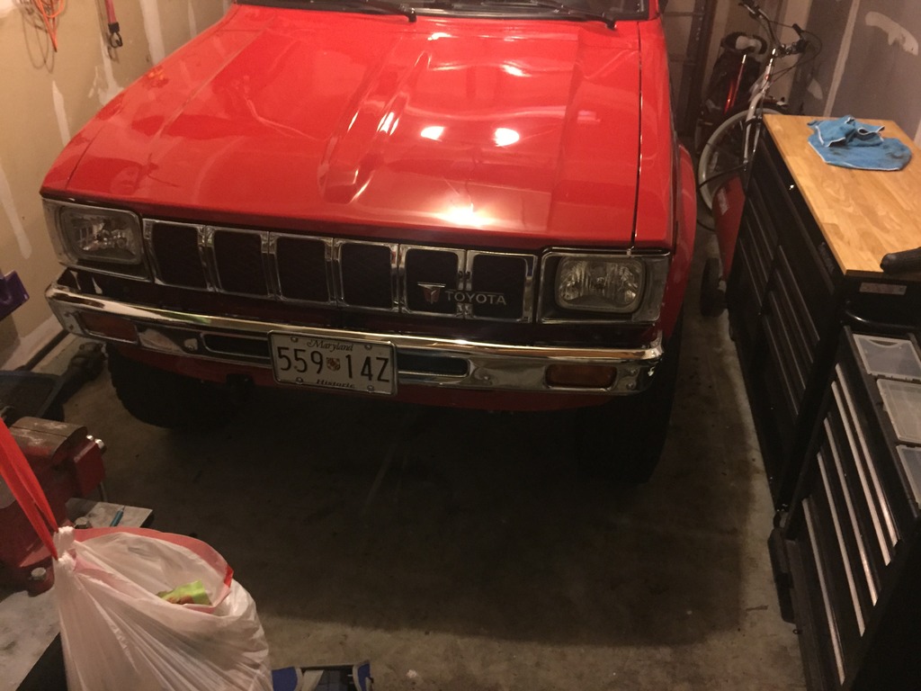

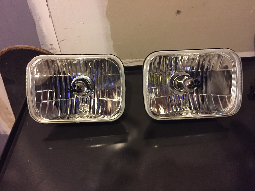

About a week ago I scored a nice set of Round Eye H4 headlight conversion lenses for a really good price from a member here on YT. They were sitting on my front door step when I got home tonight. They were apparently used for about a year, but I certainly can't tell! They also came with yellow Piaa Plasma bulbs which I absolutely love driving behind but I don't like the look for my particular truck so I'm going to have to run out and get some new bulbs before I install them or I might put the Piaa bulbs in my Tundra and swap the Silverstar Ultras over to my pickup. Here are the Round Eyes in all their squared glory:

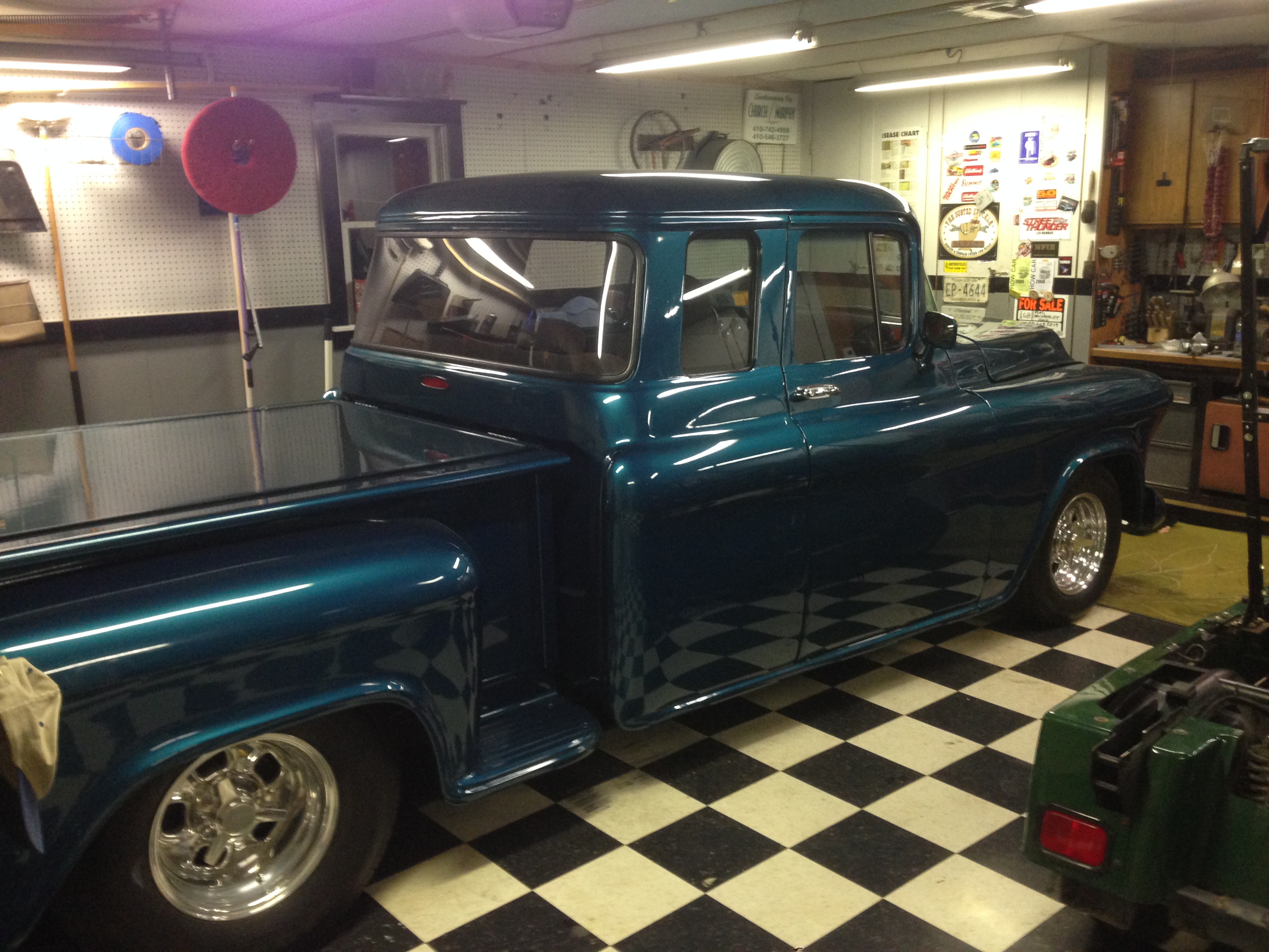

Hopefully I'll get to installing those tomorrow night. I've been tied up with my Pops' 55 Chevy for the past couple weeks so time has been short. I have the long block put back together, but not like I wanted to do it... A little more finishing work to do and I'll have it all slapped back together just in time for the Car show next week. Talk about a stressful deadline!! And to top it all off, the new intake manifold and carb may not be here in time so I might end up putting the old nasty ones back on! Hopefully that is not the case

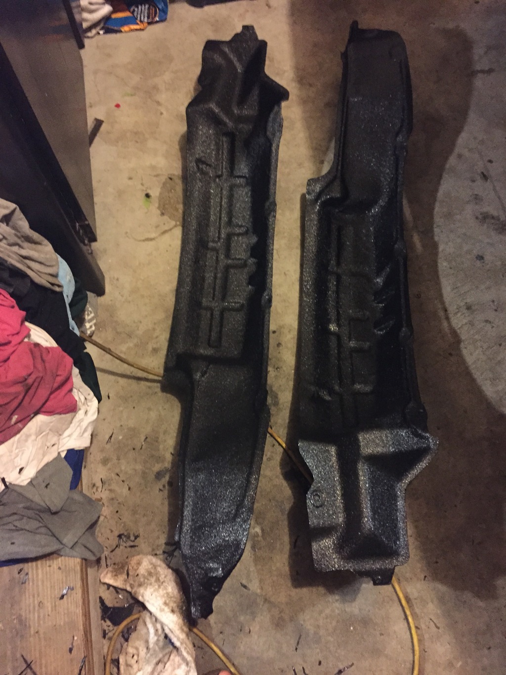

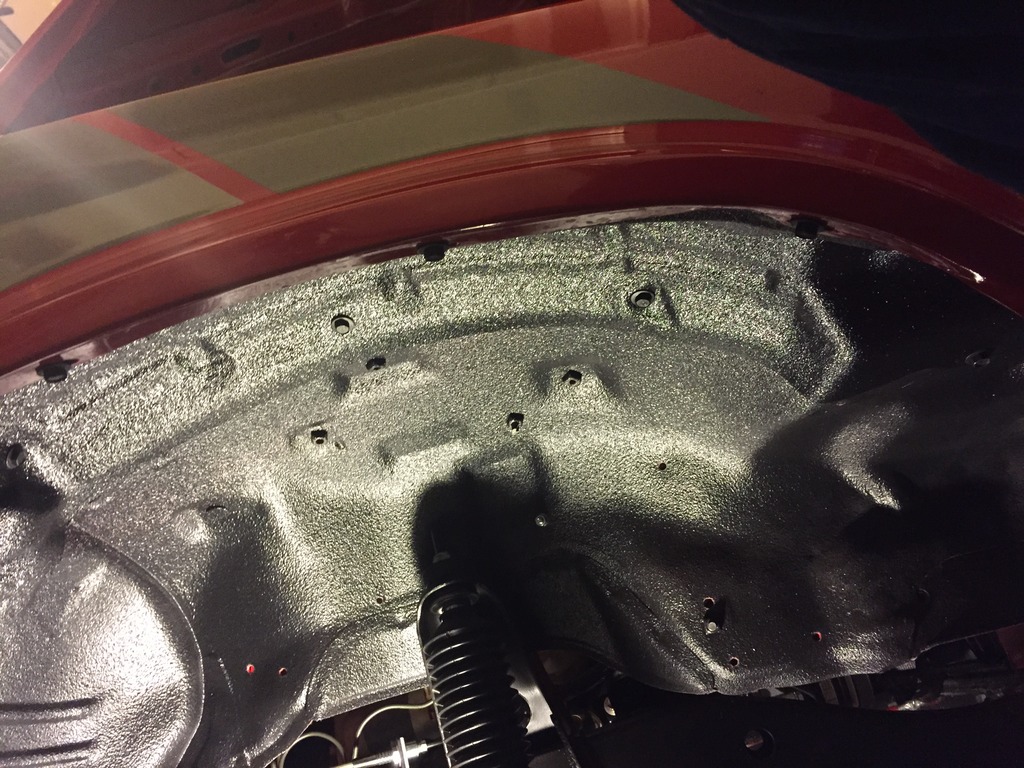

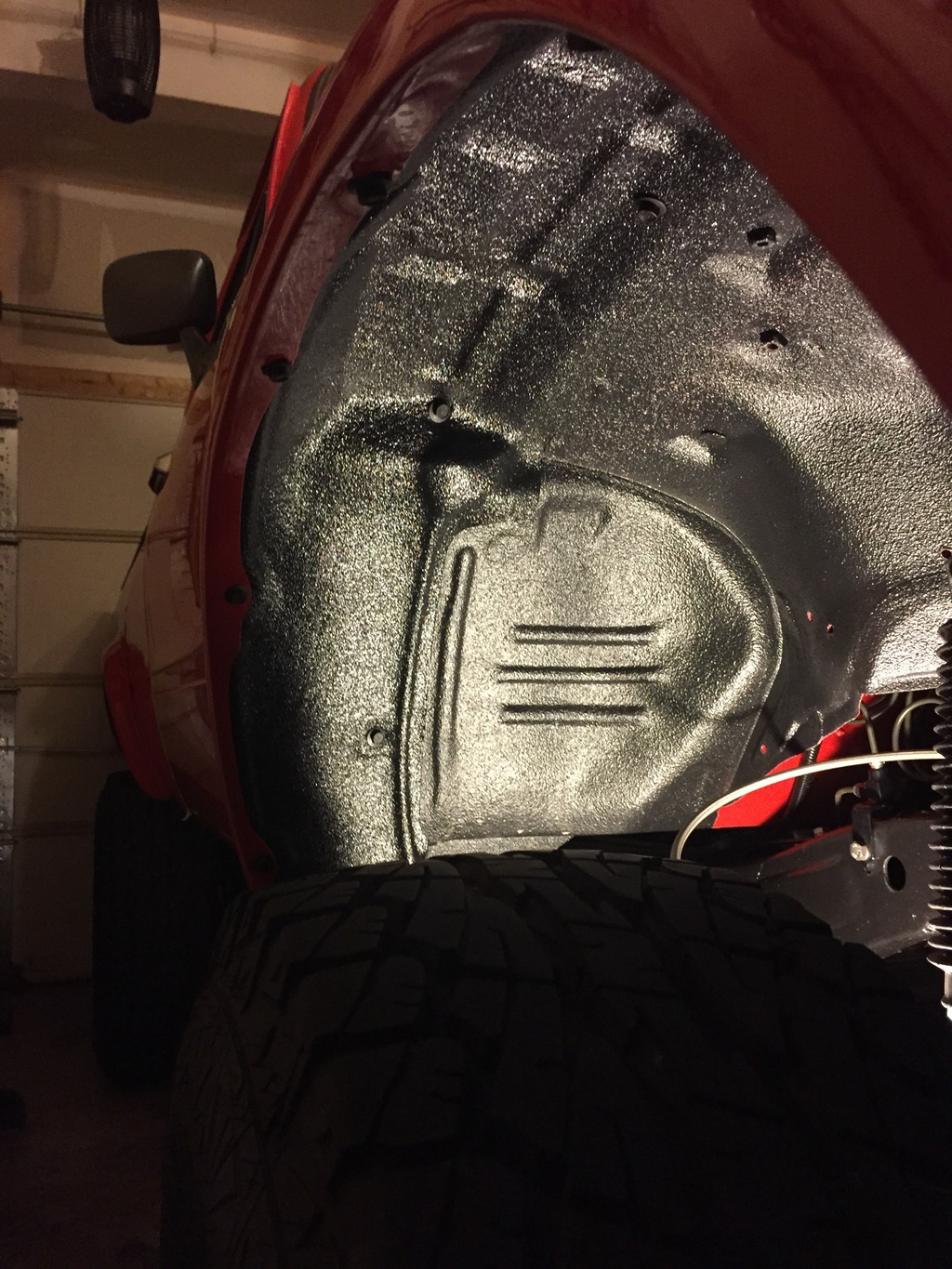

I have been getting the run around from several people who supposedly have a set of fenderliners, but they either want me to pay a ridiculous amount for them or they say them have them but flake out and never return my messages. Soooo.... I took it upon myself to fix the ones I have. Since a bunch of tabs were cracked and they pretty much looked like crap I decided to have them sprayed with bedliner. I put duct tape on the back side of the tabs that were cracked to stabilize them and act like a form for the bedliner to form to. Then I took them down to friend's shop who just started doing spray in bedliners. It's the same as Line-X but if you recall, Line-X has forever lost my business. The idea worked like a charm! Only had the spray the wheel side and they came out looking better than just plastic.
Results:
After a few hours of cleaning, polishing and waxing I am not ready to hit the road for the show!!
Results:

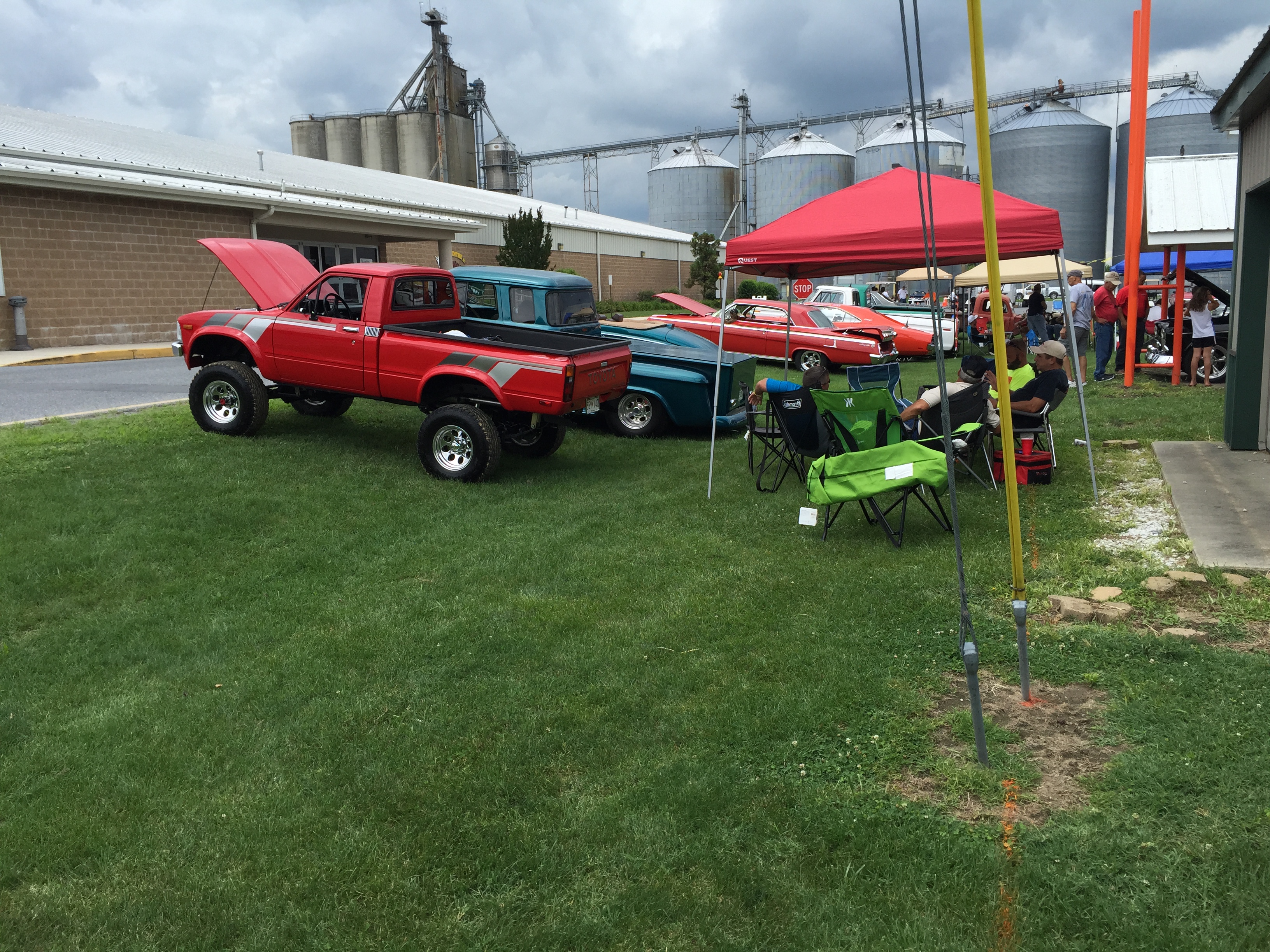

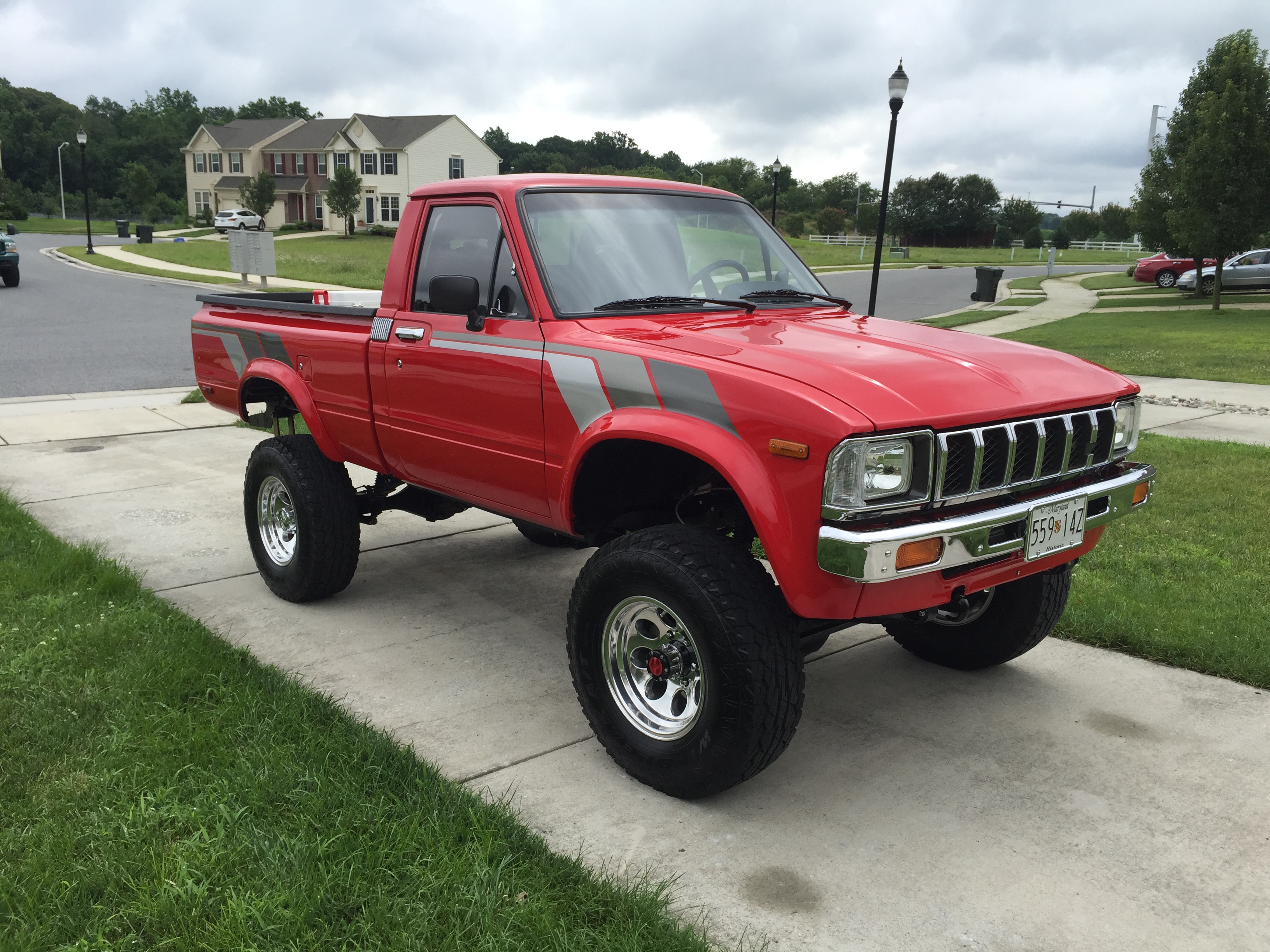

Got the truck loaded up and ready to roll this morning - finished cleaning it up too
Corey, this one is for you... Tried dodging rain drops on my way but wasn't too successful

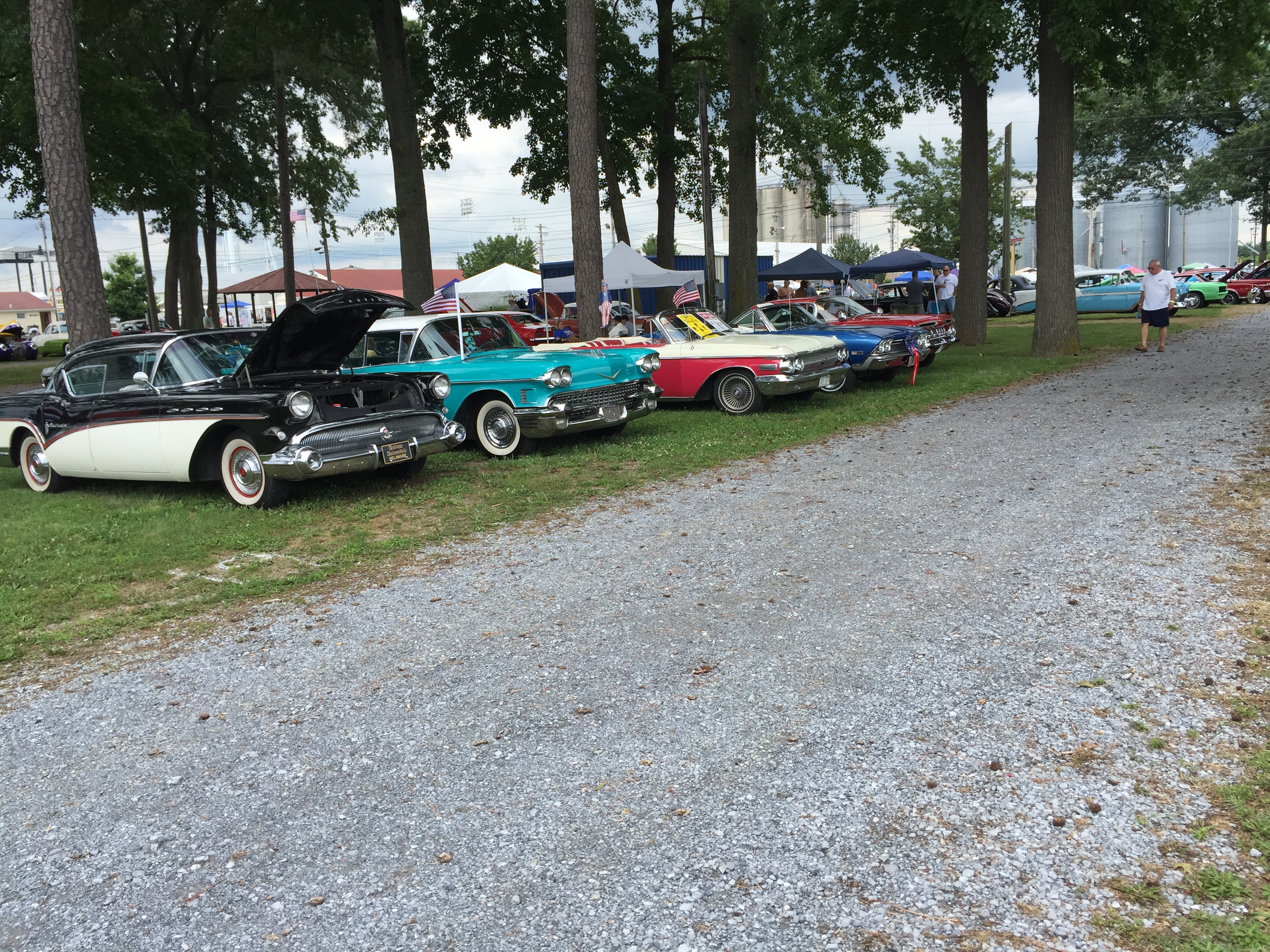

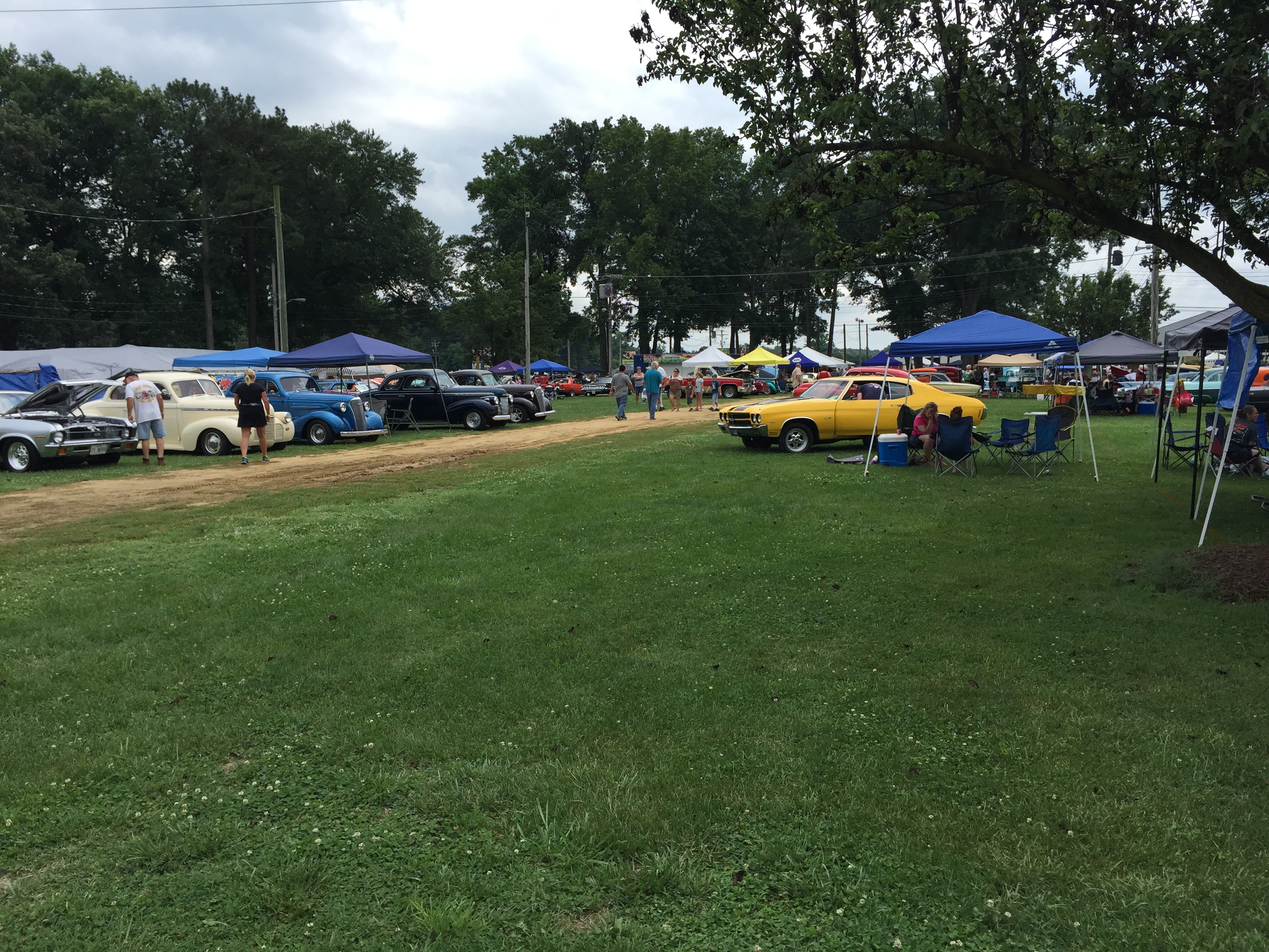

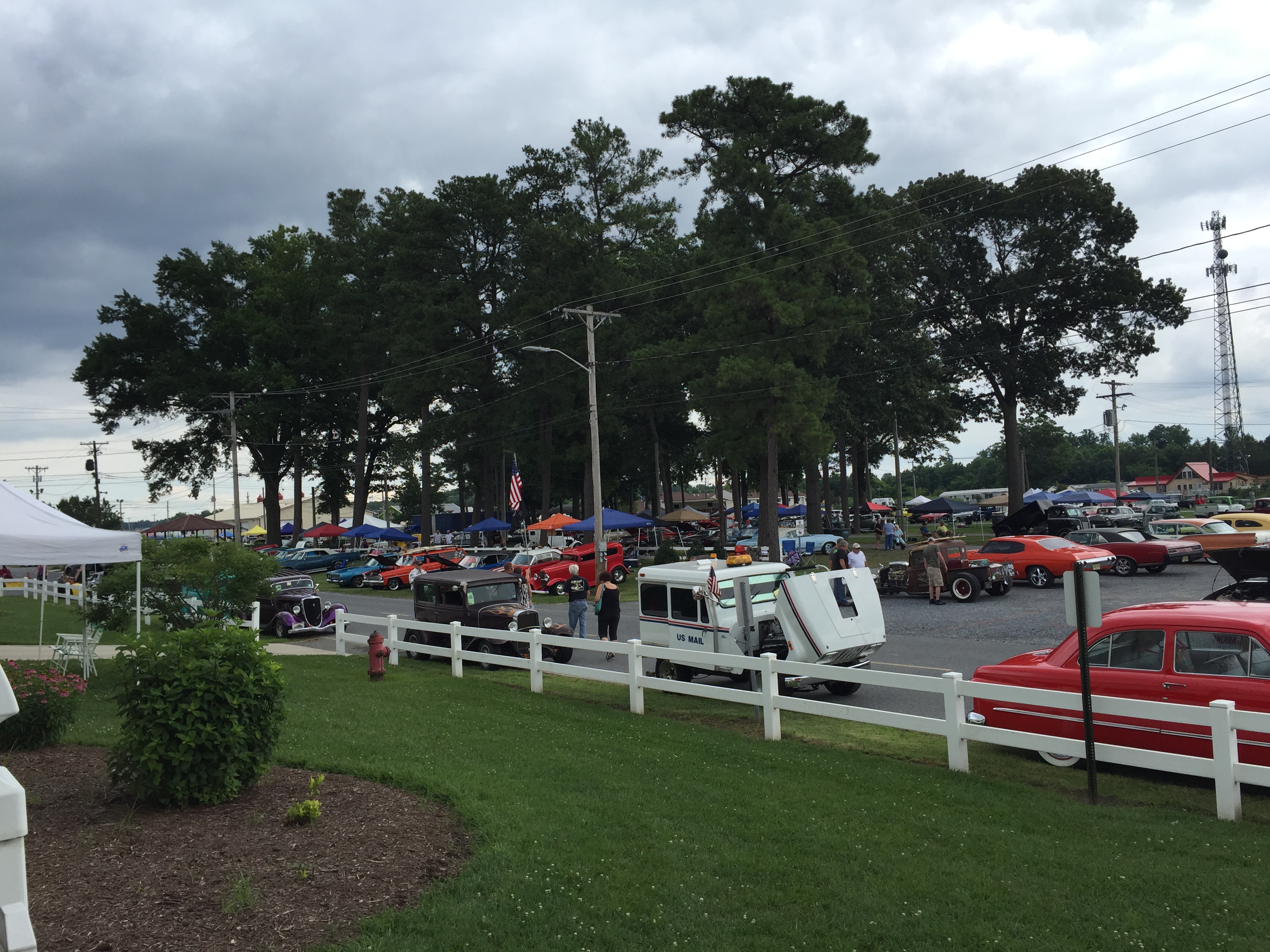

And some shots from the show:
And that's only about a quarter of the cars that will be there! I was the 560th registered so we should see about 2000 cars here this weekend. More to come!

Nice save on the fender liners, those things are unobtanium.
I was thinking my options over on repairing mine, and sandwiching the cracked parts with 1/8" strips of ABS plastic and epoxy were my thoughts.
Also, have you considered using oversized washers behind the mounting screws to increase their footprint? That was another thought I'd had: bigger foundation, less energy concentrated onto a smaller area.

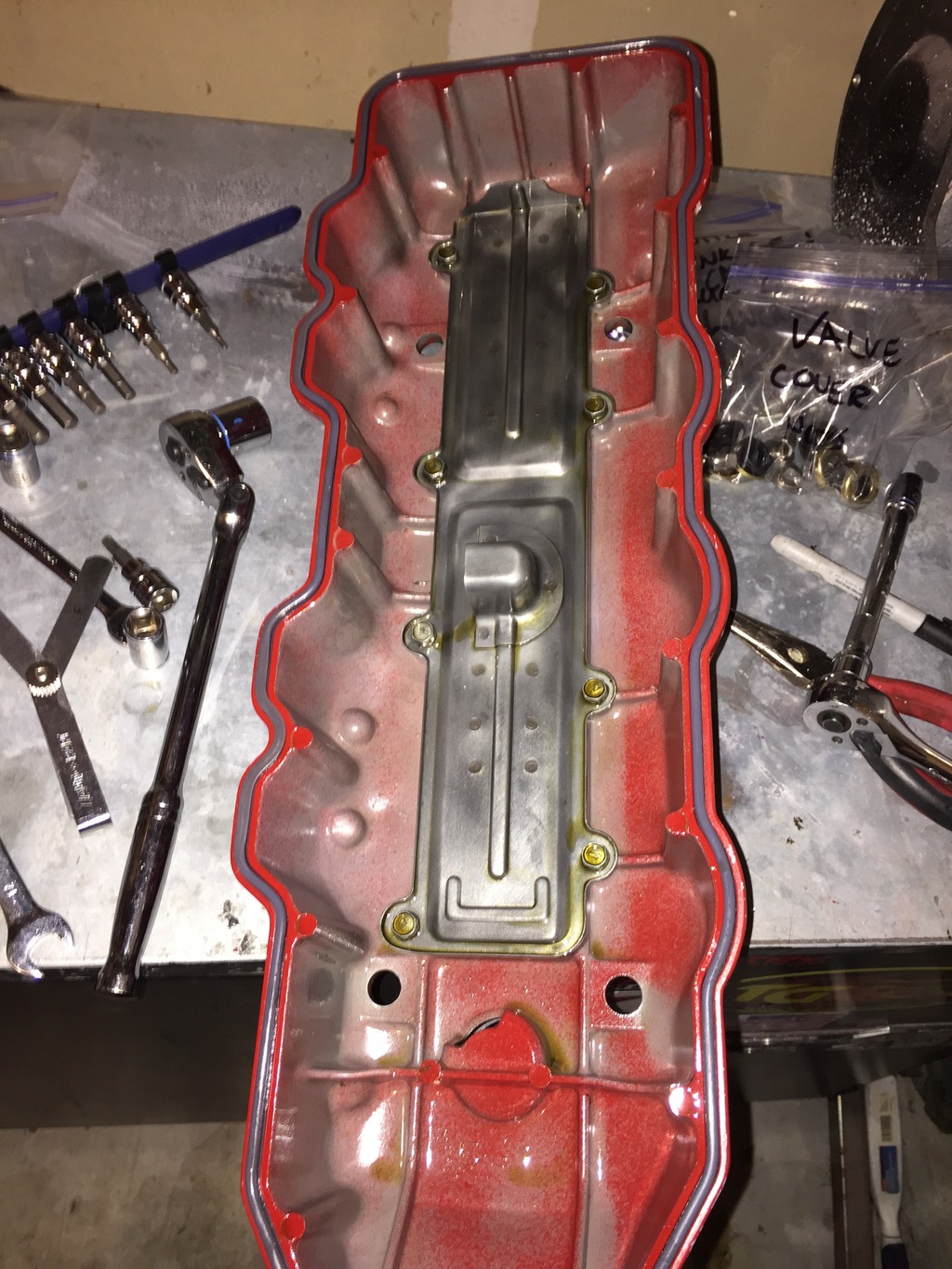

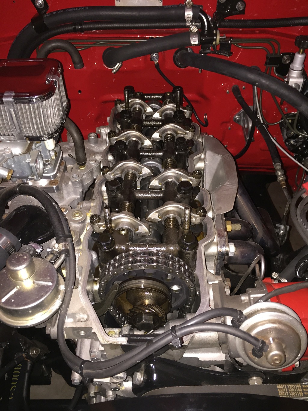

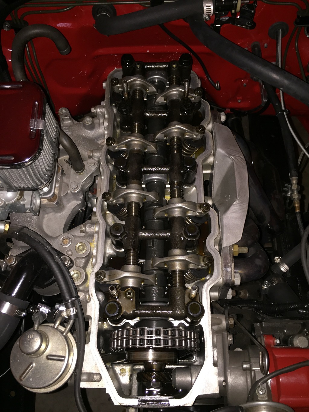

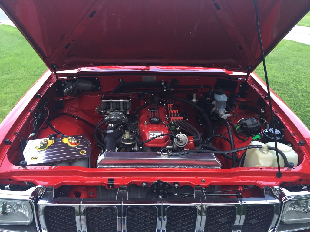

Tonight I decided to go ahead and pull the valve cover off to check the valve clearance and do some light dress up that I have been meaning to do. The valvetrain looks just as good as the last time I saw it before she was fired up! She is running really healthy and clean - the oil in there now is about 450 miles old and it still has a nice clean golden color.
The valve clearance was a little loose which is what I had expected with the new camshaft. I was also starting to get a little extra valve chatter over the last couple hundred miles so it was about time for the first check-up. The Camshaft break in looks good so I just tighted the valve clearance and it should be good for a while. While I have the valve cover off, I'm going to strip it down and powdercoat it, along with some other small parts that I didn't already powdercoat.

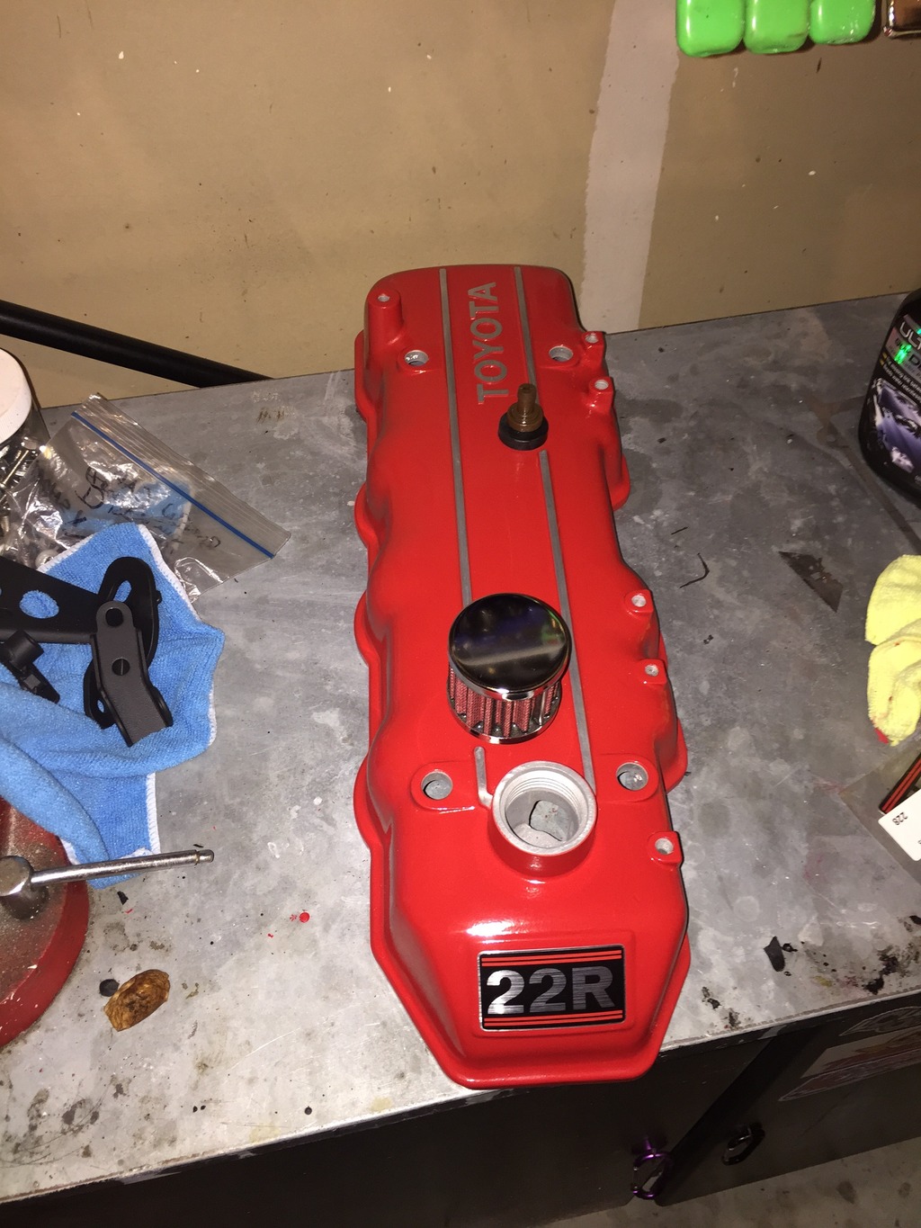

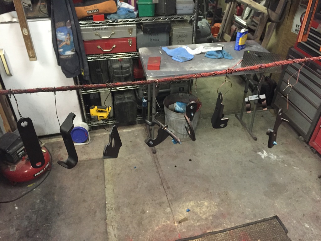

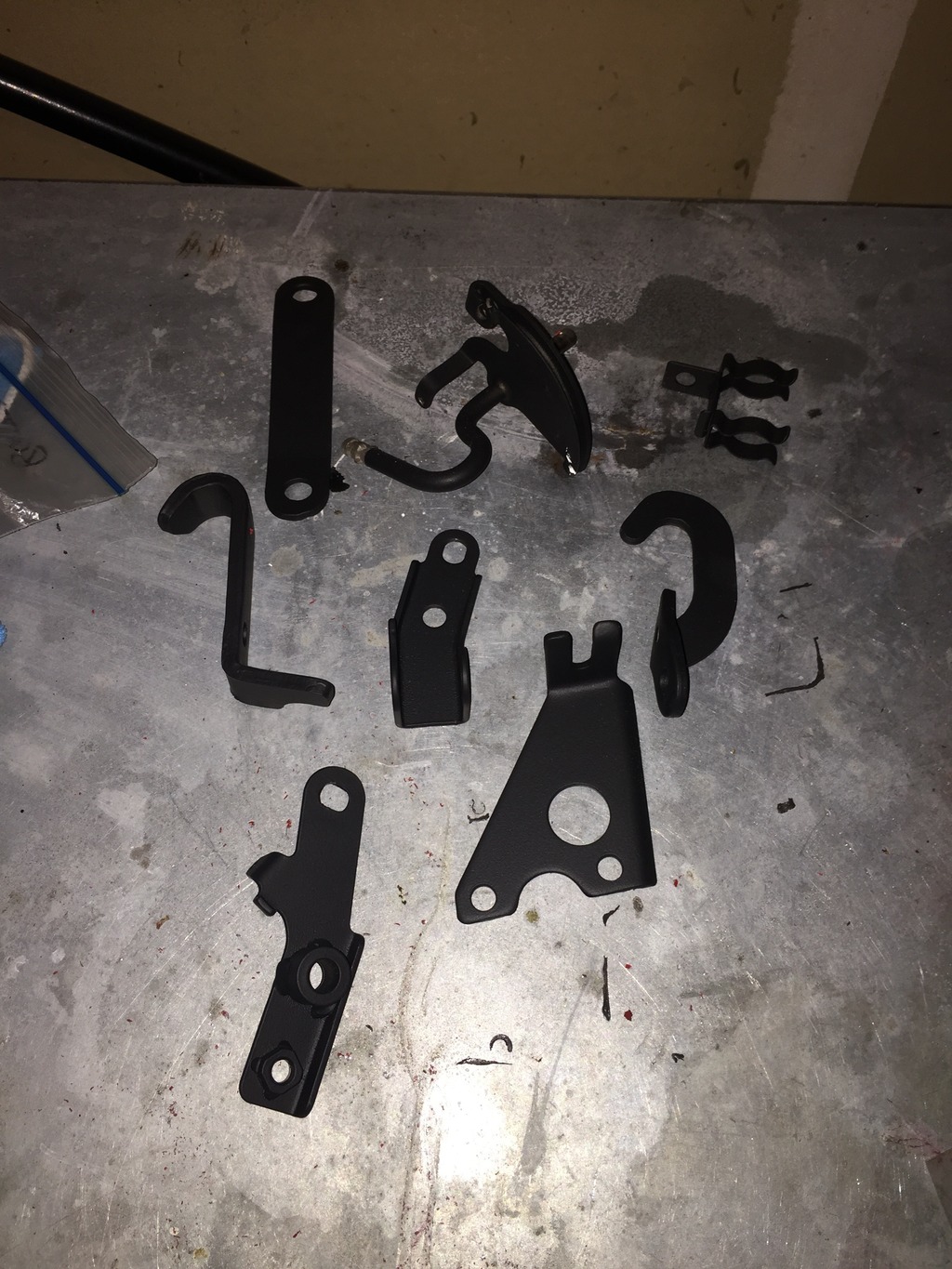

Had a little powdercoating session tonight - hopefully the last one for a long time! I shot a bunch of miscellaneous stuff under the hood that I had been putting off (throttle linkage, engine hoist hooks, distributor plug bracket, etc...) and re-coated my valve cover. I got this down to an efficient production with my rope braided with wire strung across the shop for my ground to connect to my parts:
I meant to use gloss black powder but I grabbed the wrong bottle and they ended up being satin black. I actually think it will all look better in satin black so maybe it was a good mistake.
After I powdercoated the valve cover I took it over to my friend's house to mill off the raised lettering - that was much easier than using a file and sandpaper like I did last time. I also began to polish the raised areas but decided I was been a little too ambitious so I'm going with the brushed look.
Started putting it all back together tonight but I want to get new bushings for the throttle cam pivot shaft so I'll grab those tomorrow and get her running again before the weekend.

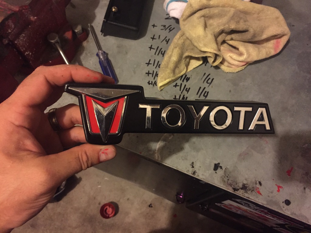

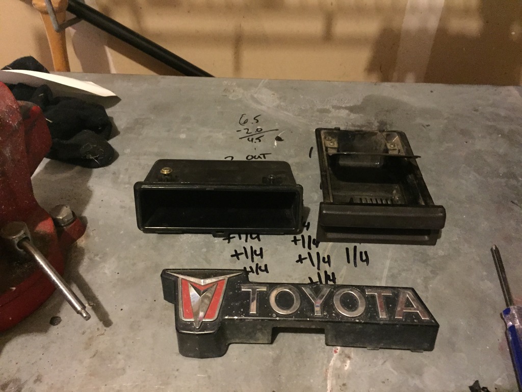

I got the grille emblem cleaned up and painted tonight. I'm very satisfied with the results - It turned out GREAT!
And the crown jewel mounted on the grille:
The exterior is pretty much done for now. All I really want to do to the exterior now is find a good fitting rear bumper (I heard old Dakota bumpers fit well) and mount some fog/driving lights. I love driving behind bright lights at night so I basically want them for the added illumination while driving at night. I'll probably go with some 4" KC HiLites mounted upside down from the bottom of the bumper.

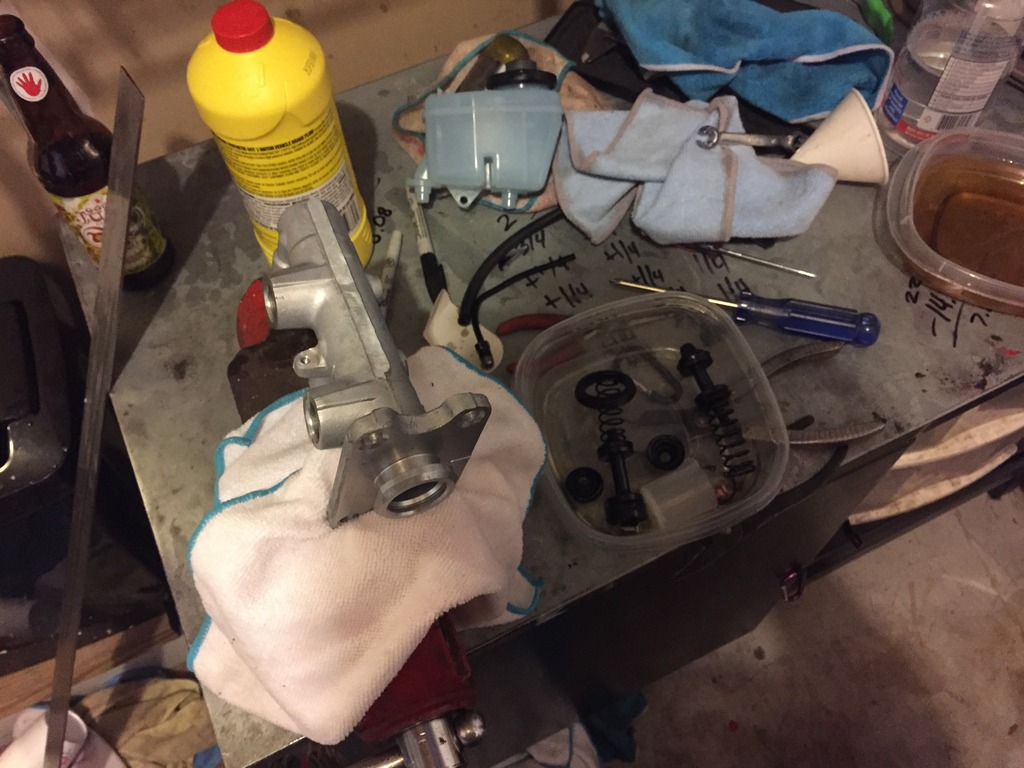

Well after getting sick of dealing with my stiff brake pedal I finally decided to do something about it... It almost seemed like I didn't have enough travel in the brake pedal so Last night I took my master cylinder off to investigate. Just to be sure there weren't any problems with the master cylinder, I disassembled it and clean it up (not that it was really dirty to begin with...). I wanted to make sure that there wasn't any debris in there that could potentially limit fluid flow. Everything looked good in the MC so I'll get some brake grease and re-assemble it this afternoon:
Then I moved on to the brake booster... I checked to make sure that the booster was receiving and holding an adequate amount of vacuum. That checked out fine. I checked the travel of the push rods on both sides. That checked out. Then I checked the push rod clearance with the MC piston. I don't have the special service tool to check the clearance the easy way, but I was able to use my calipers and a little bit of math to figure out how much adjustment I needed. DING DING DING!!! Come to find out the push rod was about nearly 3/8" too short - pretty considerable when you consider that the travel of the piston is around 1.25". This somewhat perplexes me because it shouldn't cause a stiff pedal but it would certainly limit the progressive pressure of the MC under hard braking and would hinder the ability to "pump up" the brakes. Nonetheless, I made the adjustment and I'm hoping that is it because, other than a possible frozen caliper piston, I have know idea what could be causing the symptoms. The calipers are new remans and if I did have a frozen caliper my truck would likely pull to one side and I would have uneven wear on my rotor - neither of which is present.
