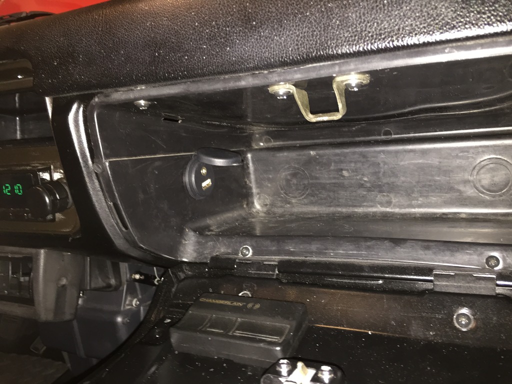

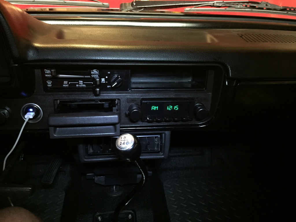

I added a little modern convenience tonight - a 3.5mm aux input and a USB input plug for my radio. I mounted it in the glove box in lieu of drilling a hole in the dash:

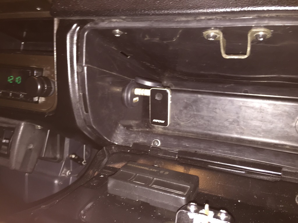

I also use a 3.5mm Bluetooth module to wirelessly connect my iPhone to my radio so I can listen to iTunes, Pandora, MLB games, etc. These things are great!! I bought on for the boat too so I can throw my phone in dry storage and not have to worry about my phone getting wet or falling overboard, but can still listen to music on my phone.

I also want to wire a 12V power outlet directly to the battery so I have a constant power supply to charge stuff when the engine is off. I definitely want to mount one in the glovebox next to the aux outlet that I mounted tonight and I may also mount one in the bed somewhere or somewhere towards the rear of the frame.
Old Jul 21, 2015 | 06:09 AM
  #1288
RobotMoose's Avatar
Joined: Jul 2012
Posts: 639
From: Calistoga, CA
I like that USB/ 1/8" jack in the glove box, it's a very neat idea.
Do you get any noise from the power side of it through the audio side?
If I have my phone pluged into the power supply and the audio plugged in via the 3.5mm cable then I do get a little noise, but if I use the bluetooth module then I don't get any noise at all.

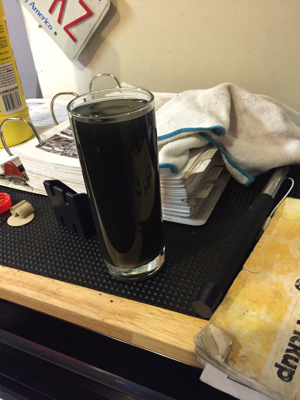

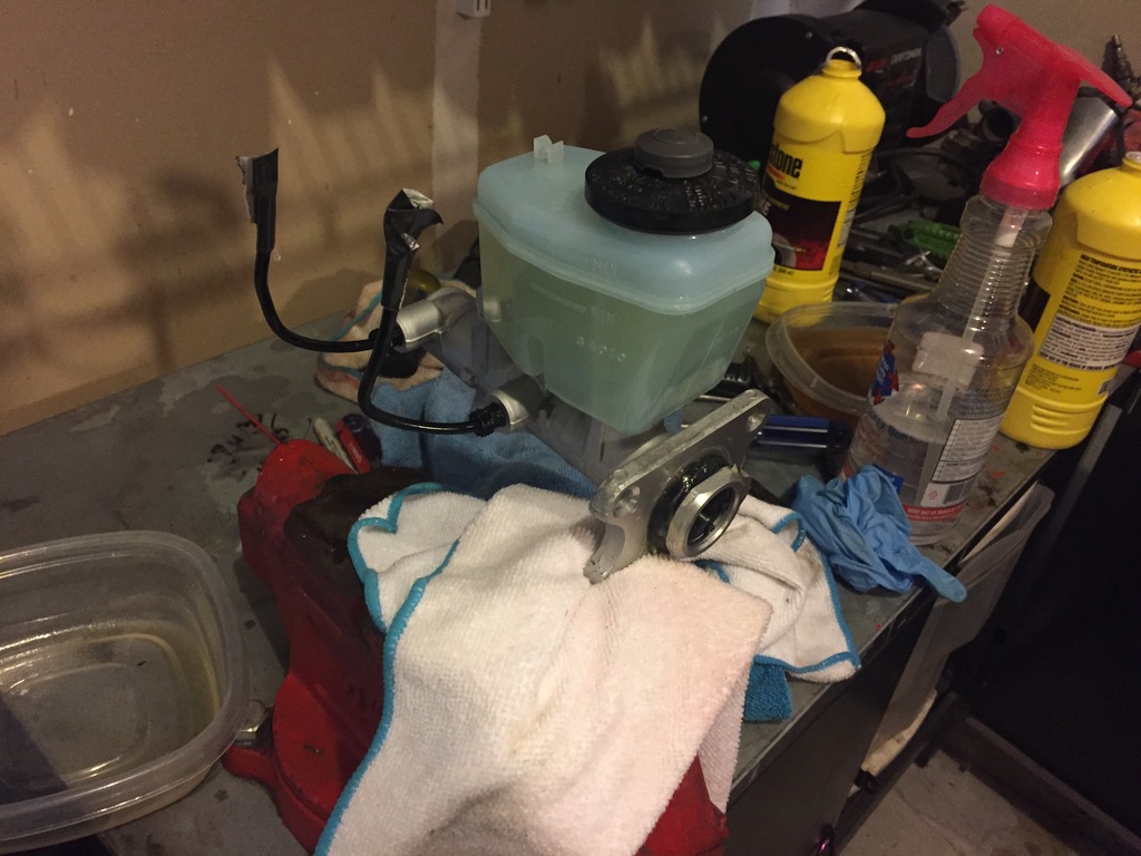

So my clutch was feeling kind of squishy and was releasing a little further out that I would like in the pedal travel so I decided to give it a quick bleeding figuring that I may have some air in the line. When I went to bleed the clutch I noticed that the fluid was coming out completely black! I've never seen this before so I completely drained the clutch system and flushed it out several times with new fluid. This is a glass full of the fluid that came out as well as the fluid that was used to flush the system:
I used Prestone DOT 3 Synthetic brake fluid which is originally clear in color. The master cylinder, slave cylinder and all the lines were brand new. I used this exact fluid on my brake system but they didn't bleed out black like this so I wouldn't assume that it was the new lines. Does anybody know what may have happened here?
Nonetheless, I bleed the system and now my clutch feels much better.

My clutch fluid also does that. It's gritty. Even with new components and a very thorough flushing it still does it. I figure it's an inherently poor design. No other explanation I can come up with.

All new components in mine as well, a year later and 3000km it is a little bit yellower than before but I've never seen black fluid like that! Maybe take a sample and send it for used oil analysis as well as some engine oil to get a break down on how everything is going would be interesting? Can it be the rubber inside deteriorating for some reason? Or aluminum oxidising? that's strange!

The only thing that I think it could be is either the seals breaking down (but everything is new) or possibly water that reacts to the brake fluid (but I let it sit in a glass for a week and it never separated). Kind of has me stumped
