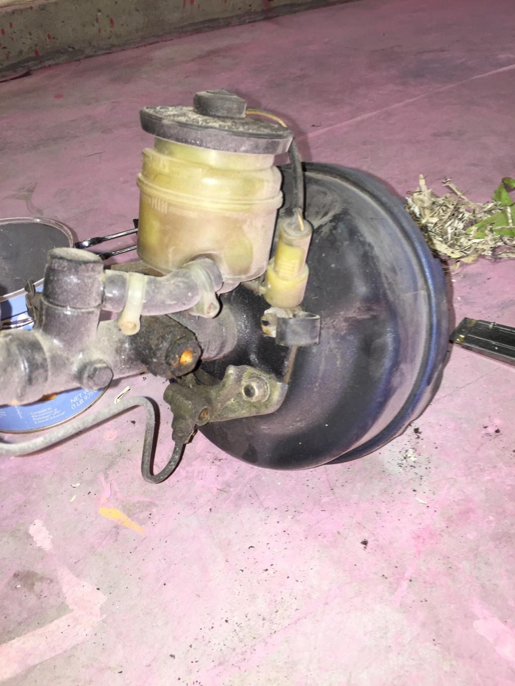

Also got these gems in too:
Both Aisin MC's. Apparently Advics is the company that took over the Aisin stuff. Both MC's have "Aisin" stamped on them. I'll powdercoat the pedal assemblies and brake booster spacer and have them installed in no time!
I hope the Toyota Santa brings you all everything you wanted!

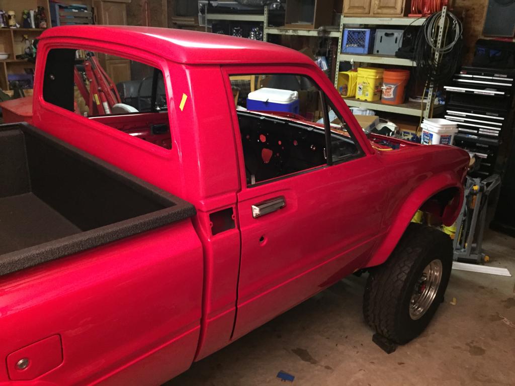

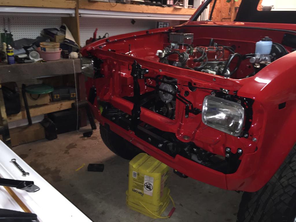

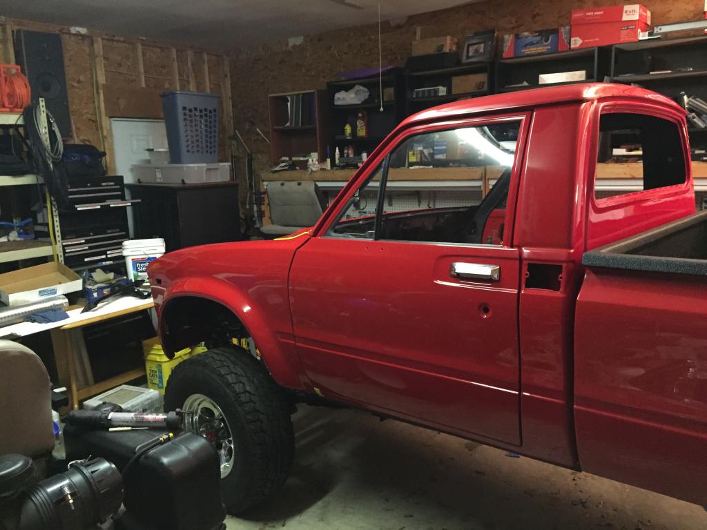

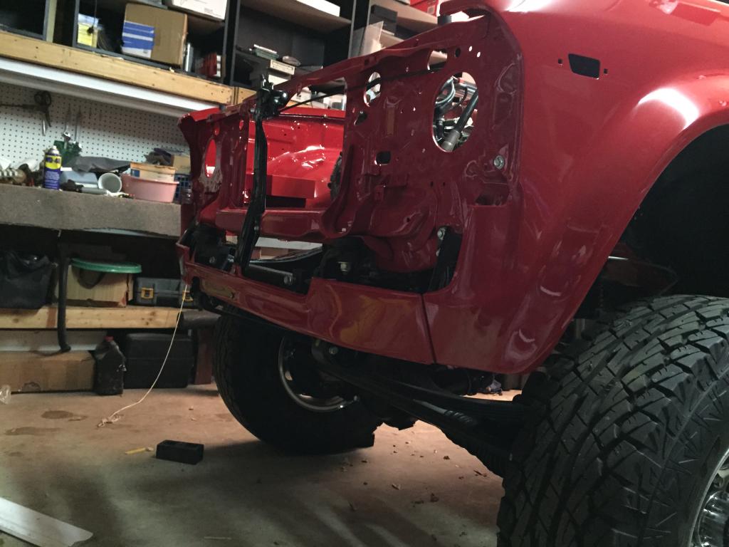

Well, thanks to Al (Thanks Al!!), I got the plug I needed for the rocker panels so I mounted the fenders and valance last week.
Unfortunately, after I got the fenders and valance mounted I realized that my driverside door was hung about an 1/8 of an inch too low and I don't have enough adjustment on the door side of the hinges so I have to yank the valance and fender off to adjust the cab side of the hinge to raise the door - the lack of access to the cab side of the door hinges is a very inconvenient design flaw by Toyota. I'll get that done later.

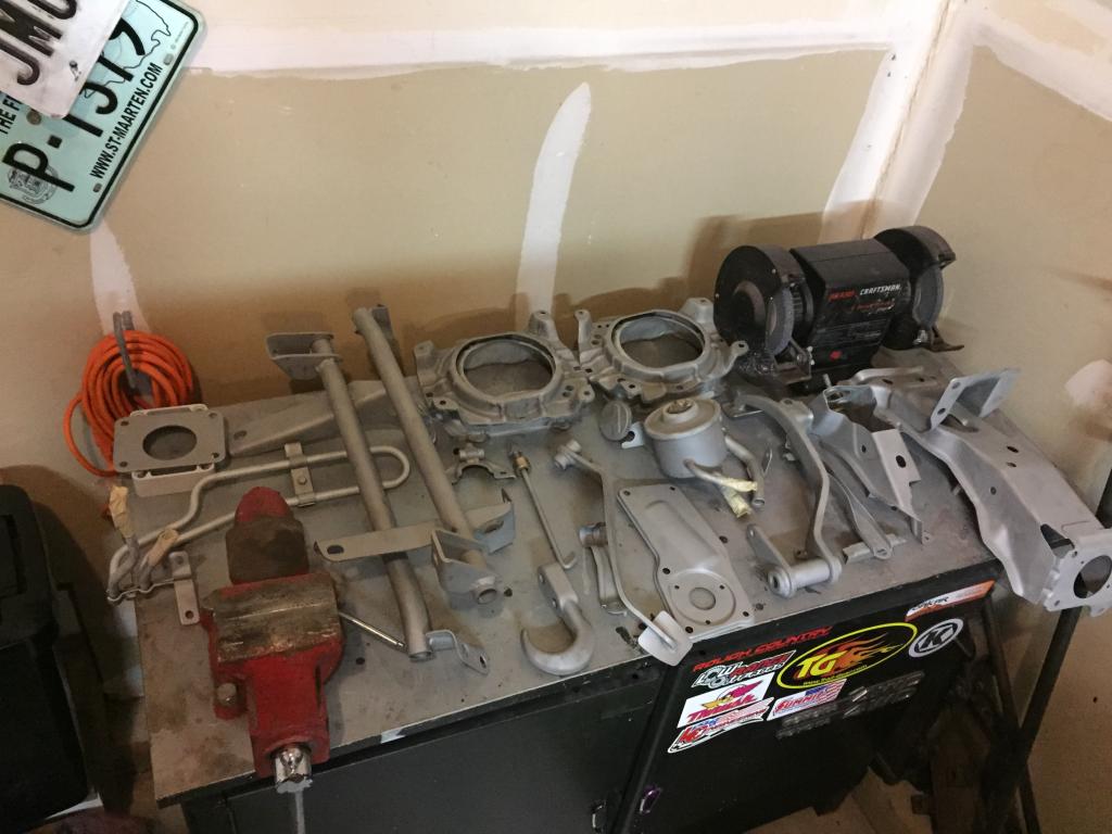

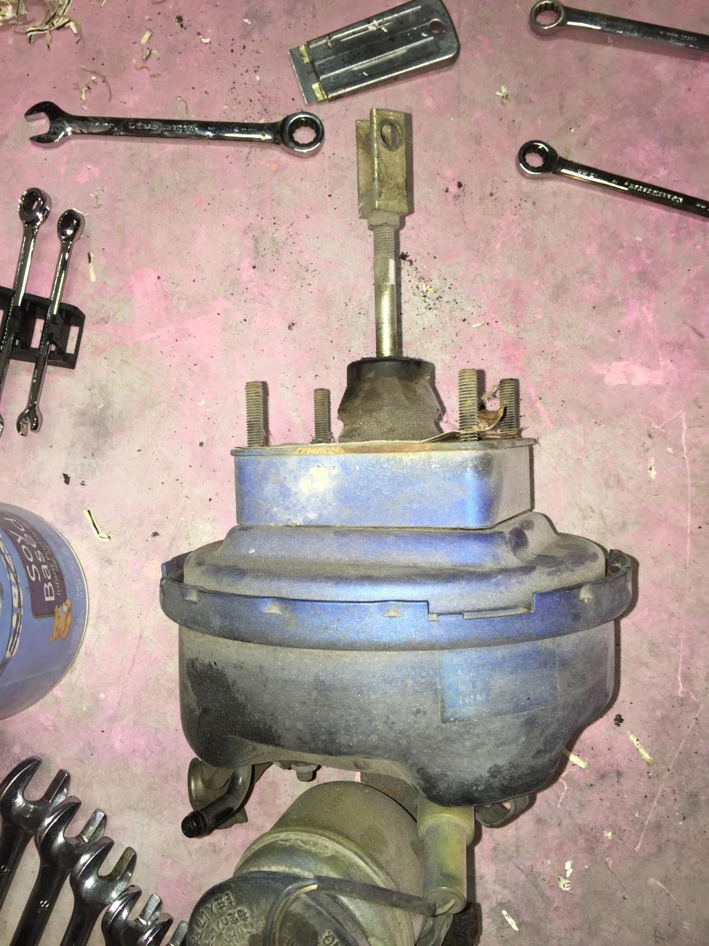

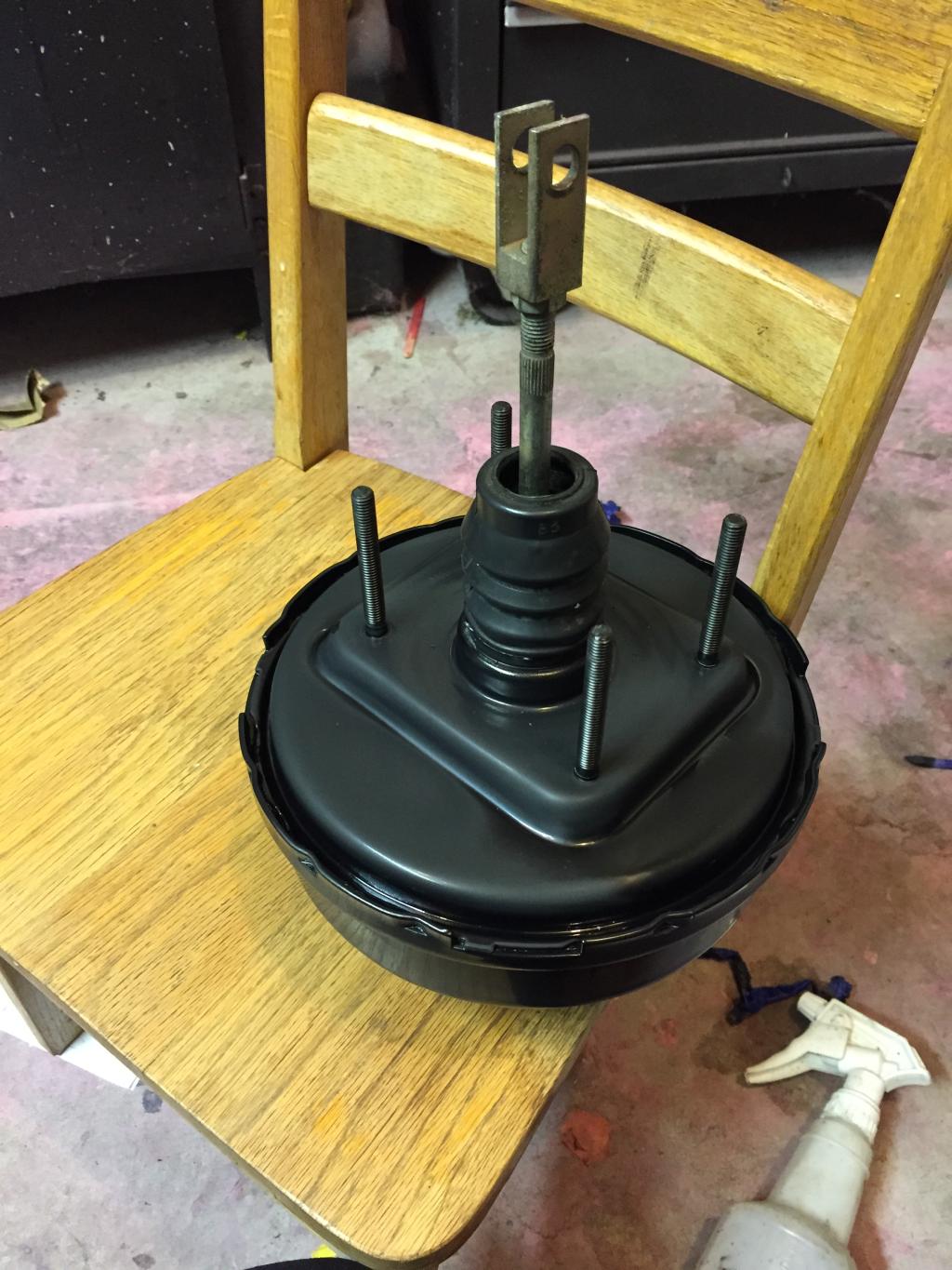

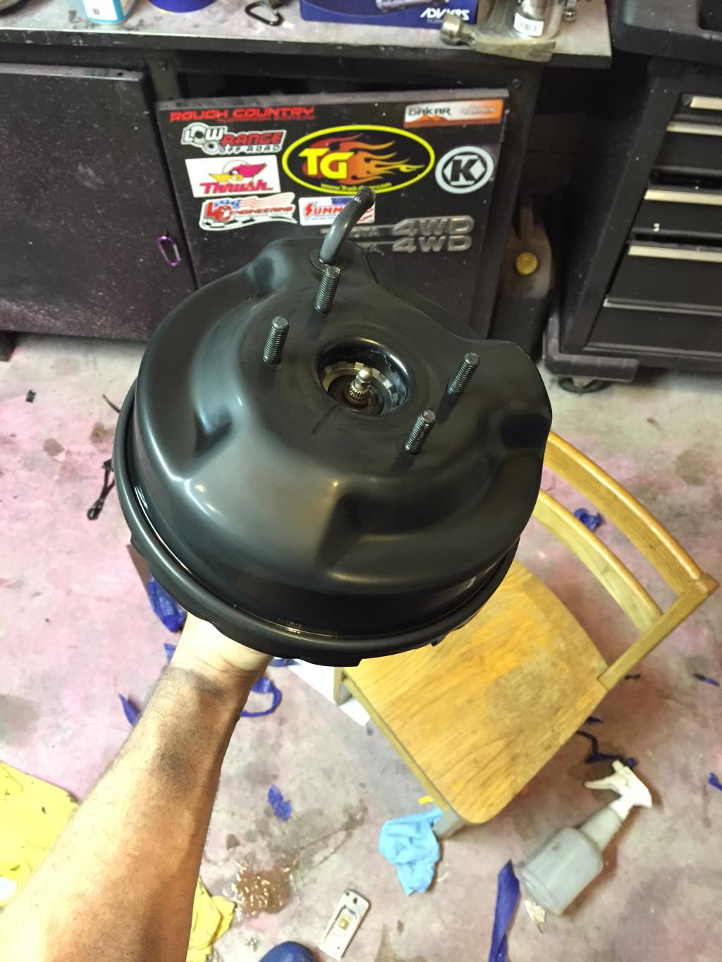

Over the holidays I decided to go on a little bit of a blast cabinet binge. After about 4 hours of standing at the blast cabinet I got the clutch pedal/assembly, brake pedal/assembly, wiper motor plate, brake booster spacer, battery tie down, headlight buckets, tow hook, bumper stays, power steer cooler and power steering reservoir all cleaned up.

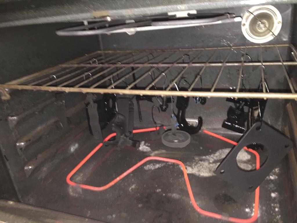

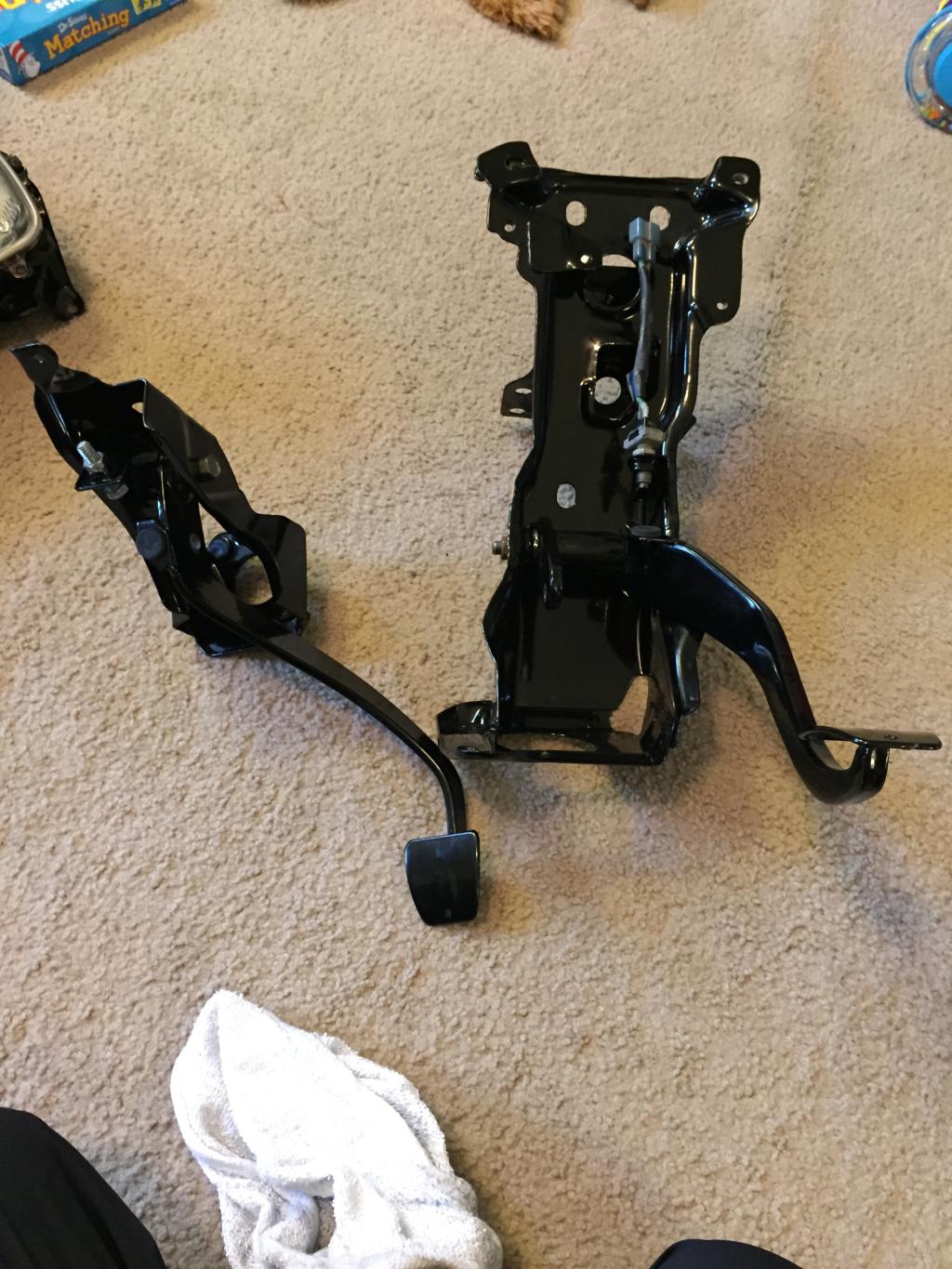

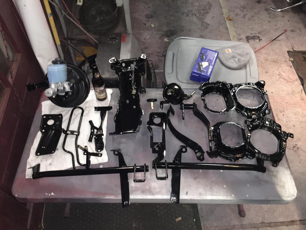

Then last night, I went on a powdercoating binge. This is what I call "baking cookies"
And fresh out of the oven:

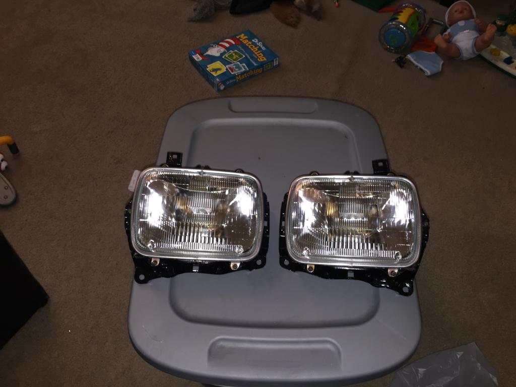

Today I reassembled the headlight buckets, brake pedal assembly and clutch pedal assembly:

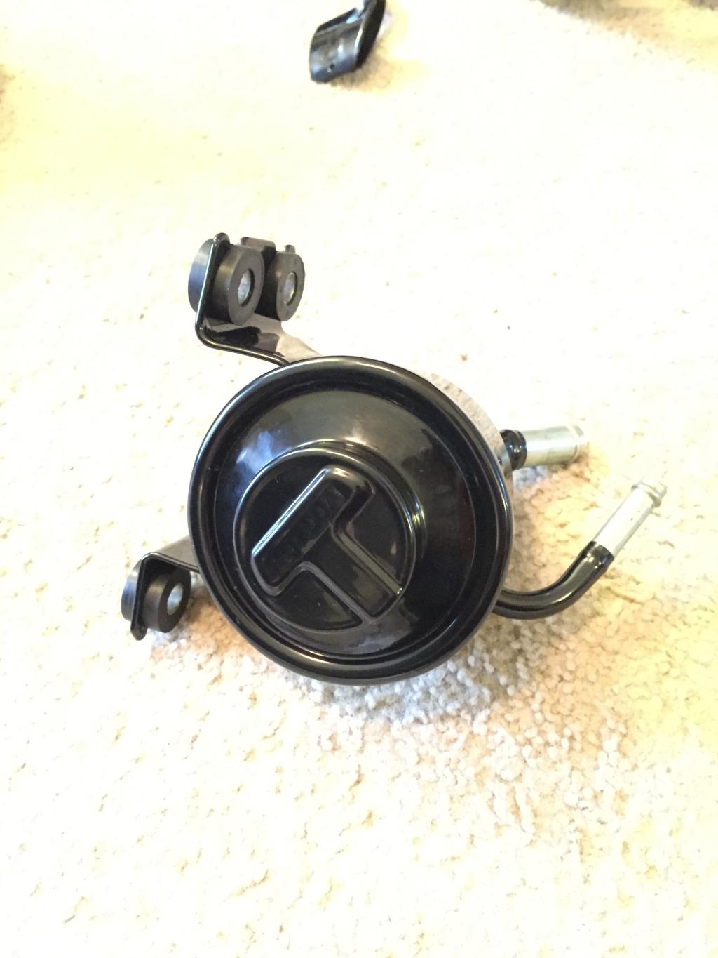

The power steering reservoir turned out great too. I was a little hesitant about powdercoating it, but figured if it didn't turn out then I could get an aftermarket one.
Now it's a matter if putting the pieces back together. This all seems small, but it is a HUGE hurdle when it comes to reassembly. More to come soon...

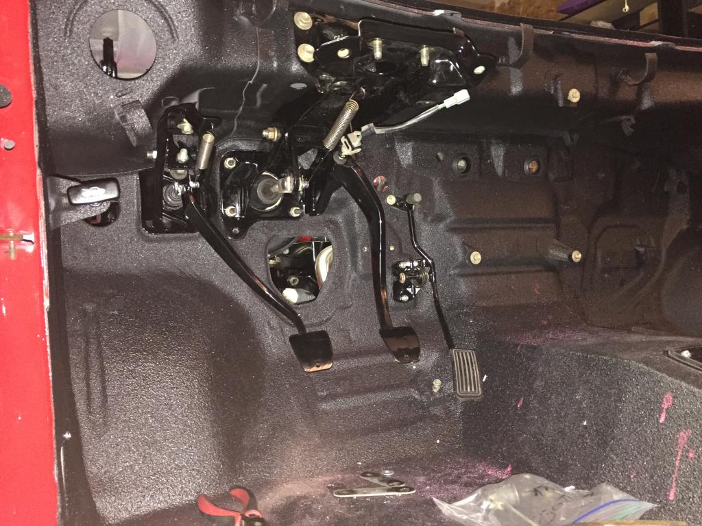

Pedals installed:

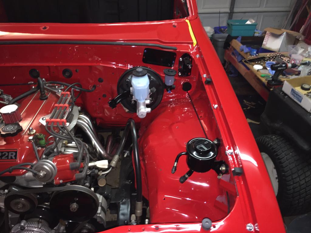

Clutch master cylinder, brake master cylinder and power steering reservoir installed:
Headlight buckets and power steering cooler installed:

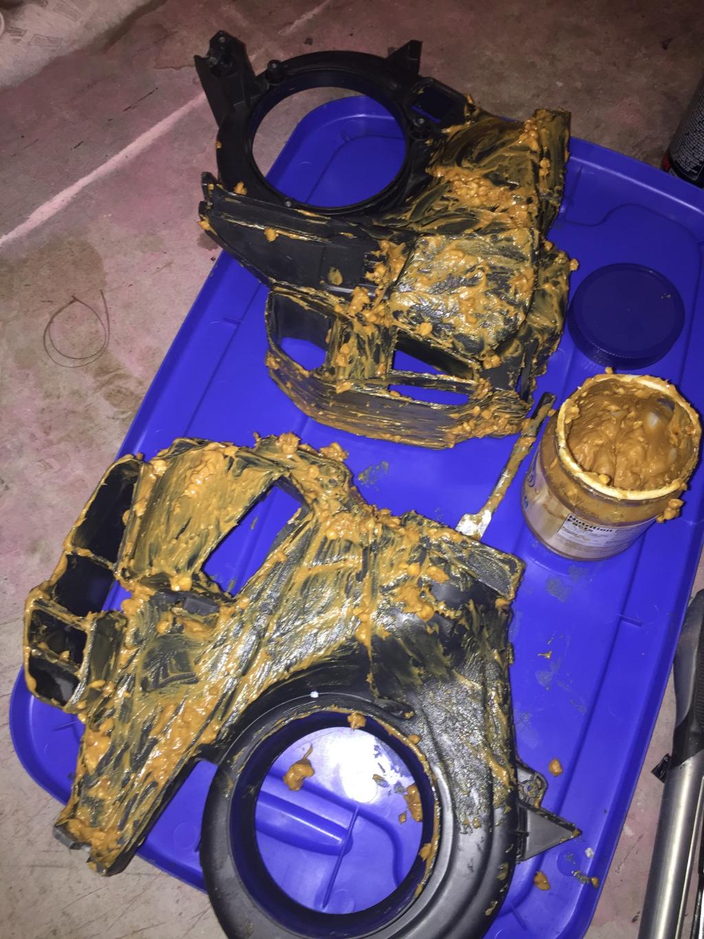

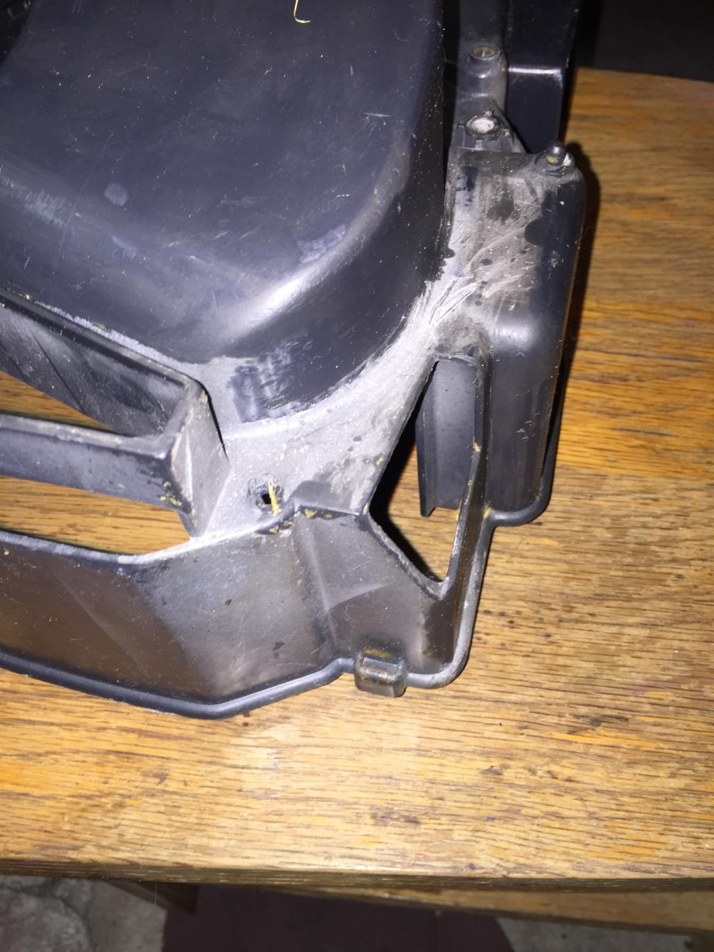

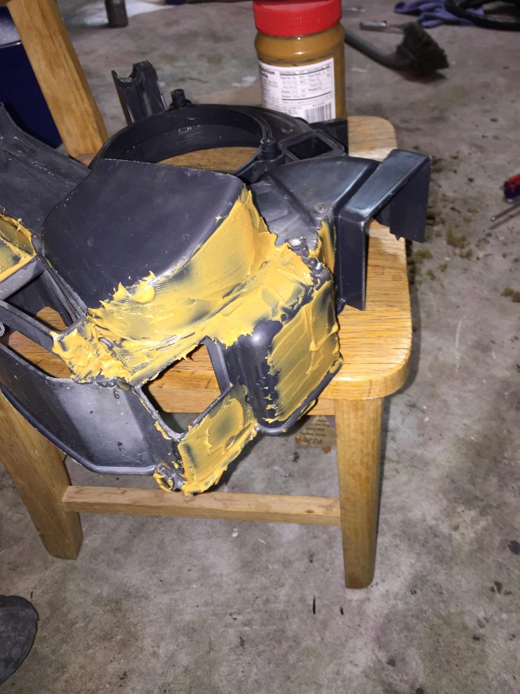

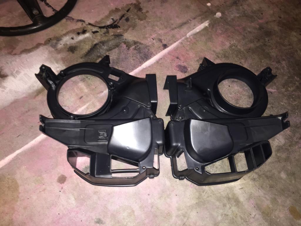

Took apart my heater core tonight to clean it out. Unfortunately the plastic housing is extremely oxidized. After I gave it a thorough cleaning and scraped as much of the oxidation off as I could with plastic razors, I then broke out the secret sauce...
Here's what the oxidation looks like before:
And then I lathered it up with the high tech special sauce:
Yes, Ladies and Gents, that is peanut butter. Go ahead and laugh now, but when I rub it off (perhaps recruit the help of my dogs) in the morning you'll be like "damn... That actually works!" It's an old dirt bike plastic remedy that I used to used. I'll go ahead and let the suspense get to you all for a little bit...

So the peanut oil moisturizes the plastic?

It not only moisturizes it, it actually removes the oxidation too. This isn't like putting lotion on dry skin to make it look better until it dries out again - this is like removing the dry skin completely to get to the fresh skin underneath. Works wonders on most all plastics and is a fix not a cover up like products such as Back to Black

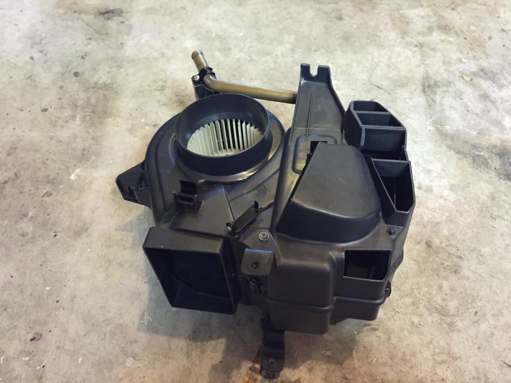

I finished cleaning up the heater core assembly. My wife yelled at me for using the creamy peanut butter so I had to go with the chunky (my son and wife don't like chunky PB). It still worked all the same but was a little more inconvenient with the chunks of peanuts.
After a quick rinse and a run through the dishwasher I then gave them a good wipe down with a 50/50 mix of boiled linseed oil and paint thinner (basically like a long lasting ArmorAll for plastics).

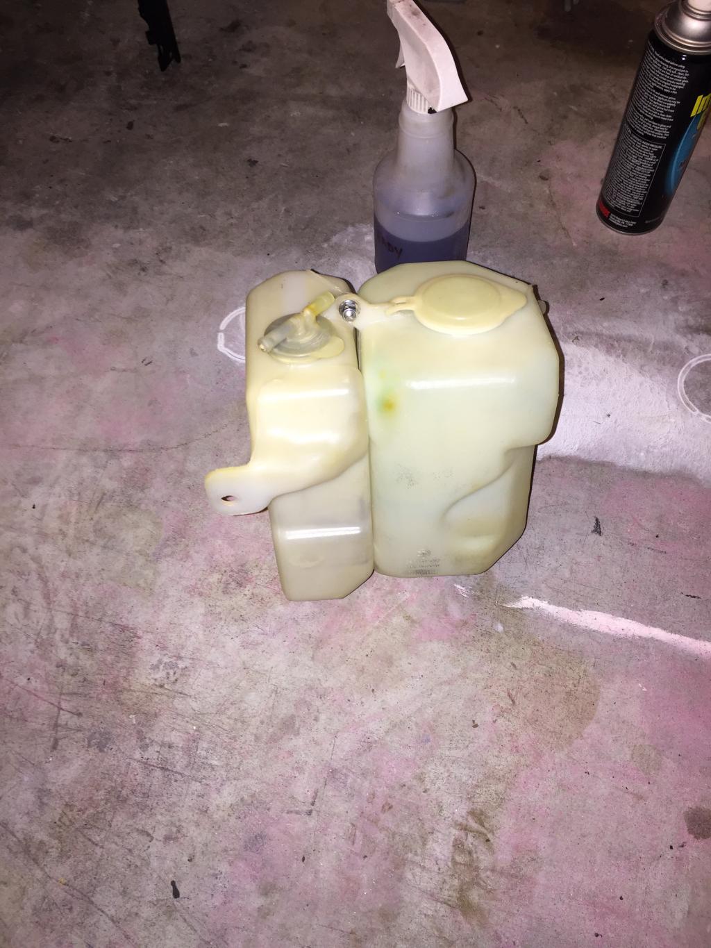

Also cleaned up the washer tank and coolant reservoir. These looked terrible before I started! They were covered in grease and paint overspray (again folks, do your truck's next owner a favor and properly mask off or, better yet, remover components before you paint!). I wish I could get rid of the yellowing, but I suppose this will have to do:
