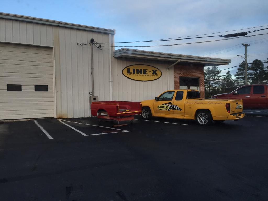

Well, it's there and dry! Just needed to get done....

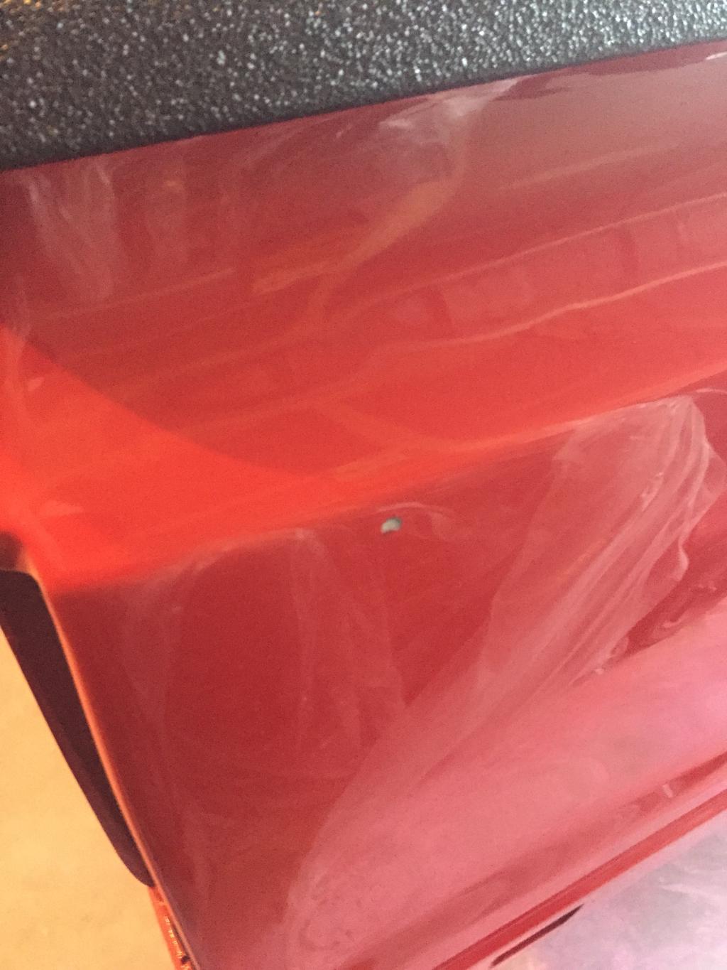

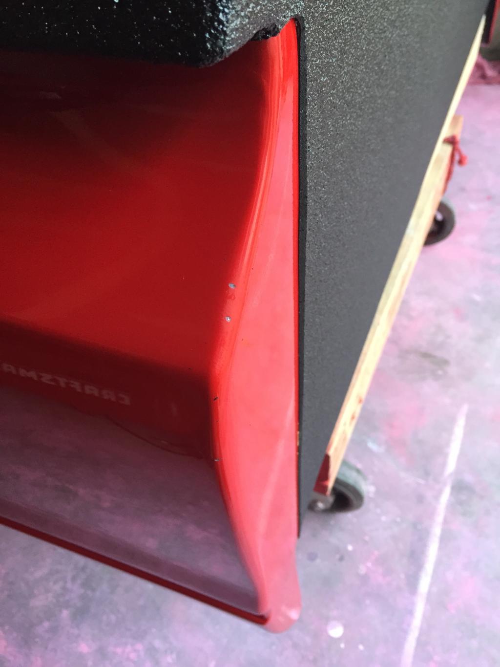

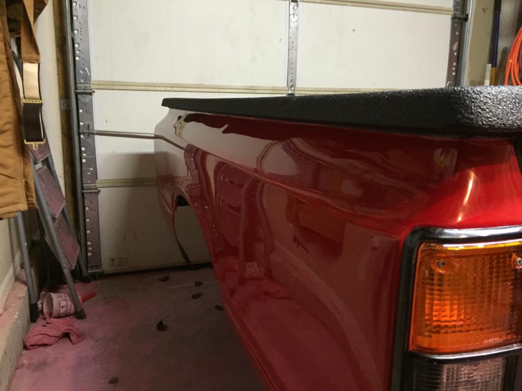

Just picked uo my bed from Line-X. The actual Line-X looks good, but the chips the put in my paint don't....
This is EXACTLY WHY I always like to do things myself. Nobody treats your stuff like you would. This bed has made a journey all the way across the continent, has been loaded and unloaded off a landscaping trailer about a dozen times and has been worked and stored in several confined areas. Despite having the bed for less than 5 hours, the morons at Line-X managed to do more damage! I was pissed! The guys said, he'd take $25 off. I said, nope... You'll take $150 off because I don't have any leftover paint and I can only get the paint in gallons at around $150. That was the deal and I stormed out of there. I'm so irritated right now... I'll post some pictures later after I get everything assembled.

Dang that sucks. How the hell do you fix a chip like that? Eye dropper?

Mother jeez!!! 25$ off that's adding insult to injury, I feel your pain, I am genuinly pissed! That's four chips in 3 places that I can see, 1 might be an accident, but 3 places that's just not giving a flip. And it's not like you brought in a geo metro, they should have known. argghhh

unbelievable ... geez , you'd think they would take a little more care with such a nice shinny piece .
I think I would have a couple of professional shops come in and do a quote on the repair , just to show them how much it actually costs ... I feel your pain my friend

How in the heck did they knock chips like that out? Grrrrrrr.

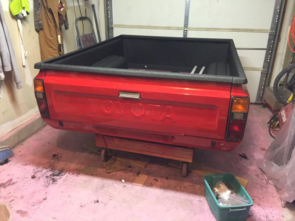

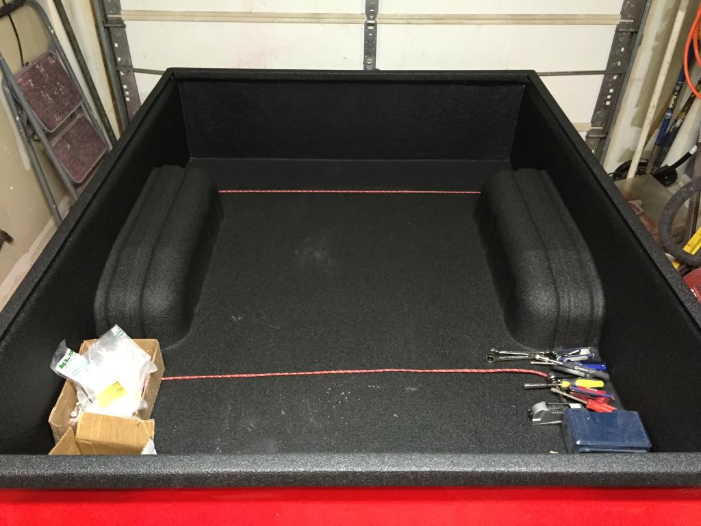

Yep, I could hardly believe it when I saw them. Not sure how it happened, but they got it good. Ideally, the correct way to fix it is to sand down the whole panel and repaint it, but I don't have time for that right now. Foor now I'll just grap a pipette and touch it up. I laid down the paint rather thick so I have plenty of paint around the chip to wetsand the touch-up smooth. In a perfect world, I shouldn't have to do this. I'm still really irritated about the issue - mainly because I haven't even driven it yet and I would like to be the one that does the damage first. Oh well, it is what it is. You better bet that nobody else is going to be working on my truck again!

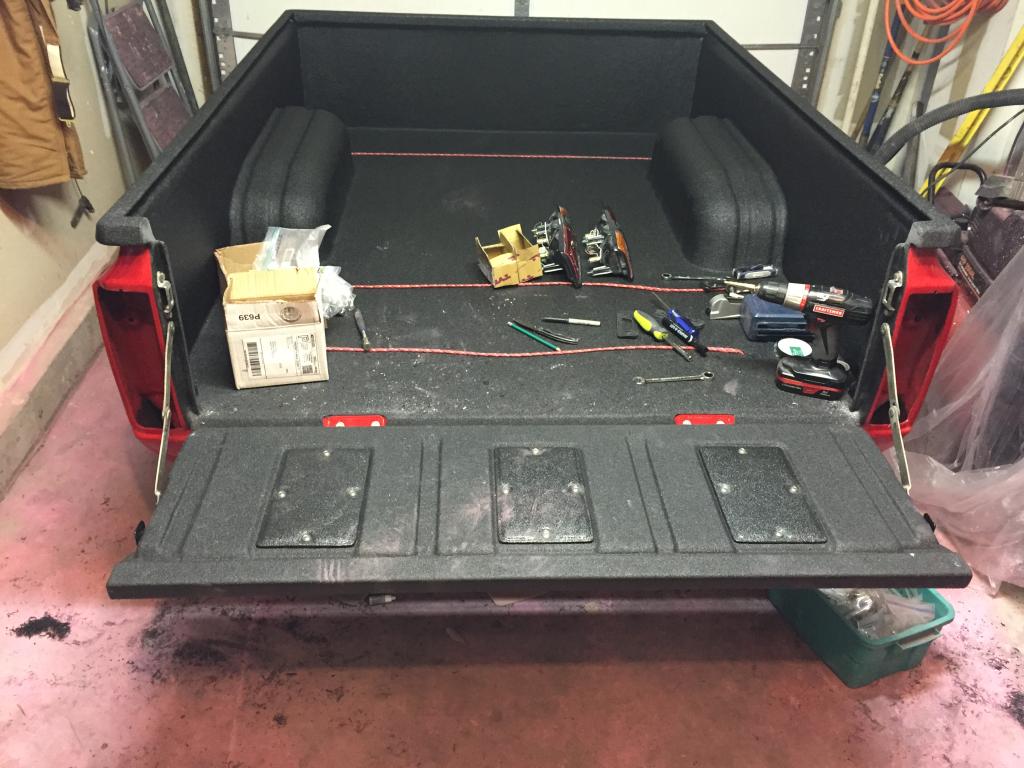

Got most of the bed assembled - tailgate installed, latches installed, latch strikers installed, tailgate stays installed, tailgate handle installed and side markers installed. Only thing I have left to do is install the tail lights but I have some adjustments to make due to the thickness of the Line-X - no biggie. I had Linex do the tailgate jams so I needed to do some tweaking there to get everything to fit up properly. I took some clearance measurements and knew that it was going to be tight given the thickness of the Line-X (about 1/8" thick), but I wanted the protection. I had to shave a little bit off of the jabs, but that wasn't too bad. The latch is still a little tight up against the Line-X but the tailgate does shut and latch all the way. Some minor adjustments hear and there I'm good to go!
The tail lights aren't fully secured, but they are in there for effect:

Went up, over and under the bed rails:

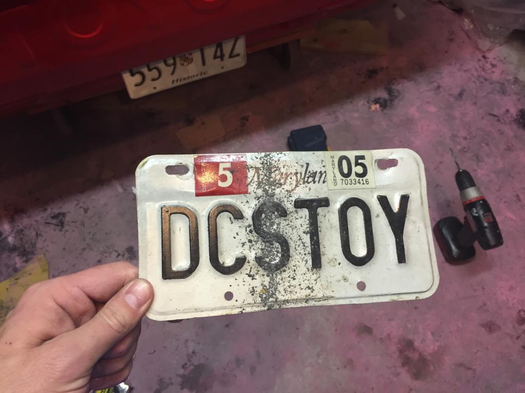

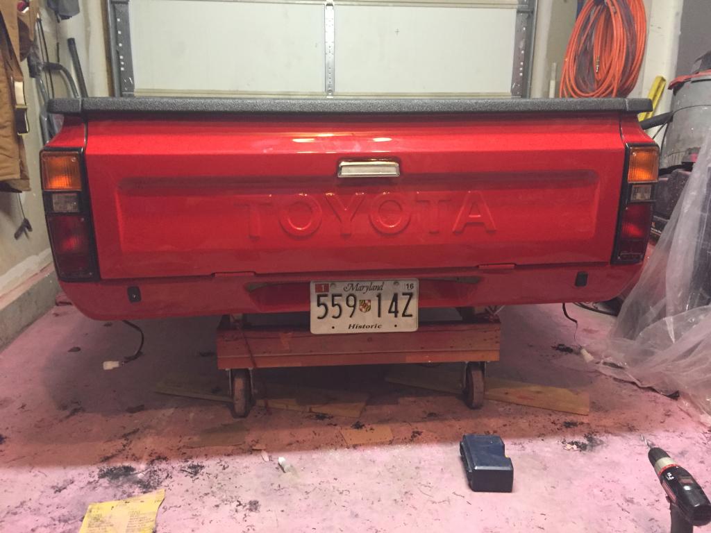

Yep, it's a lot of work to do just to fix a moment of carelessness.... This will be a semi daily driver and my fun toy - nothing too crazy. I haven't checked my PM's in about a week and I know I have about a dozen of them piled up in my inbox, but I'll check it out and get back to you shortly.
Finished adjusting everything tonight so it'll be ready to plop on the chassis this weekend. I even mounted my license plate just to say I did...
That's not the one I'm going with, I got a special vanity plate on the way, but I had thought about using my motorcycle tag on in. In Maryland, when you have vanity plates on a motorcycle you can keep your generic plates as well. I haven't had this plate on my motorcycle in years, but I still own it and could transfer it to my truck -DCS TOY (as in Dave Church's Toy).
