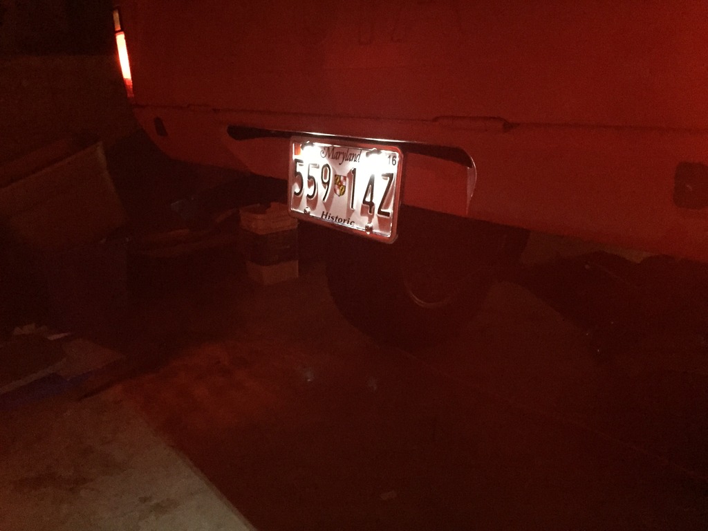

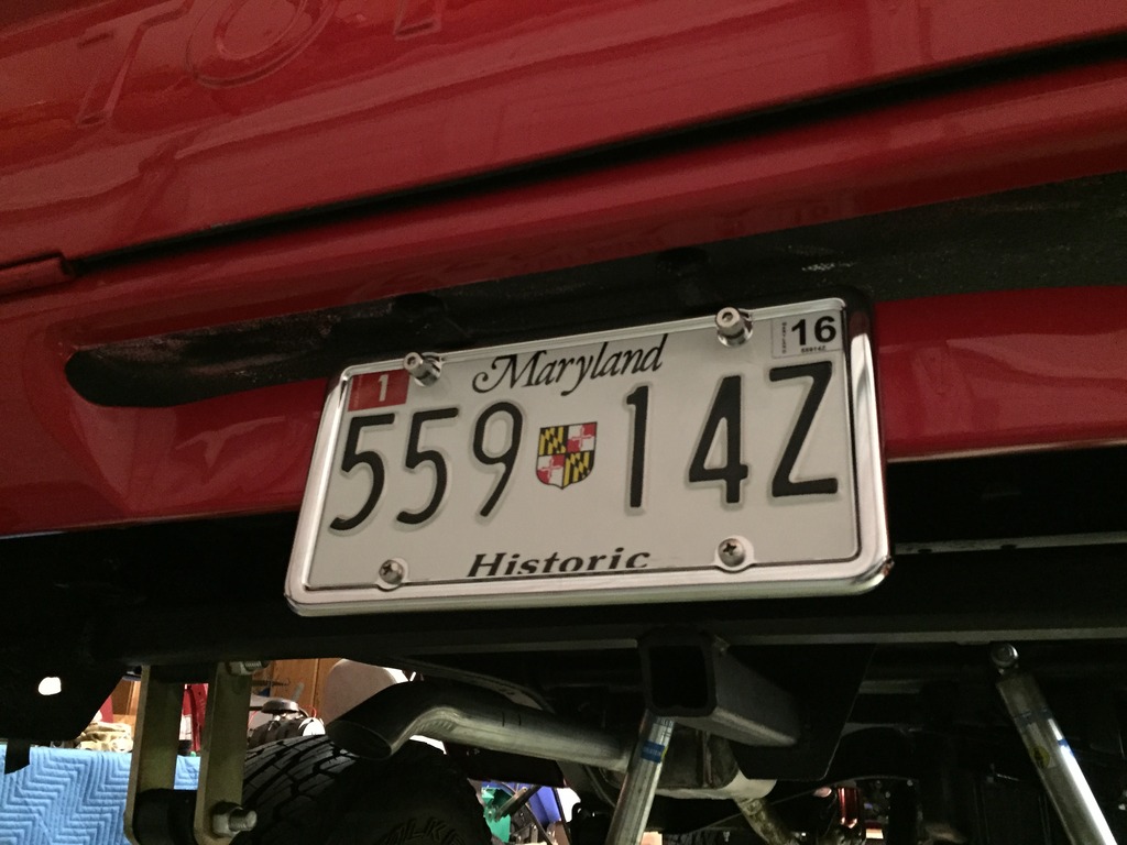

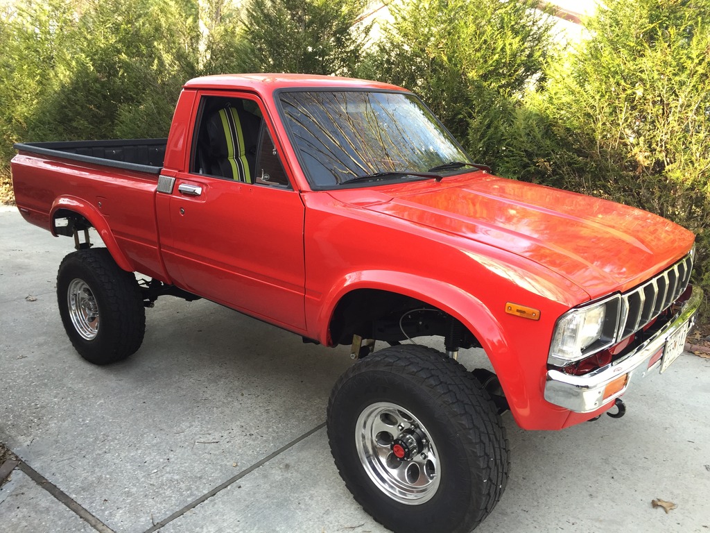

I finished making the truck "legal" this week. Installed some LED tag bolts that I got from a local motorcycle shop. Since I have the fiberglass bed, I don't have that little lip in the rollpan that hides the factory tag lights so I wanted to go with something a little more sleek and less noticeable, but I didn't want to use some of the cheap lights that are readily available from local parts stores. I think they look a little brighter than most car tag lights so that should keep the police from complaining.
Look, you can't even tell they are there:
The boom! There they are!
Also finally got my driverside front turn signal - damn near impossible to find new aftermarket ones:

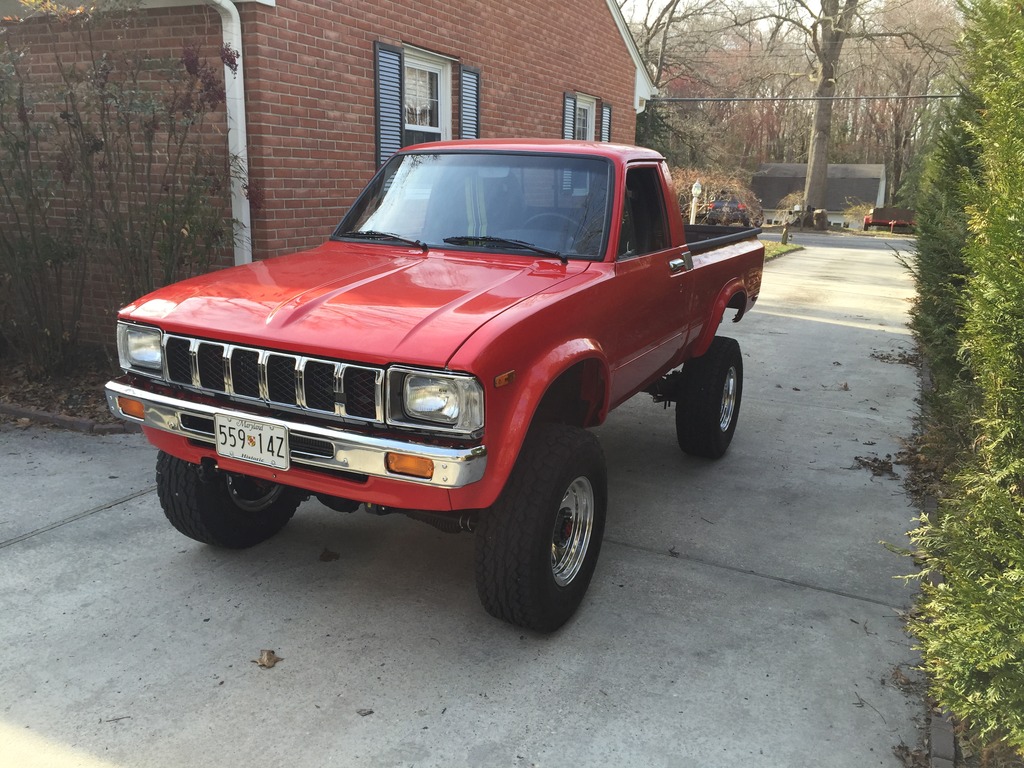

I also took it out today for a nice long spin with my son:
So far I've piled on about 200 trouble free miles. Only issue that I really need to work out is this pesky leak when the heater hose connects to the heater core. I've tried working out the dent in the copper pipe and even double clamped it, but it still leaks! Not much though, just enought to make a small puddle in the driver side floor pan after about 100 miles. I'll probably end up pulling the heater core and replacing the pipes.
I also think I need to figure out some thing with my brakes. They definitely stop the truck, but are SUPER touchy! I got my proportioning valve dialed in well, but I think that 1" bore MC might be a little much. Then again, I'm also used to the modern brakes of my Tundra and Camry. I'll do a little research on the topic.
Hopefully next weekend I'll finish wetsanding and polishing out the rest of the paint. Then I may call it quits for a little bit and just enjoy driving it for a while. I likely just do some odds and ins work here and there.
