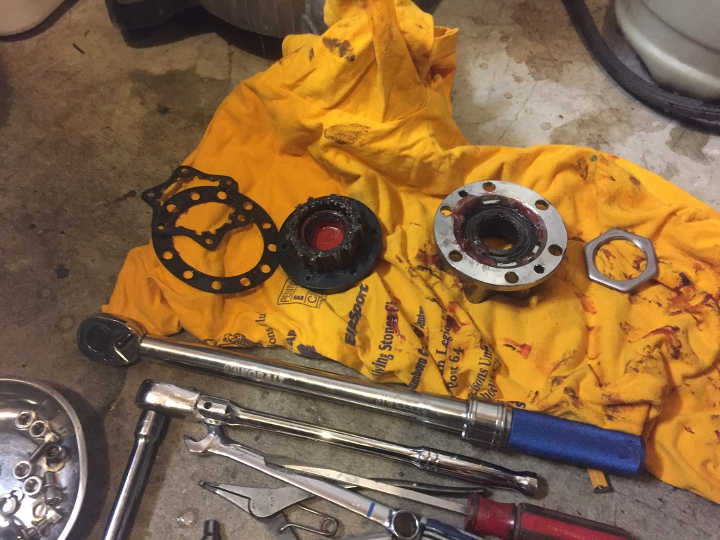

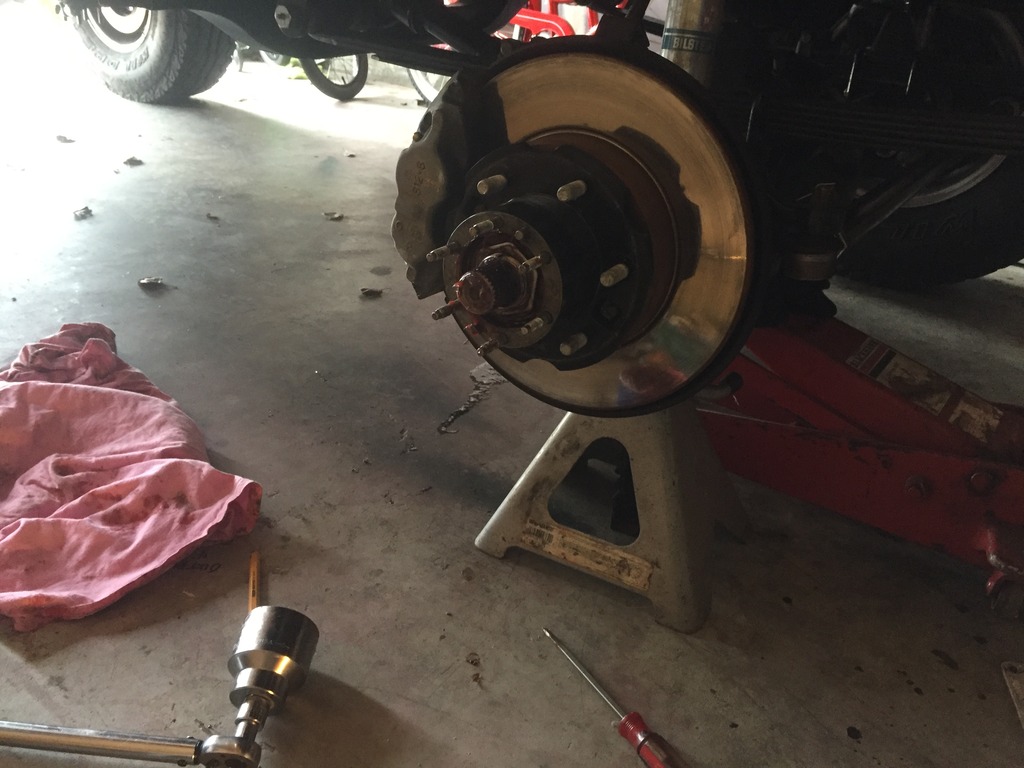

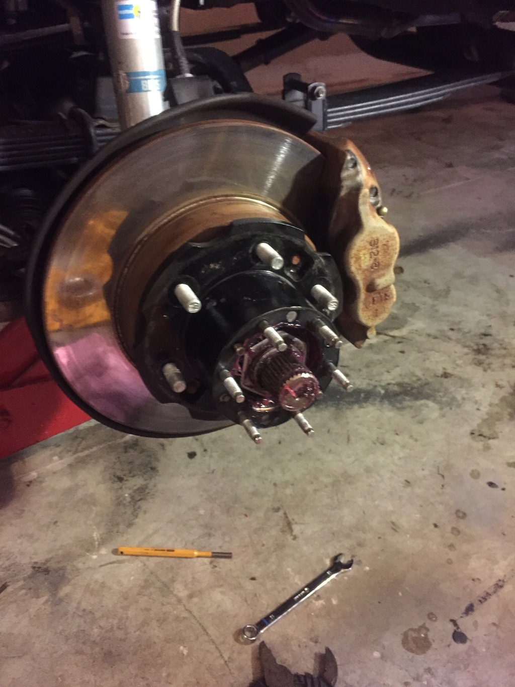

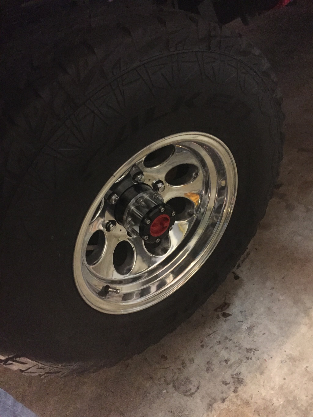

Well it was nice out today (nice being 40* and not snowing or raining) so I decided to take a little drive around town. On my way home I drove across some railroad tracks and noticed a slight clunk coming from my driver side front wheel. It wasn't bad at all, but enough for me to be concerned so I drove the 1/2 mile I had left to get home and jacked up the front end. I have a heavy rubber coated tire thumper so I gave the front tires a couple good whacks to see if I could hear or feel any movement in the hubs. Both sides seemed to have some very slight play so I yanked the hub locks to scope out the torque on the spindle nuts. Turns out that they were a little loose so I pulled the hubs to check for bearing damage. Luckily the bearings were still good. Since my 52mm socket has eluded me (I used some channel locks to remove the spindle nuts), I'm going to have to go out to get a new one tomorrow.
No gear oil coming through to the hubs so I suppose that the Marlin Eco seals are doing their job properly (please ignore the rusty brake calipers - maybe I'll finally get around to painting the only thing that I didn't paint on the truck...):
Hub locks and cone washers came off easy thanks to a go coat of anti-seize when I assembled them (highly recommended):

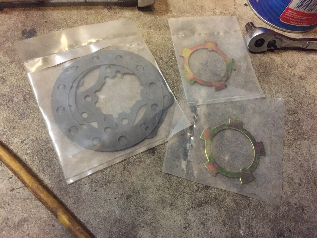

And I also have a fresh spare set of gaskets and lock washers so I didn't have to worry about salvaging the old ones:
Re-assembly will commence tomorrow...

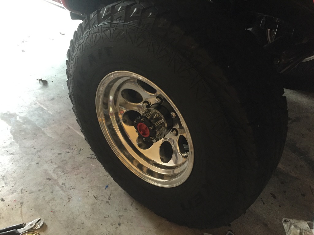

I got both hubs tightened up and re-assembled yesterday. Total time... 2 hours! I was expecting a lot worse time wise, but having anti-seize on the cone washers really prevented any headaches. A couple taps on the hub lock studs with a hammer and they popped right off!
Passenger side hubs were slightly loose, but the bearings were still good. And again, no gear oil in the hubs so those Marlin Eco seals are holding up:
Everything re-assembled, like new again:
Took a little test drive and no more clunking so it looks like the loose hubs were my only problem! Woot Woot!
