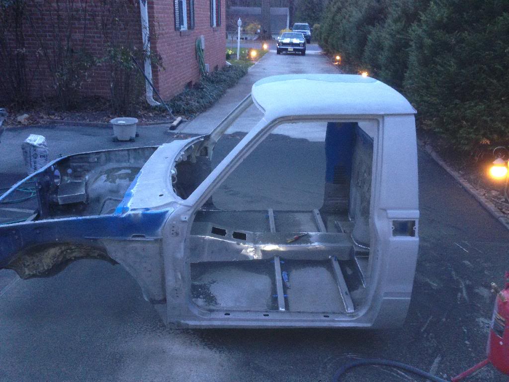

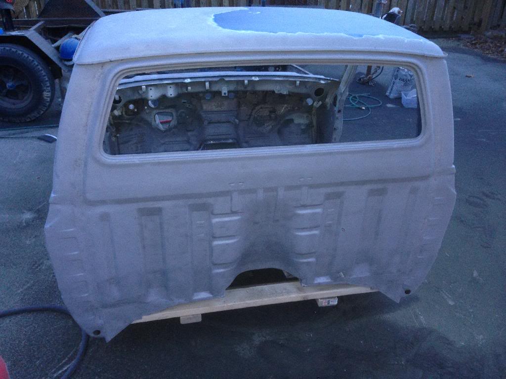

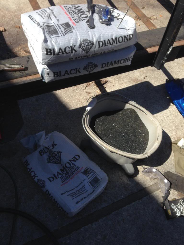

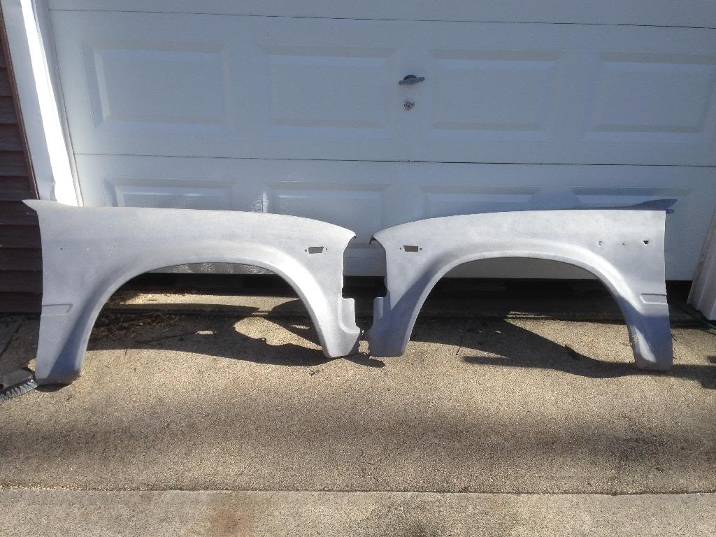

Well I have good news and bad news. Good news is I haven't found any hidden surprises under the paint yet. Bad news is that I only got about a third of the sandblasting that I wanted to get done today. I got tied up trying to remove old seam sealer in the drip rail for a couple hours. The sandblaster wouldn't even touch it and I got the good stuff today to. This stuff is great:
Fenders done:
Driver side:

Rear done:

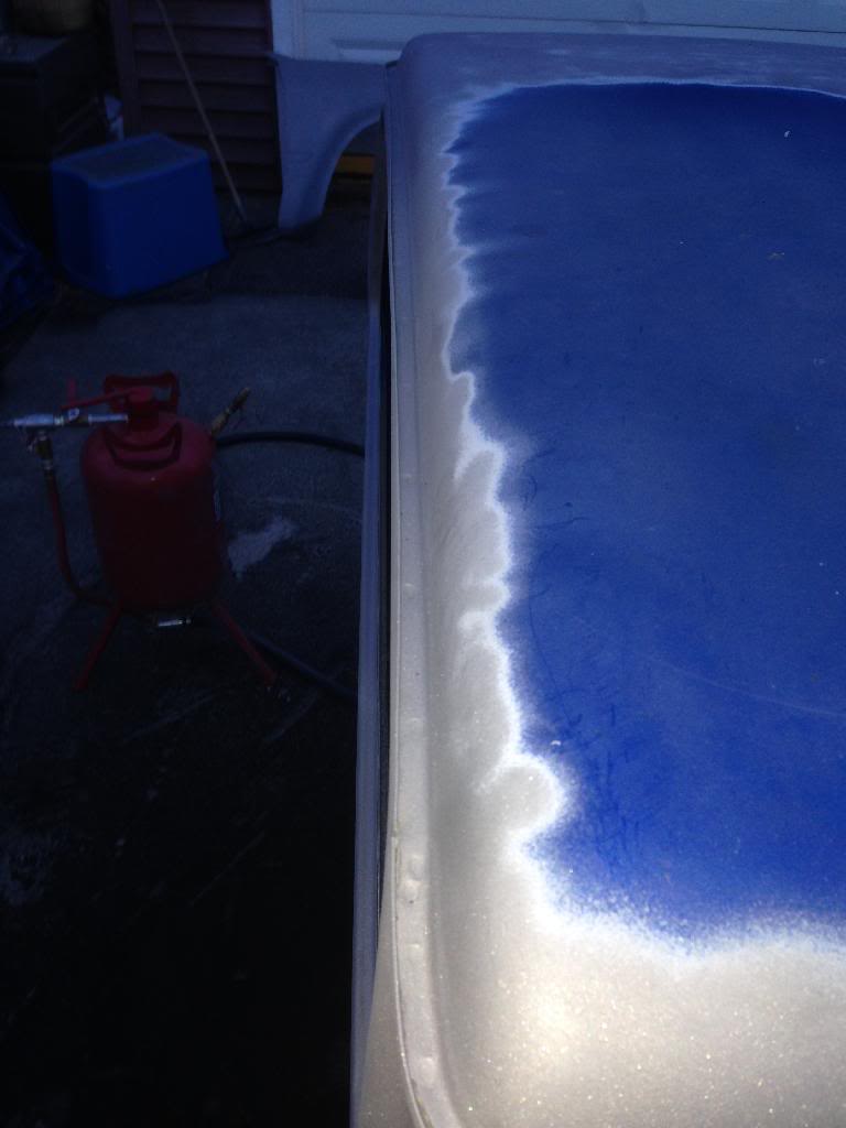

Passenger side:

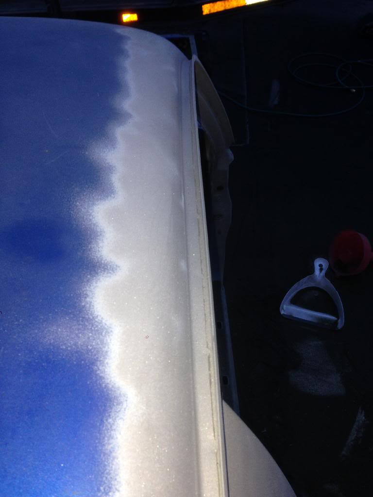

Drip rail all cleaned up and NOT ONE SPECK OF RUST!! Woot woot!!

I have about a full day of blasting left to do, but that media that I bought cuts really well so it shouldn't be too bad. I still need to dismantle the doors before I blast them.

What did you use
Old Apr 6, 2014 | 06:23 PM
  #567
83 trail rig's Avatar
Joined: Feb 2014
Posts: 351
Never mind I see the bag

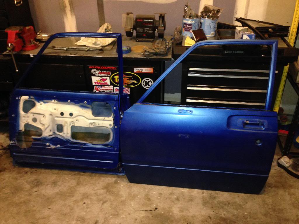

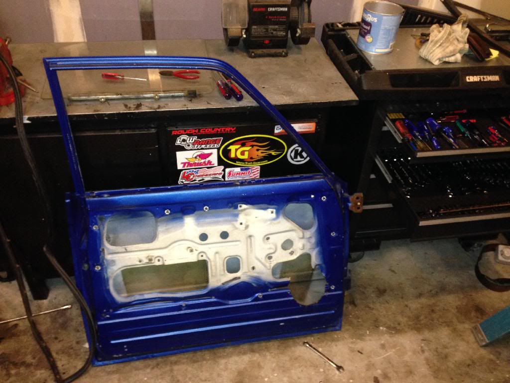

Last night I decided to break down the doors. I decided to just go at them figuring that it can't be that difficult... Well, after about a hour of fiddling with the driver side door I decided maybe I should break out the FSM to see how these damn windows come out! Boy did that make it easier. And like everything else, the second time around is always easier so I had the passenger side completely apart in less than 30 minutes. Everything looked pretty good coming off. I'm going to get new locks (hopefully find a set with the matching ignition key), new door handles (originals have pitted chrome and stick a little), new weather seals (old ones aren't terrible, but new is always better when it comes to water tightness) and new outside reveal trim. Then HOPEFULLY, I can re-assemble everything without scratching up my fresh paint! I imagine that it will be easier with the door on the truck instead of having to fight the door to stay still. I also need to figure out what I want to do for a door panel. I want to do something that screws in (not snaps in like factory) and hides all the jacked up cuts that the PO did to mount the speakers. I'm thinking that I'll use nutcerts in some of the original mounting holes with a couple of "guide pegs" to help align it when taking it on and off. I also need to figure out how I want to do the speakers - it's a small truck so I'm probably just going to go with a couple 6.5" speakers with 1" separate tweeters. As for materials, I'm not sure which way I want to go. I can do a simple 1/8" MDF covered with padded vinyl or I have a friend that does really good custom fiberglass work build me one. It's farther down the road, but it never hurts to start planning early (Corey, doing production door panels in your future?????)
Anyway, here are the doors ready for sandblasting:
