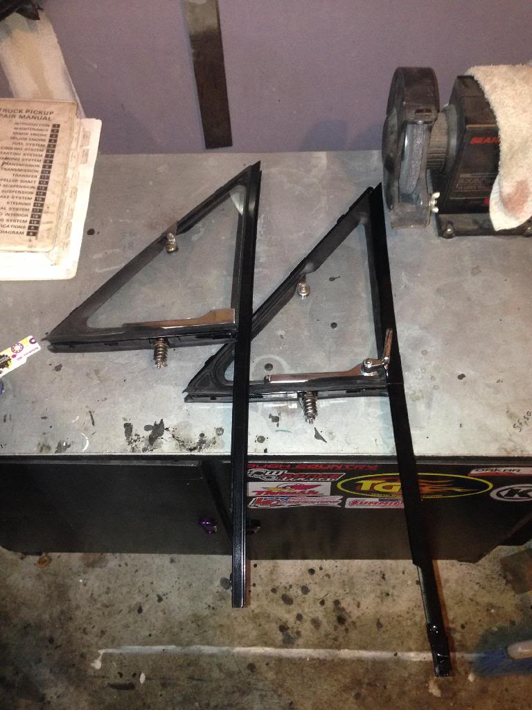

I may have lied a little bit on the elbow grease.... I also used a polishing wheel on my bench grinder to do most of the work, but I had to used my elbows to help move it on the wheel right??

Thanks! It just took a little elbow grease and some Mequiars PlastX headlight restoration compound (my little secret for polishing chrome). When bringing back chrome, it's important to remember that just because it has a little bit of corrosion doesn't mean its gone. Most of the time it is just surface oxidation that needs to be removed to uncover the good chrome underneath.
I may have lied a little bit on the elbow grease.... I also used a polishing wheel on my bench grinder to do most of the work, but I had to used my elbows to help move it on the wheel right??[/QUOTE]
Haha, exactly. Well thanks again!
