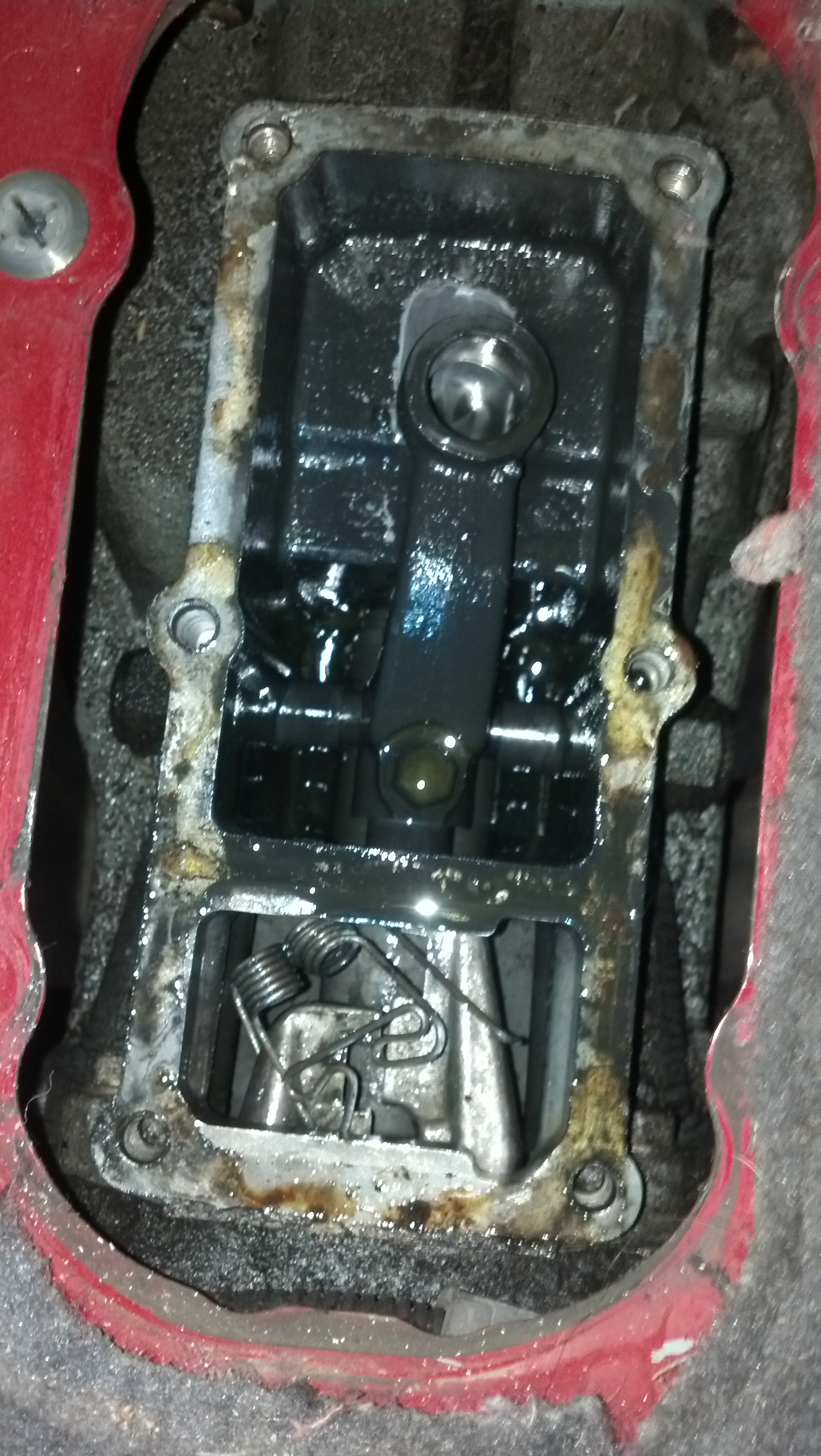

this is what i found when i removed the shifter..the transfer case is in 4 low not 4 high and what is the spring to

another thing that i noticed is the fork on the right side looking at the pic will spin up and down I am thinking this could be the problem but i have no clue
