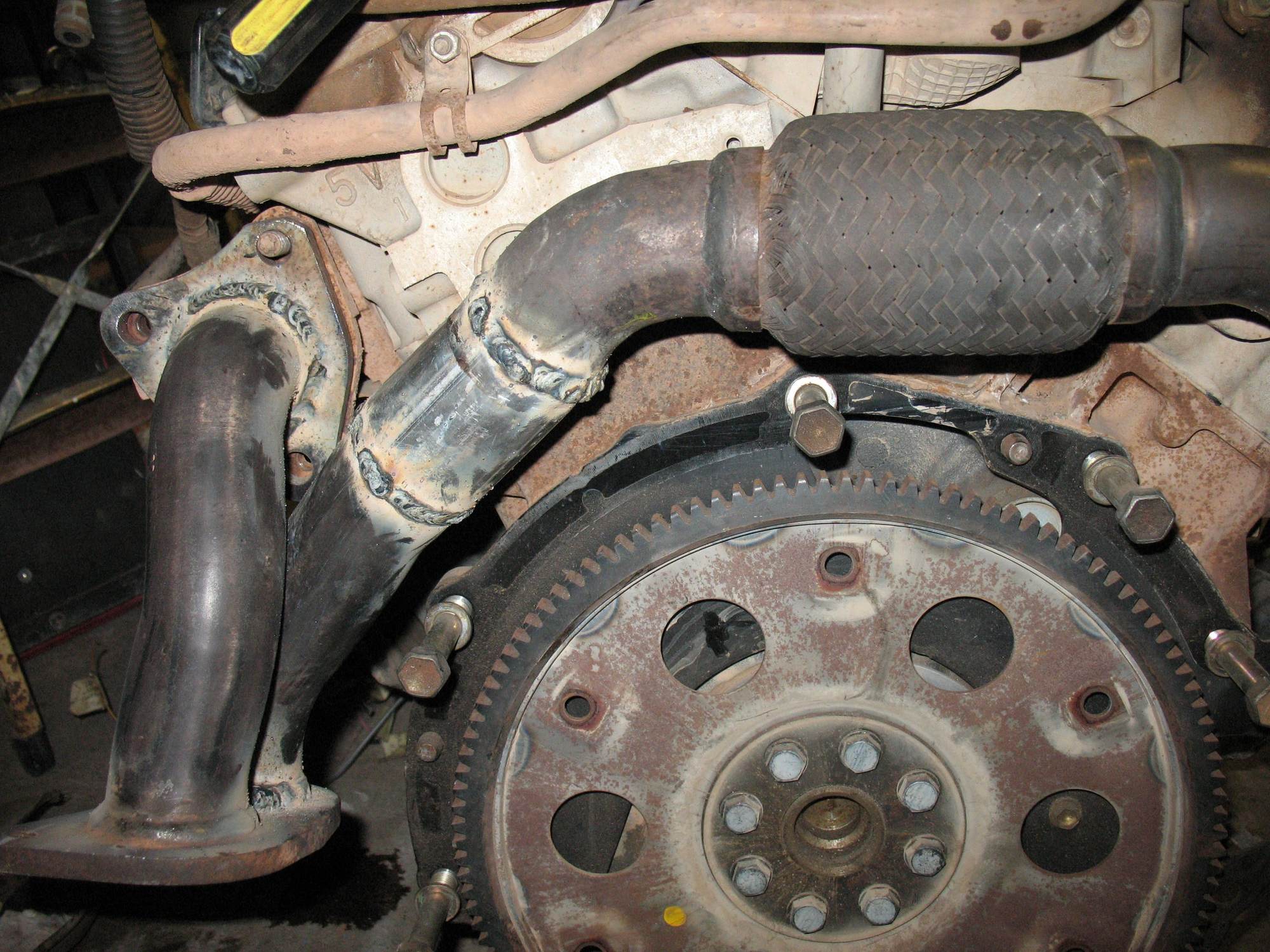

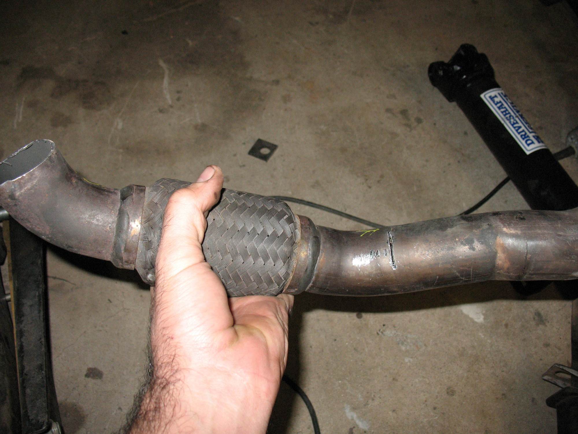

Build your own 3.4 crossover pipe UPDATE- 8/24/2013

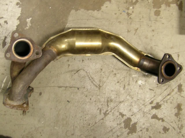

here you go, I took lots of pics, and I will do what I can for describing what I did, I had a total of $3.00 in it.
obviously this is the factory pipe, it just has the heat shield removed
took and cleaned all the mud off
here is one of the factory welds, I cut the weld, without cutting the pipe
here is what it looks like with one pipe removed, I used a cut off wheel and a die grinder to get in the area where the two pipes came together.
you can see here that I left the factory weld on the pipe, it makes it nice when re-welding it back together, and also you know how far the pipe goes into the flange.
another one with the weld cut
here is the pie with the flanges cut off, I didn't cut the short pipe off of the big flange, it worked without needing to. I also marked right and left on the flew, so I can put it in the same way.
I'm not sure how many pics I can put in one post, so I am going to post this and start another post, so if you can, don't post yet until I am done, thanks.
Old Mar 2, 2008 | 06:21 AM
Jason4X4's Avatar
Joined: Jun 2006
Posts: 156
From: Chandler, AZ
first cut on the pipe
how the pipe fits
second cut
what is left, this is the flex
other side of pipe
test fitting
this is the clearance with the pipe in place
both pipes test fit
as you can see, the flex cuts don't line up, so I took it to the grinder to get the angles right
closer
even closer, NOTE, you can also see that I did wind up flipping the flex over, my right mark is now on the left
I wound up getting a piece of pipe to put inbetween here, I think it would have been able to be welded without it, but I wanted to make sure that the flex wasn't going to interfer with the trans bolts
engine clearance
I am going to do another post now, please hold...
Old Mar 2, 2008 | 06:32 AM
Jason4X4's Avatar
Joined: Jun 2006
Posts: 156
From: Chandler, AZ

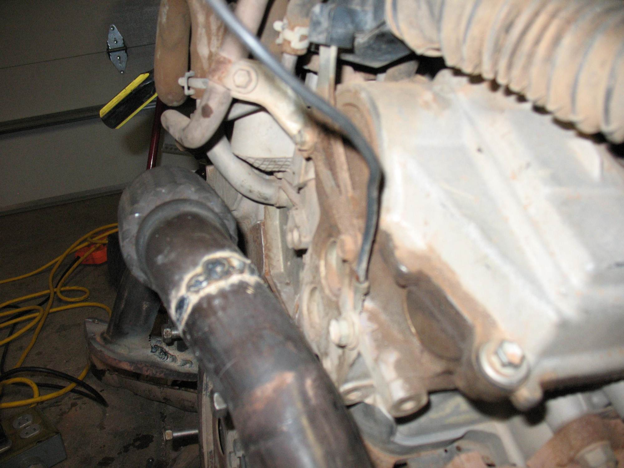

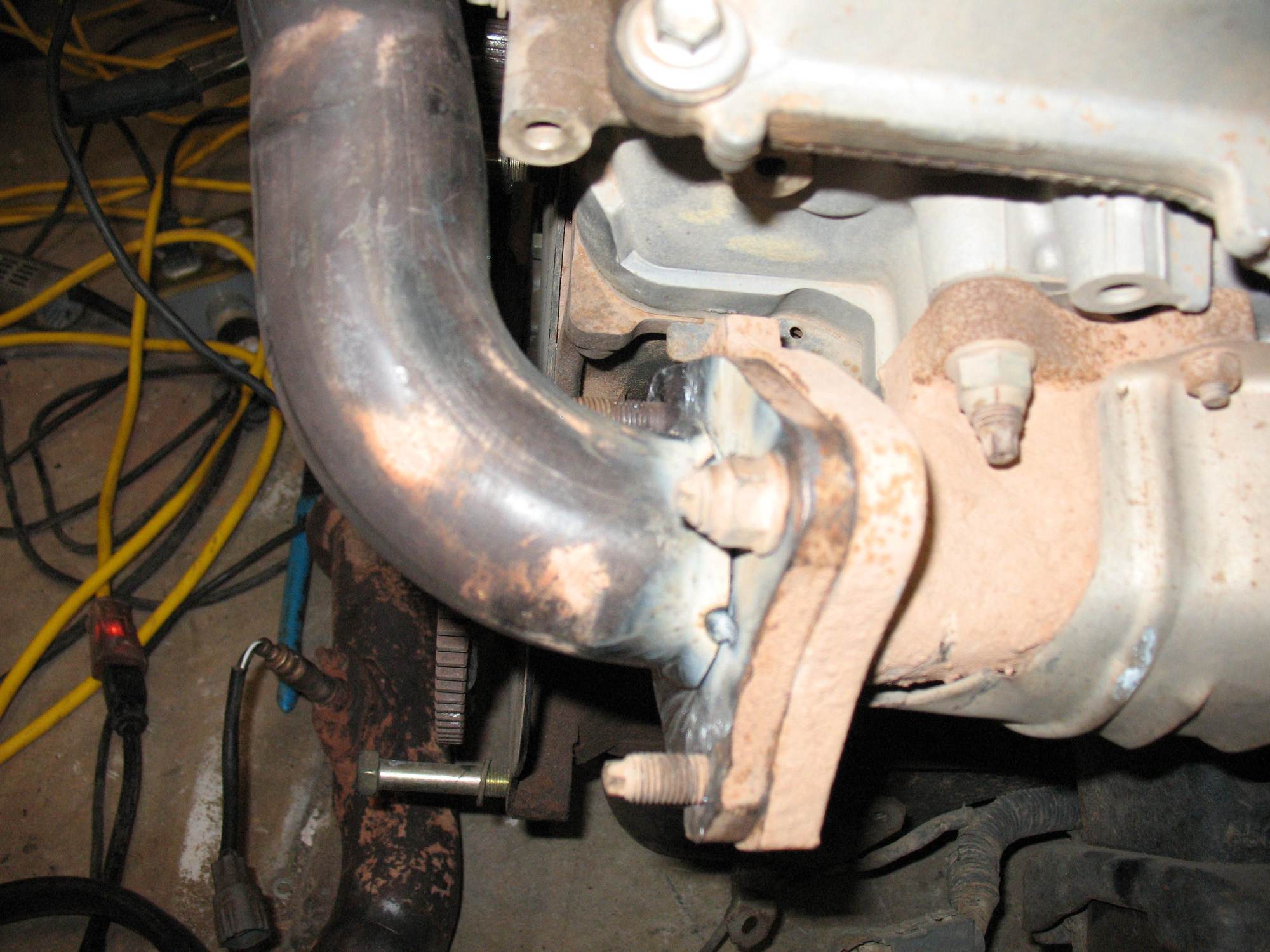

side shot before welding
you can see here the how much room there is for the transmission and bolts
another pic before welding
one more
head clearance
tacked in place
driver side clearance
tacked in place

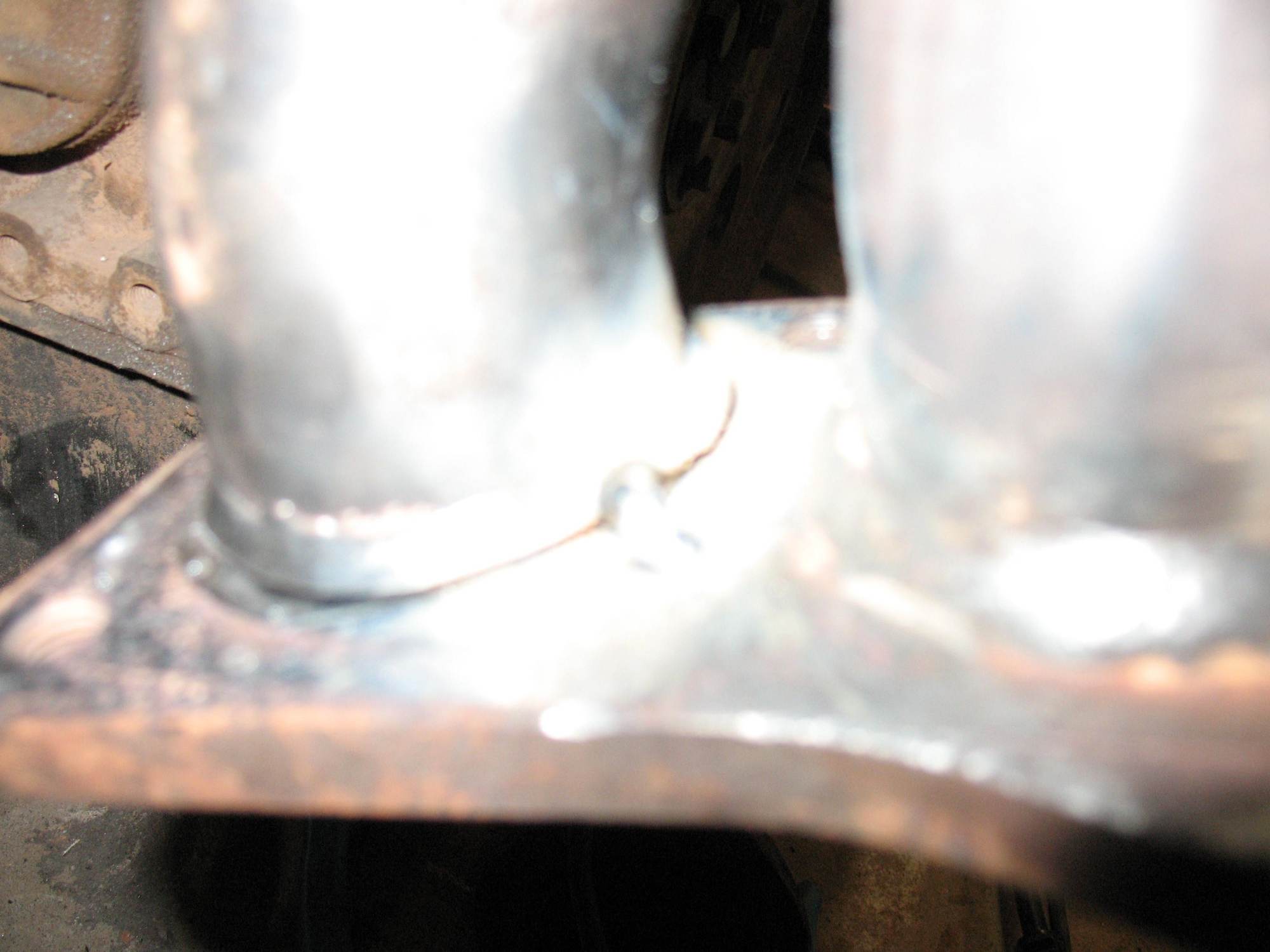

the two pipes are close, but they don't touch, they can be tacked together, but I didn't
all welded up, I am using a flux core wire welder, they look better after I wire brush them
final clearances
since we used the factory down pipe, I had to move the o2 sensor cause it was hitting the frame, I also had to cut an ear off of this pipe at the flange, I just don't have a pic of it
used the factory o2 sensor hole as the second o2 sensor hole for the 3.4. yes it is in front of the cat, but it has a dummy box on it.
That;s all I have, this was on an 89 4runner, which I believe is the first gen(?). anyway, it worked for me, so good luck...

Excellent writeup! I might just add that the later 5VZFE models have a different crossover. I'll try to post a pic of the newer style factory crossover later. What is involved with removing the heat shield on the older style crossover?

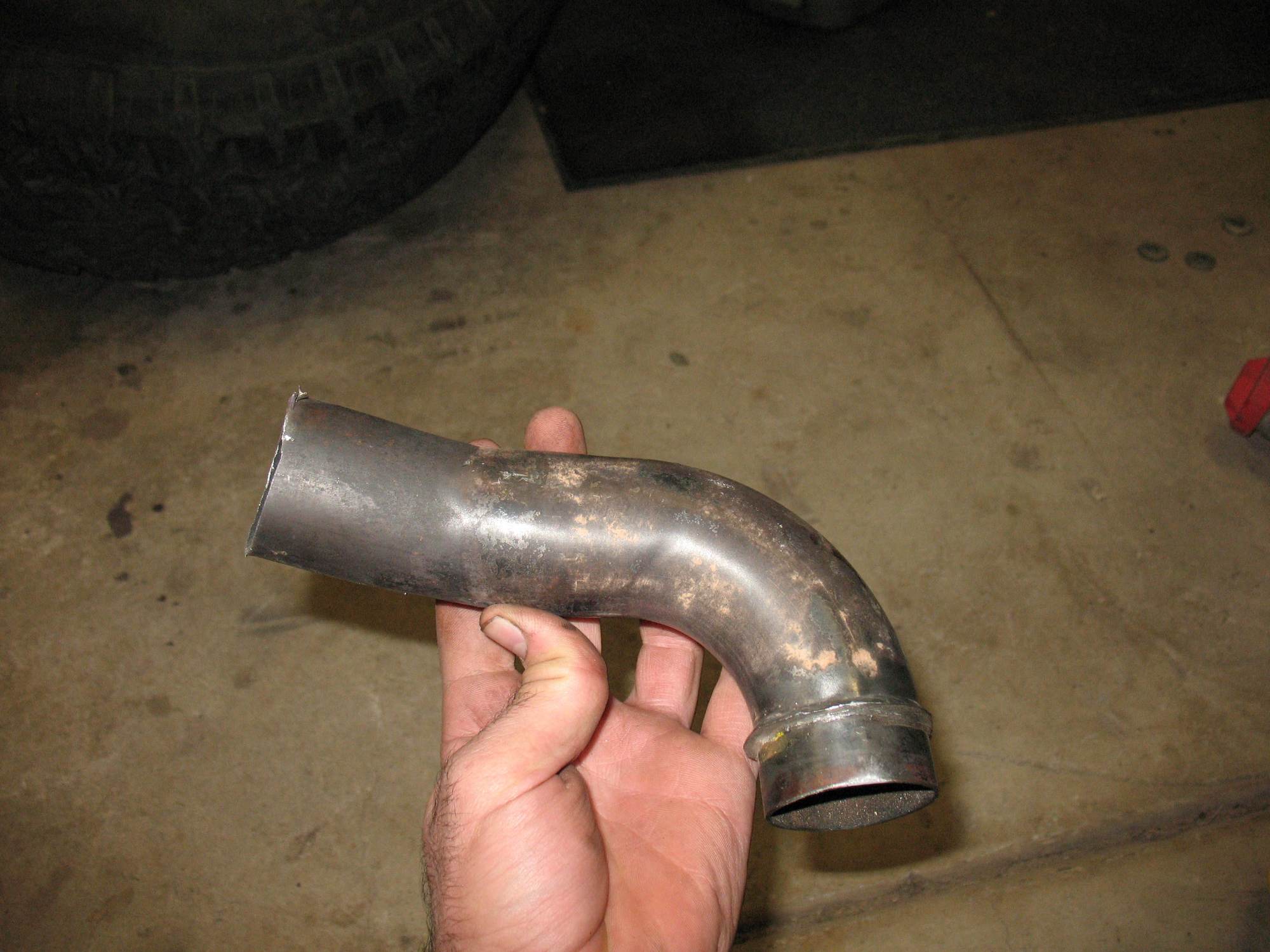

Ok, here's the pics of the newer style 5VZFE crossover design, 2001 and up Tacos, (not sure about 4runner years):
As you can see they are very different designs, as are the exhaust manifolds from 2001 and up. The newer style use double wall tubing (most evident in the last pic) and it appears to have no flex coupling. These newer style look like it would be nearly impossible to flip around like you have done with older style. Lets put it this way, it would be easier to build one from scratch. The only thing you could use would be the flanges and if you used the stock exhaust manifolds you would need those flanges badly.

Wonder why the flex joint was eliminated? I was under the impression this allowed the crossover to flex or expand along with the heads.
I happen to have a older 3.4 crossover for sale... in perfect shape... if someone is looking for the flanges and such.

The crossover pipes are ALL the same on Tacoma's and 4Runners from 1995.5 to 2000 then they went to the double wall set up as seen in the above pictures.
