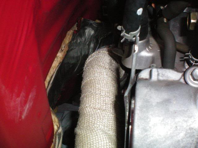

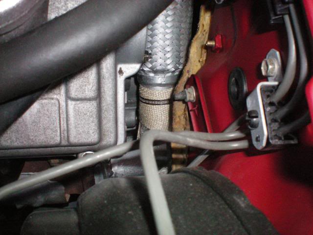

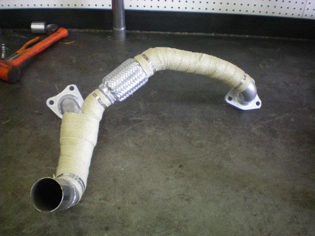

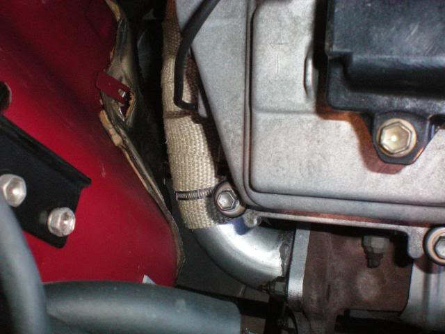

Here are a few of my crossover pipes
also built using most of the stock parts
