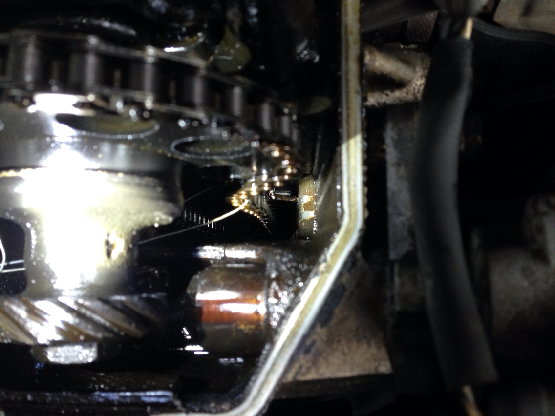

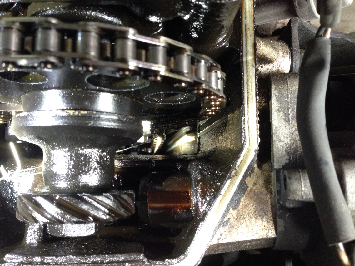

That sucks but it doesn't look like it wore through to the coolant passages, which is good. If it did that would require a new head, right? First thing I'm going to check is if there's oil in the coolant.

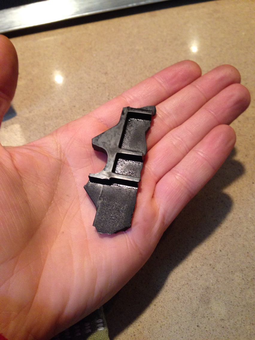

Nooo!!! Haha, this is a piece of the driver side chain guide. The rest is in the oil pan and not even near the chain. The chain has been eating up the head slightly and the timing cover pretty good. Here are a few more pictures of the wear that happened. My goal is to do it next week. Hoping to have a friend help me out who knows these trucks pretty well. It really looks like the guide can be replaced right from here! I'm sure it can't, but I'm open to suggestions, haha.

Should I also replace the oil and water pump while I'm there? I just can't seem to find a kit on eBay that has both pumps, timing cover and two steel guides. Does the passenger side have to be steel as well?
