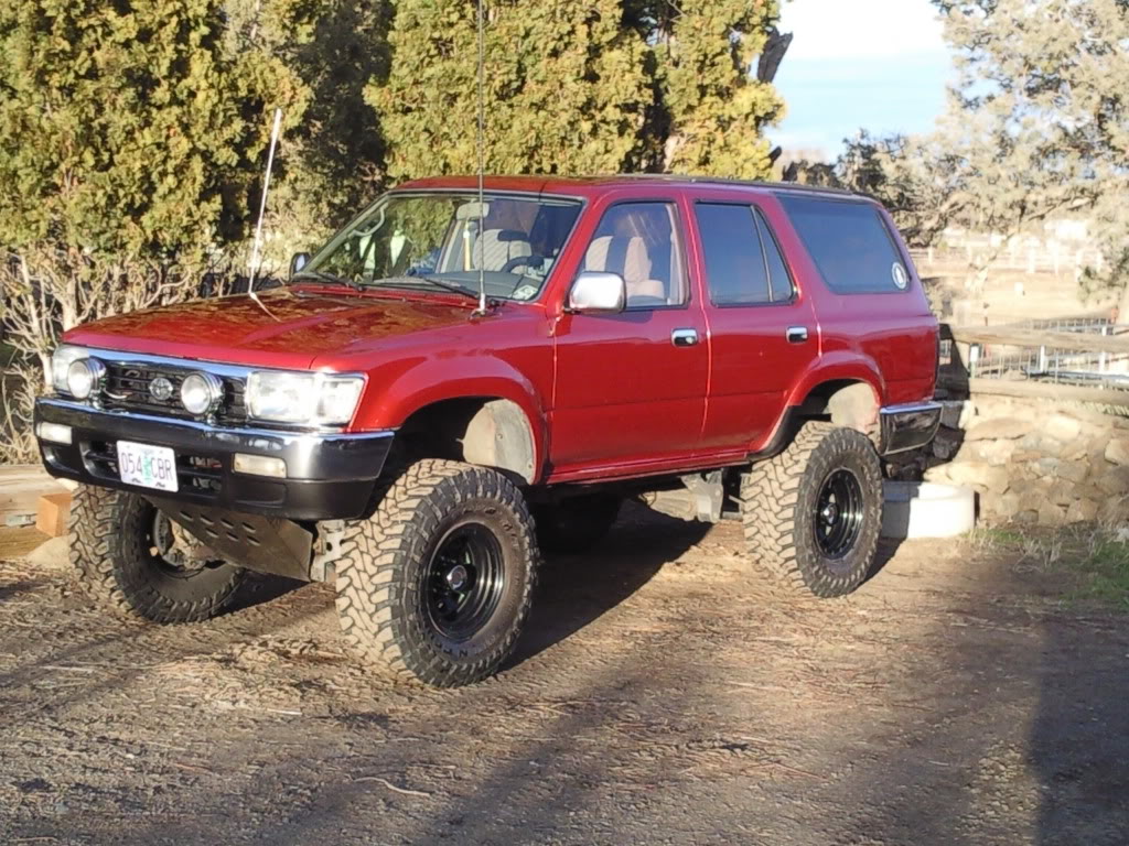

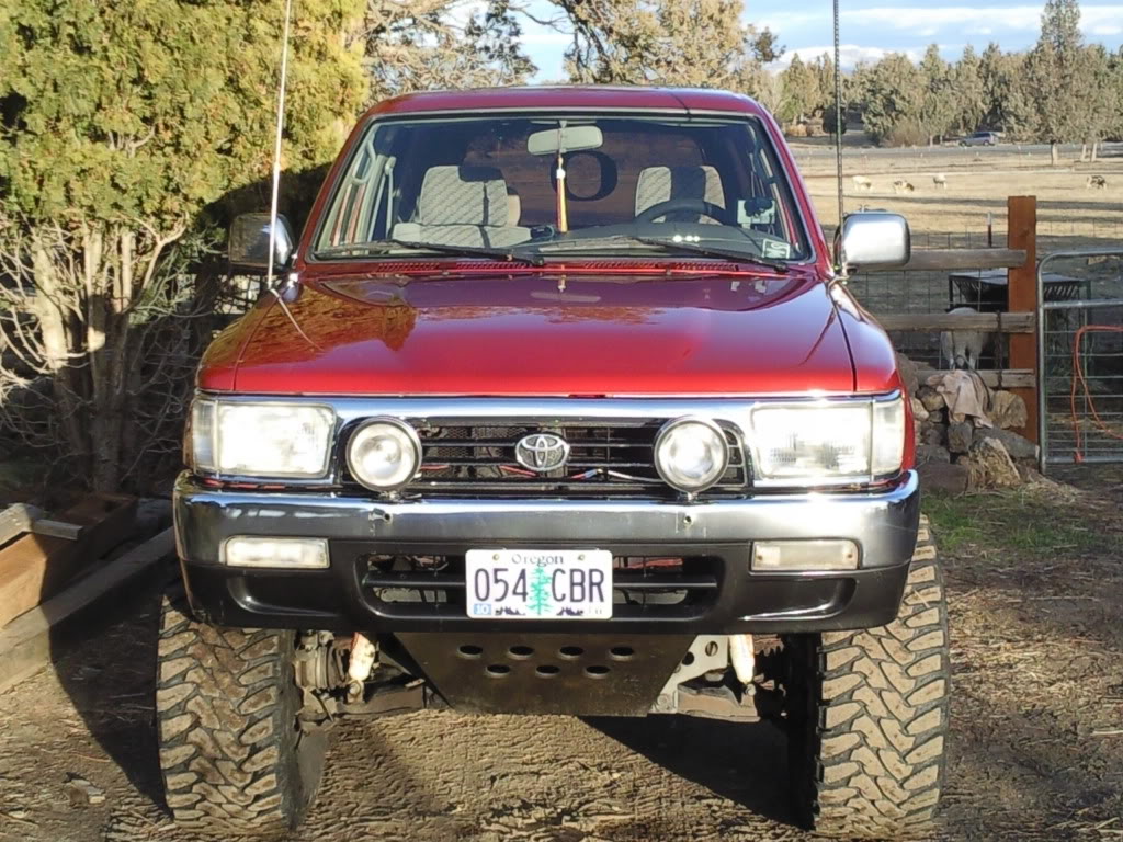

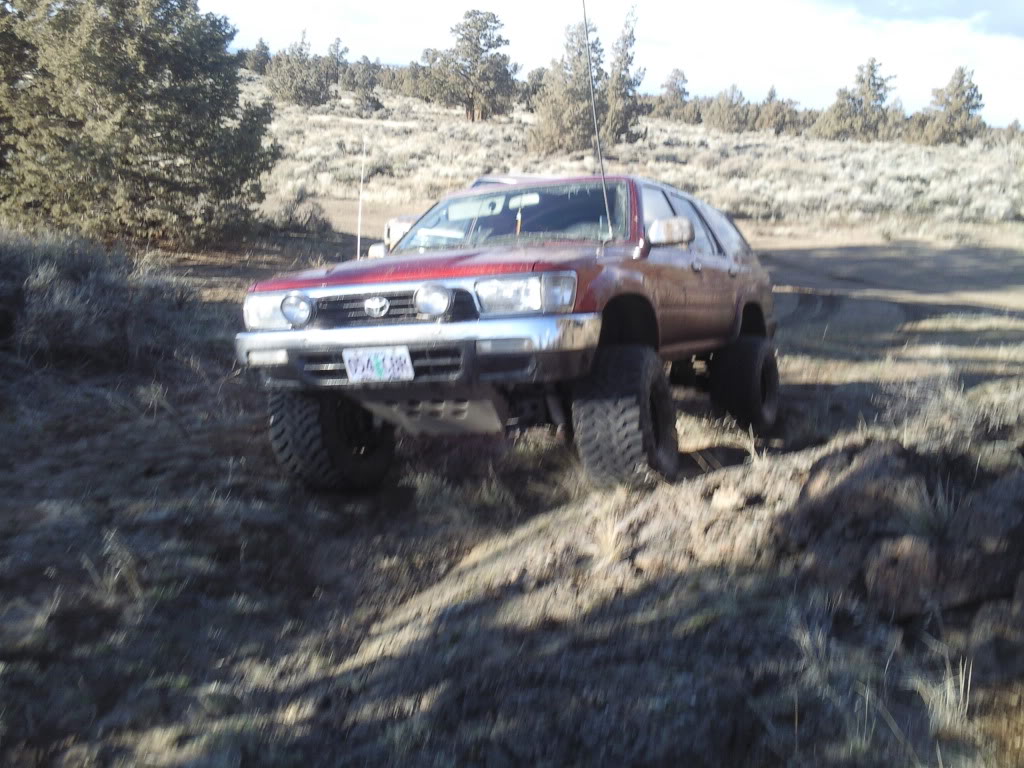

    My turn!! Here's my old '95, sure do miss her. This was with a 4 inch (I believe it was the pro comp) drop bracket lift on 33's no rear sway bar but the front was still there Name:  Photo0210.jpg
Size:  198.7 KB Name:  Photo0209.jpg
Size:  210.7 KB Name:  Photo0185.jpg
Size:  148.4 KB Name:  Photo0187.jpg
