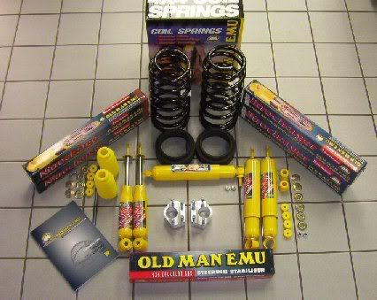

    Old Man Emu lift kit options
    Option (1)
    2"-3" Lift (approx.)
    Sdori 1.5" Ball Joint Spacers (1pair)
    Sdori 2" Coil Spacers (pair)
    OME N98 Front Shocks (each)
    OME N71E Rear Shocks (each) FJ80 Shock
    OME 901HD Coil Springs (each)
    OME SD33 Steering Stabilizer
    Total $638.65
    Option (2)
    1.5"-2" Lift (approx.)
    OME N72F Rear Shocks (each)
    Total $501.24
    Option (3)
    OME N72FRear Shocks (each)
    Total $454.72

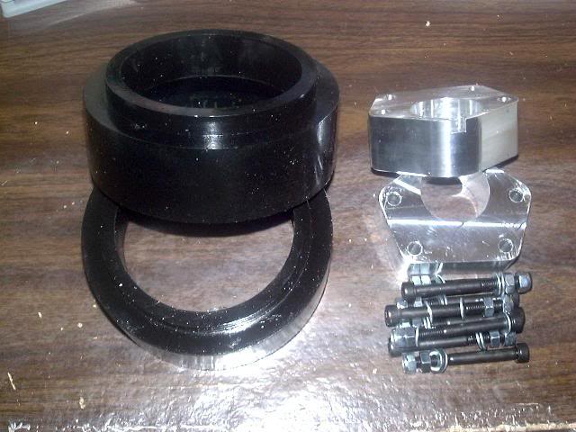

    2" 4Crawler lift
    1.5 BJ spacers and 2" coil spacers $189.00

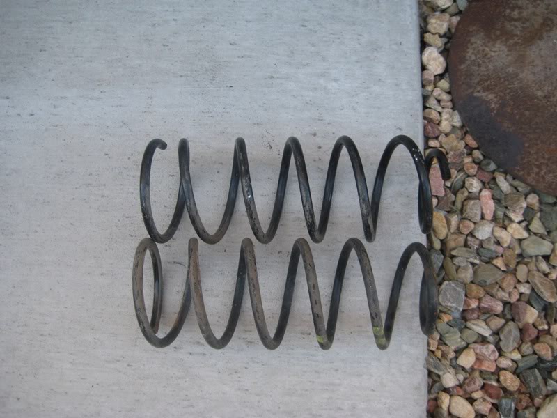

    1.5" BJ spacers and 80 Series Land cruiser coils
    80 series land cruiser (1990-2008)
    *lift 3" * Also If you get them of a truck, they come one short sided one long, just the way they are, so try to get a pair of short sided, or longer sided, only about 1/4" difference

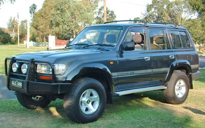

    Example with of 1.5" BJ spacers and 80 Series Land cruiser coils
    80 series land cruiser on 33x12.50

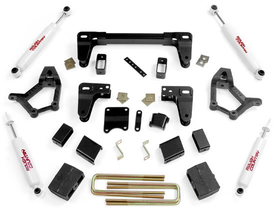

    4-5" Rough Country lift $609
    *Now this is meant for an 86-96 4wd IFS Pickup, however all you need to do is replace those blocks with 80 Series Land cruiser coils.*

    So how does option 1 get you that much lift, in the front especially, 1.5-2" t-bar crank or what? The rear coils and spacers make sense though.

    If you plan on cranking the torsion bars, i would suggest getting the old man emu torsion bars as a replacement..
    i was curious about that to, but that is what i assumed
    here is were i got it from
    https://www.yotatech.com/forums/f37/...s4u-com-54794/
    That doesn't make any sense, unless they're just accounting for the rear where height is gained because of spring sag.

    Just a few things..
    Your first picture, those tires rubbed pretty bad on that truck. Should note that to really cut down on trimming, you wheel needs to be stock backspaced (or very close).
    Option 1, 3-4" of lift? No. 1.5-2" tops. There is no way to get 4" out of just bj spacers without totaly throwing your front end out of whack.
    Other then that, pretty good

    What year of 80's series Landruiser coils, or does it matter? Do you have a part number.
    Old Sep 27, 2008 | 11:13 AM
    SR5's Avatar
    SR5
    Joined: May 2007
    Posts: 713
    Likes: 5
    From: Kirkland, WA
    OME 895
    and as long as its 80 series it don't matter

    Originally Posted by Jay351
    Just a few things..
    p.s Love that the bracket lifted 4runner has those stupid chrome rims
    i know i didnt like that option ill change
    but here i got it from strap 22
