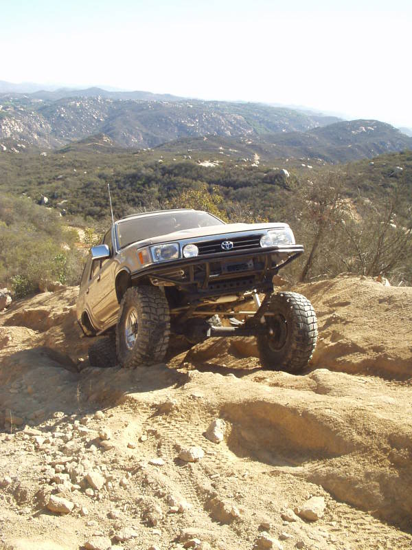

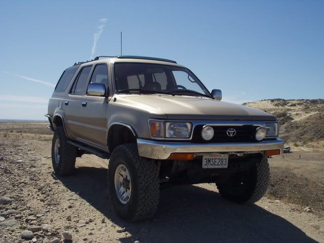

    Having owned my 4runner for about 7 years now, I have changed the suspension a few times.....here is my history lesson...
    When I first bought it, Downey was the only game in town...so I purchased some 1.5" HD coils and cranked the torsion bars to match. It had very little flex, but worked ok for the trails I was running.

    Then the ball joint spacers were available from SDORI and I put them on, relaxed the torsion bars to factory specs, and went with 33x10.5 BFG's. It worked great, flexed ok, but the front was a little higher than the rear again.

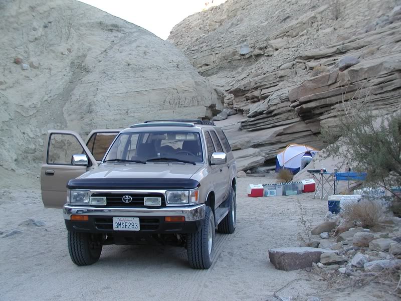

    I then replaced the rear coils with some FJ80 coils, and added a Panhard drop bracket. It worked good, but the truck leaned a little due to the coils being different lengths (that is how they are). So I bough another set and used both long side coils.

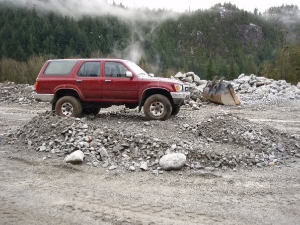

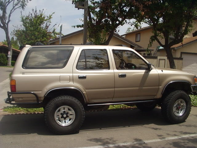

    I ran that setup for quite a while, until the upper control arm bushings gave me issues...I ditched the IFS and completed an axle swap up front. For the rear I have basically the stock configuration with the exception of adjustable upper links, adjustable panhard bar, and OME 860 springs. Eventually I may swap the rear to leaf springs.
