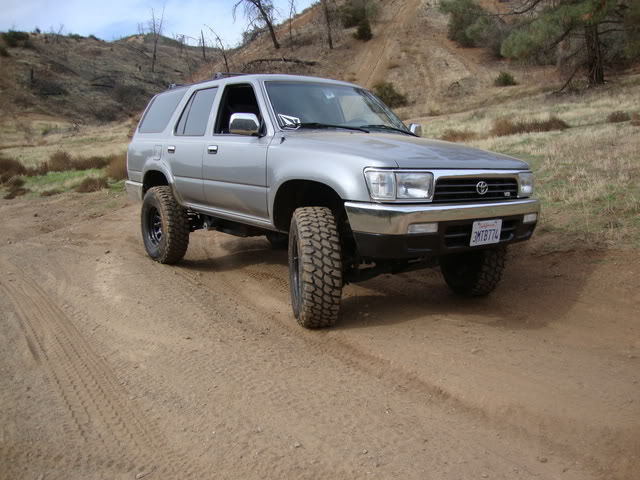

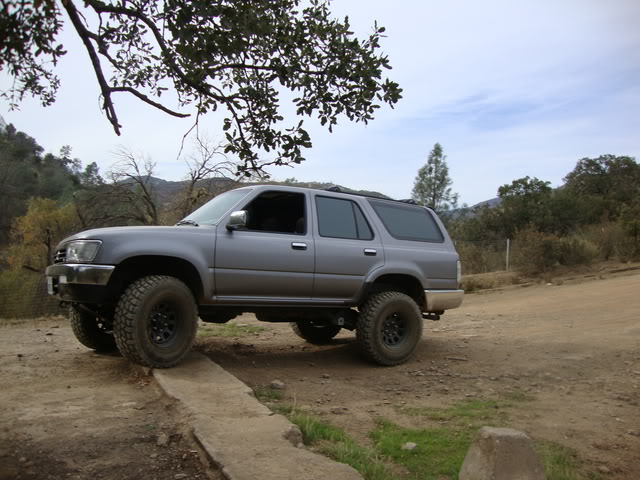

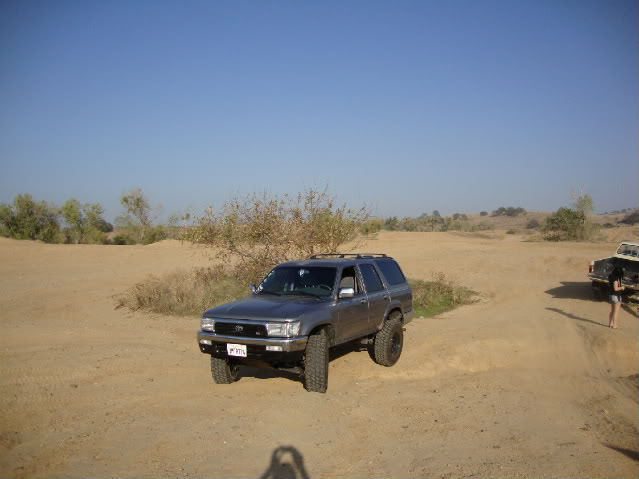

    anyways ill post mine. not up to date pics now has new custom rear bumper. runnin 32's no sway bars adjusted t bars 2 in spacers in rear. 15 1/2 in from rim lip to fender lip with 16's. sits higher then my friends 85 straight axle with 4-5 in TG kit . couldnt really find any pics of it not wheelin or one where its level. lol
    I love the way your Runner looks. I think it sits beautifully and perfectly. If you don't mind, could you pm me with all your suspension details. What you bought, where you bought and any modifications you had to do. Thanks

    From: Modesto, CA
    thanks not much done though. it has 16's on it which i think makes a big difference looks wise. other than that some 2in coil spring spacers in the rear from toytec and a bit of crankin of the tbars will do it. 265/70/16 tires with 16x8 with 4.75 bs
