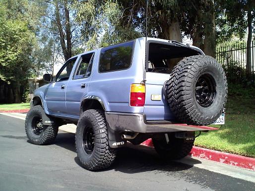

    this is how she sits now...
    Running 35's..901 OME's rear, 1.5" RB BJ Spacers front, really cranked the t-bars..Super stiff front end...
    Purchased Sway Away T-bars for the front...need time to install...should soften the ride a little..

    that looks nice! ^^^ i like how there is no body lift .
    all sounds good to me but i wouldnt do a body lift imo they look wonky and i cant stand the frame hanging down so far. the most i would go would be 1" to just barely fir a 3.4 . imo its all susp lift

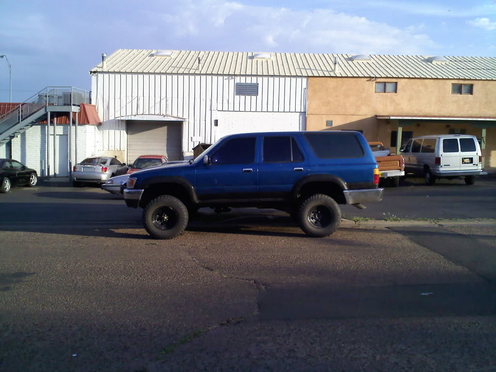

    i went with the cruiser coils and ball joint spacers. 09' tundra shocks in the rear and toytec extd. lenght shock in the front. and mine sits lower in the front how can i fix this with out messing with the t-bars.Name:  0813090734.jpg

    ball joint spacers...

    turn them T bars lol if you already have bj spacers then i dont know what else you could do but crank em a bit?
