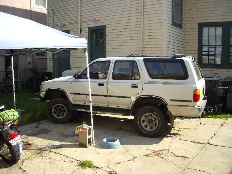

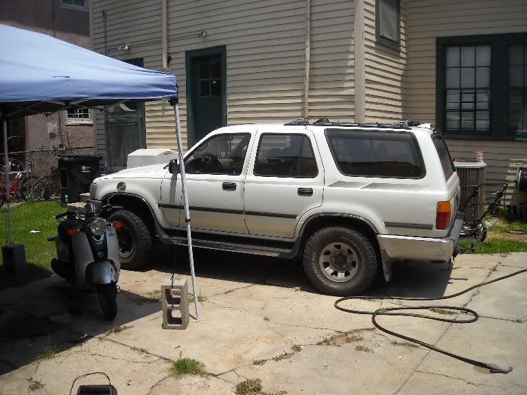

    Current pricing on Option 2 is $535 at trdparts4u. I just finished installing it, and feel it's more than 2" of lift.
