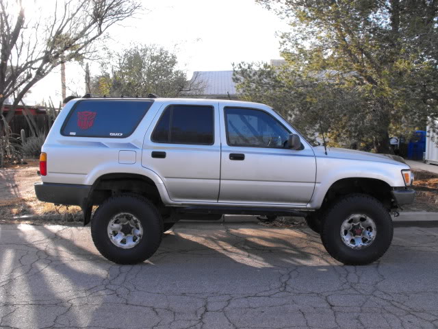

    bj spacers LC coils and 1" BL BFG 33x10.5's (before I turned the torsion bars up a bit)
