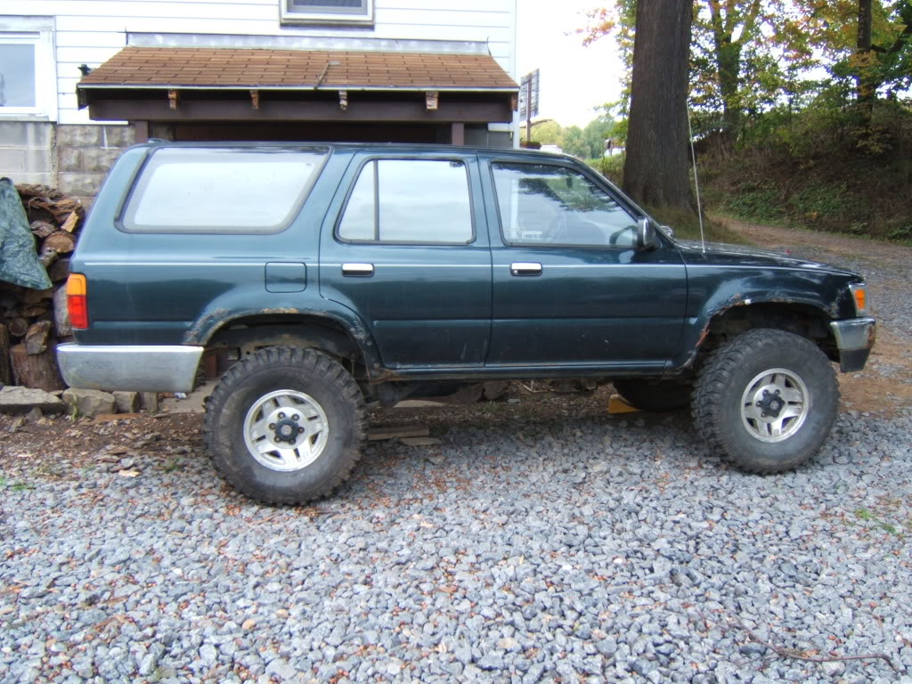

    Probably not too much here is mine with LC Coils and "no" bj spacers, I'm running 33's. I have them just not enough time to get them in.

    Two more questions are those stock lc coils? because i want to get a set of LC coils i saw on trdparts4u.com that gives the LC .7" of lift ...and my second question is what year LC coils are u using?
    Old May 17, 2011 | 09:51 AM
      #435
    Lumpy's Avatar
    Joined: Jan 2009
    Posts: 6,086
    Likes: 17
    Thanks...the old girl has been through some hell along the way.
    Yes, I have stock rear 80 series coils on the back.
    As for the year not real sure all I know is that they are from and 80 series 90-97 I believe.
