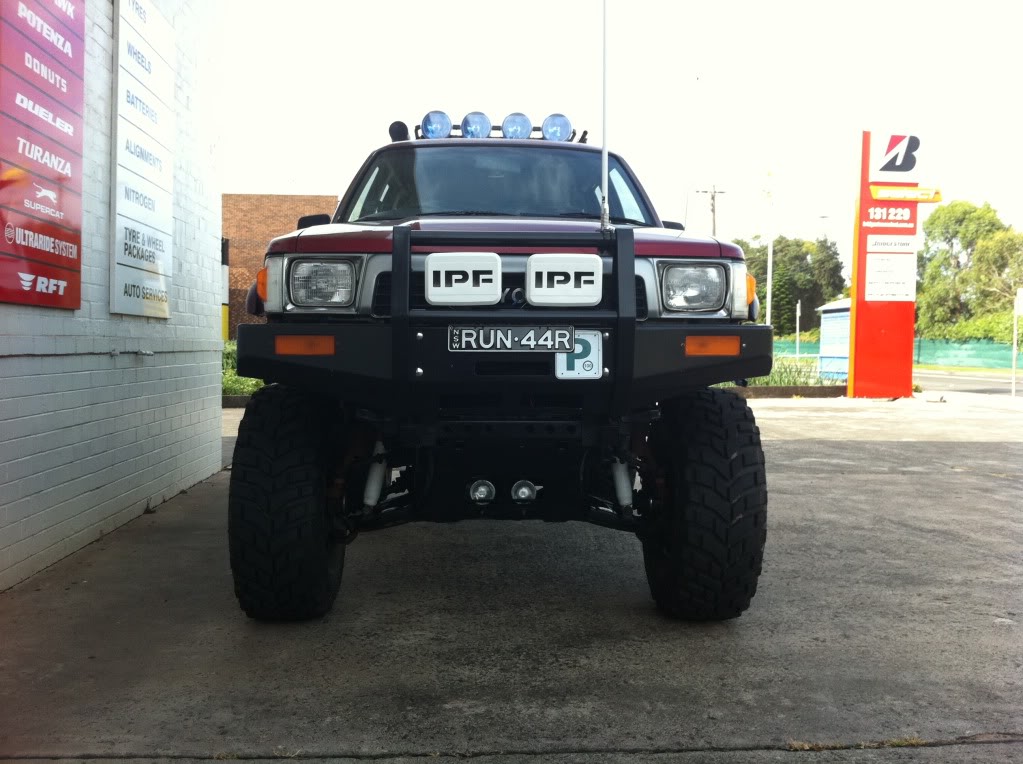

    This is my 2nd Gen
    4" Skyjacker IFS bracket lift
    1.5" 4crawler BJ Spacers
    3" 4crawler Body lift kit
    1" Lifted Land Cruiser Coils
    Skyjacker 4" Extended Shocks all round
    Set on 35" Mickey Thompsons
    So all up about 8" over standard
    I actually had brand new 33s but took them back and swapped them for 35s after i lifted it. so now i need diff gears

    So how does this thing feel at around 70-75 mph??? Is tippy when cornering at low speeds (30-35)?? Looks awesome! And the lights in the skid plate are kinda cool. They must light up the ground pretty good!
    It's actually pretty stable even at speeds. I was expecting it to be a bit scary but I barely had to adjust my driving style. I'm running it without a rear sway bar at the moment and that is definitely noticeable in the corners. Still…not bad thought
    Right on just looking at it I would imagine a lot of body roll but if that's not the case then wow! Like I said its a great looking truck!
