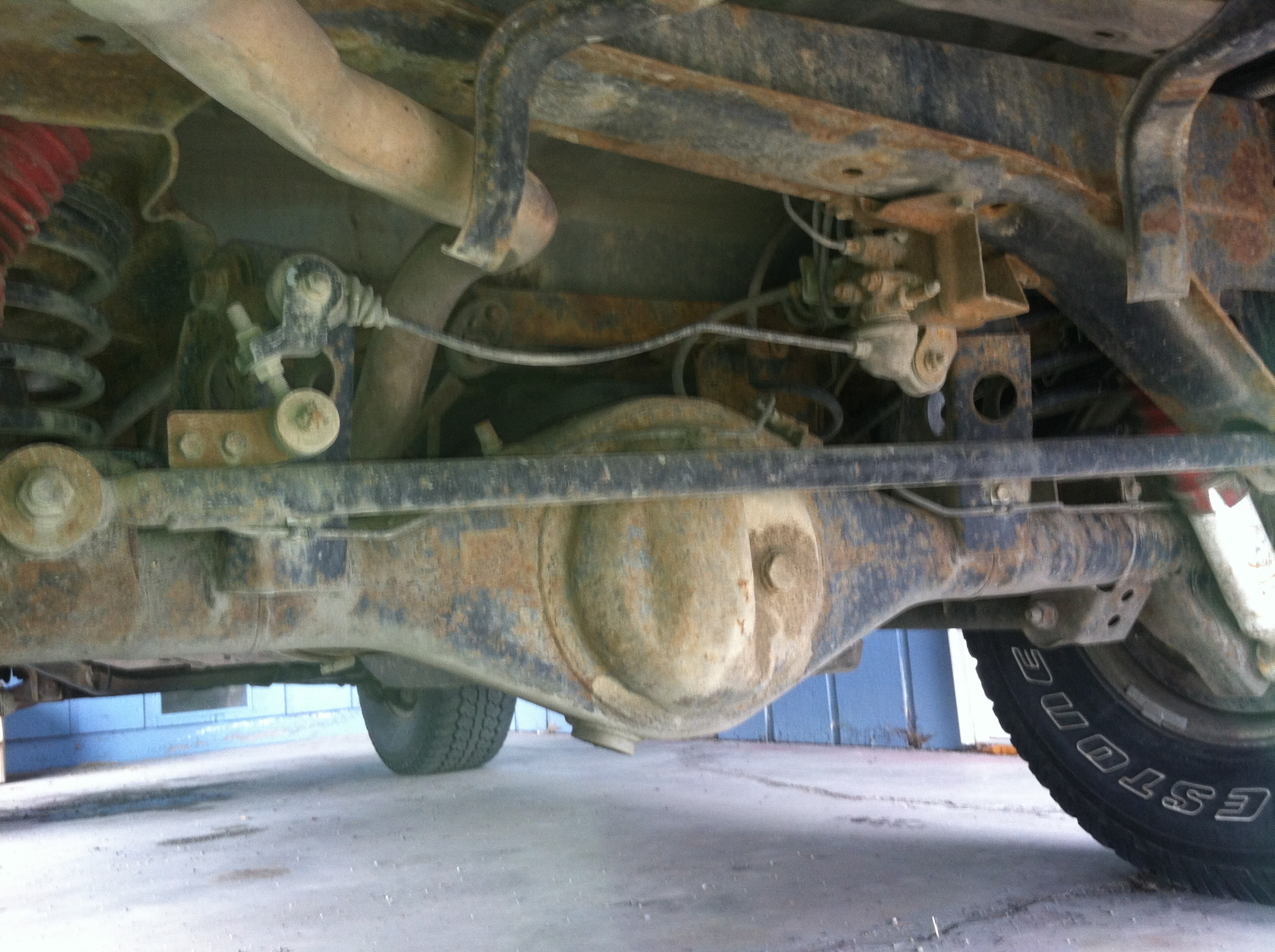

    Is this a torsion bar?
    Is this a torsion bar? I'm pretty sure but doesn't look like are any drop down brackets. If it is what else will I need besides longer shocks and fj coils?

    That is a PANHARD bar, not a torsion bar.

    Yep, panhard bar as noted above:
    - http://www.4crawler.com/4x4/ForSale/...anhardDropBrkt
    And a bracket to re-align that plus a bracket to raise the brake proportioning valve (LSPV):
    - http://www.4crawler.com/4x4/ForSale/...l#LSPV_Bracket
