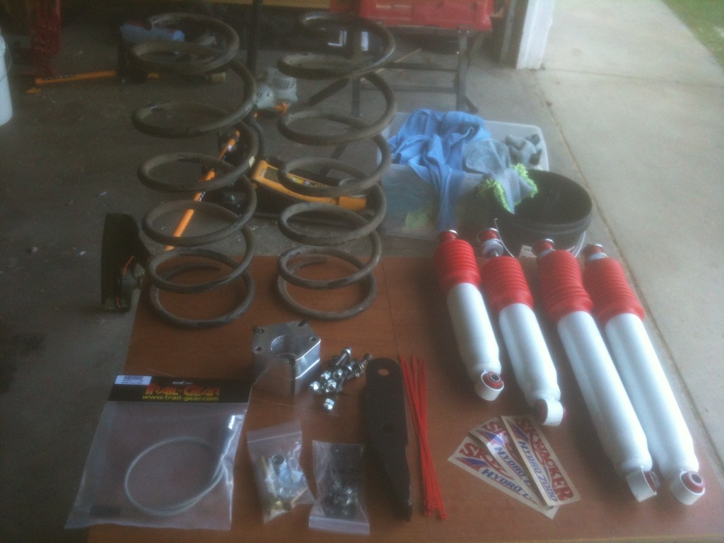

    Figured I could add my .02 to this thread now.
    This is EVERYTHING you need to lift a 2nd gen 4Runner.
    1.5" BJ spacers
    FJ80 Coils
    Trailgear Brake Line
    Skyjacker front shocks -SKYH7054
    Skyjacker Rear Shocks - SKYH7024
    4Crawler 4" Panhard
    4Crawler 4" LSPV
    Total cost:
    ~$250 including the 35 dollar rebate on the shocks and the 20% on sale.
    Hope this helps... pictures will be posted when the lift is done.

    thanks for the info, im ready to order, i just need the Fj80 coils now, not havin much luck finding them!
