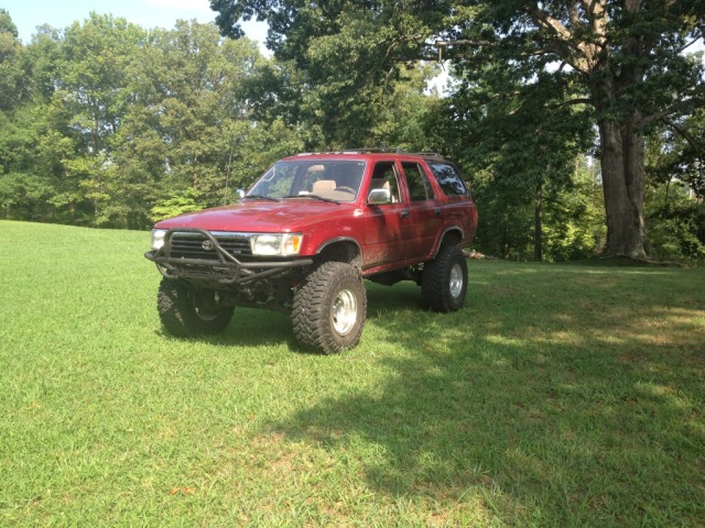

    If you're trying to save money and not lift it very much, I think I'd go with rear spacers if I were you. I still have my OME 900's around, and plan to use them in the rear when I do a lowest lift possible sas, but I'm pretty sure where they get that 1.75" of lift number is from stock height, not sagged after 20 years height. My adding weight to the front of mine with a just a Marlin bumper made it so I couldn't keep the front level with the rear unless I had about 800 pounds of stuff in the back. I now have 1.5" spacers in the front with the bars relaxed a little for smooth ride and 1.25" Daystar spacers in the rear. It's just enough to keep off the bumpstops and the stock springs can still haul some weight. Not too long ago, I had 2 complete rear axles, a complete front, a set of 4 lift springs for my '83, 2 front and 1 rear driveshaft, a radiator, and some miscellaneous trim pieces in the back of my Runner, and it was still an inch or so off the rear bumpstops.
    This is my stance as of now, with survival/camping stuff I always have in there and one of the complete rear axles still in the back cause I haven't delivered it to my buddy yet

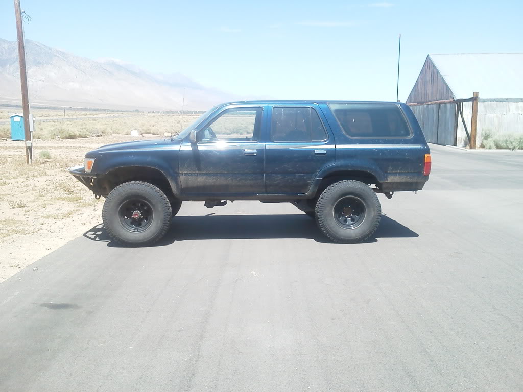

    I put the lc coils on the rear, Lspc bracket, pan hard drop bracket, and the bj spacers in the front. Matched it up with 15x10" rims and 33x12.5's. In less than a month i busted 2 cv boots with normal driving. Get the diff spacers if you do this lift. I finished up the ride with a bumper from addicted offroad.
